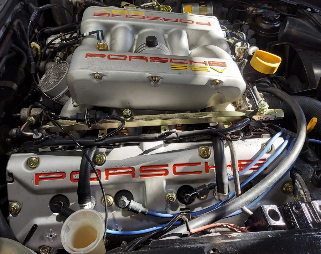

Big progress. I have everything buttoned up except the new FPR and the dampers. Waiting for a nicer day to allow the garage doors to be open for venting. Still need to figure out the fuel pump but I spent a bunch of time on just finishing up odds and ends.. I think I might have a leak at the water bridge which sucks but I did miss one coolant connection initially so it maybe residual. If I need to put a new o ring in the bridge what am I looking at for taking that apart? Is that intake off or?Attached Image Attached Image

nice work, looks great, water bridge can be done with intake in place, but I wouldn't recommend if you have not had those bolts out before, access is very poor and they tend to seize in the block, so need careful / not angled removal / heat etc.

Well the Water bridge turns out was not leaking. I have the TPS and the CPS plugs Swapped but now with it correct it runs pretty darn well. Stay tuned for more updates. It super quiet which I don't think I like on this car.

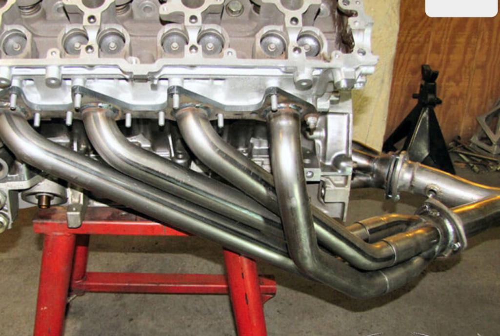

A pair of these will definitely wake up some horses + make some nice tunes!

(IMG:style_emoticons/default/agree.gif) .... yep they where of a time when quite was better, xpipe and rear muffler delete are popular mods which are less of a commitment than headers

...if power is needed= exhaust scavenging; just after a change in sound= muffler change

This would probably sound better with a set of Marty's headers but it is definately NOT a Chevy! The tone from the throttle body is awsome when it blips open.
https://www.youtube.com/watch?v=kRf69SC1EQ0
Those headers would probably work on the Alien the way they are pointed in at each other... (IMG:style_emoticons/default/idea.gif)

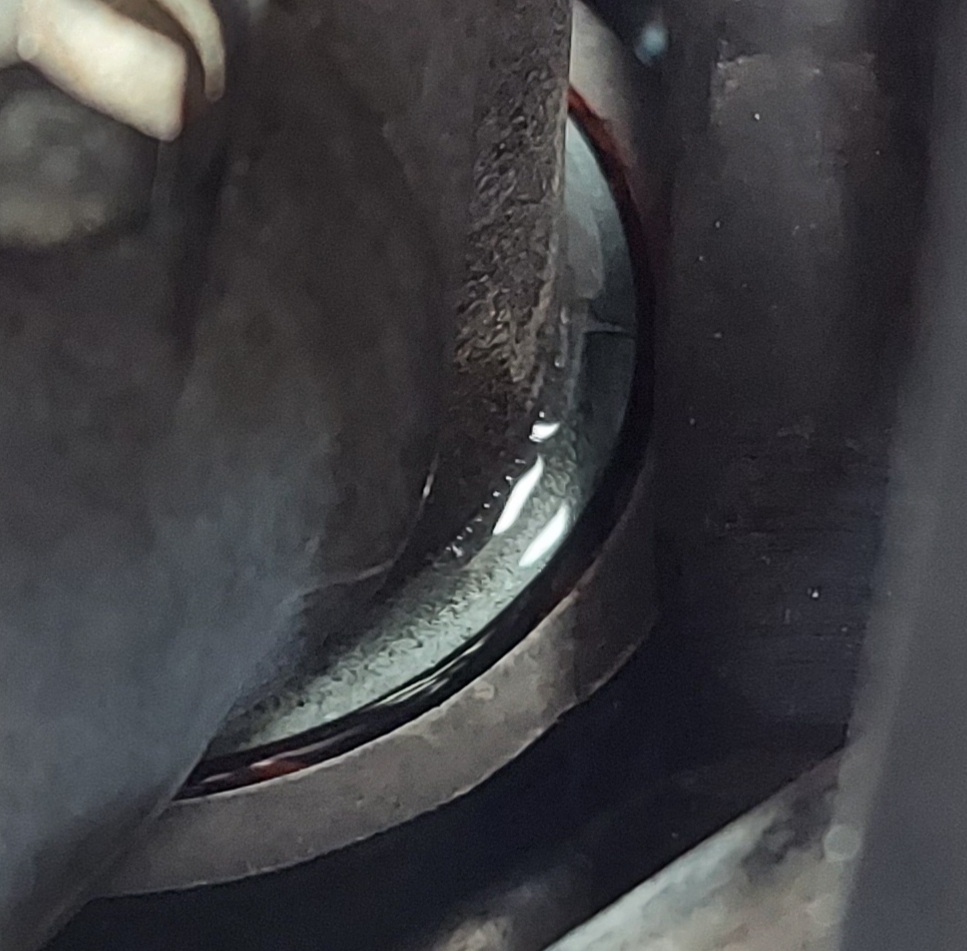

Well took it around the block this past weekend. Drove nice. Bad news is trans has a front seal leak.. ugh. Sounds like tranny out to fix that.
