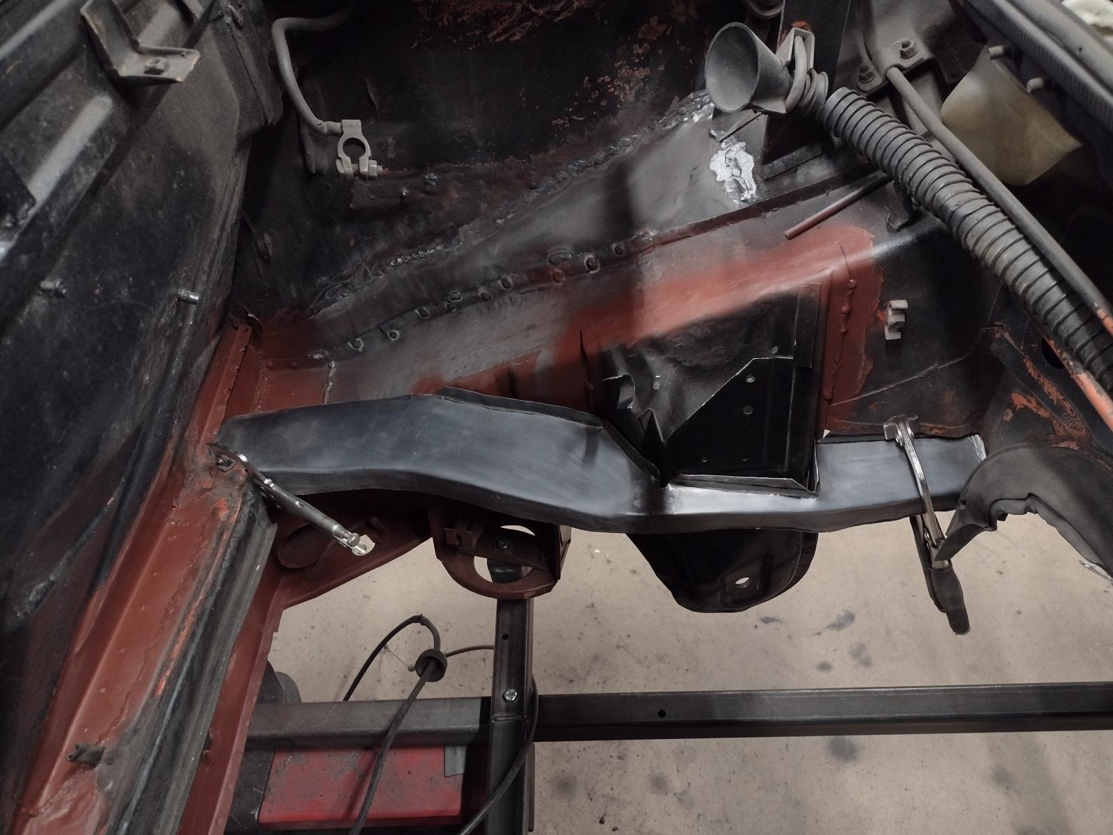

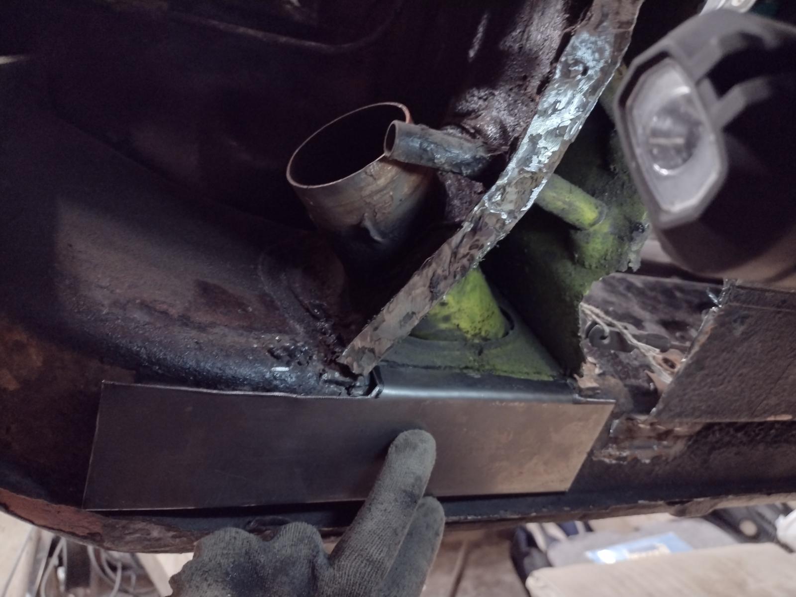

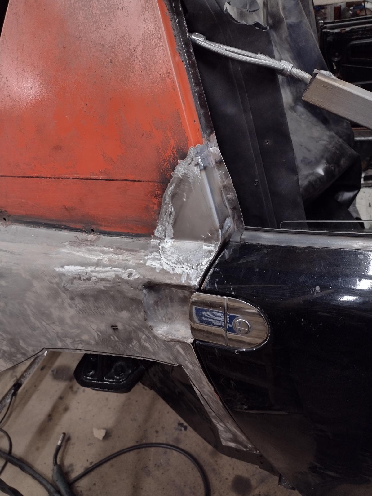

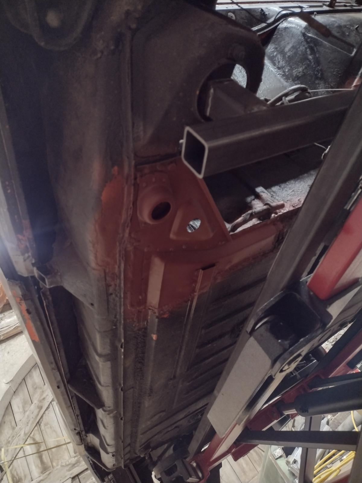

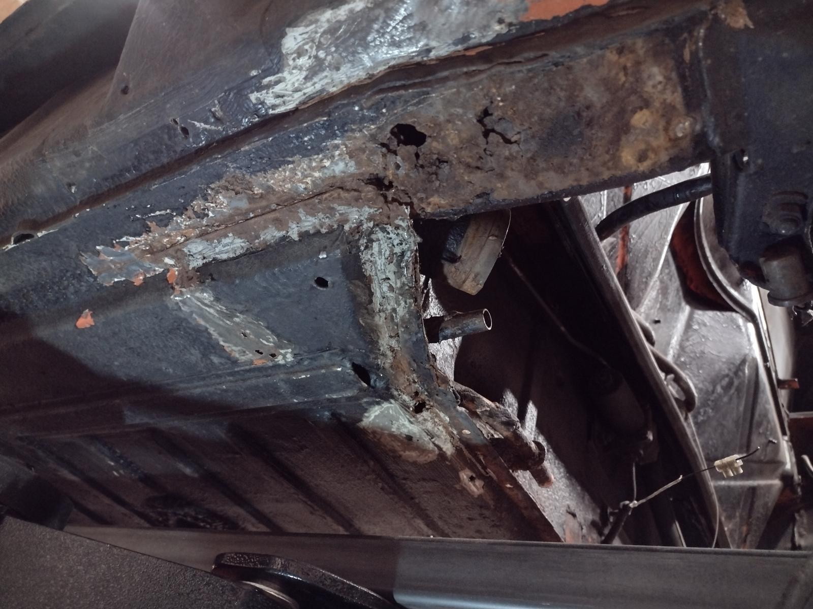

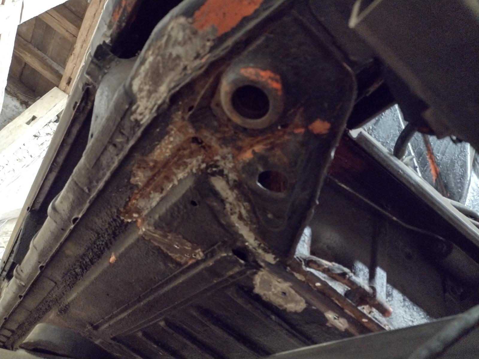

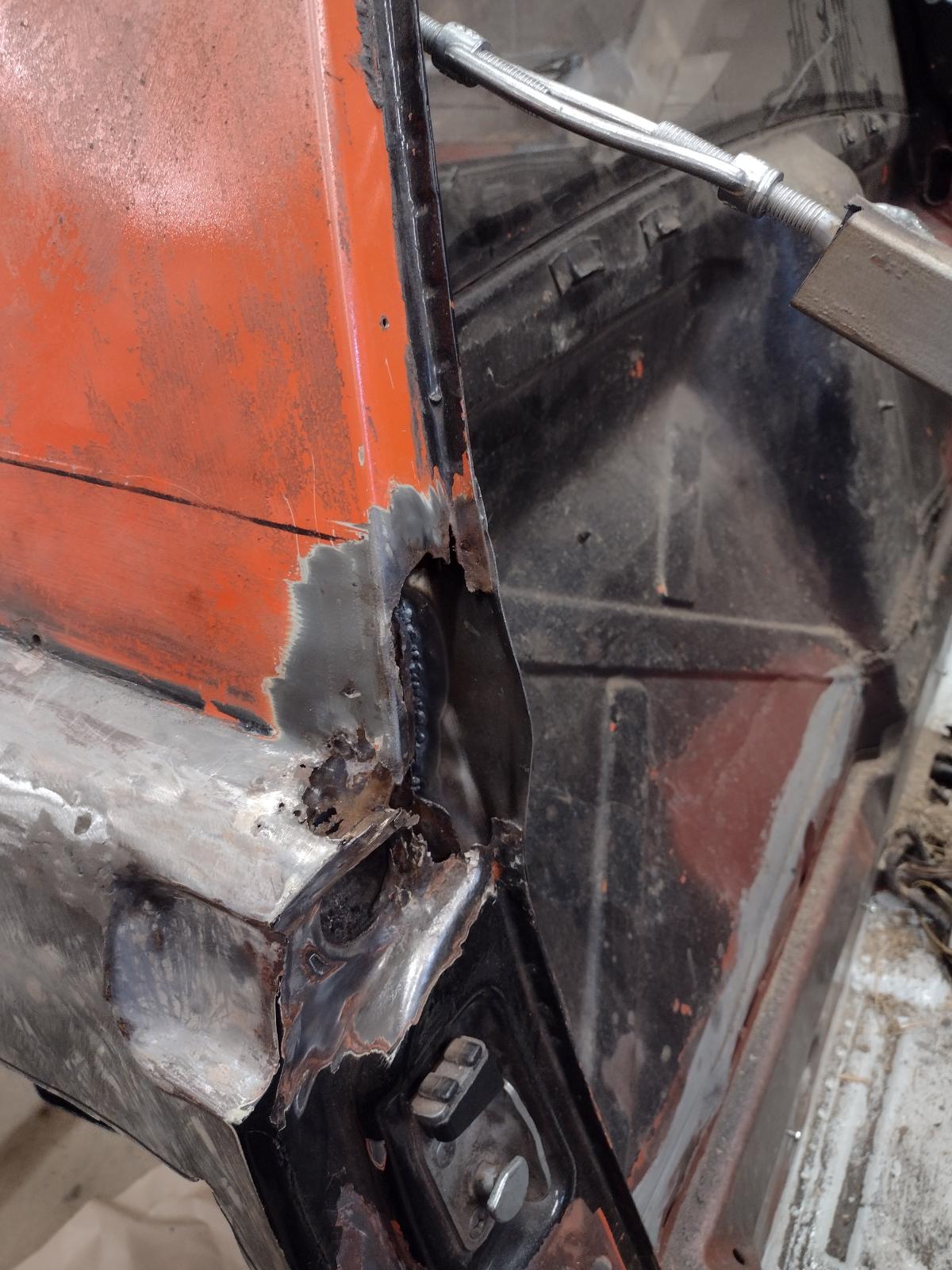

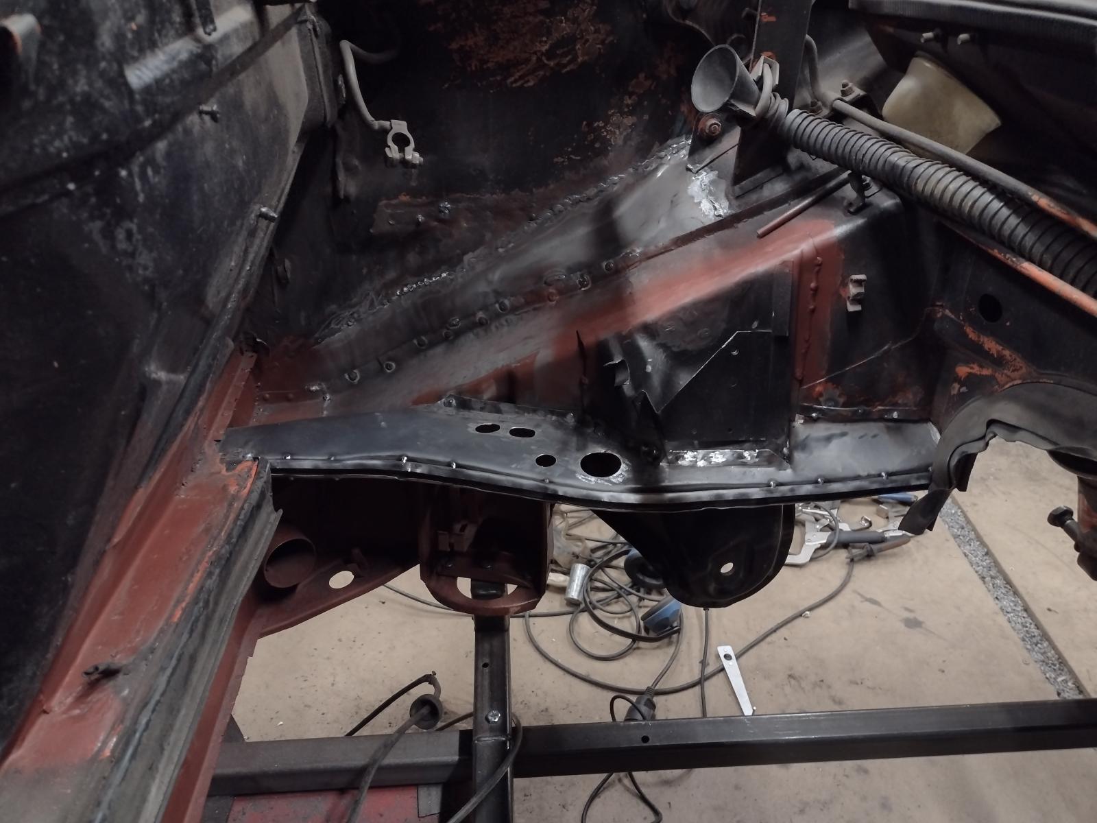

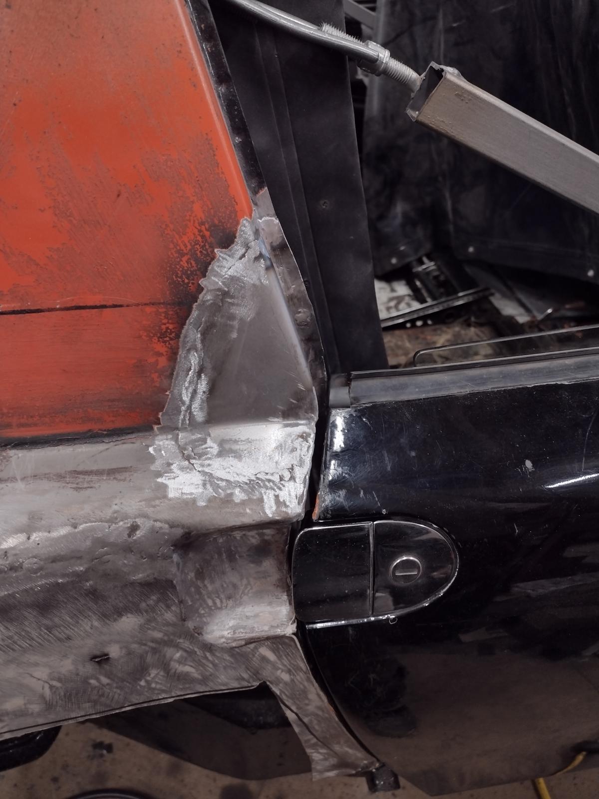

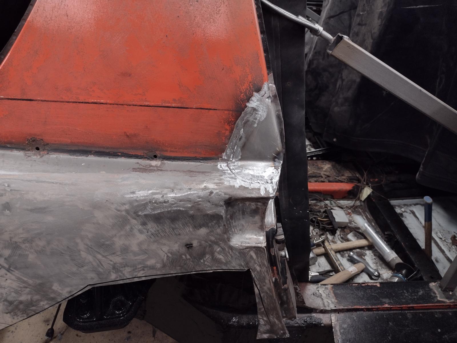

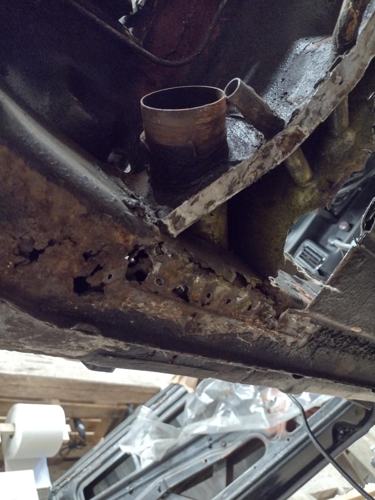

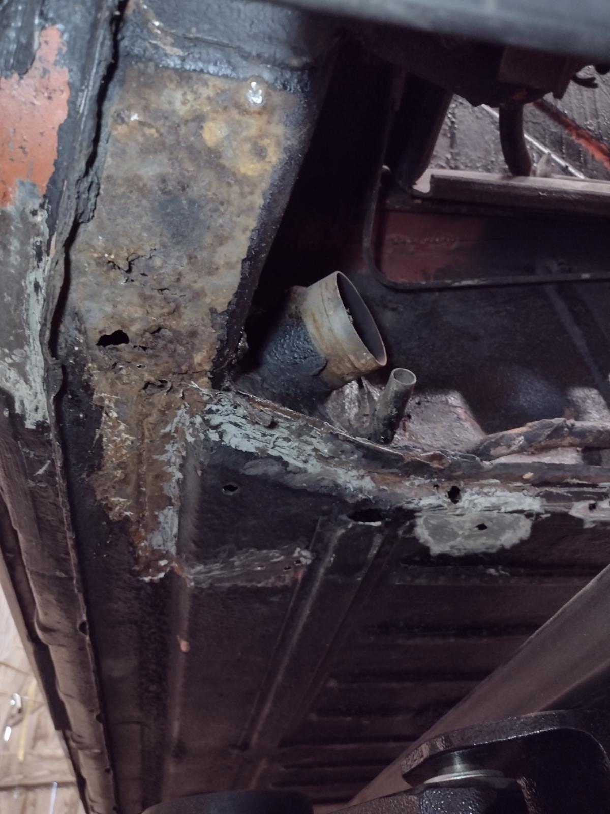

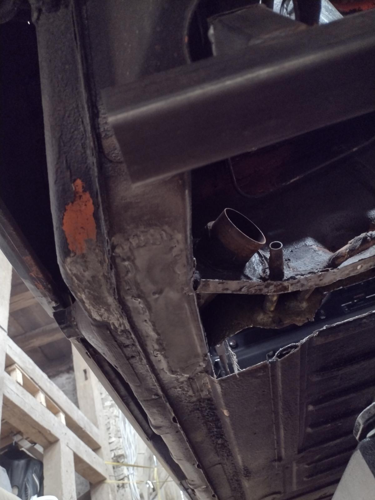

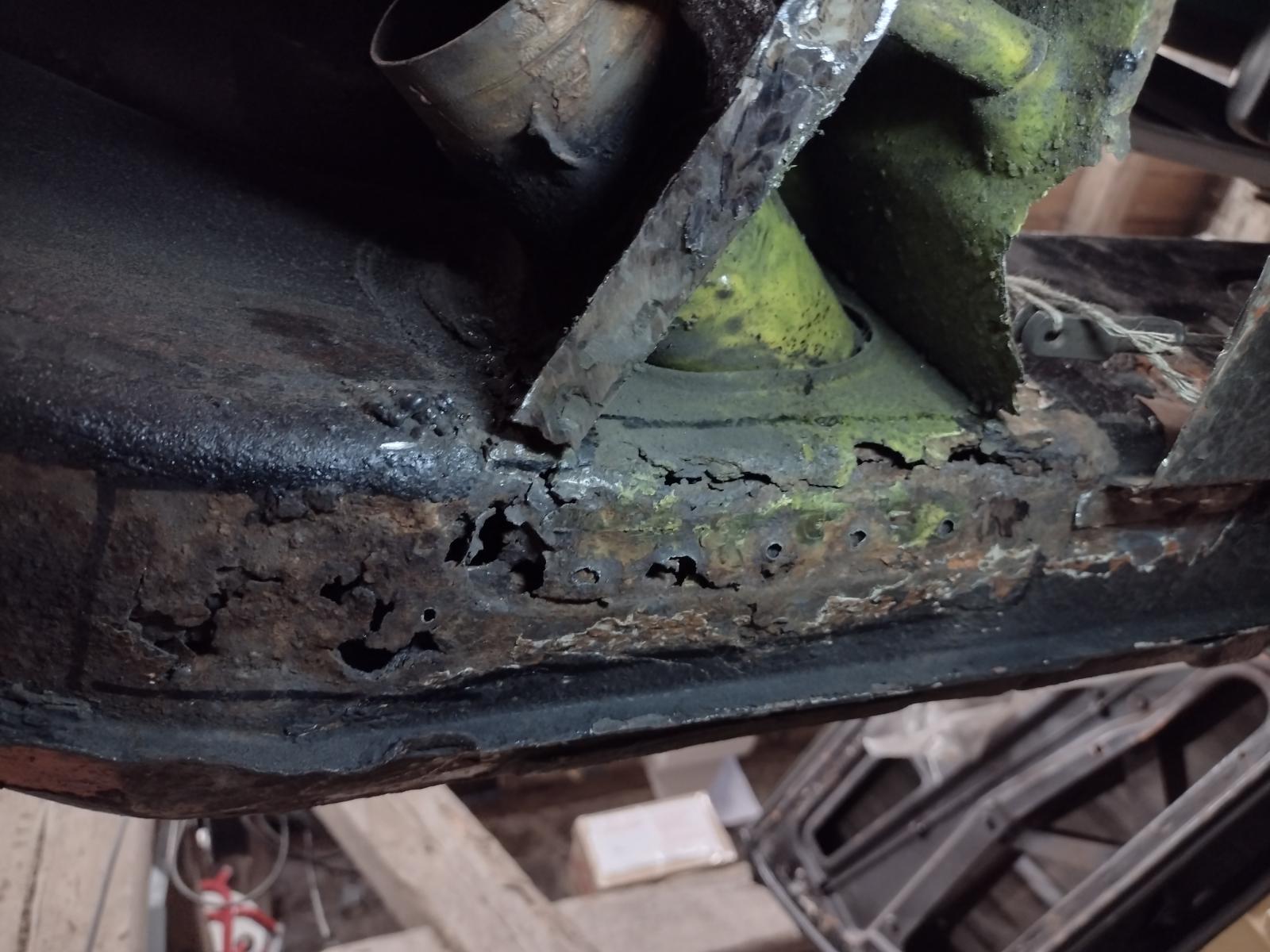

So, as promised, the work on the driver's side!
After a bit of Paint/gravel protection removal, it wasn't looking promising:
(IMG:http://www.914world.com/bbs2/uploads_offsite/www.thesamba.com-24690-1645822663.1.jpg)
(IMG:http://www.914world.com/bbs2/uploads_offsite/www.thesamba.com-24690-1645822664.2.jpg)
And not much better without the jack point triangle :
(IMG:http://www.914world.com/bbs2/uploads_offsite/www.thesamba.com-24690-1645822665.3.jpg)
(IMG:http://www.914world.com/bbs2/uploads_offsite/www.thesamba.com-24690-1645822665.4.jpg)

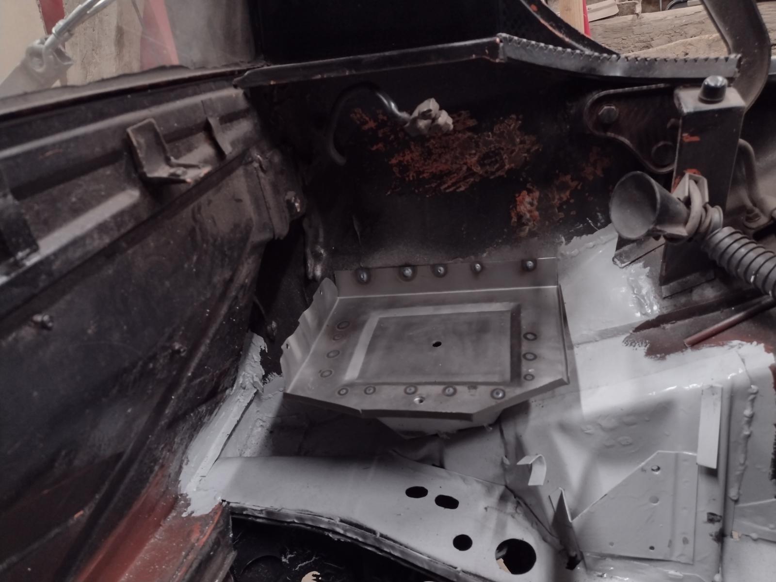

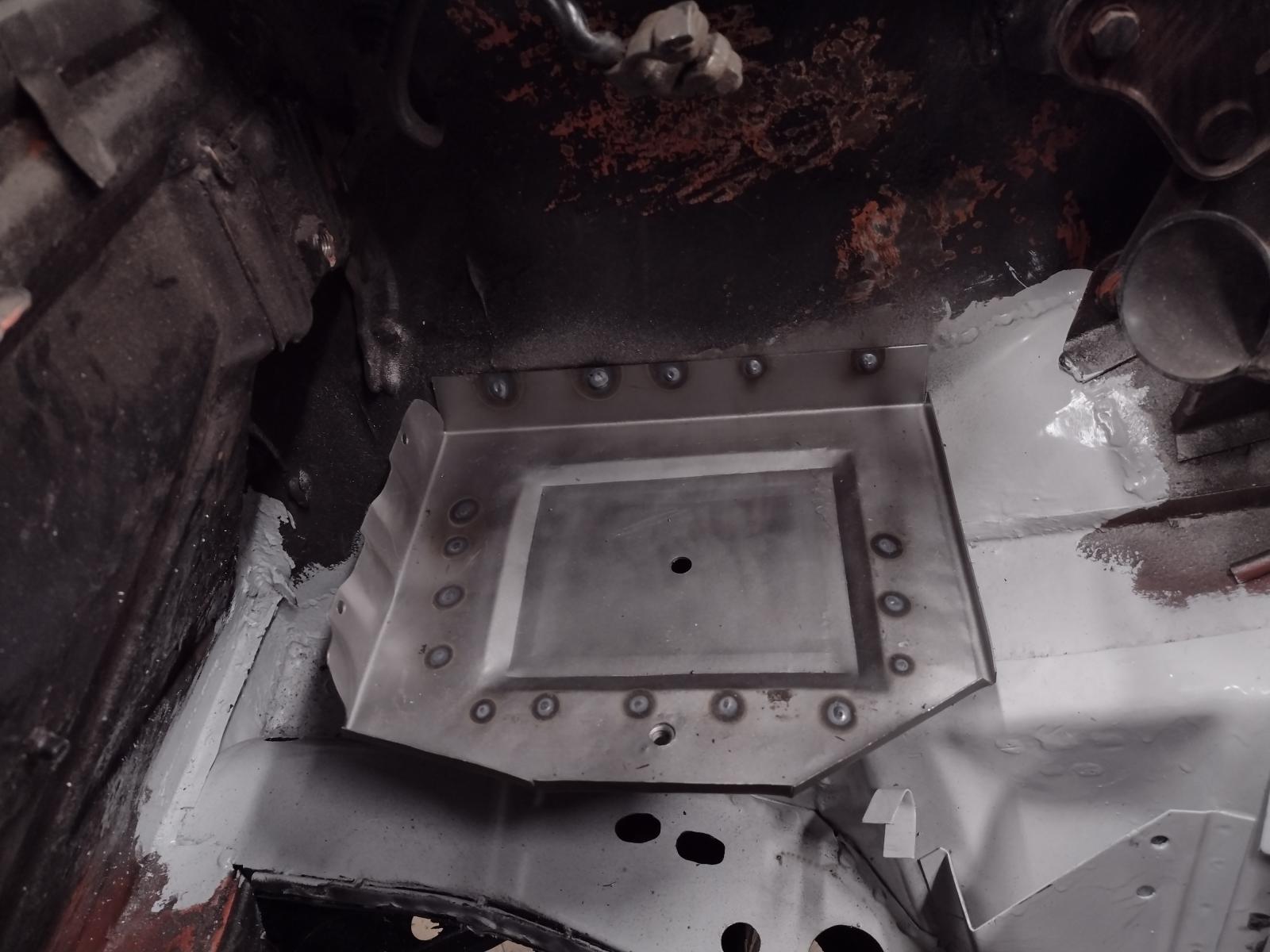

So I prepared the floor pan:
(IMG:http://www.914world.com/bbs2/uploads_offsite/www.thesamba.com-24690-1645822666.5.jpg)
(IMG:http://www.914world.com/bbs2/uploads_offsite/www.thesamba.com-24690-1645822666.6.jpg)
(IMG:http://www.914world.com/bbs2/uploads_offsite/www.thesamba.com-24690-1645822666.7.jpg)

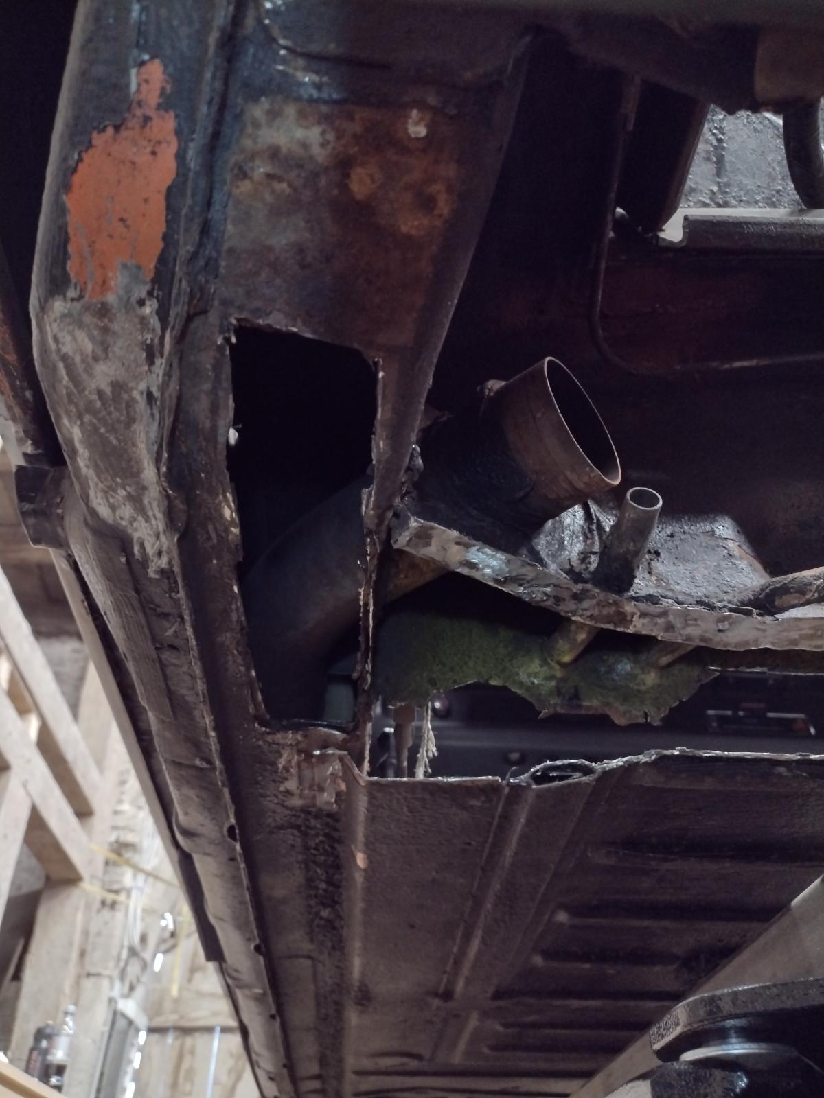

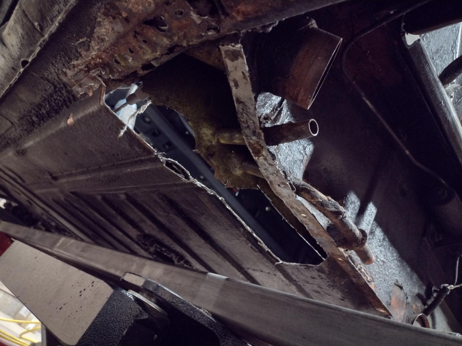

And made some cut:
(IMG:http://www.914world.com/bbs2/uploads_offsite/www.thesamba.com-24690-1645822667.8.jpg)
(IMG:http://www.914world.com/bbs2/uploads_offsite/www.thesamba.com-24690-1645822667.9.jpg)
Now I could see the damages better:
(IMG:http://www.914world.com/bbs2/uploads_offsite/www.thesamba.com-24690-1645822668.10.jpg)
(IMG:http://www.914world.com/bbs2/uploads_offsite/www.thesamba.com-24690-1645822668.11.jpg)

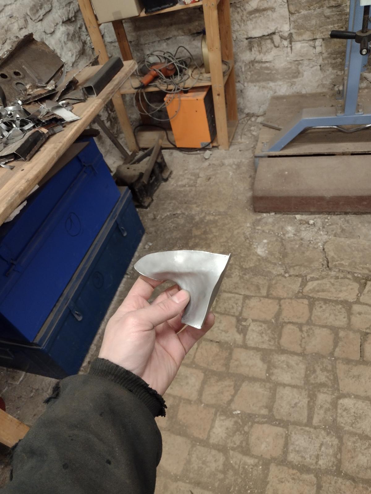

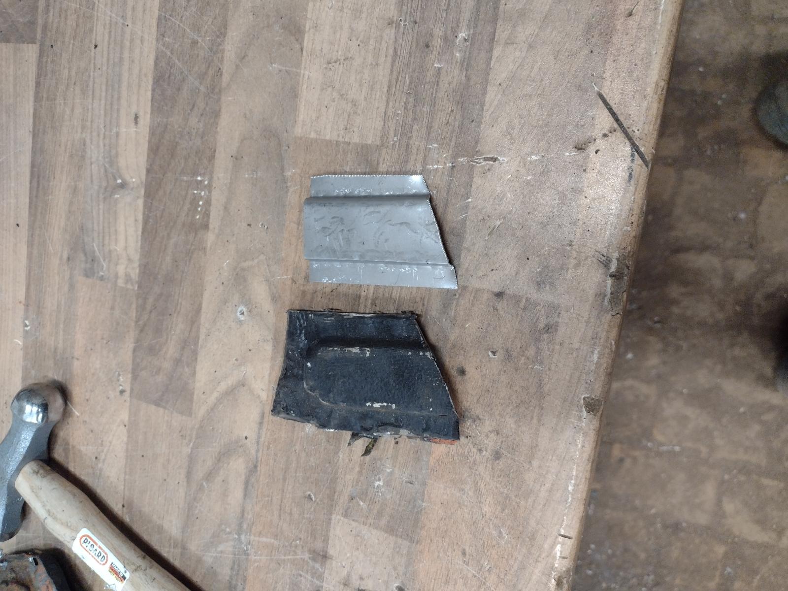

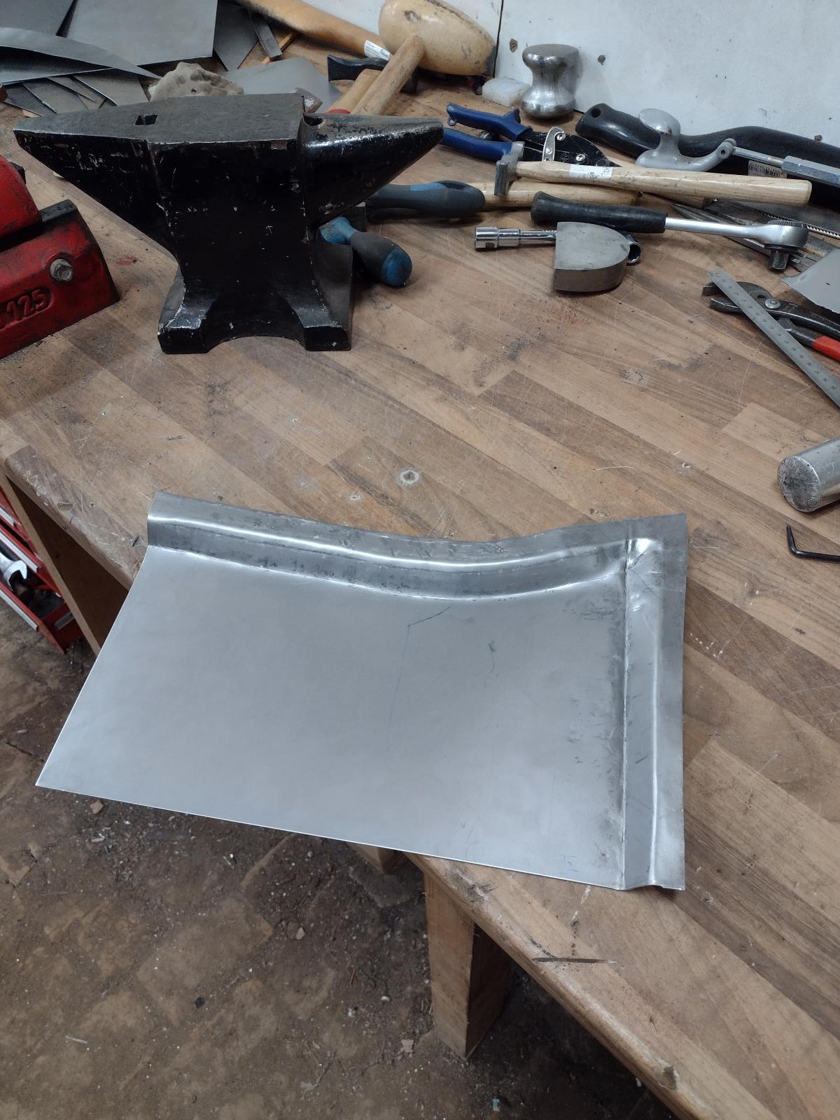

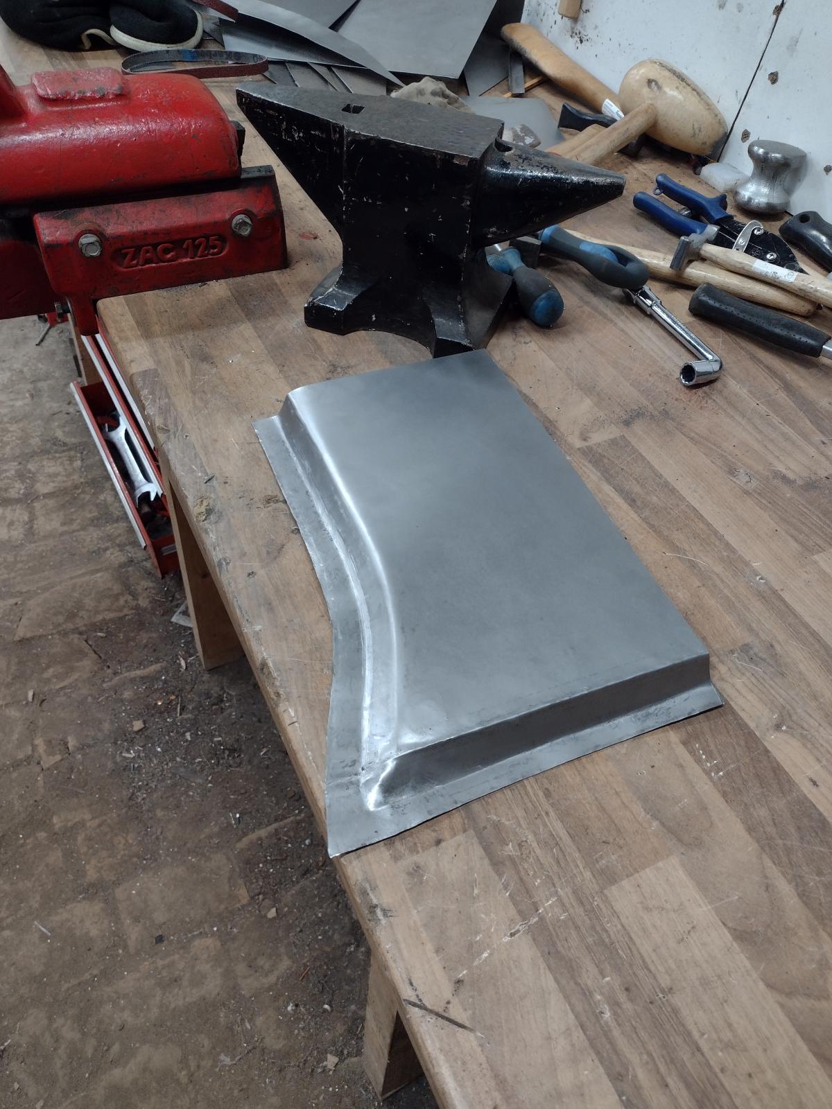

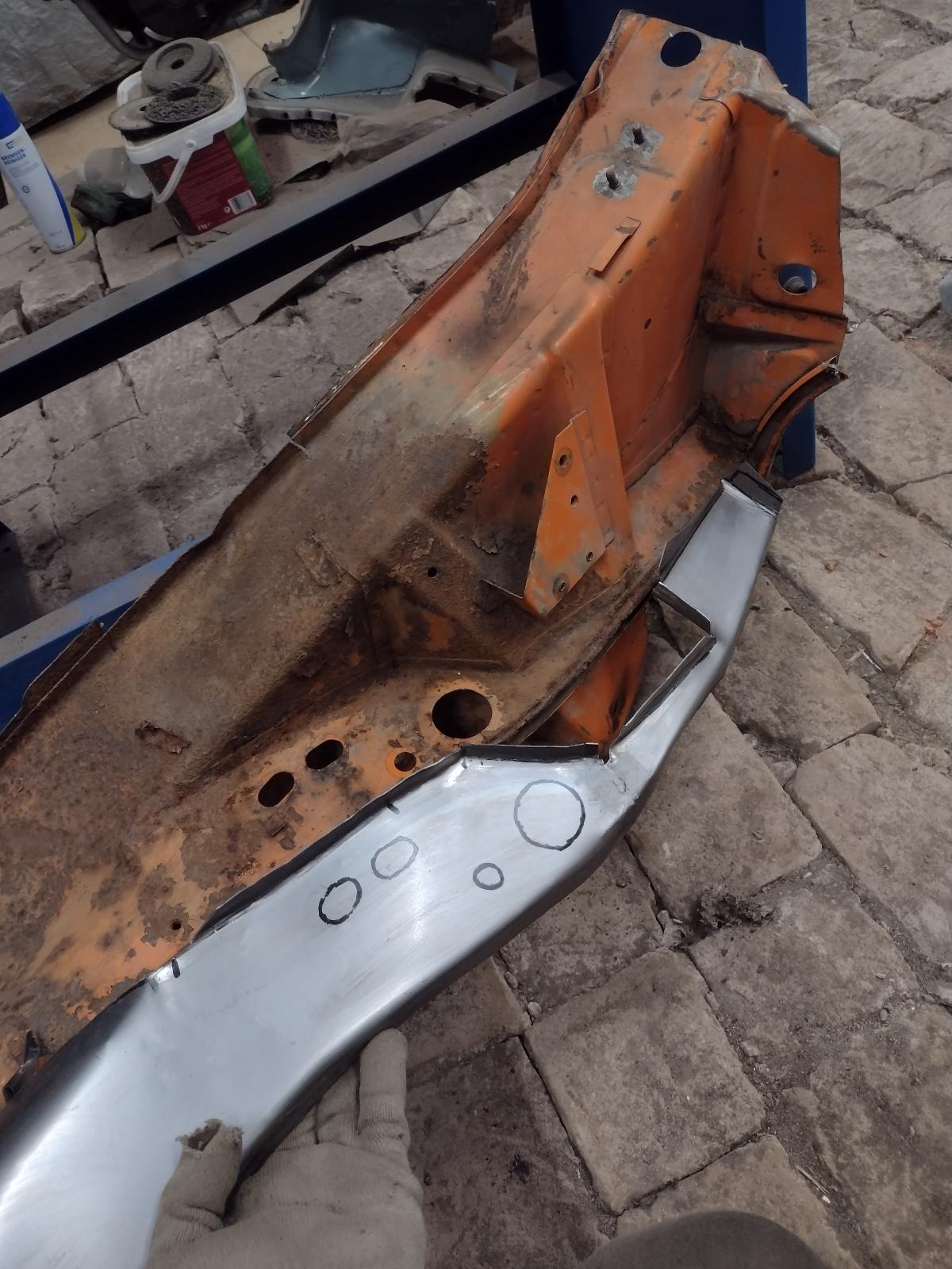

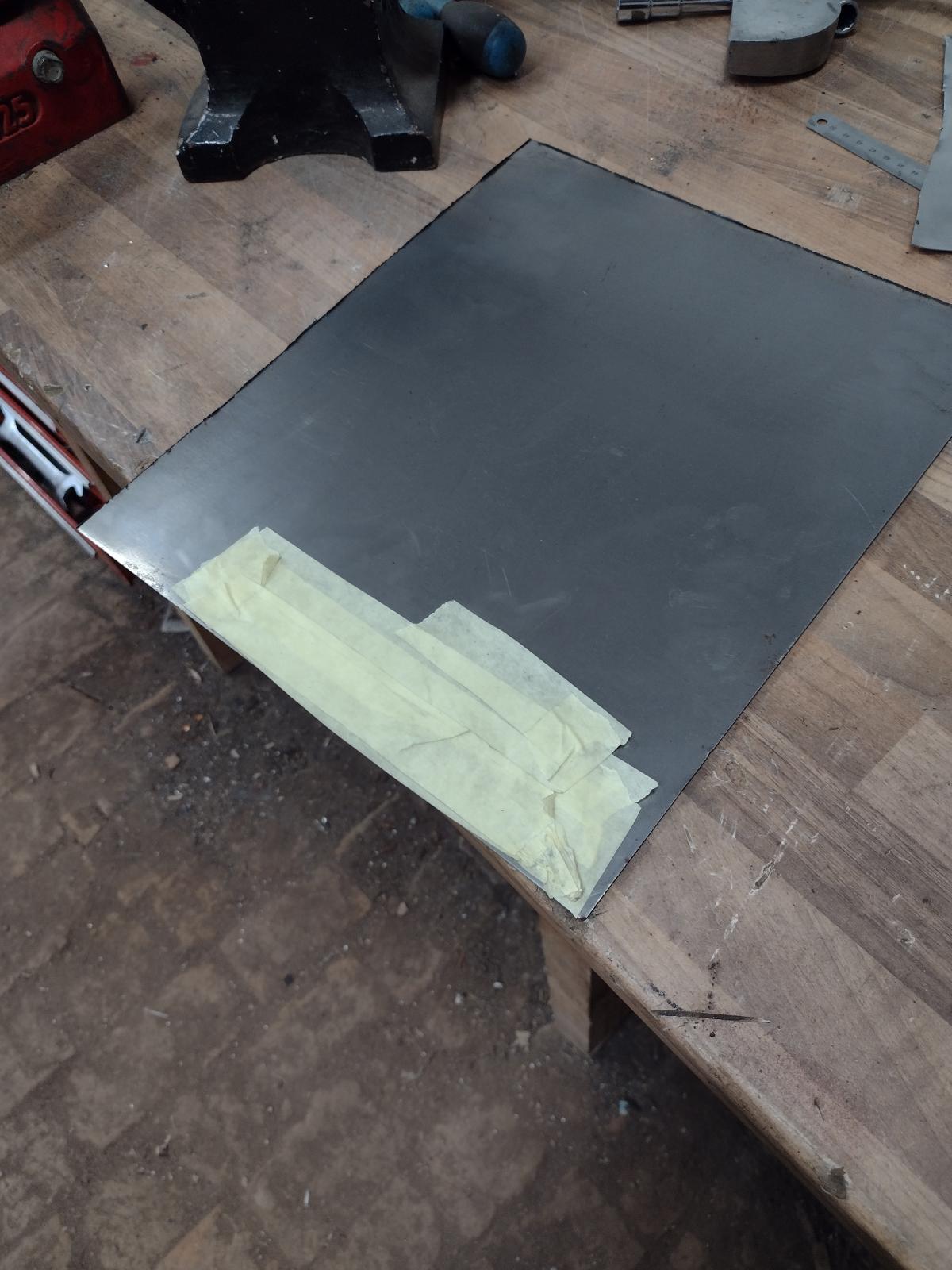

So I made a template :
(IMG:http://www.914world.com/bbs2/uploads_offsite/www.thesamba.com-24690-1645822669.12.jpg)

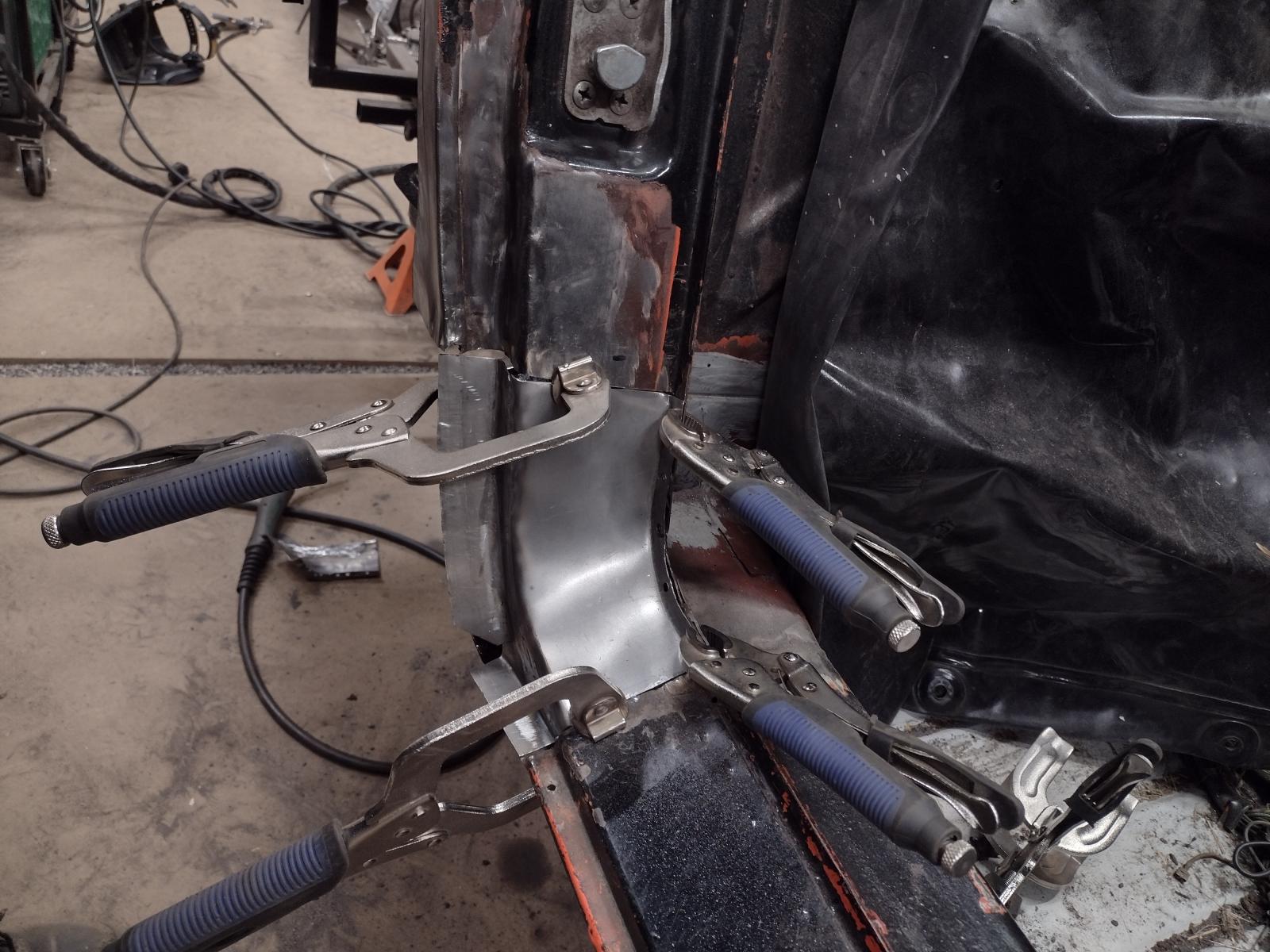

And the part, from cutting to adjusting to welded:
(IMG:http://www.914world.com/bbs2/uploads_offsite/www.thesamba.com-24690-1645822669.13.jpg)
(IMG:http://www.914world.com/bbs2/uploads_offsite/www.thesamba.com-24690-1645822669.14.jpg)
(IMG:http://www.914world.com/bbs2/uploads_offsite/www.thesamba.com-24690-1645822670.15.jpg)
(IMG:http://www.914world.com/bbs2/uploads_offsite/www.thesamba.com-24690-1645822670.16.jpg)
(IMG:http://www.914world.com/bbs2/uploads_offsite/www.thesamba.com-24690-1645822671.17.jpg)

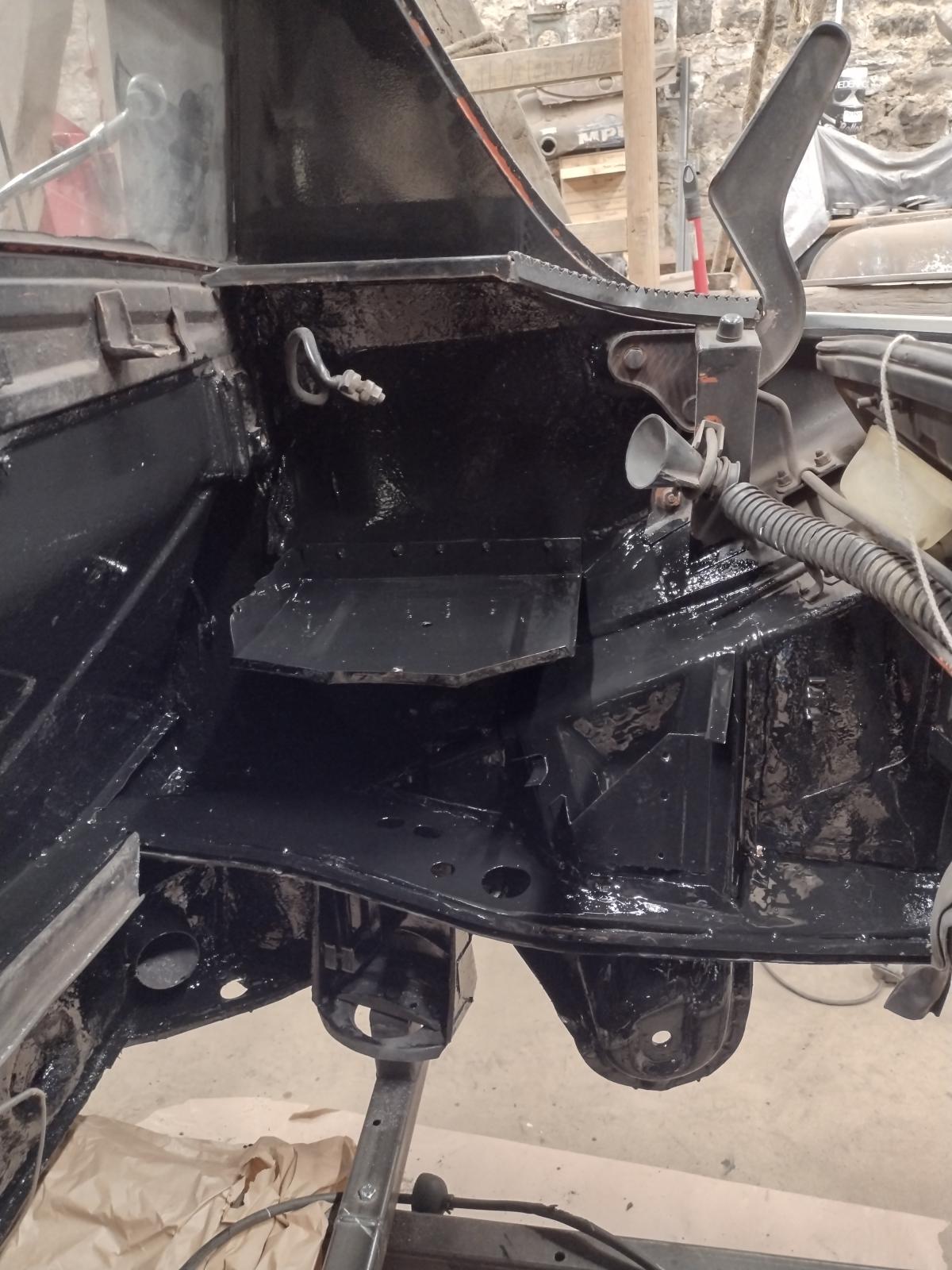

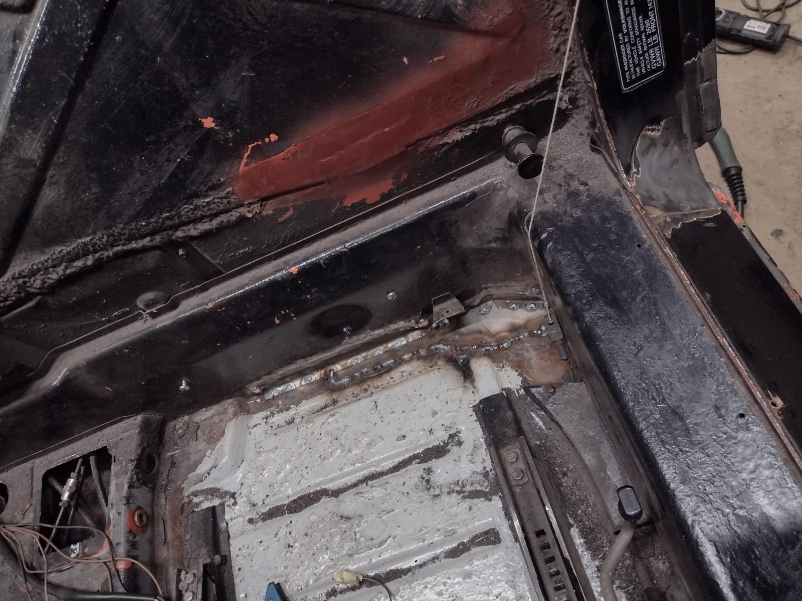

Then some repair on the inner firewall:
(IMG:http://www.914world.com/bbs2/uploads_offsite/www.thesamba.com-24690-1645822671.18.jpg)
(IMG:http://www.914world.com/bbs2/uploads_offsite/www.thesamba.com-24690-1645822672.19.jpg)
(IMG:http://www.914world.com/bbs2/uploads_offsite/www.thesamba.com-24690-1645822672.20.jpg)

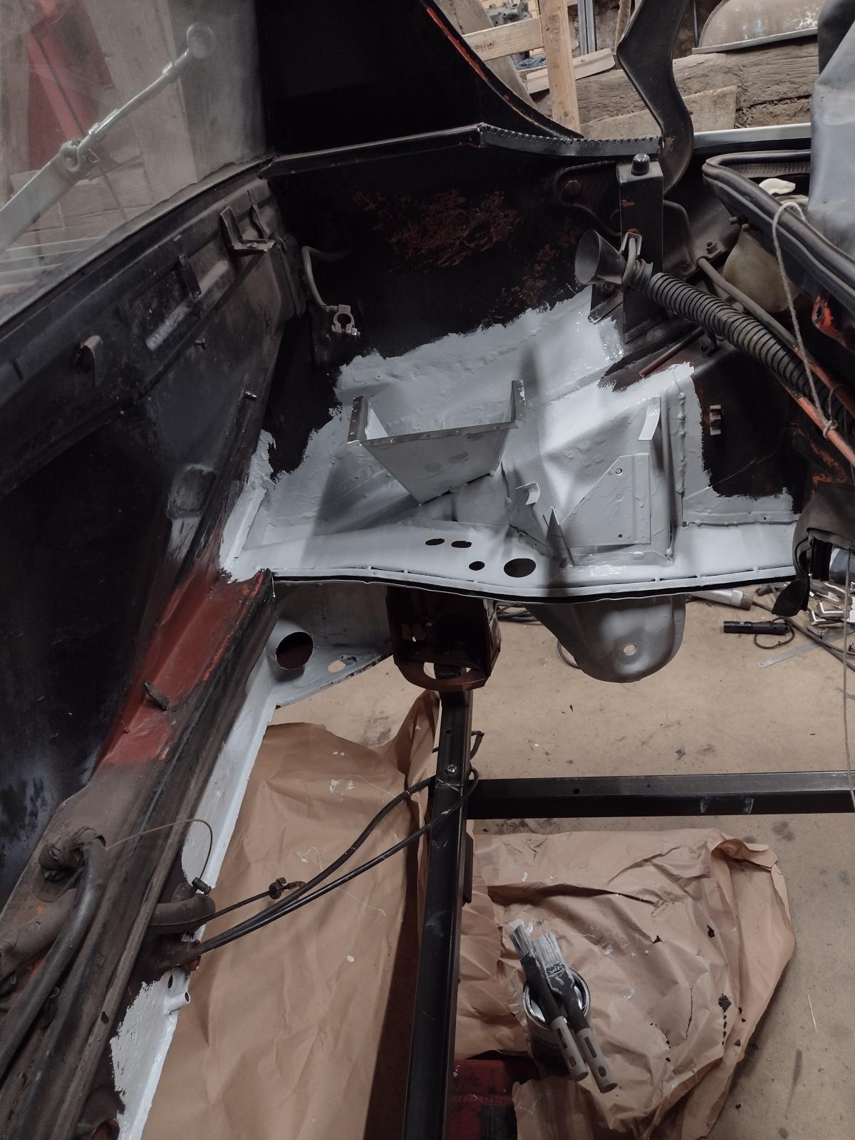

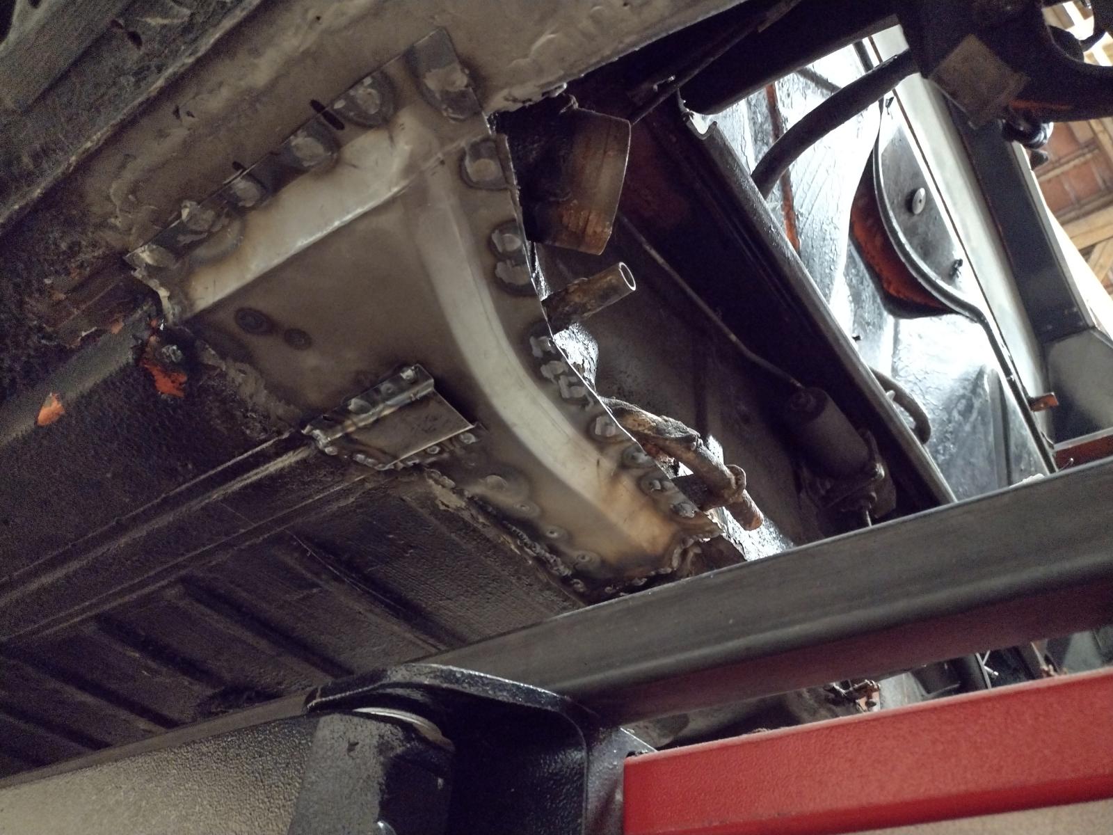

And the pan:
(IMG:http://www.914world.com/bbs2/uploads_offsite/www.thesamba.com-24690-1645822673.21.jpg)
(IMG:http://www.914world.com/bbs2/uploads_offsite/www.thesamba.com-24690-1645822673.22.jpg)
And its reinforcement:
(IMG:http://www.914world.com/bbs2/uploads_offsite/www.thesamba.com-24690-1645822673.23.jpg)
(IMG:http://www.914world.com/bbs2/uploads_offsite/www.thesamba.com-24690-1645822674.24.jpg)

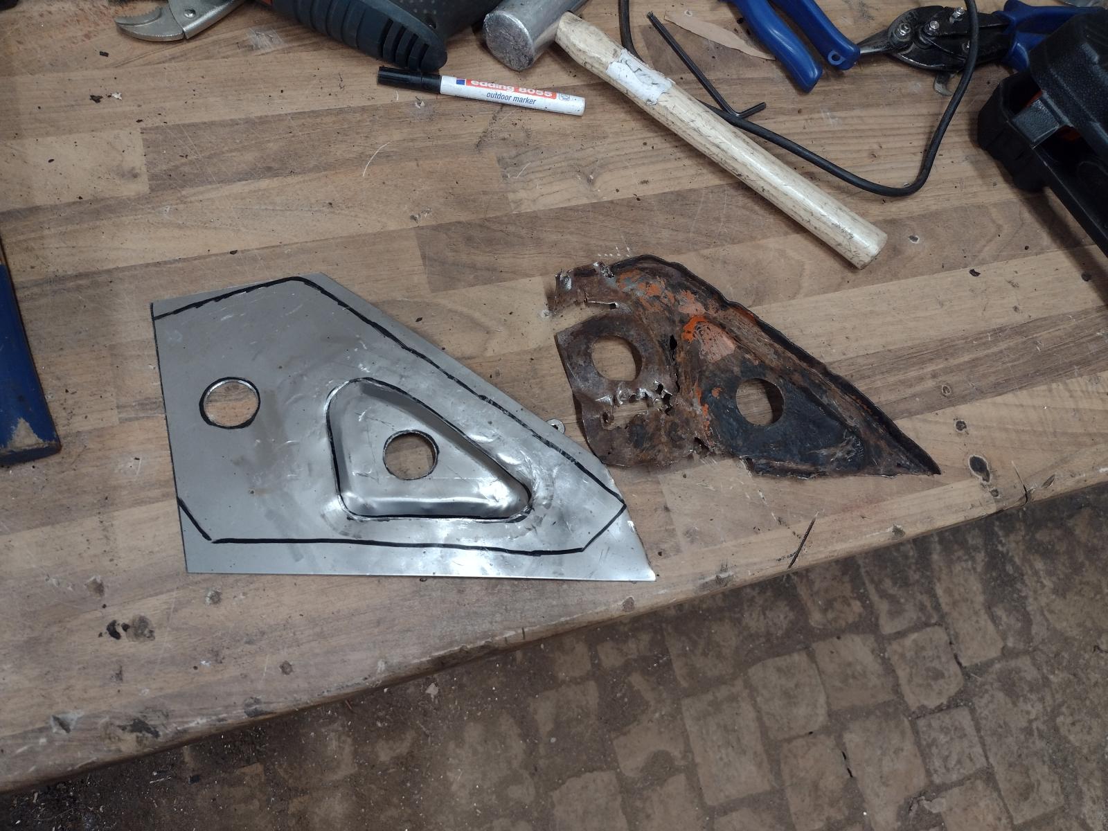

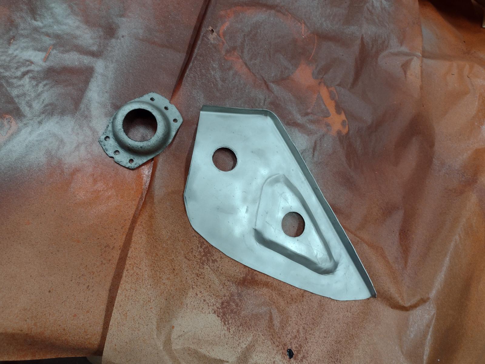

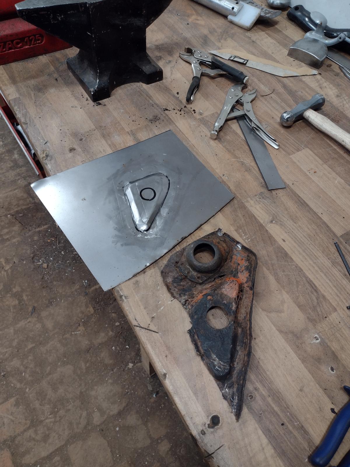

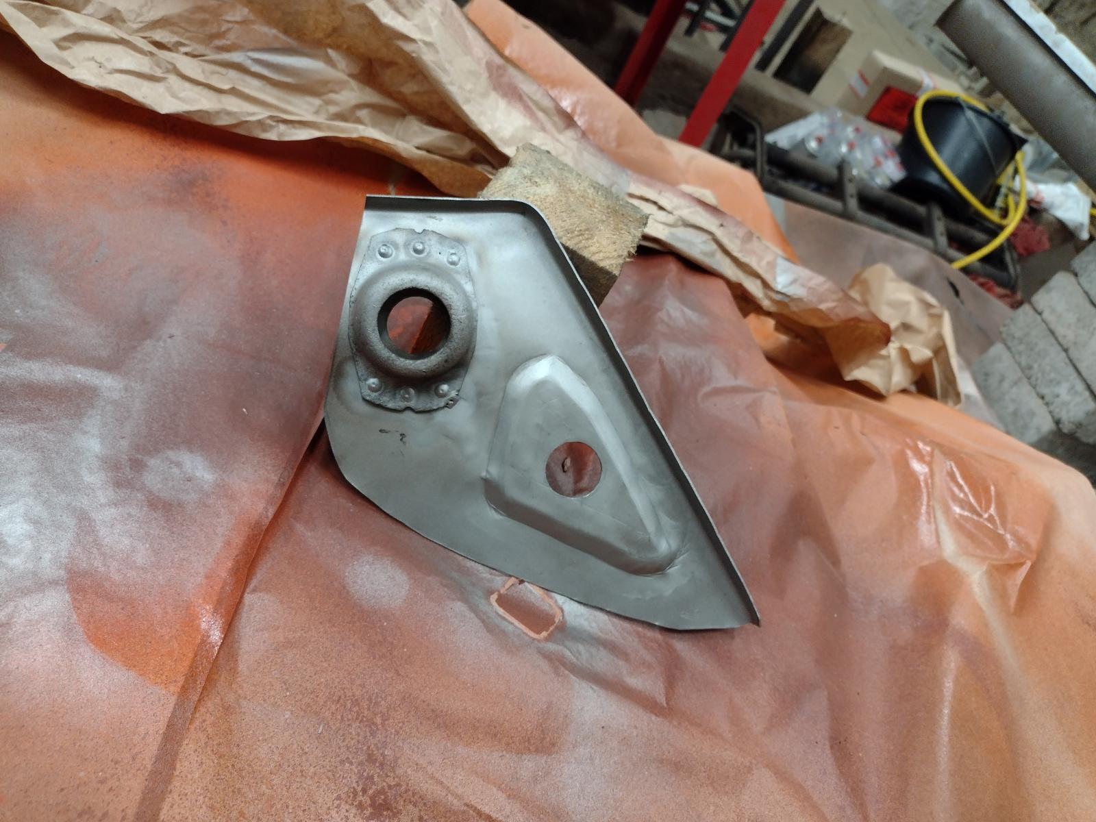

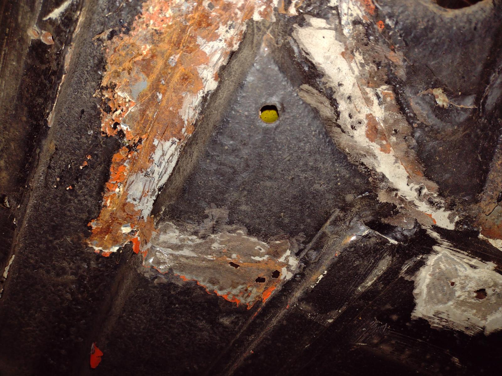

And the triangle, no chance to repair the old one so I made a new one:
(IMG:http://www.914world.com/bbs2/uploads_offsite/www.thesamba.com-24690-1645822675.25.jpg)
(IMG:http://www.914world.com/bbs2/uploads_offsite/www.thesamba.com-24690-1645822675.26.jpg)
(IMG:http://www.914world.com/bbs2/uploads_offsite/www.thesamba.com-24690-1645822676.27.jpg)
(IMG:http://www.914world.com/bbs2/uploads_offsite/www.thesamba.com-24690-1645822677.28.jpg)
(IMG:http://www.914world.com/bbs2/uploads_offsite/www.thesamba.com-24690-1645822677.29.jpg)
(IMG:http://www.914world.com/bbs2/uploads_offsite/www.thesamba.com-24690-1645822677.30.jpg)
(IMG:http://www.914world.com/bbs2/uploads_offsite/www.thesamba.com-24690-1645822678.31.jpg)

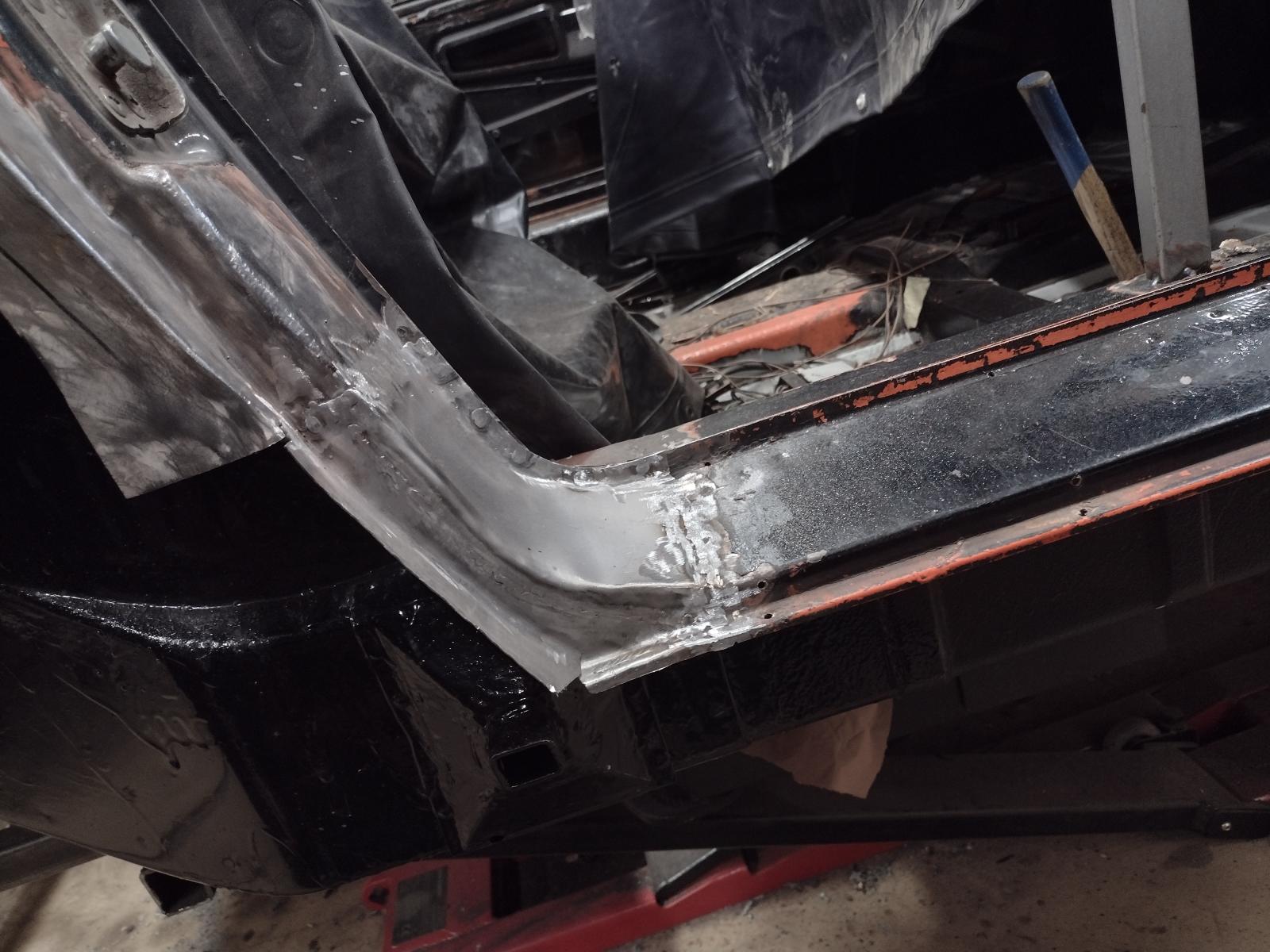

And that is one side done:
(IMG:http://www.914world.com/bbs2/uploads_offsite/www.thesamba.com-24690-1645822678.32.jpg)
Stay tuned
Antoine

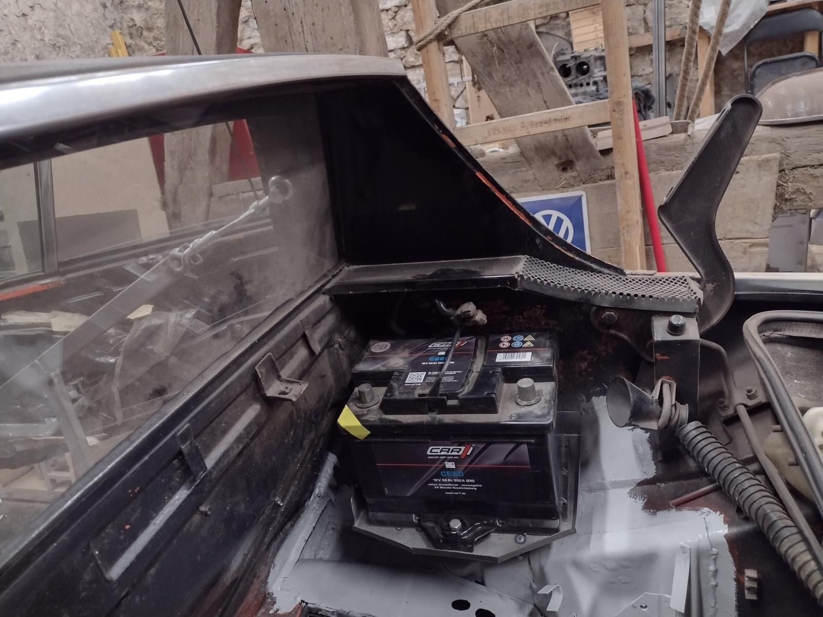

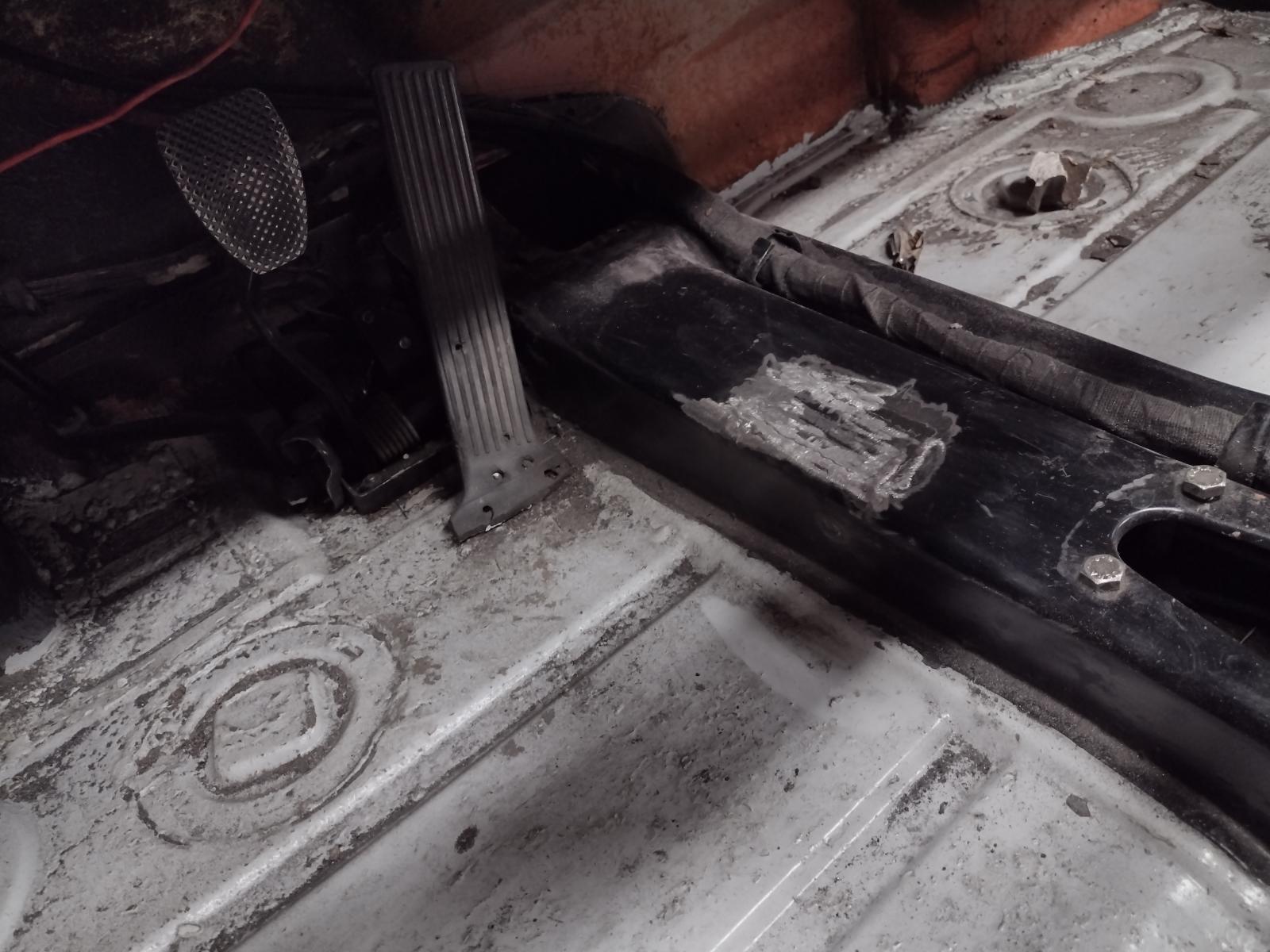

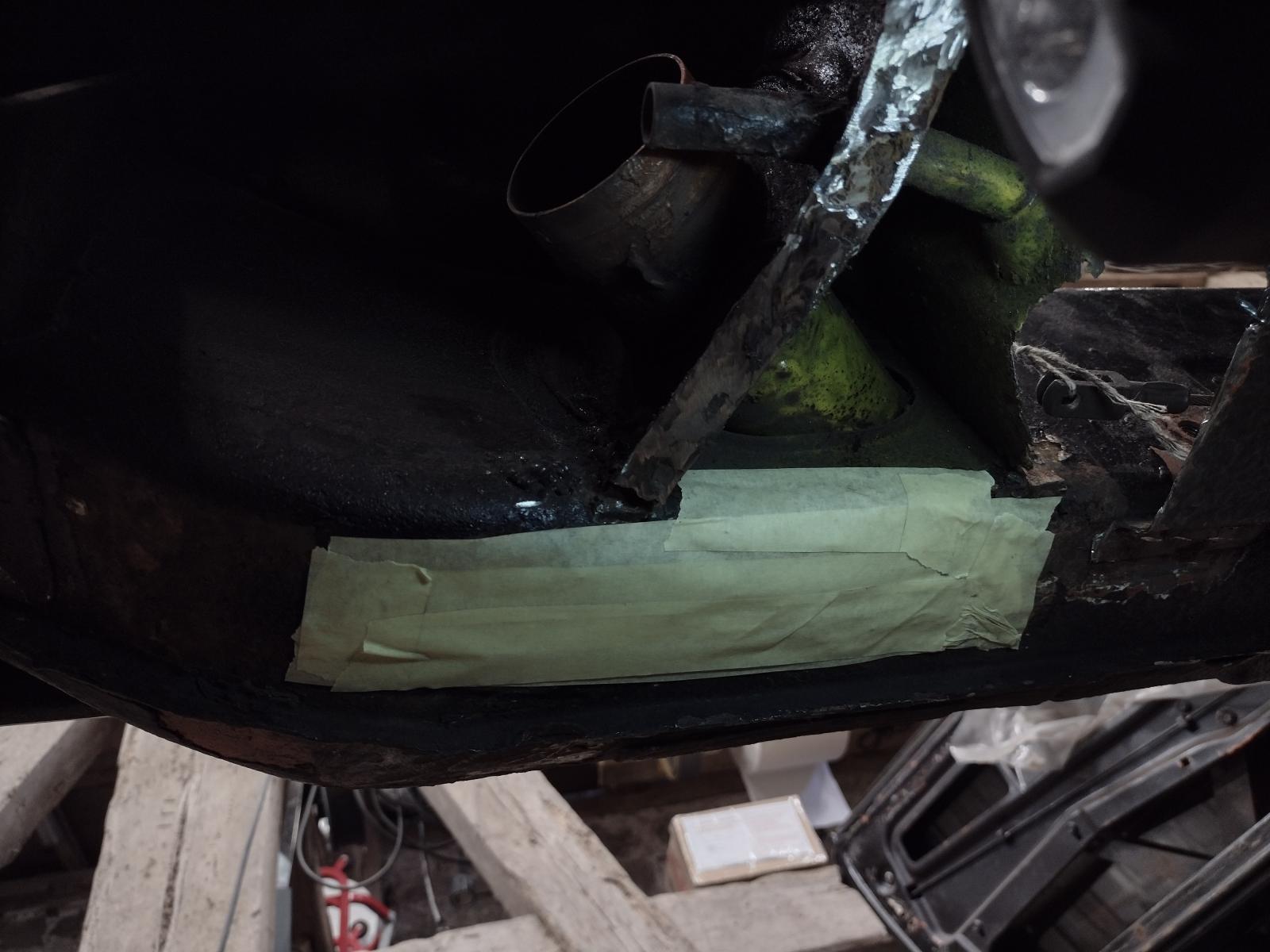

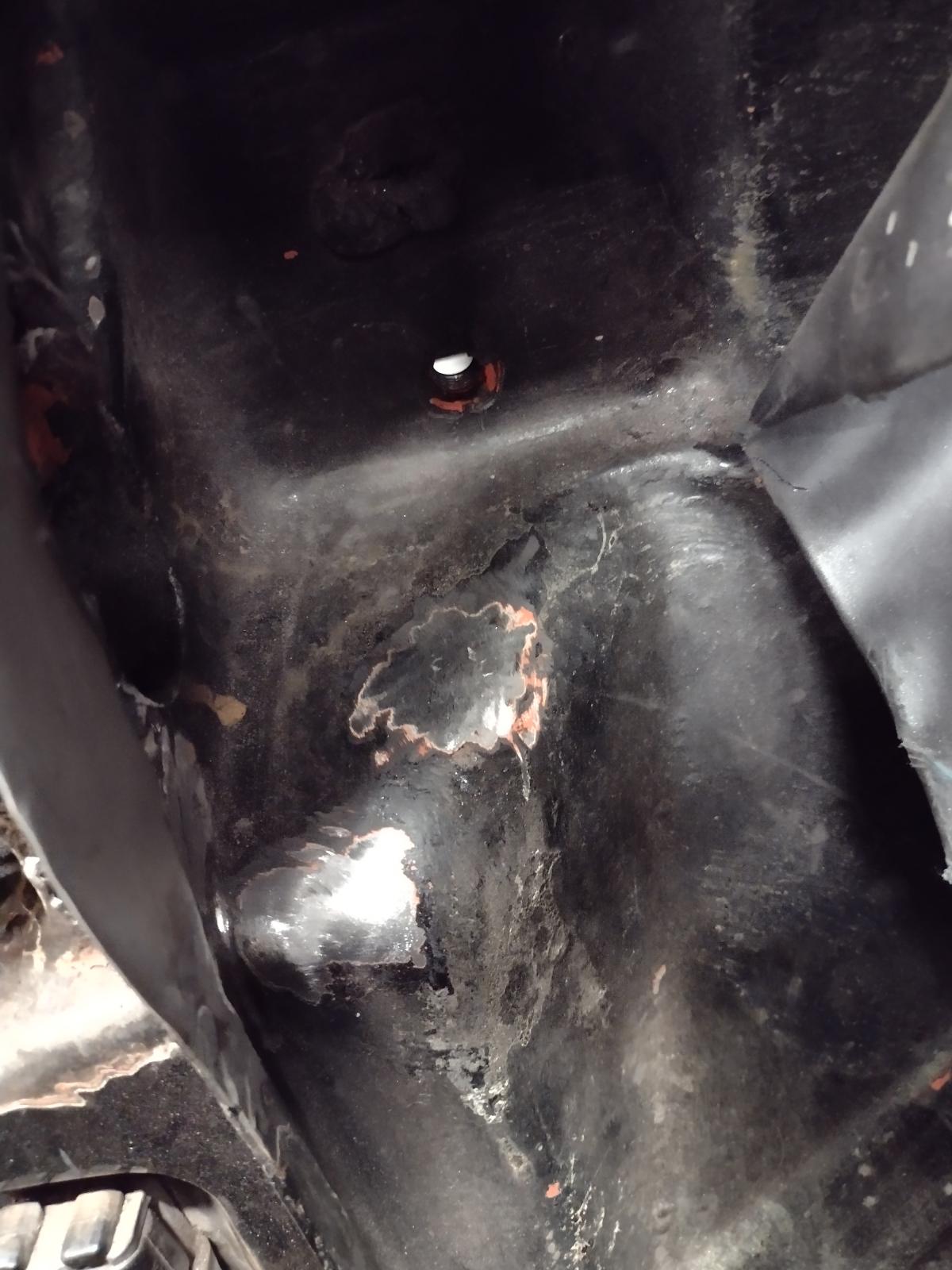

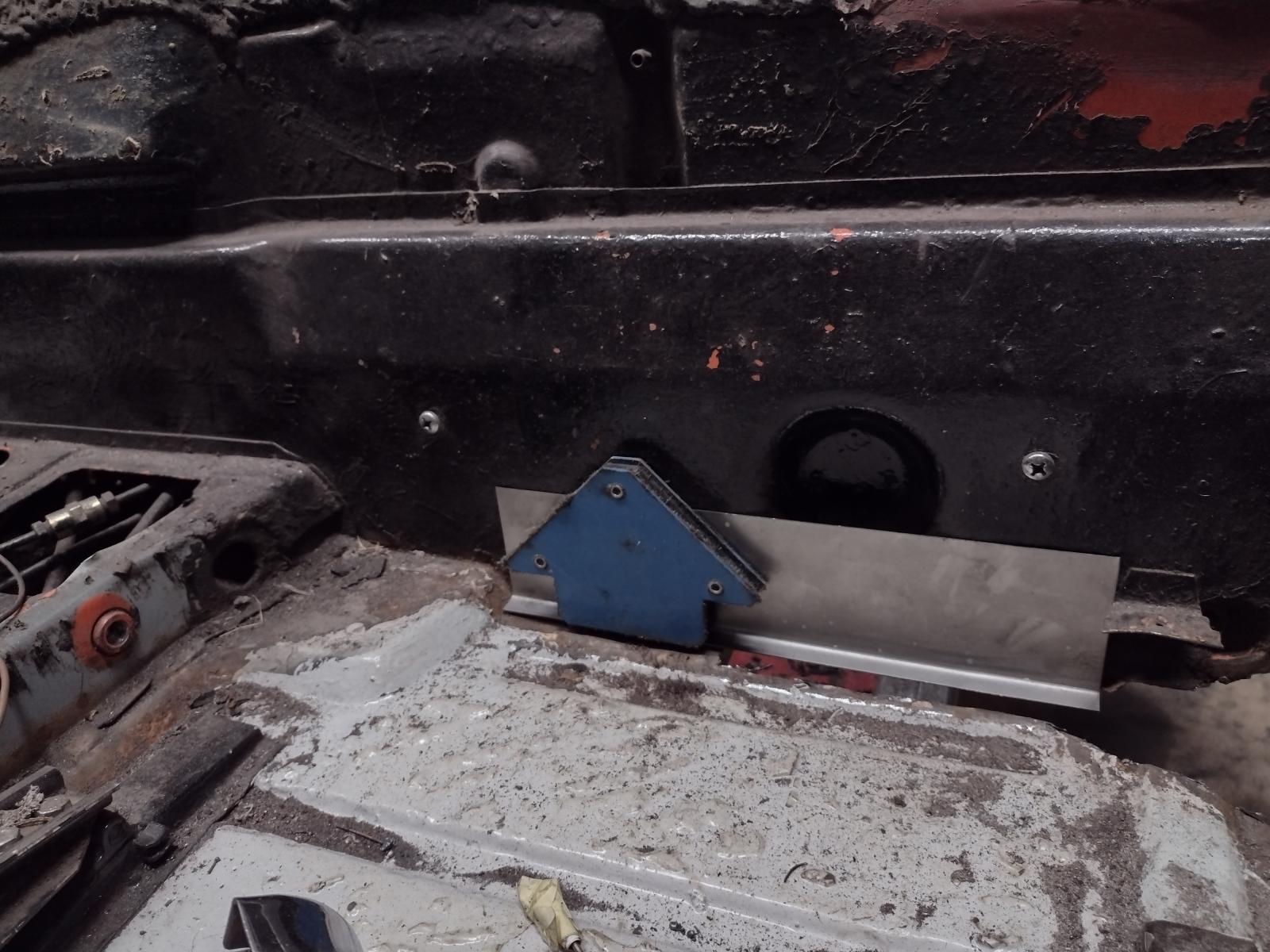

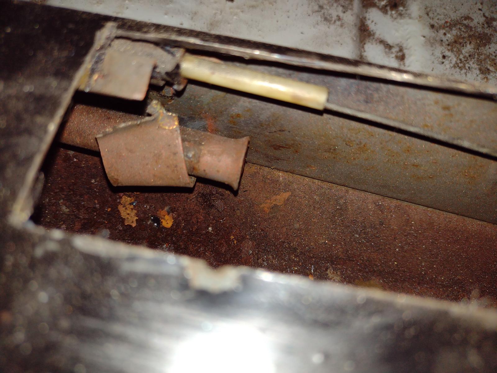

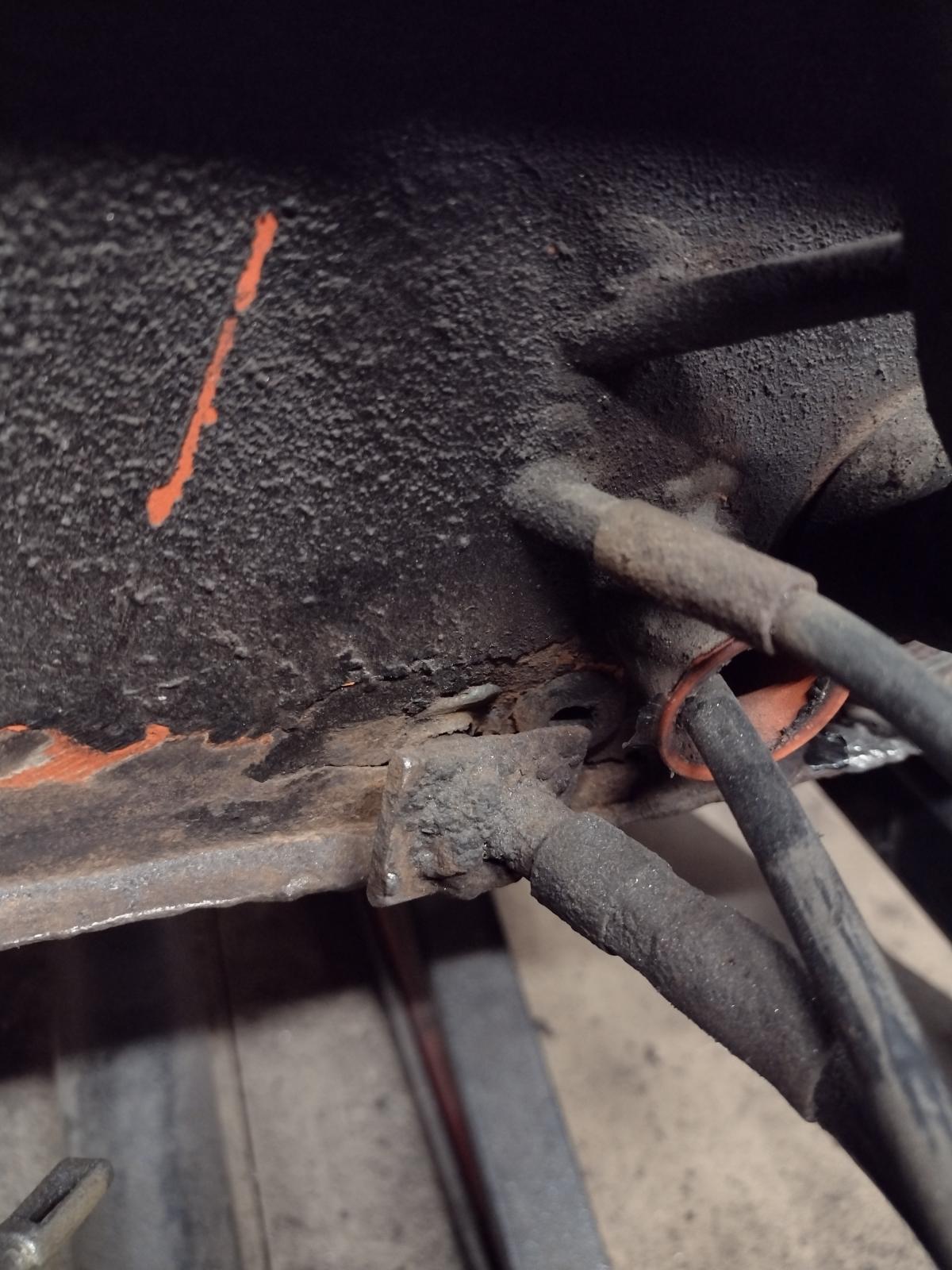

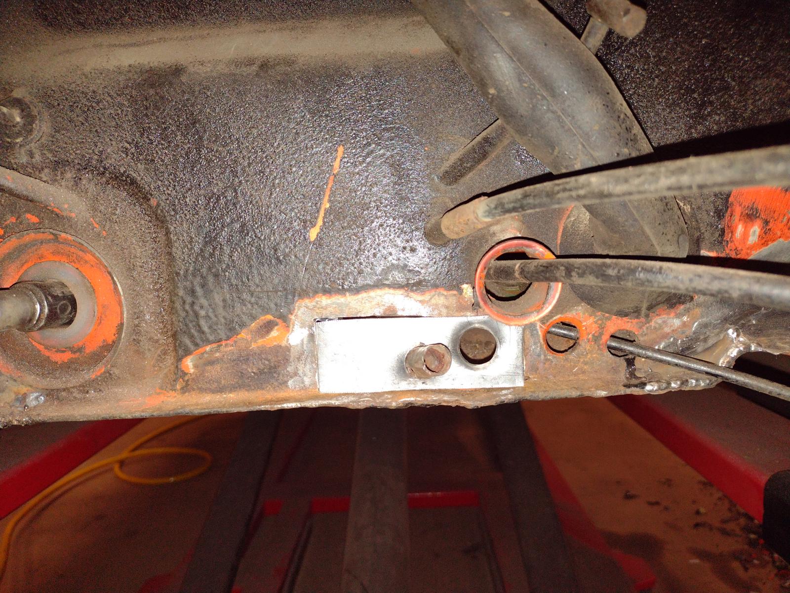

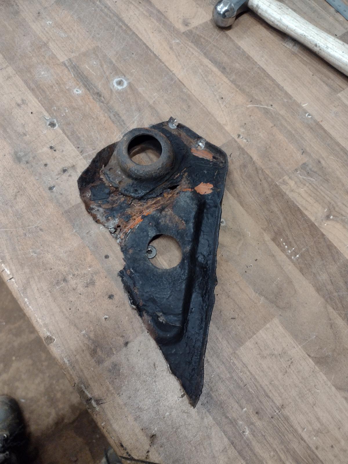

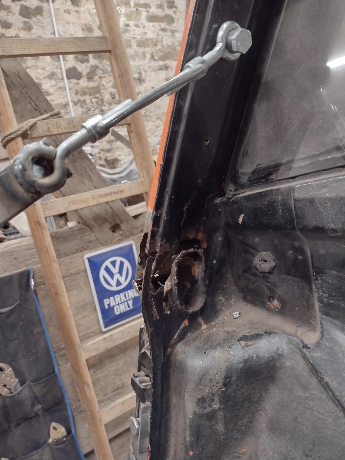

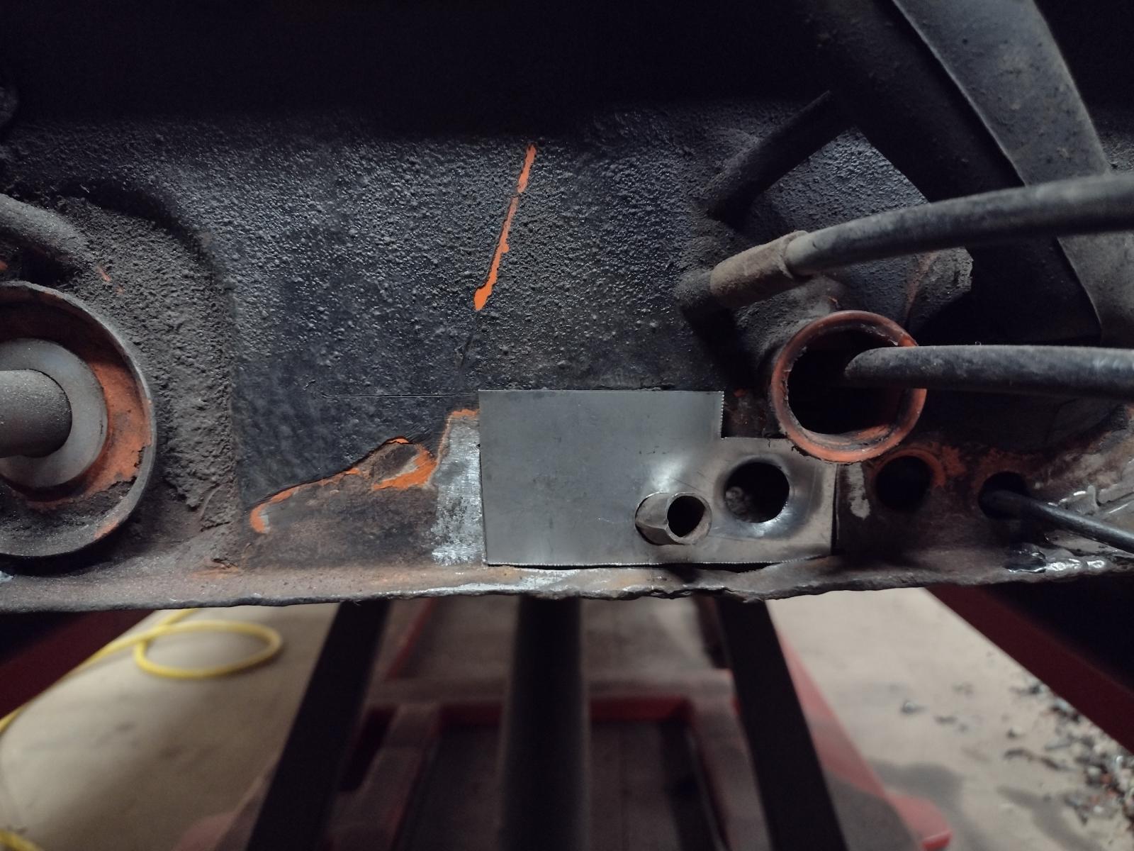

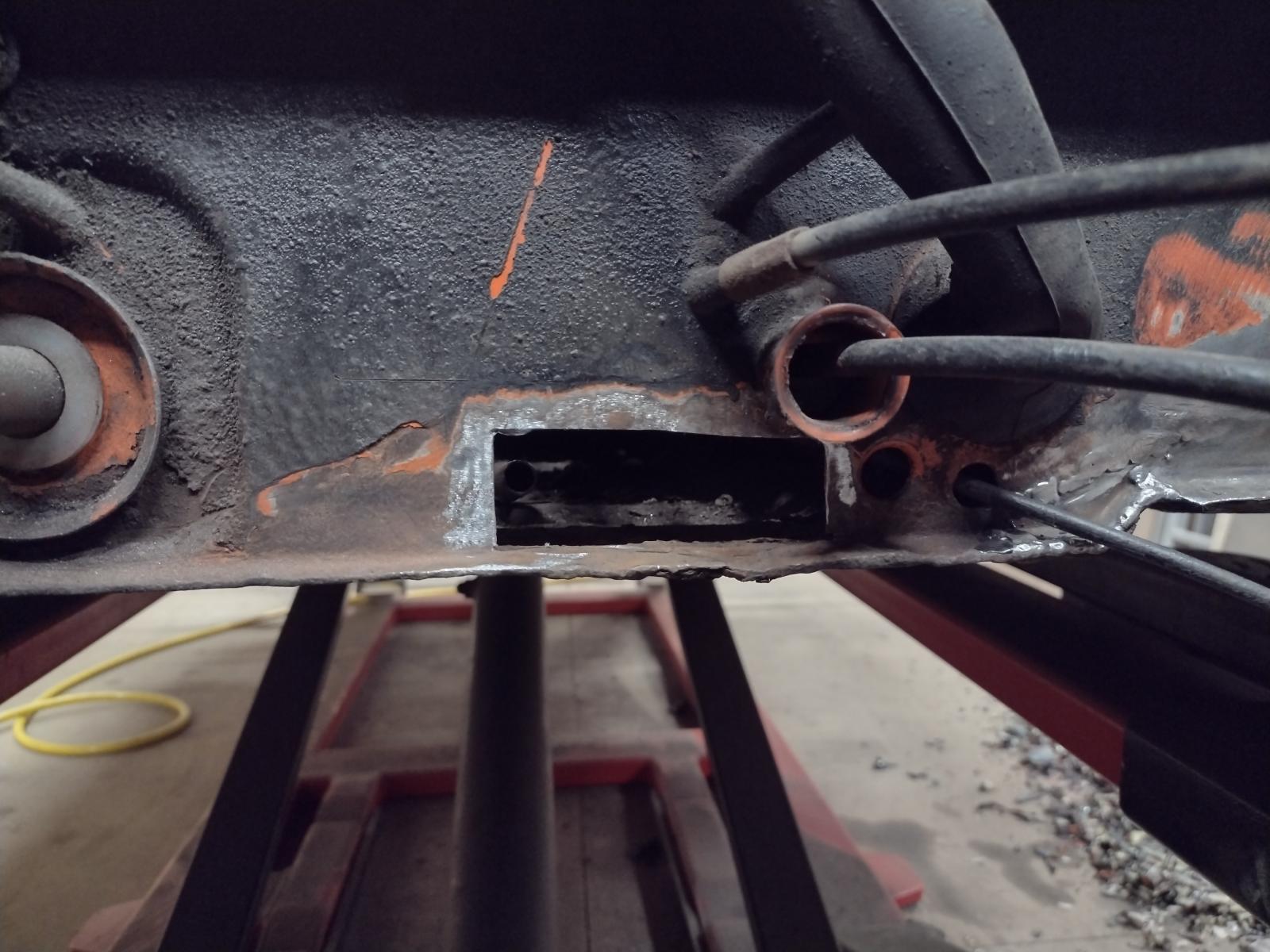

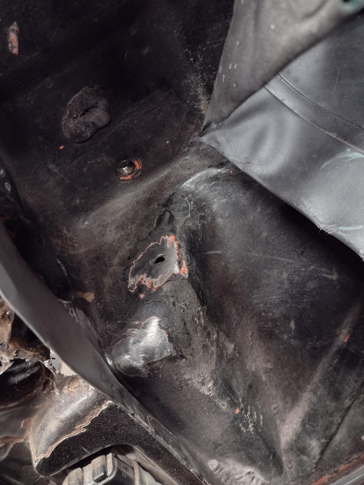

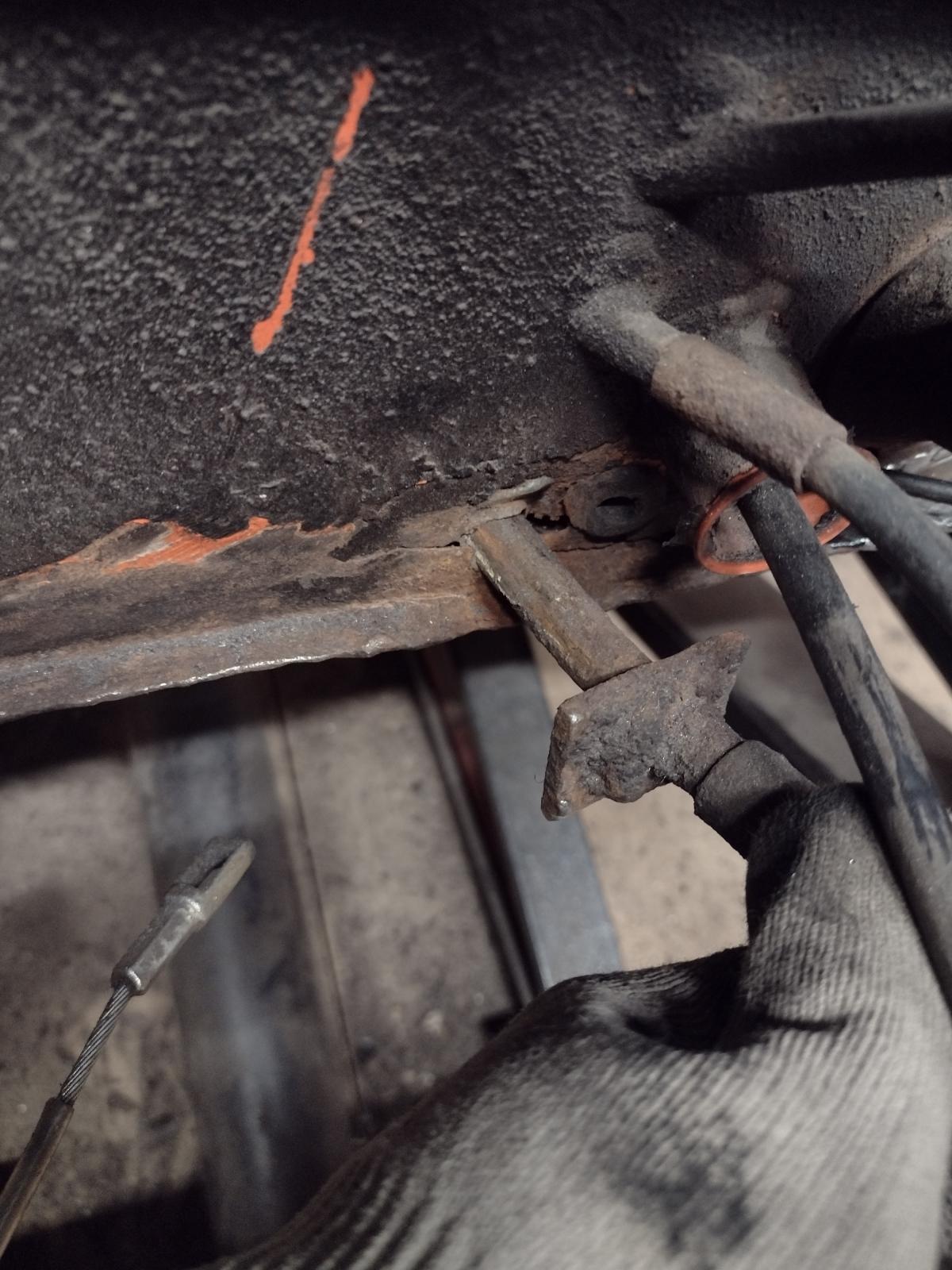

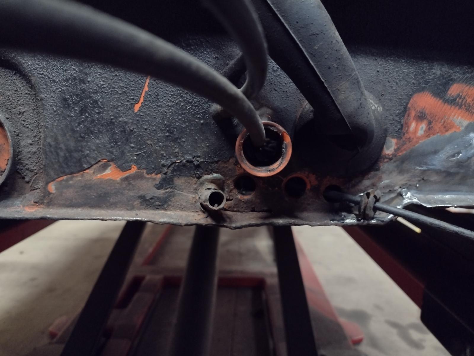

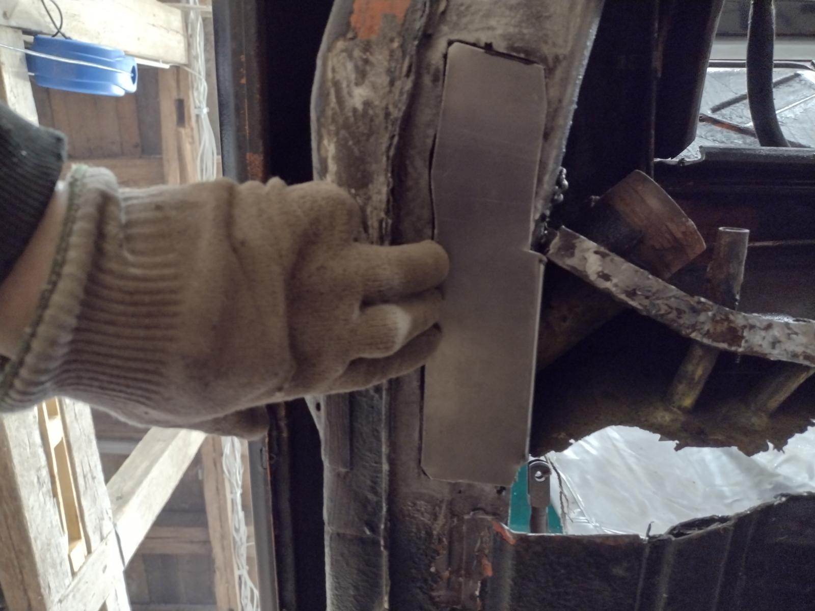

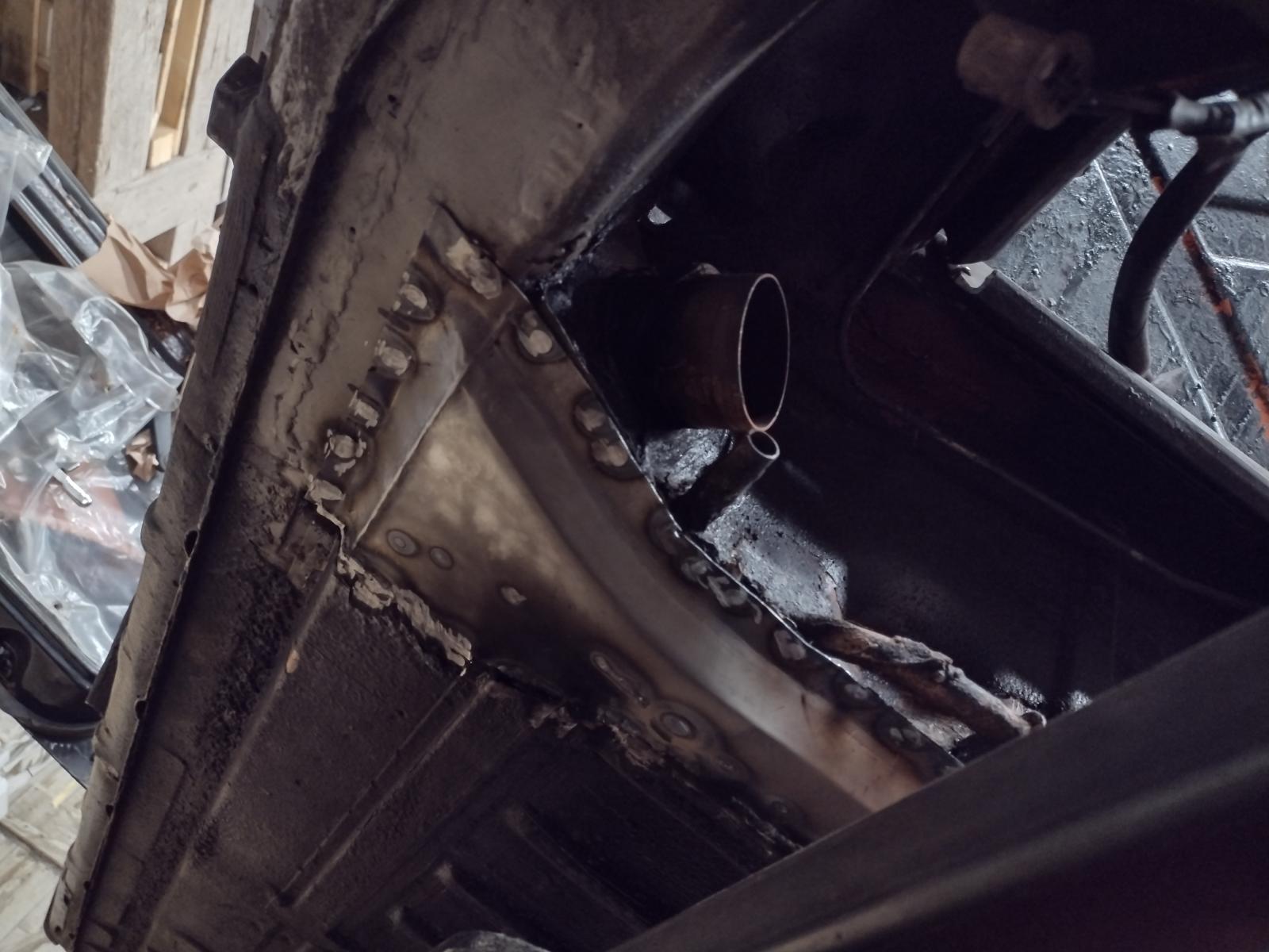

So, next I fixed the clutch tube.
First the part on the firewall, I don't know what a PO was thinking with this thick piece?!
(IMG:http://www.914world.com/bbs2/uploads_offsite/www.thesamba.com-24690-1646298836.1.jpg)
(IMG:http://www.914world.com/bbs2/uploads_offsite/www.thesamba.com-24690-1646298837.2.jpg)
So I removed it and found a damaged firewall:
(IMG:http://www.914world.com/bbs2/uploads_offsite/www.thesamba.com-24690-1646298837.3.jpg)
So removing what is damaged:
(IMG:http://www.914world.com/bbs2/uploads_offsite/www.thesamba.com-24690-1646298838.4.jpg)
Making the patch:
(IMG:http://www.914world.com/bbs2/uploads_offsite/www.thesamba.com-24690-1646298838.5.jpg)
Adjusting:
(IMG:http://www.914world.com/bbs2/uploads_offsite/www.thesamba.com-24690-1646298838.6.jpg)
Welded:
(IMG:http://www.914world.com/bbs2/uploads_offsite/www.thesamba.com-24690-1646298838.7.jpg)

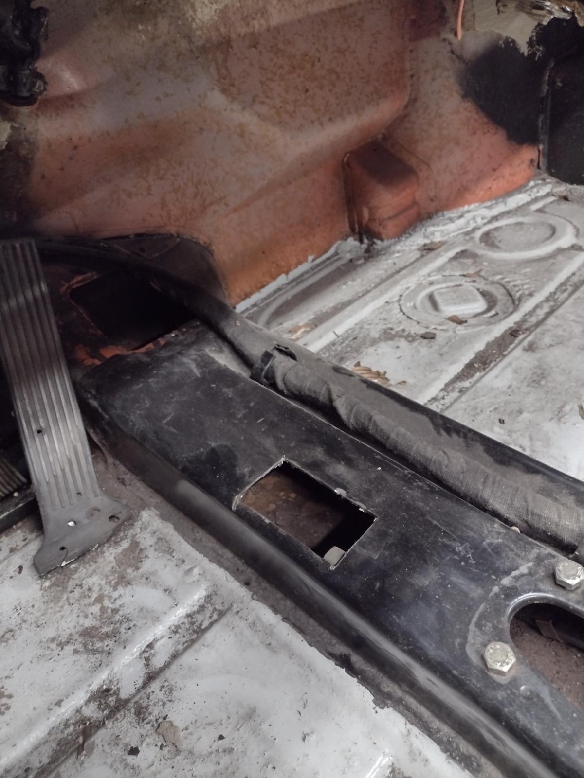

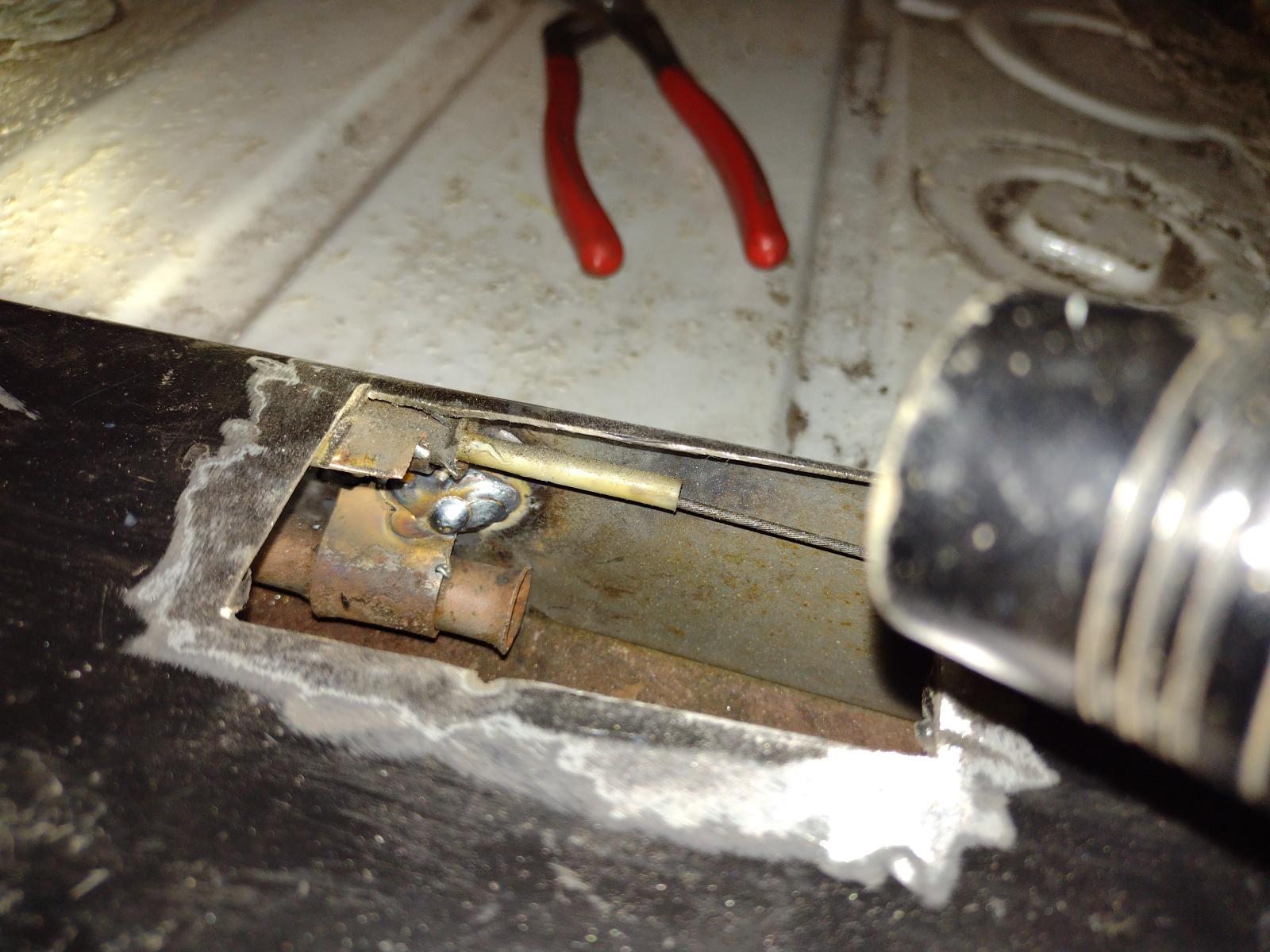

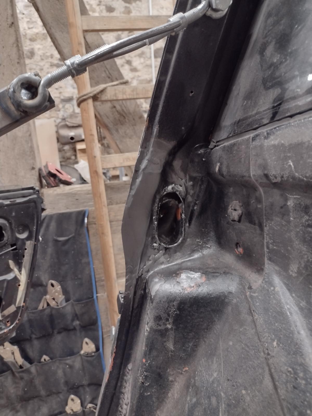

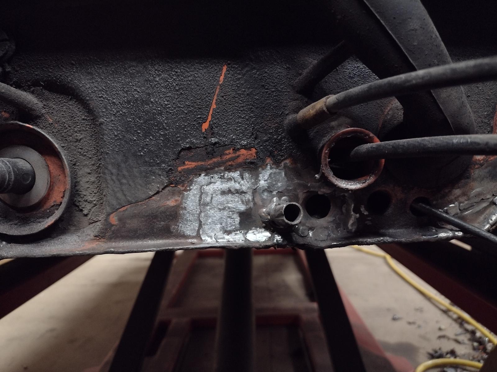

And the front fixation, cut the access :
(IMG:http://www.914world.com/bbs2/uploads_offsite/www.thesamba.com-24690-1646298839.8.jpg)
The issue:
(IMG:http://www.914world.com/bbs2/uploads_offsite/www.thesamba.com-24690-1646298839.9.jpg)
Welded (pic was ongoing, I welded the whole length but forgot to take a picture):
(IMG:http://www.914world.com/bbs2/uploads_offsite/www.thesamba.com-24690-1646298840.10.jpg)
And closed:
(IMG:http://www.914world.com/bbs2/uploads_offsite/www.thesamba.com-24690-1646298840.11.jpg)
Stay tuned
Antoine

At this phase in their life the clutch tube failures are pretty common.
This is so common with 914's. Prior owners attempt to fix but they only look at the symptom (the cracked bulkhead) and then slap a "fix" onto it. Meanwhile they never address the root cause (the broken clutch tube restraint) that is leading to all the flexing in the 1st place.
Nice job fixing the clutch tube at both ends! It will be good to go for decades!

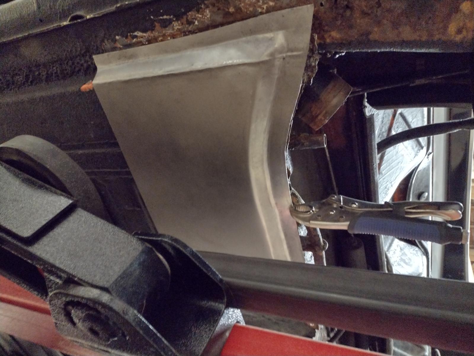

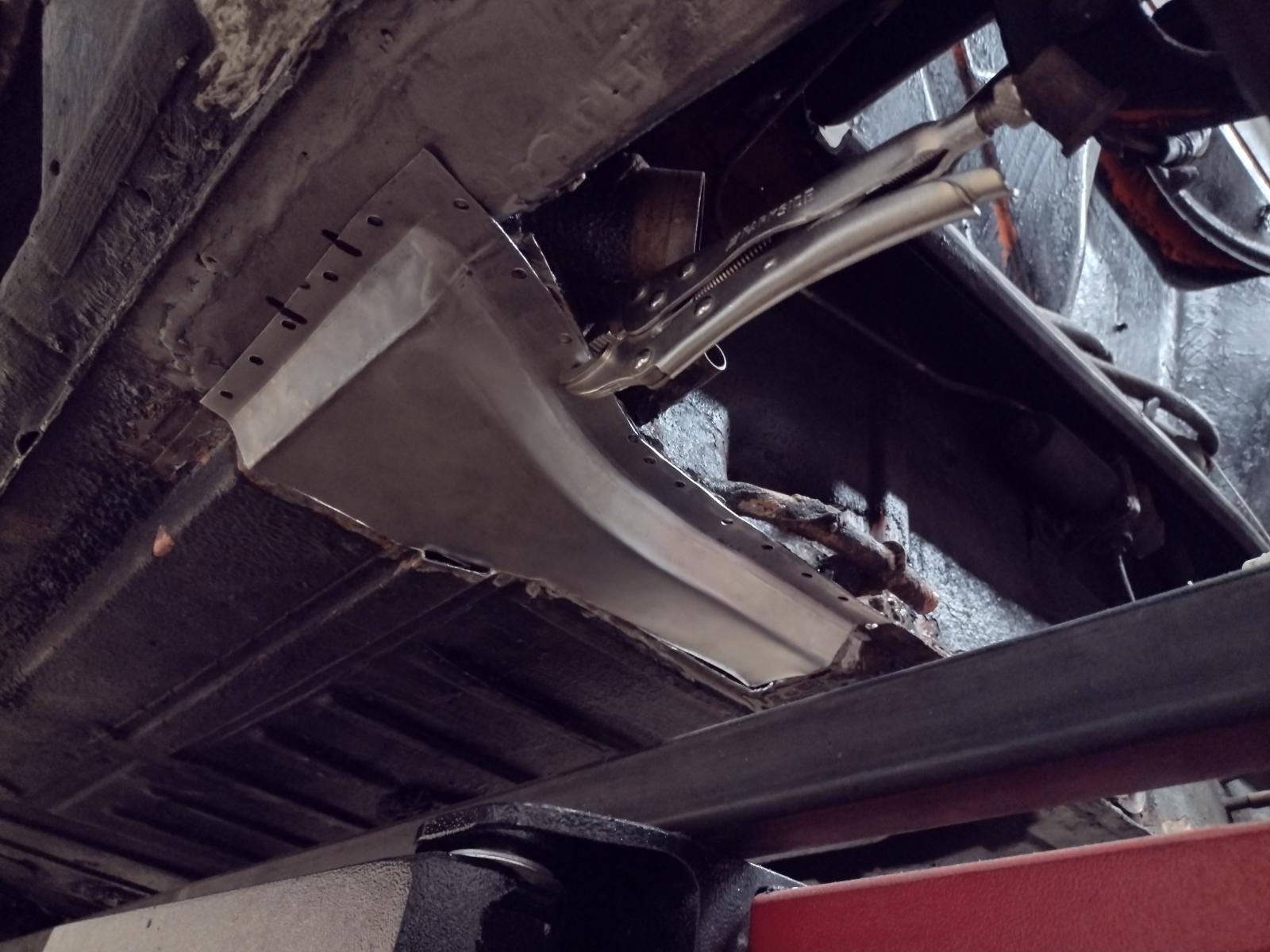

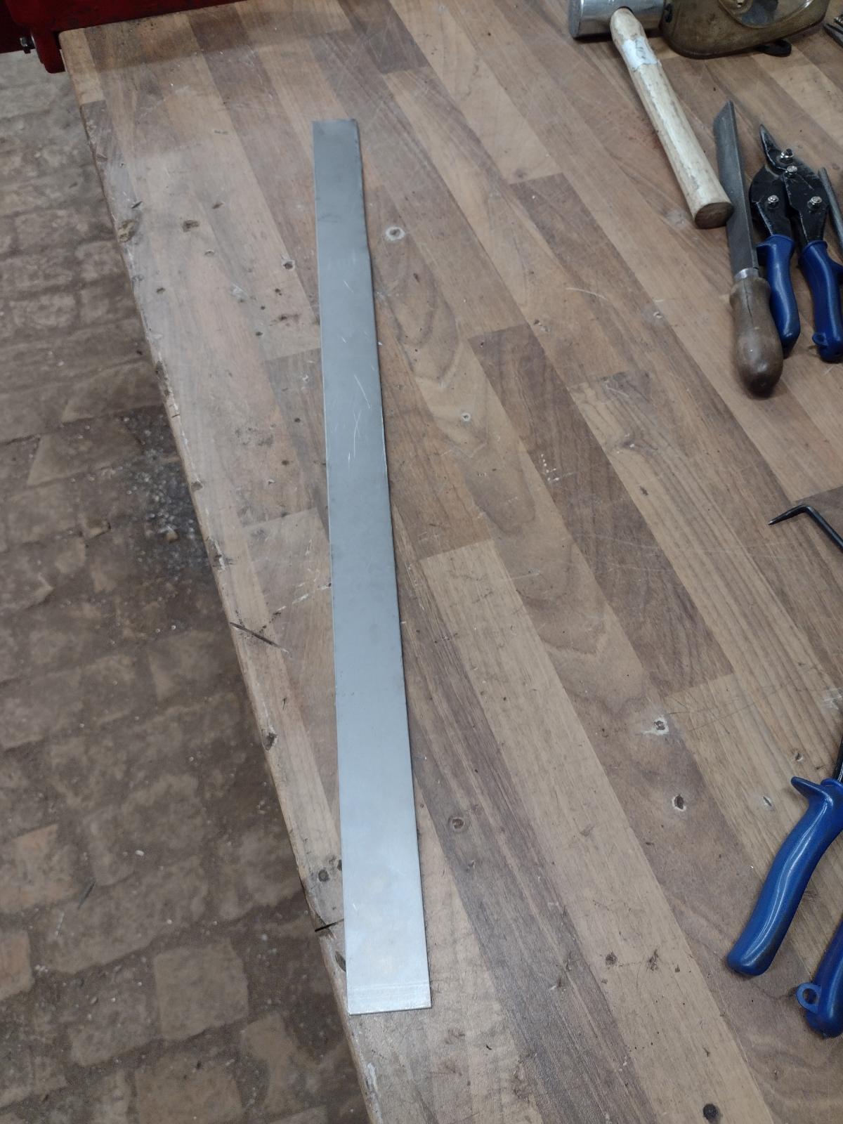

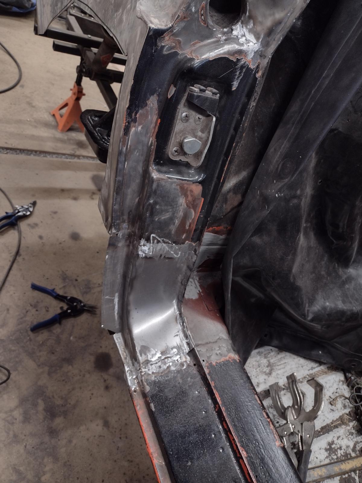

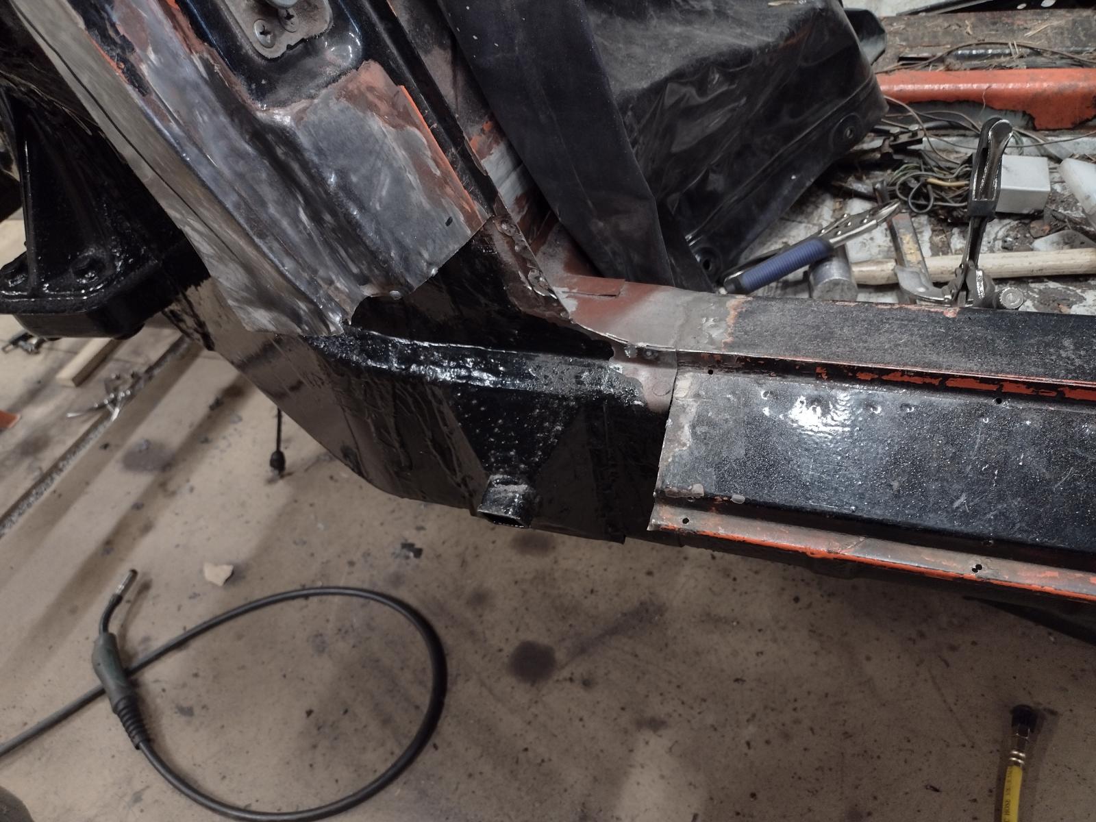

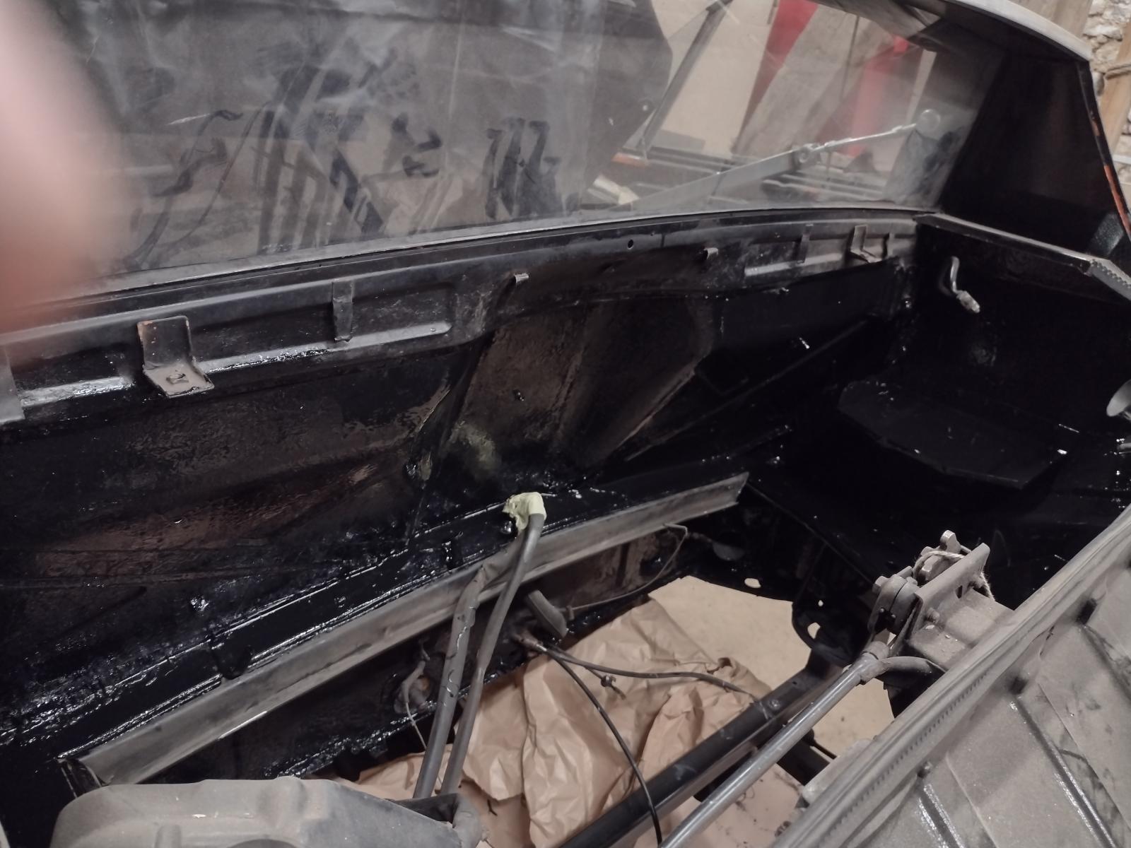

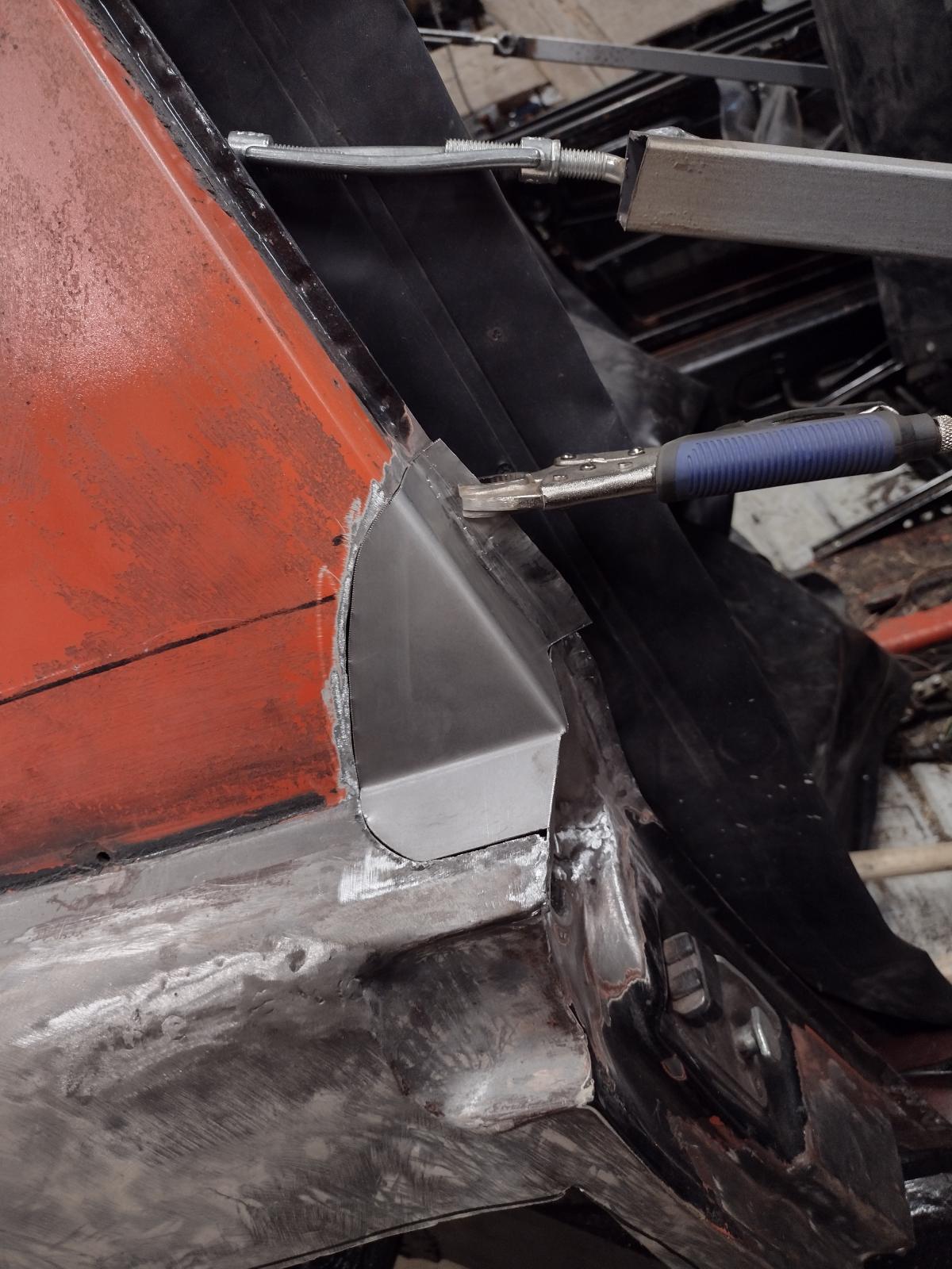

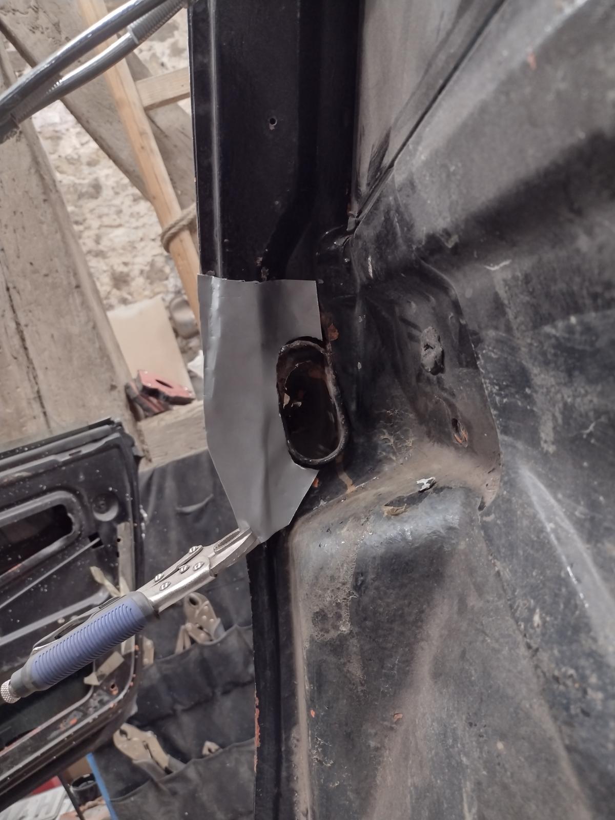

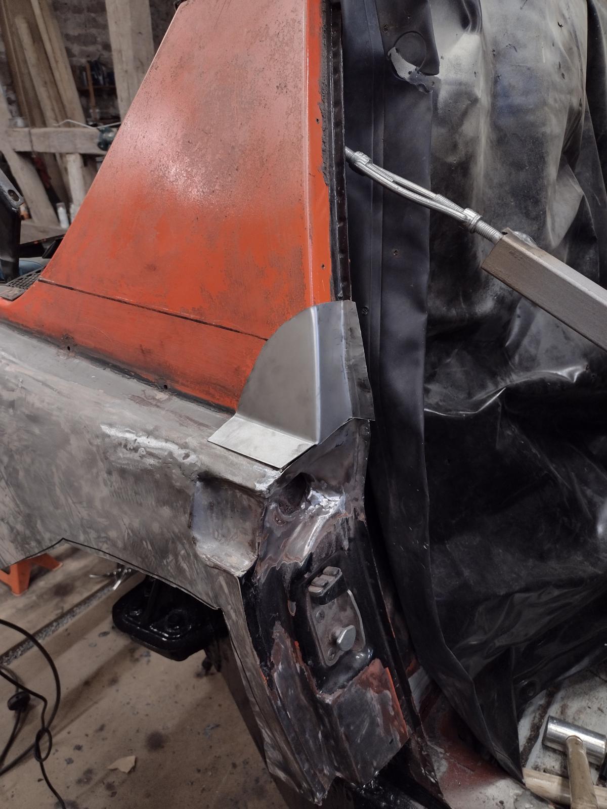

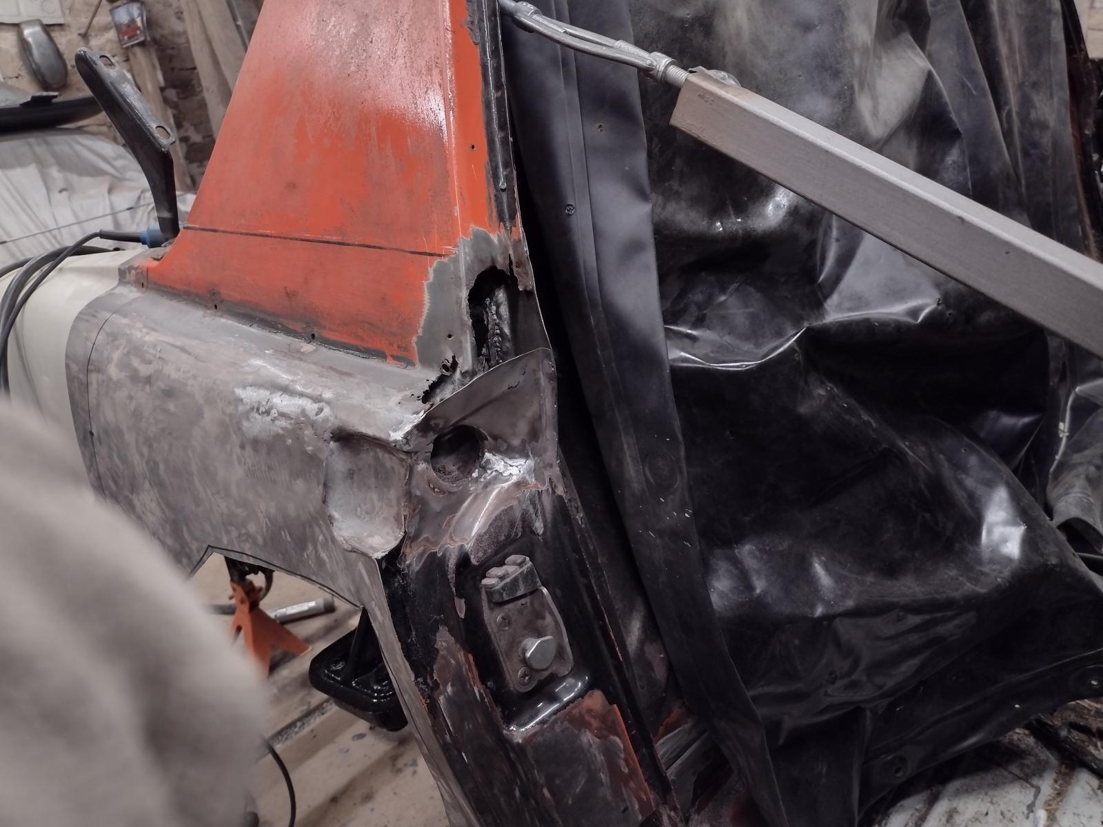

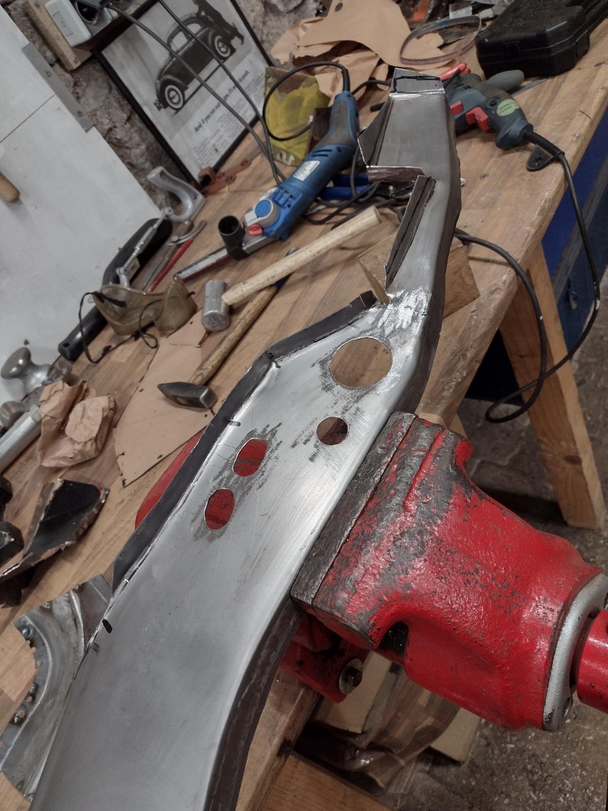

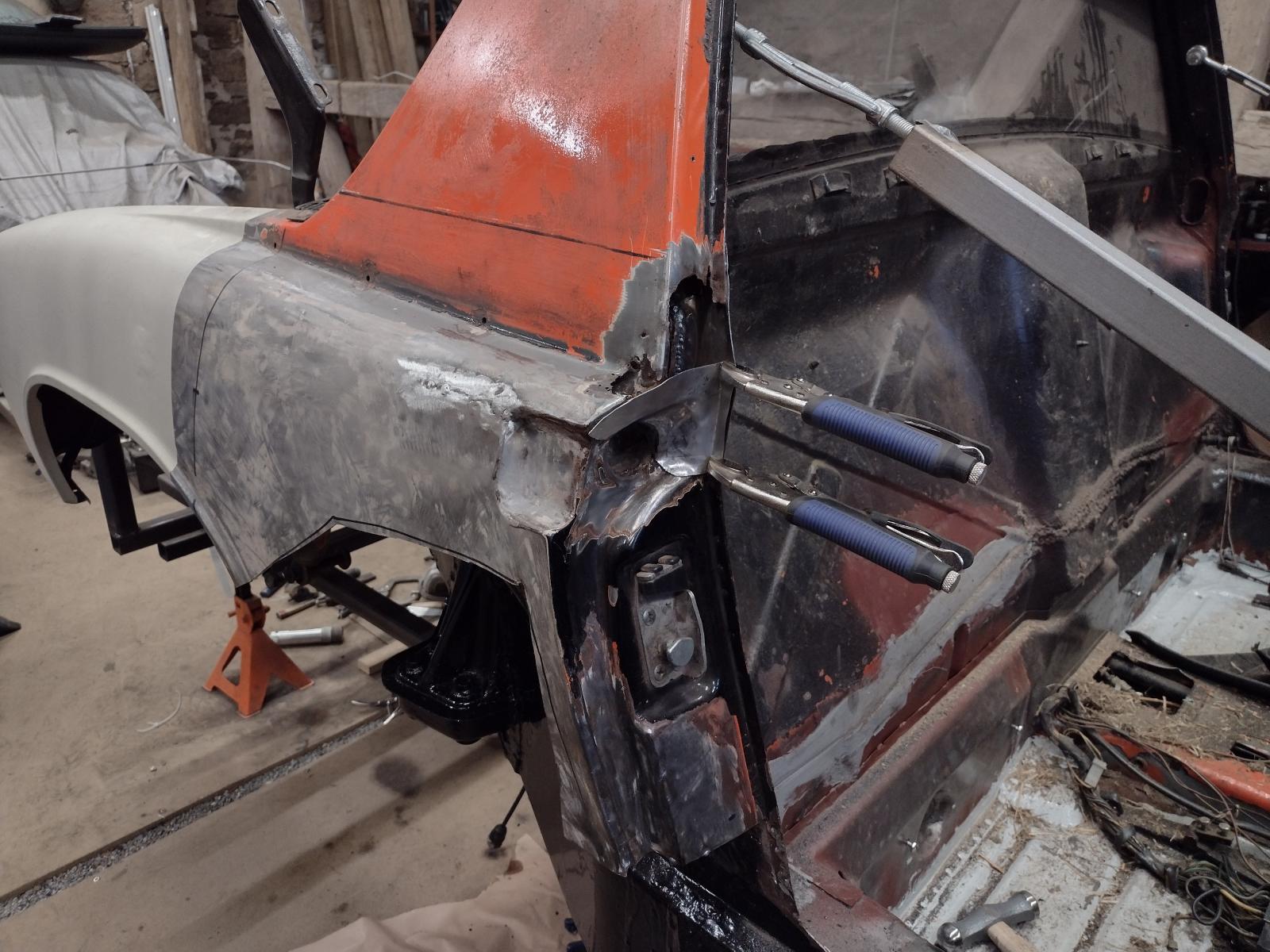

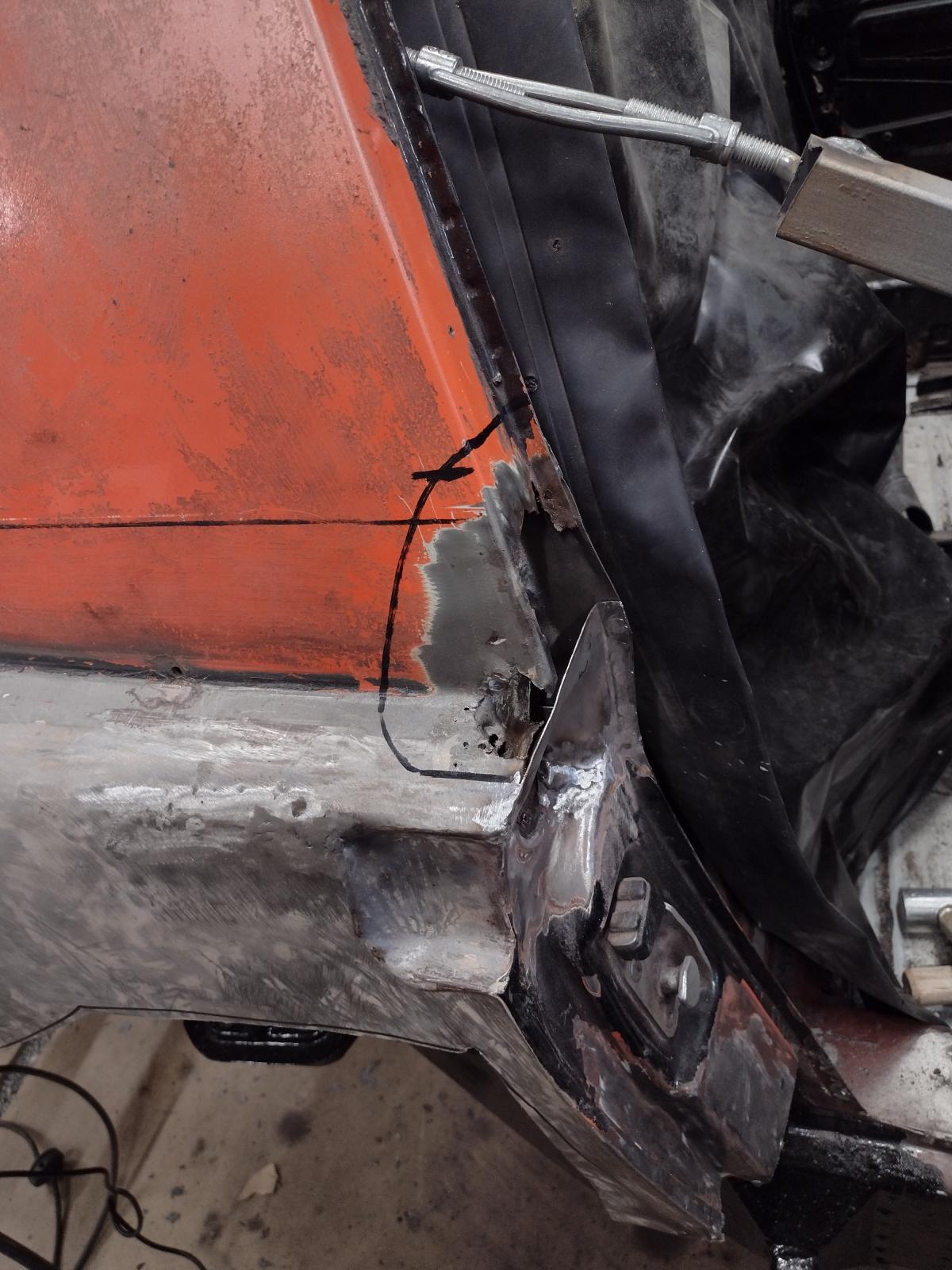

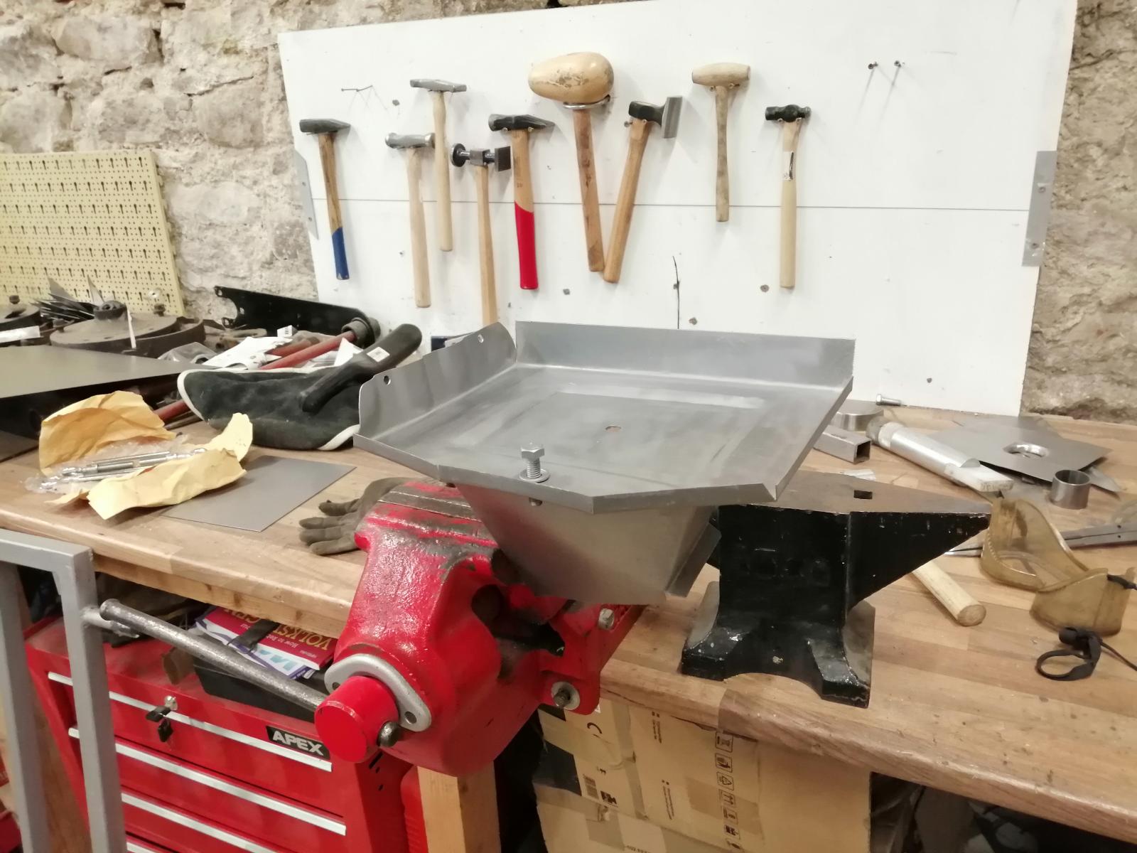

So, I then worked on my engine side panel:
Adjusting:
(IMG:http://www.914world.com/bbs2/uploads_offsite/www.thesamba.com-24690-1646909462.1.jpg)
Then the necessary holes:
(IMG:http://www.914world.com/bbs2/uploads_offsite/www.thesamba.com-24690-1646909463.2.jpg)
(IMG:http://www.914world.com/bbs2/uploads_offsite/www.thesamba.com-24690-1646909463.3.jpg)
Then the sealing guide:
(IMG:http://www.914world.com/bbs2/uploads_offsite/www.thesamba.com-24690-1646909464.4.jpg)
(IMG:http://www.914world.com/bbs2/uploads_offsite/www.thesamba.com-24690-1646909465.5.jpg)
(IMG:http://www.914world.com/bbs2/uploads_offsite/www.thesamba.com-24690-1646909465.6.jpg)
A before-after:
(IMG:http://www.914world.com/bbs2/uploads_offsite/www.thesamba.com-24690-1646909466.7.jpg)
And in place :
(IMG:http://www.914world.com/bbs2/uploads_offsite/www.thesamba.com-24690-1646909466.8.jpg)
Bests
Antoine

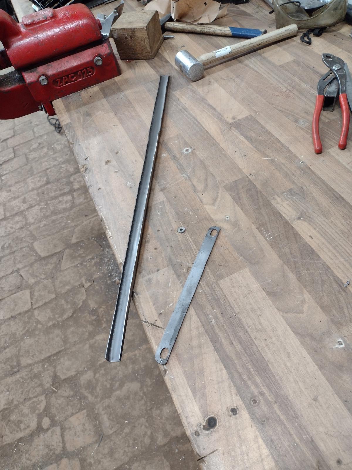

So, I think the next step was quite logical..the battery tray (IMG:style_emoticons/default/biggrin.gif)
I did built it by hand couple months ago:
(IMG:http://www.914world.com/bbs2/uploads_offsite/www.thesamba.com-24690-1648639737.1.jpg)
So it was time to adjust and weld it, first the bottom part:
(IMG:http://www.914world.com/bbs2/uploads_offsite/www.thesamba.com-24690-1648639738.2.jpg)
And then the top:
(IMG:http://www.914world.com/bbs2/uploads_offsite/www.thesamba.com-24690-1648639738.3.jpg)
(IMG:http://www.914world.com/bbs2/uploads_offsite/www.thesamba.com-24690-1648639738.4.jpg)
All done and all fits great:
(IMG:http://www.914world.com/bbs2/uploads_offsite/www.thesamba.com-24690-1648639739.5.jpg)
I then found one last hole on the firewall:
(IMG:http://www.914world.com/bbs2/uploads_offsite/www.thesamba.com-24690-1648639739.6.jpg)
That I welded close:
(IMG:http://www.914world.com/bbs2/uploads_offsite/www.thesamba.com-24690-1648639739.7.jpg)
And now we have a nice engine bay/right long:
(IMG:http://www.914world.com/bbs2/uploads_offsite/www.thesamba.com-24690-1648639740.8.jpg)
(IMG:http://www.914world.com/bbs2/uploads_offsite/www.thesamba.com-24690-1648639740.9.jpg)
Starting to look good!
Antoine

I have more to share with you (IMG:style_emoticons/default/biggrin.gif)
This corner was ugly:
(IMG:http://www.914world.com/bbs2/uploads_offsite/www.thesamba.com-24690-1648808514.1.jpg)
So I decided to take care of it:
(IMG:http://www.914world.com/bbs2/uploads_offsite/www.thesamba.com-24690-1648808514.2.jpg)
And welded:
(IMG:http://www.914world.com/bbs2/uploads_offsite/www.thesamba.com-24690-1648808515.3.jpg)
And the outside part, before:
(IMG:http://www.914world.com/bbs2/uploads_offsite/www.thesamba.com-24690-1648808515.4.jpg)
Starting with the bottom part:
(IMG:http://www.914world.com/bbs2/uploads_offsite/www.thesamba.com-24690-1648808515.5.jpg)
(IMG:http://www.914world.com/bbs2/uploads_offsite/www.thesamba.com-24690-1648808516.6.jpg)
Welded:
(IMG:http://www.914world.com/bbs2/uploads_offsite/www.thesamba.com-24690-1648808516.7.jpg)
And the top part:
(IMG:http://www.914world.com/bbs2/uploads_offsite/www.thesamba.com-24690-1648808516.8.jpg)
(IMG:http://www.914world.com/bbs2/uploads_offsite/www.thesamba.com-24690-1648808517.9.jpg)
(IMG:http://www.914world.com/bbs2/uploads_offsite/www.thesamba.com-24690-1648808517.10.jpg)
And here we are:
(IMG:http://www.914world.com/bbs2/uploads_offsite/www.thesamba.com-24690-1648808518.11.jpg)
(IMG:http://www.914world.com/bbs2/uploads_offsite/www.thesamba.com-24690-1648808518.12.jpg)
(IMG:http://www.914world.com/bbs2/uploads_offsite/www.thesamba.com-24690-1648808518.13.jpg)
Bests
Antoine

Next step was the bottom of the B-post..here you go :
Empty space: (IMG:style_emoticons/default/unsure.gif)
(IMG:http://www.914world.com/bbs2/uploads_offsite/www.thesamba.com-24690-1649251831.1.jpg)
Home made part being adjusted: (IMG:style_emoticons/default/sunglasses.gif)
(IMG:http://www.914world.com/bbs2/uploads_offsite/www.thesamba.com-24690-1649251832.2.jpg)
And welded: (IMG:style_emoticons/default/welder.gif)
(IMG:http://www.914world.com/bbs2/uploads_offsite/www.thesamba.com-24690-1649251832.3.jpg)
(IMG:http://www.914world.com/bbs2/uploads_offsite/www.thesamba.com-24690-1649251833.4.jpg)
Bests
Antoine
