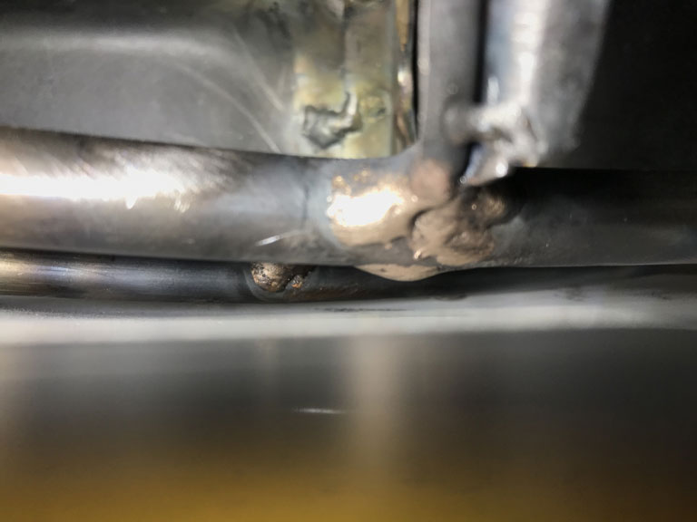

Here's the small hole through the bulkhead that the shift rod goes through.
The diameter of the hole in the bulkhead is barely twice the diameter of the shift rod itself. Not much margin for error there.
In the R-1st shift plane, the shift rod is severely scraping the passenger side of that hole.
Already making plans with Cary at Middleworks to get this addressed.

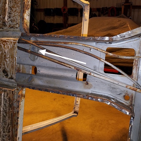

I'll tell you from experience that there is only 2-3 mm of clearance between the floorpan and these control tubes near that bracket.
Be careful in there
I have a picture of that are in sideview in my build thread.
Thin grey on bottom is floorpan edge view. Closest tube is the clutch cable tube, the smaller one behind it is the throttle cable tube and there is only 2-3mm clearance to the floorpan.
If you cut a hatch flap, it needs to be biased toward the passenger side to avoid the tubes.

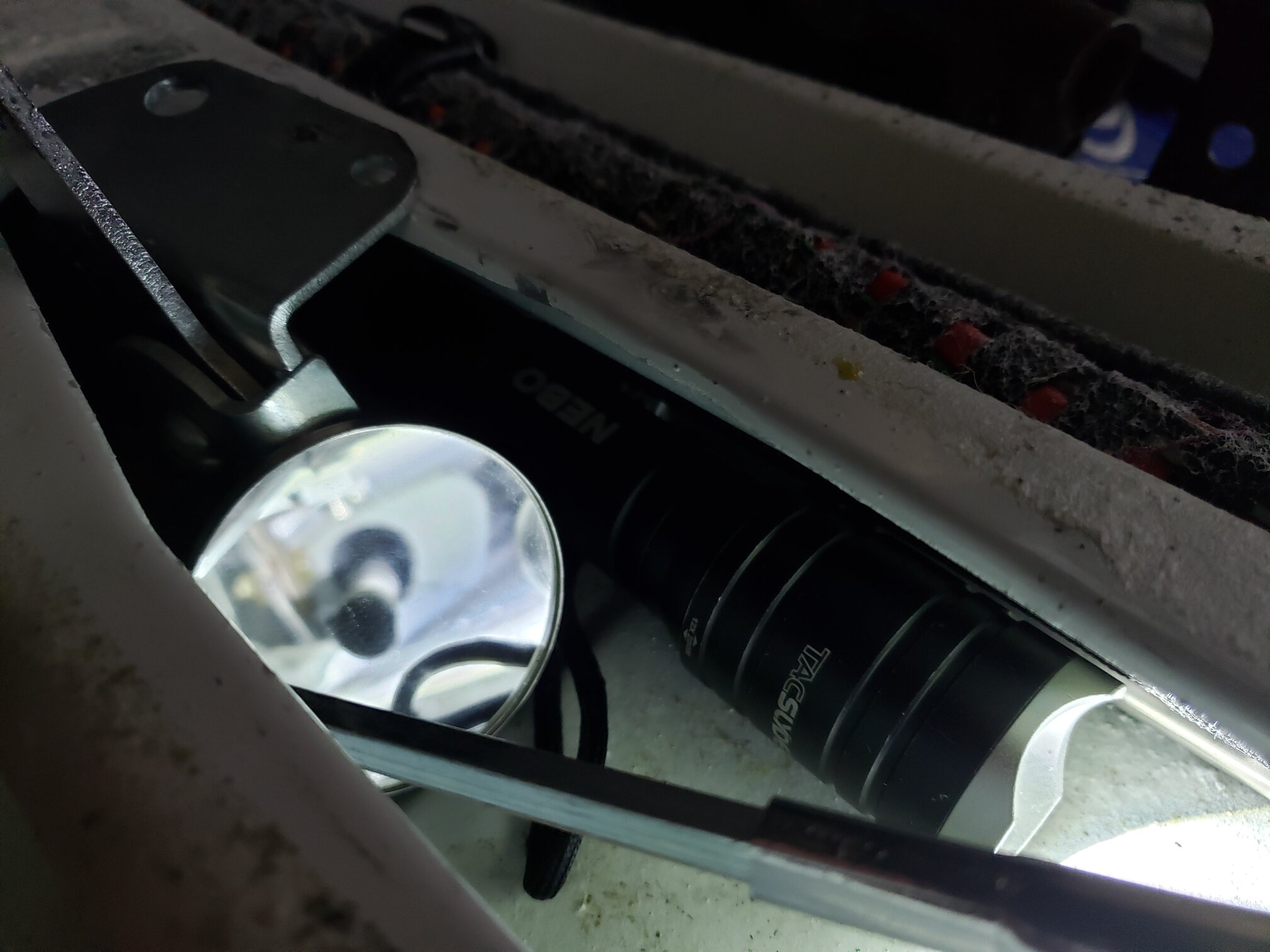

What a pain to remove the seats.
I've got GTS Classic seats in my car and the bottom of their seats wasn't perfectly flat plus I don't think the mounting holes in the seats for tracks are in exactly the right spot.
Tough to put them in (they don't slide so great) and much tougher to get them out.
I moved them forward enough to get access to the bolts that hold the seat bases to the car and removed the seats that way.
With the shifter out of the way, and a mirror & flashlight in the tunnel, this is what you see:
