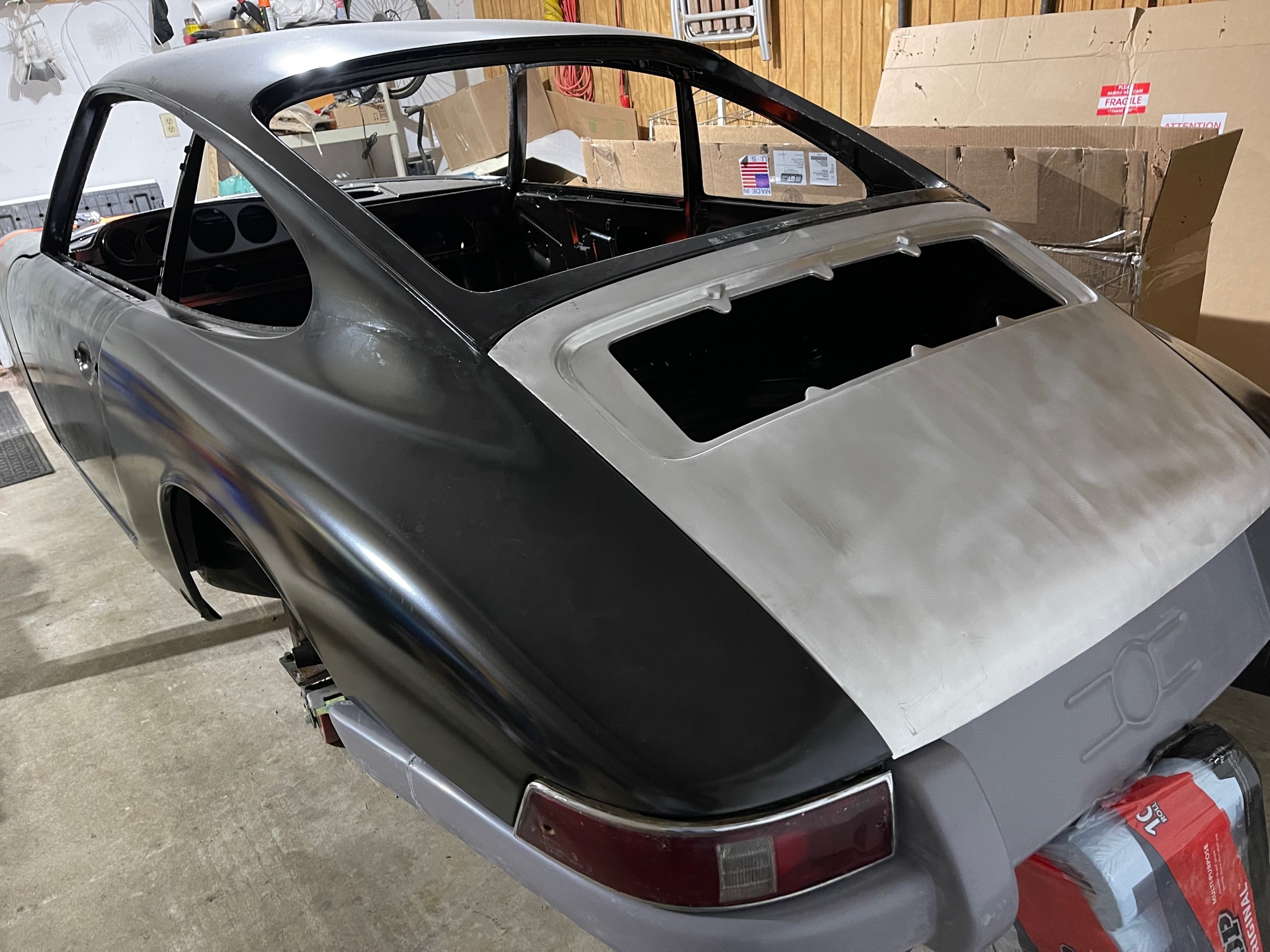

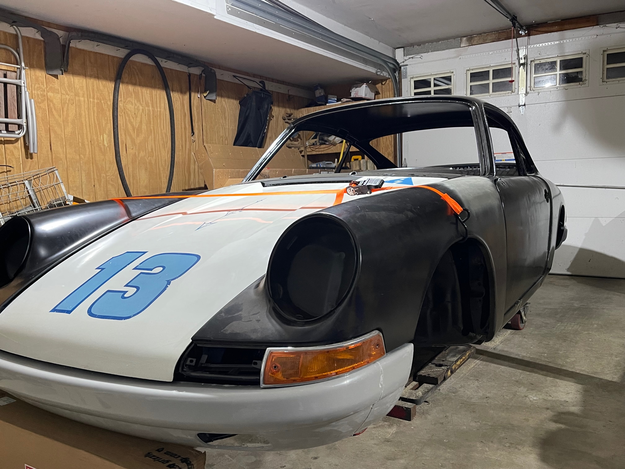

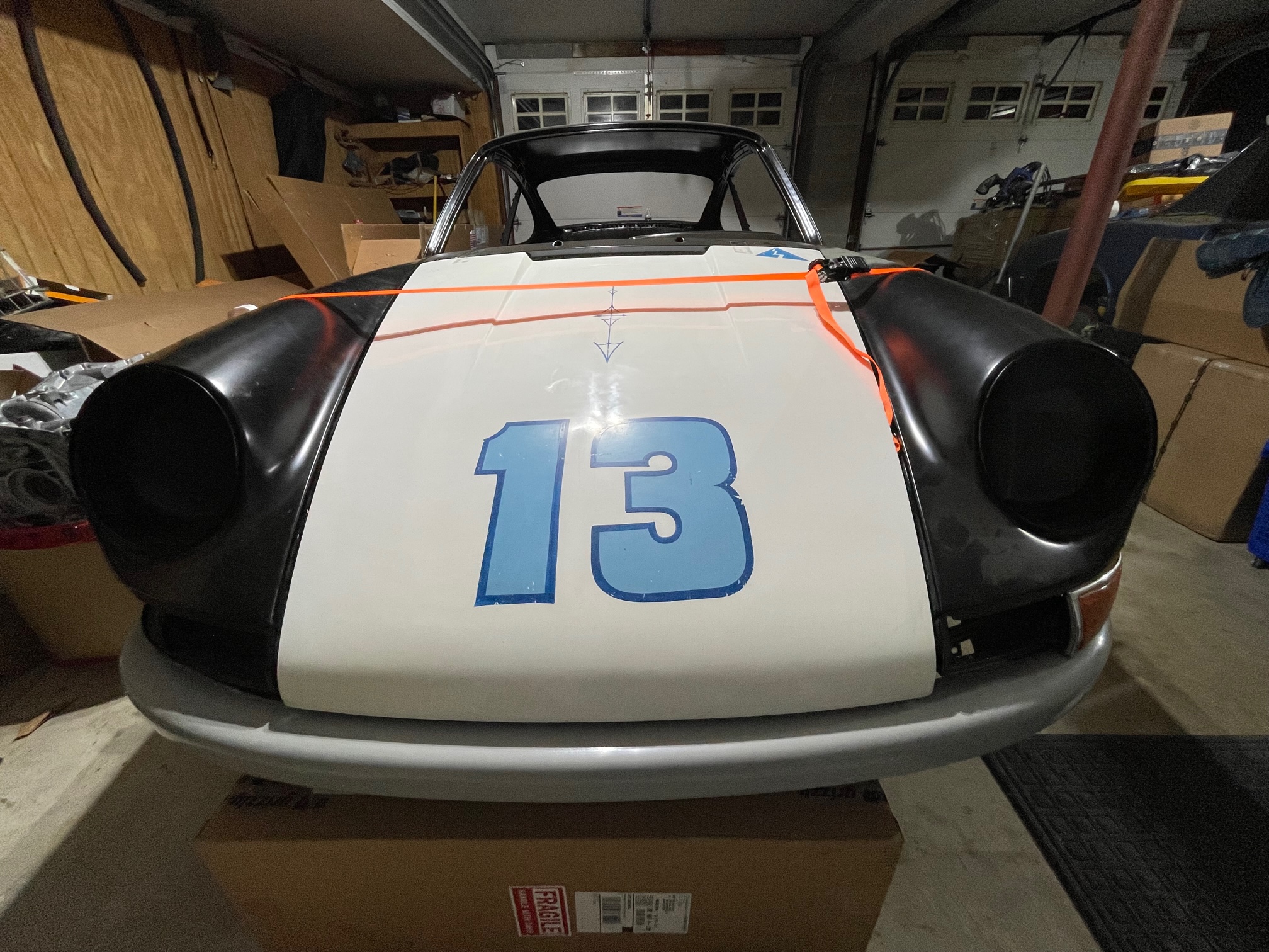

Came back from chemical dip and e-coat. Mocked it up just for fun. Headed out to paint soon.

Looking good!

How did the ecoat and overall condition come.out?

Nice looking tub!

QUOTE(BillJ @ Mar 6 2023, 10:39 PM) *
Really good. The chemical dip removes everything, rust, seam sealer, etc. then the Ecoat penetrated all the spot welded seams. A previous owner had started a restoration, replacing floor pans and some other pieces and let every overlapped seam get rusty. This cleaned and sealed everything. Ecoat is really needed if you chemical dip. Otherwise, all the spot welded seams are left bare but not accessible to conventional primer.

Is that an aluminum engine lid ? Mmmmmm

QUOTE(rgalla9146 @ Mar 7 2023, 09:32 AM) *
Yes. My friend has a real one and once I saw it, I could not unsee it. Under 5 lbs and shaped really well. In fact, when I received the glass hood, I decided I didn't want glass and ordered a Dansk aluminum long hood. Unfortunately, they are 2X the price from when I sold them in 2016.

love the 13 on the bonnet.
just like the "devils number monaro" that won bathurst in 68. (IMG:style_emoticons/default/beerchug.gif)
