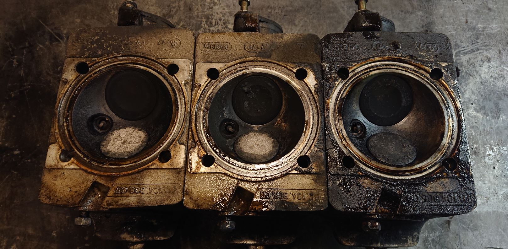

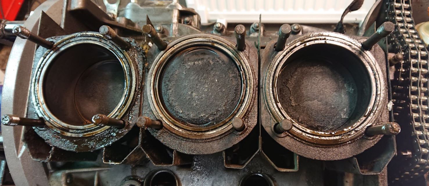

I did not want to put the engine in the car and end up with a major problem and as I enjoy taking things apart....... did I make the right decision and what do these picture tell the initiated?

Looks like it needed some new seals anyway

I think you did the right thing FWIW. Lots of carbon and unknown valve seat condition...
I agree with @mepstein - your lowest cost / best value alternative is a top end overhaul, clean & inspect cylinders and pistons, new rings; and, don't split the crankcase. If you do, dollar bills get sucked in....
