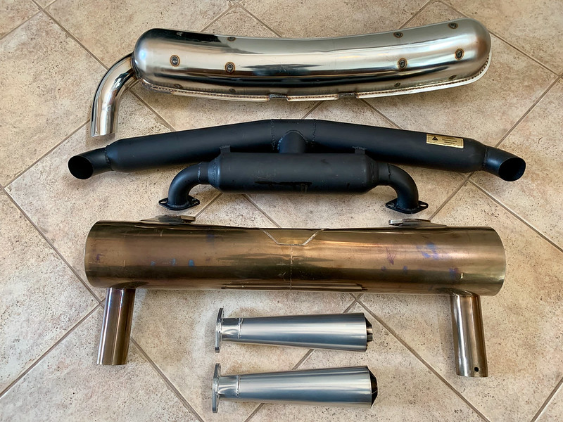

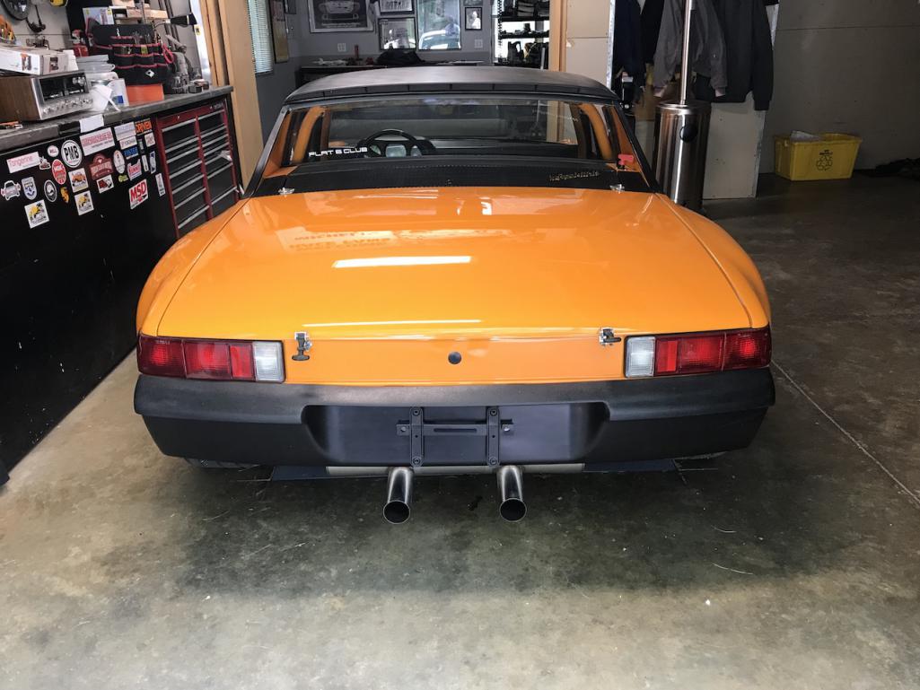

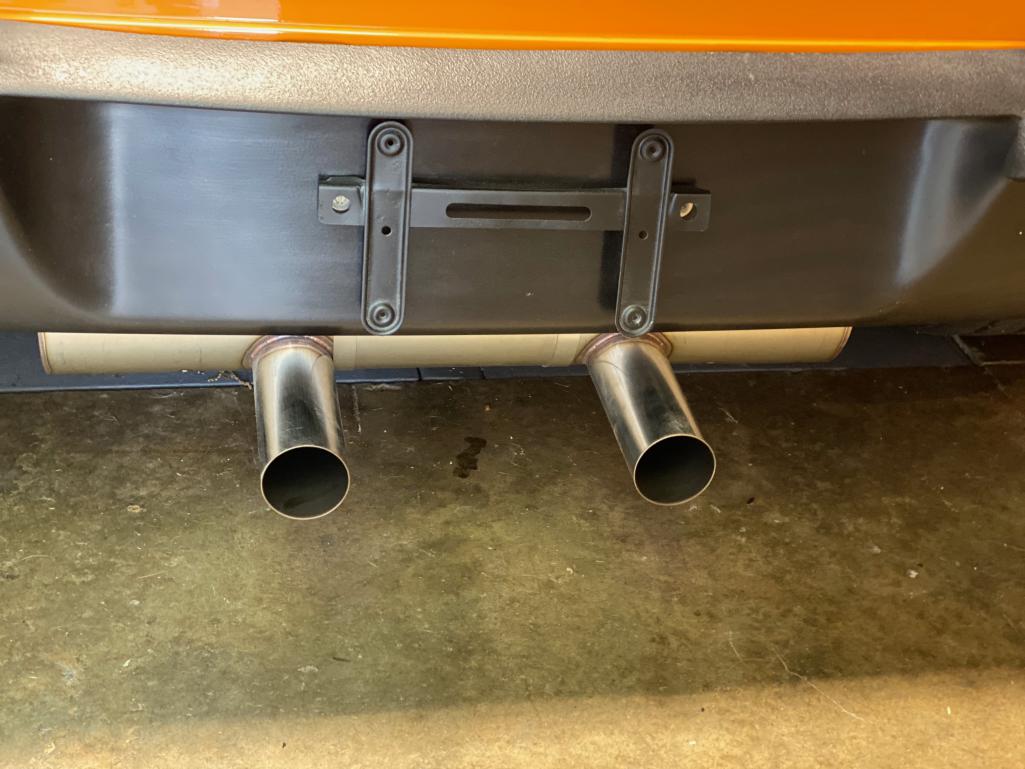

Yup, Ben's sport muffler, will make sound video tomorrow. MarkAttached Image Attached Image

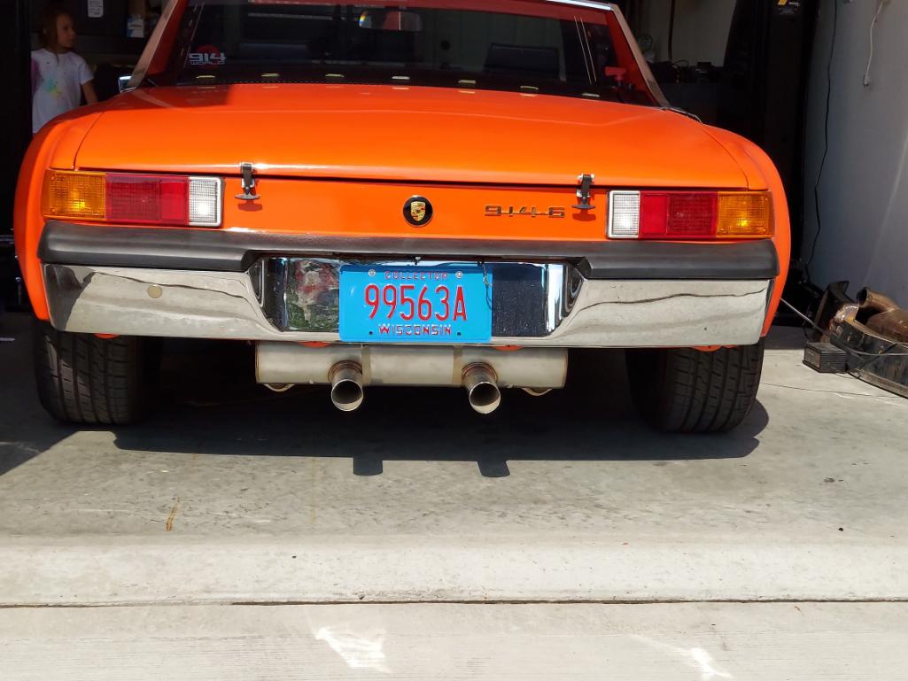

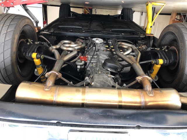

Just look at Ben's work, both header and muffler.Attached Image

From: Burlington wi
Member No.: 9,892
Thanks for all the kind words. I don't currently supply m&k anything but looks like I will be shortly. And yes I did start that company. The dual out may be fine on Steve's car but that is an anomaly as the dual out m&k drones much like the cheaper loud muffler Mark referenced.
My quiet versions now are not as quiet as the original but a perfect blend of sound/performance/ loudness. Recent tests show 84dbs wot
