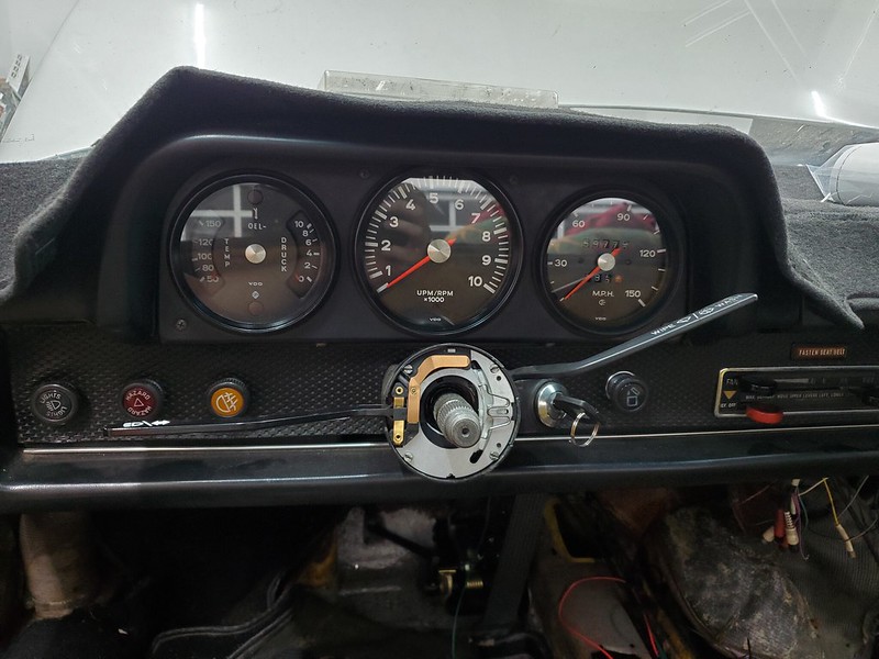

I have been putting off welding the last little piece, I think I need to get that in by tomorrow so I can put in the seals and start to move the engine into its resting place. I have been working on tuning the engine with Al and odds and ends. The front end is pretty much squared away with the tank back in and new fuel lines running up to it. My driver turn signal has some grounding issue or an issue with the holder that is making a bad connection. It works but only on the low circuit not the brighter one.
I have the new GT gauges almost fully in. The speedo was not touched, but the 10k tach is in and all wired up. It should work with the EDIS as I used one from a 74 and it had no problems with the signal. I needed to run a wire for the oil temp. I ended up using the console gauge temp wire for oil pressure. They final wiring will be done once the engine is in. I got the last hole cut for the oil tank and will begin to move it over in a day or 2.

(IMG:http://www.914world.com/bbs2/uploads_offsite/live.staticflickr.com-18763-1631424465.1.jpg)

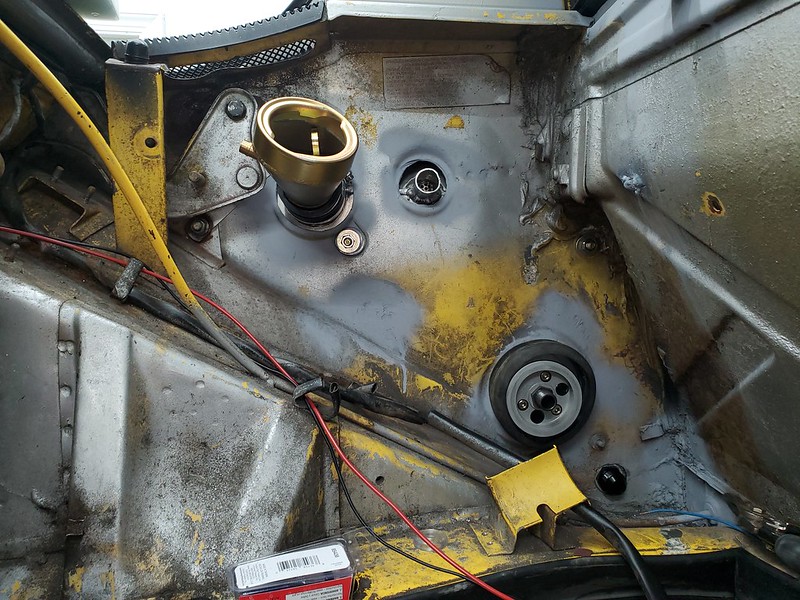

Make sure you put the lower oil line on the tank before you put the tank in the fender

Thanks Perry. I put the fitting on, but did not think to attach the hose.

Oil tank in!

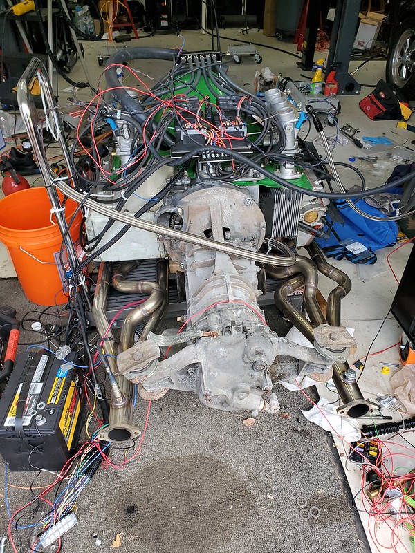

The engine is leaking a bit of oil while running. I think it is the camshaft seal. It was either not installed correctly or it is something else. A 20 minute run probably drops about a tablespoon. That is a project for winter, trying to get this down the road.
(IMG:http://www.914world.com/bbs2/uploads_offsite/live.staticflickr.com-18763-1631645766.1.jpg)
(IMG:http://www.914world.com/bbs2/uploads_offsite/live.staticflickr.com-18763-1631645767.2.jpg)

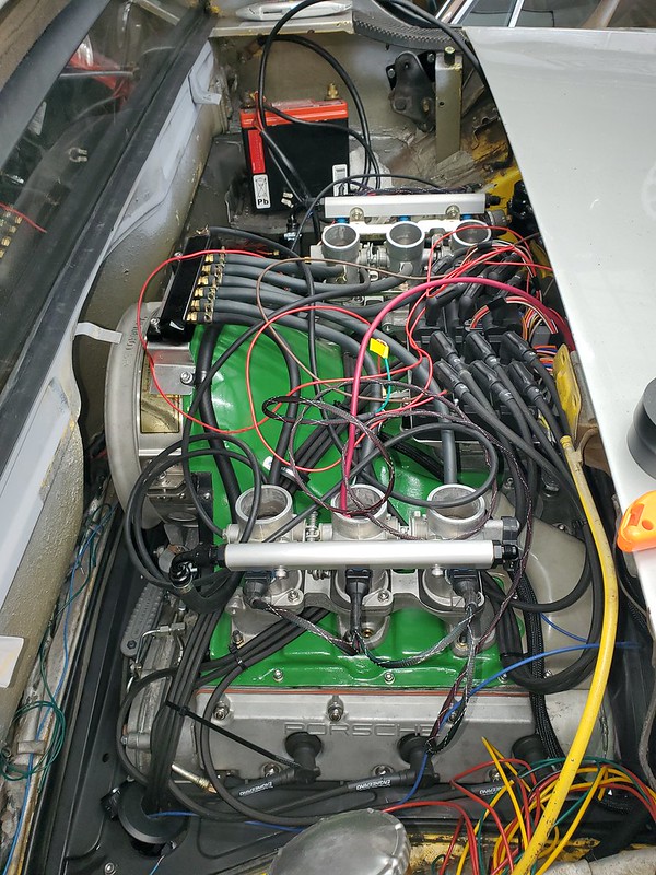

And then there was a 6. Engine is bolted in. I made my goal of having it in a week before the fest. Still plenty to do.
Hook up fuel lines
Hook up all wires
Mount main ECU
Connect throttle
Connect drive shafts
Connect clutch cable
Connect speedo cable
Fix E brake - nope not this one, in gear it is
Install shifter linkage
Install muffler
Install seat, maybe 2
Drive and tune
(IMG:http://www.914world.com/bbs2/uploads_offsite/live.staticflickr.com-18763-1631825151.1.jpg)
(IMG:http://www.914world.com/bbs2/uploads_offsite/live.staticflickr.com-18763-1631825152.2.jpg)

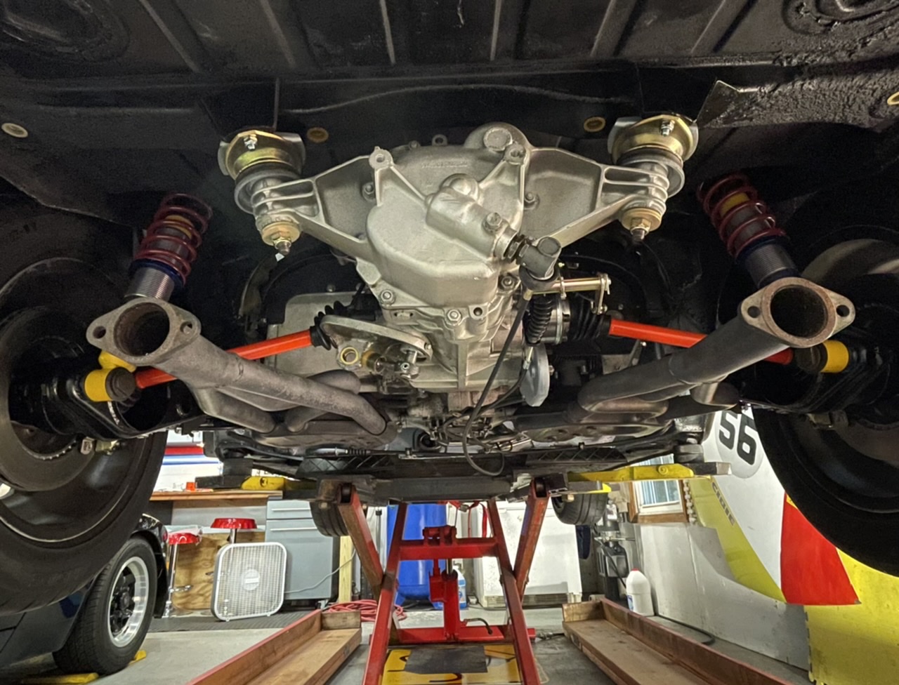

Take a look at your trans mounting hardware. It's not correct. That big cup washer goes on top of the trans ear.

Come on @Luke M why do you have to point these things out, lol. Ok let me check factorial pics for the correct mounting. I only put it back in the way it came out (IMG:style_emoticons/default/rolleyes.gif)

Looks amazing! Great progress. I had my trans hardware upside down for about 8 months and had no idea... you aren't alone.

Trans mounts should be this way…..

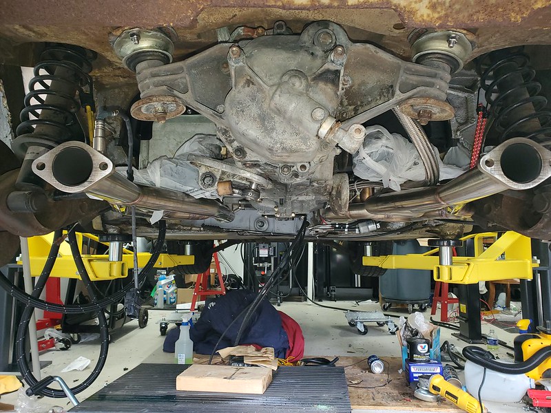

Axles reconnected
Clutch cable installed (need to adjust)
Speedo cable installed
Bracket made to offset linkage more than PMS - installed
Oil lines made and routed/installed
