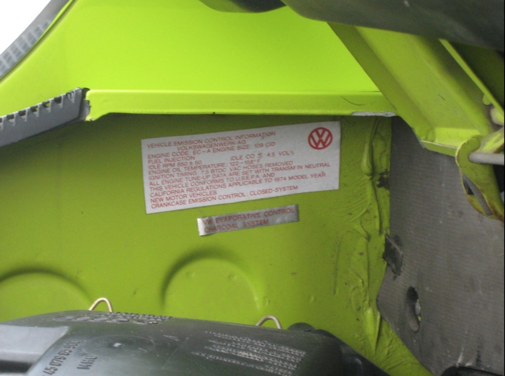

we know for sure.
EC-A is retard only. (and it is california conforming and CARB certified).
EC-B is retard and advance (when it has a california conforming sticker on it).
and we know narthing definitive about the EC-B without california conforming sticker.
which is a lot more than i knew 2 weeks ago.

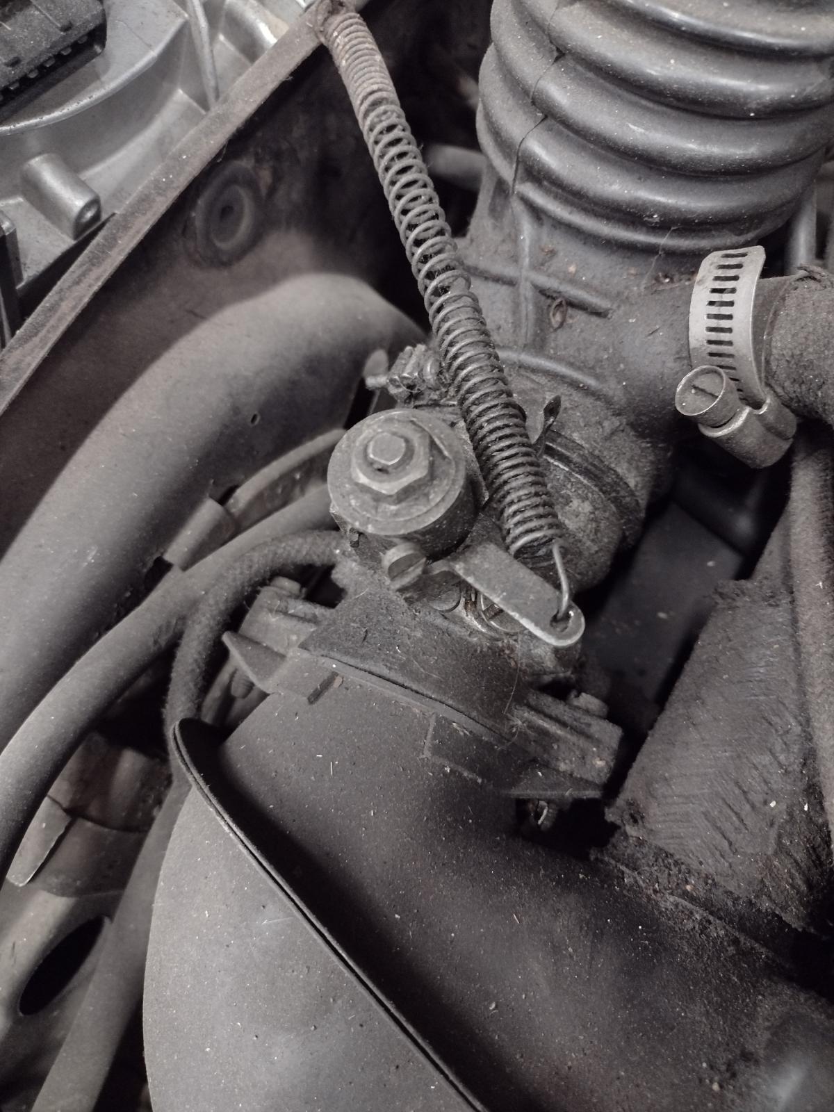

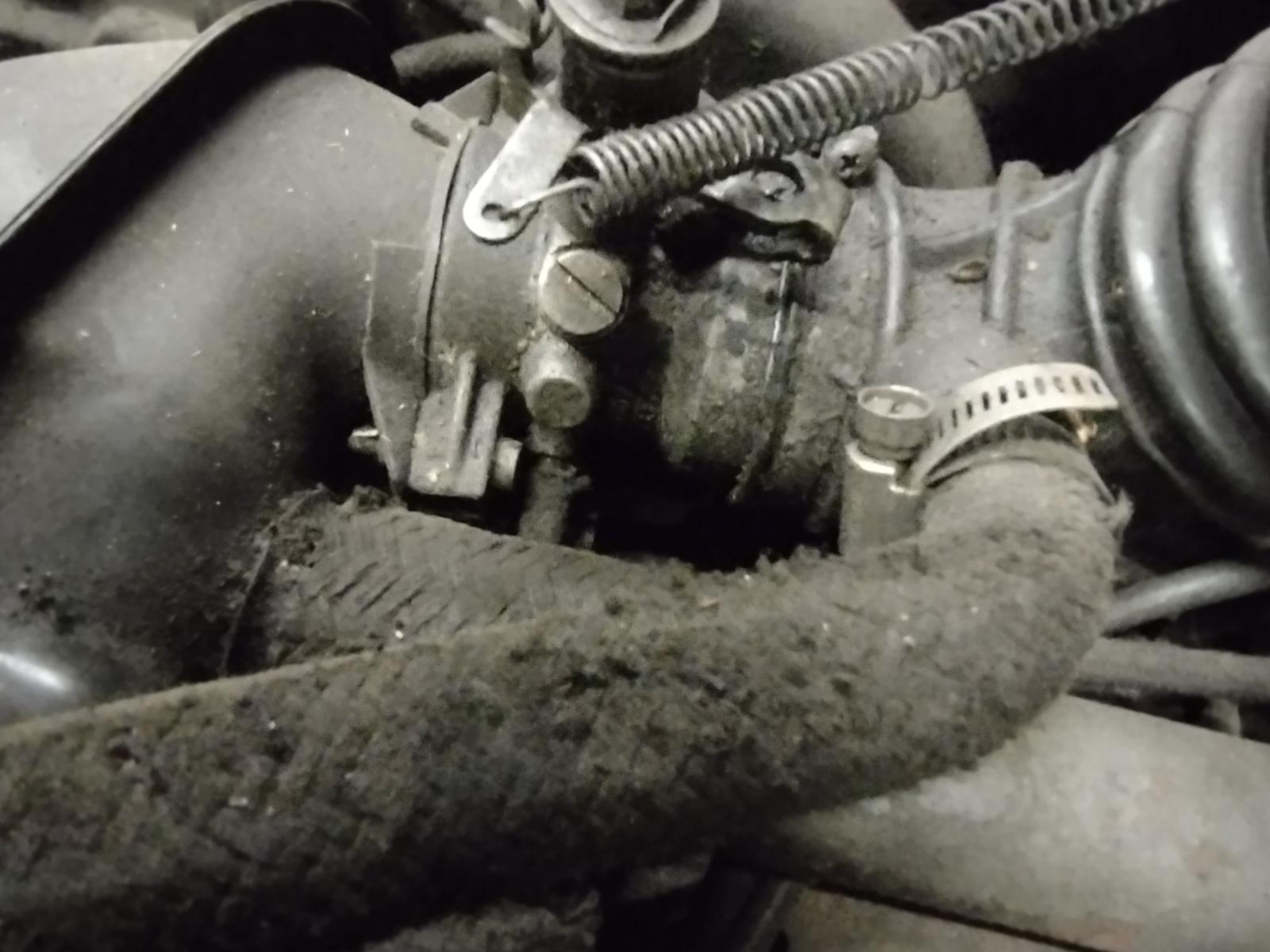

@Van B

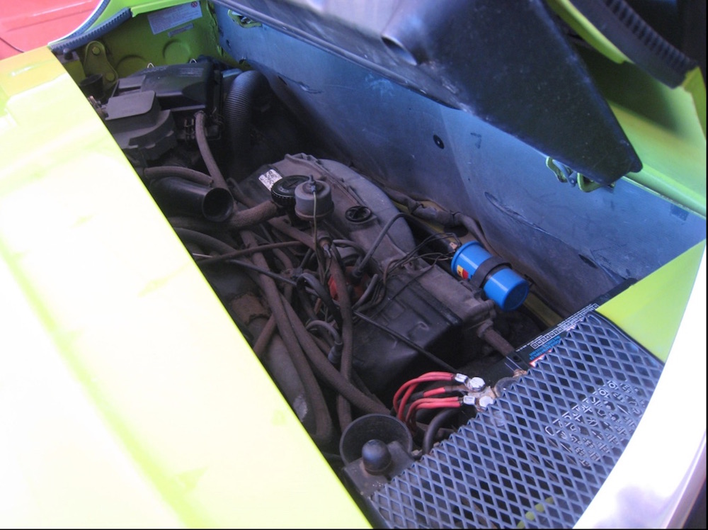

i just took a close look at the photos @nihil44 posted up.
he has got something happening there that is very probably non stock.
he has got a rebuilt throttle body that a member here refurbishes.
part of the process is boring out (remachining) the TB.
slightly increases diameter.
i'll bet this alters the ported vacuum position in relation to the throttle valve.
i'm looking at his photo and the advance port is hooked up to the retard side of the distributor (or it looks that way).
is that because the advance port is now a manifold vacuum port after the machining?
its ended up on the manifold side of the valve?
he has his advance line off distributor going into a T connector and another line and i can't tell what that does.
i think he knows what he was doing too.
he can best explain it.
must be a consequence of the refurb on the TB?
his TB has the port closed off that is in the original manifold (retard) vacuum port.
if that is all so with his TB without a "retard" port than the ECU will still run it all.
because he is getting retard at idle.

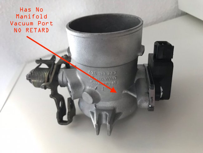

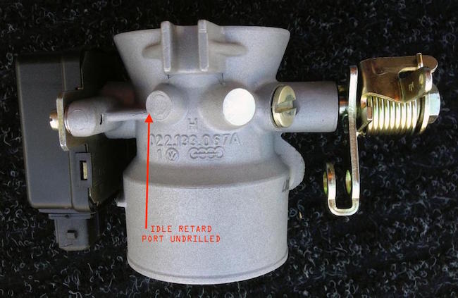

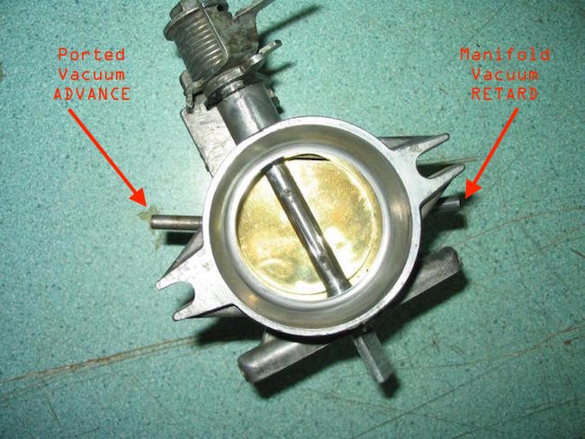

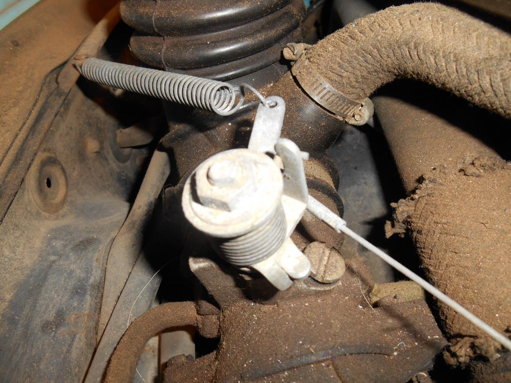

i worked out where the confusion came from between 2000 and 2010 on threads here and on pelican parts over vacuum hose set ups etc.
folks had cars that were already 30+ years old. throttle bodies had been replaced. some of the set ups being argued over were not in original configuration. some throttle bodies had come from other 1.8s in the VW family of cars.
this is the basic 74 914 EC-B throttle body.
All 74 914s had manifold vacuum connected to distributor retard vacuum. all ran retard at idle for emissions. only EC-B ran vacuum advance off upstream port on TB.
here are examples of various VW throttle bodies for the 1.8 L-Jet engine.
would have been a lot of these floating around?
to make matters worse some seem to have the same part # stamped on as the 914 TB. i don't know how VW would have distinguished these parts from each other? (IMG:style_emoticons/default/blink.gif)
both EC-A examples posted here by members @nihil44 and @L-Jet914 have had their vac advance activated and an alternative source of manifold vacuum taken off the intake plenum. in other words converted to EC-B configuration.

Hi,
Finally I can put my informations:

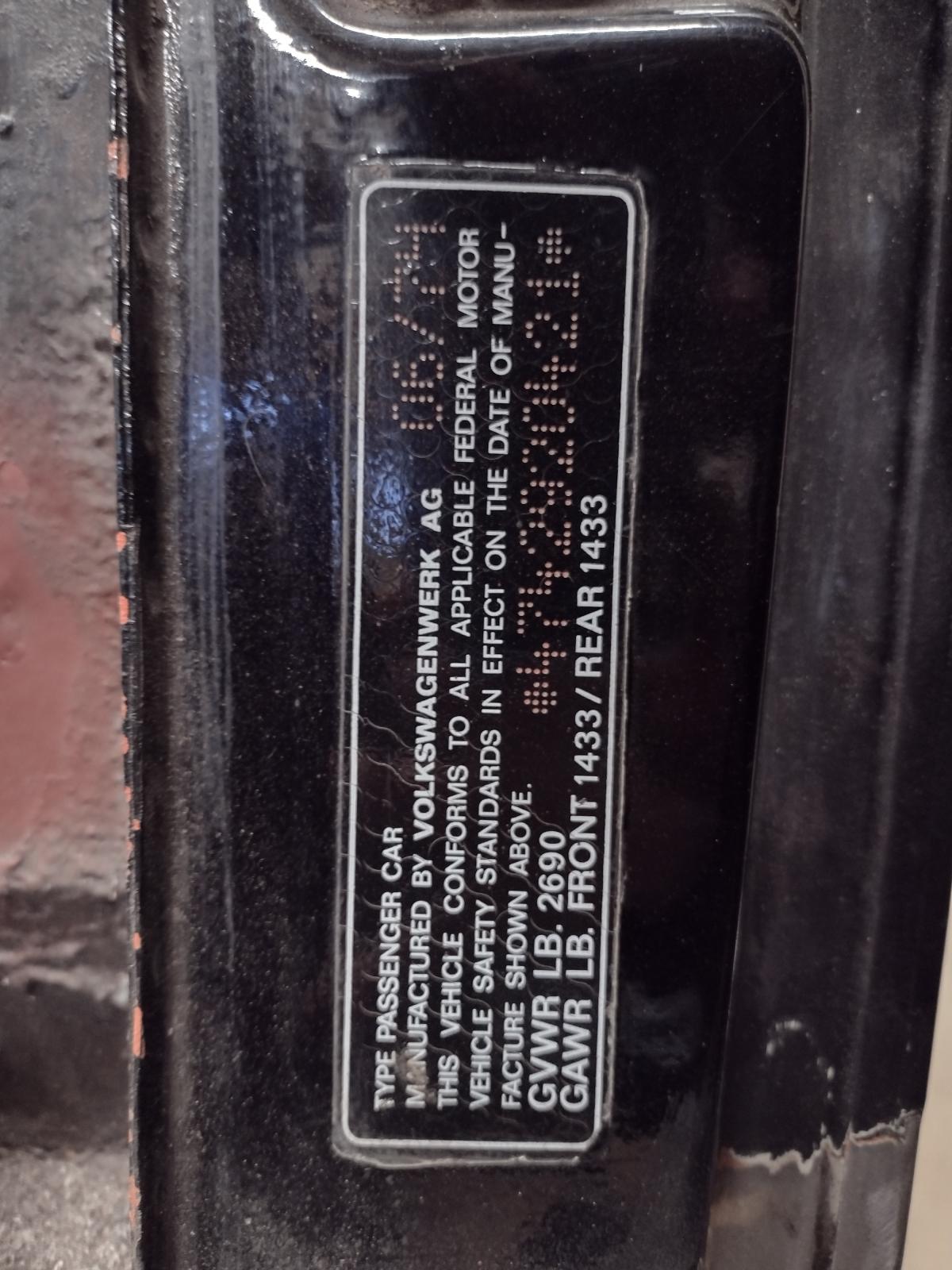

1. Vin Date - month and year (no need to post vin numbers if you don't want to). thats the date on the driver door sticker:
(IMG:http://www.914world.com/bbs2/uploads_offsite/www.thesamba.com-24690-1639061256.1.jpg)

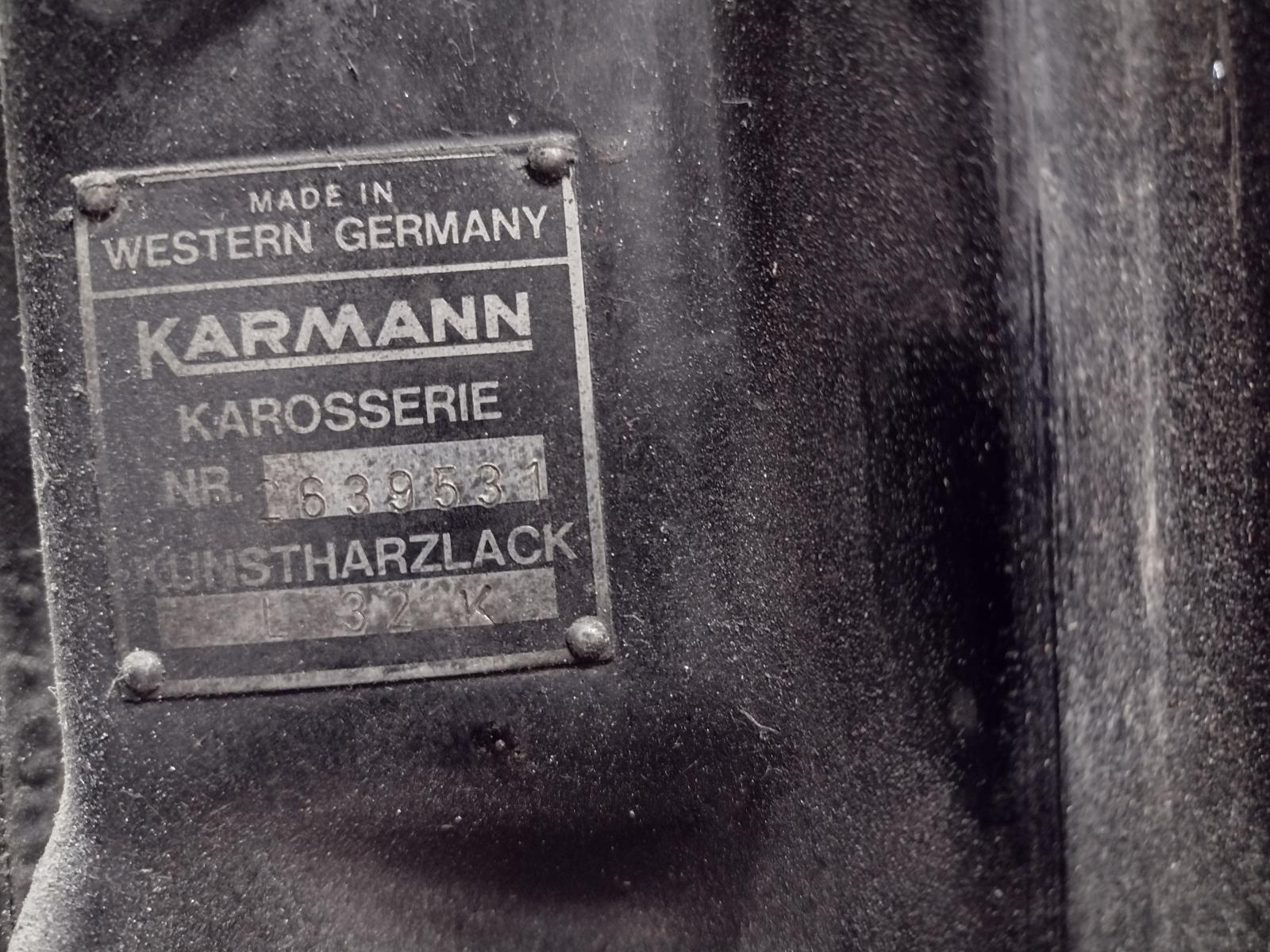

2. Karmann plate #. or if you have already done the maths, the day and week of the year the car began production.
(IMG:http://www.914world.com/bbs2/uploads_offsite/www.thesamba.com-24690-1639061257.2.jpg)
3. Image of engine bay emission sticker (lhs above the air cleaner - white with red letters). sticker should say whether it is an EC-A or an EC-B engine and whether it is california + EPA or only EPA.
-->Sadly gone on my car (IMG:style_emoticons/default/sad.gif) probably during the repaint (IMG:style_emoticons/default/sad.gif) )

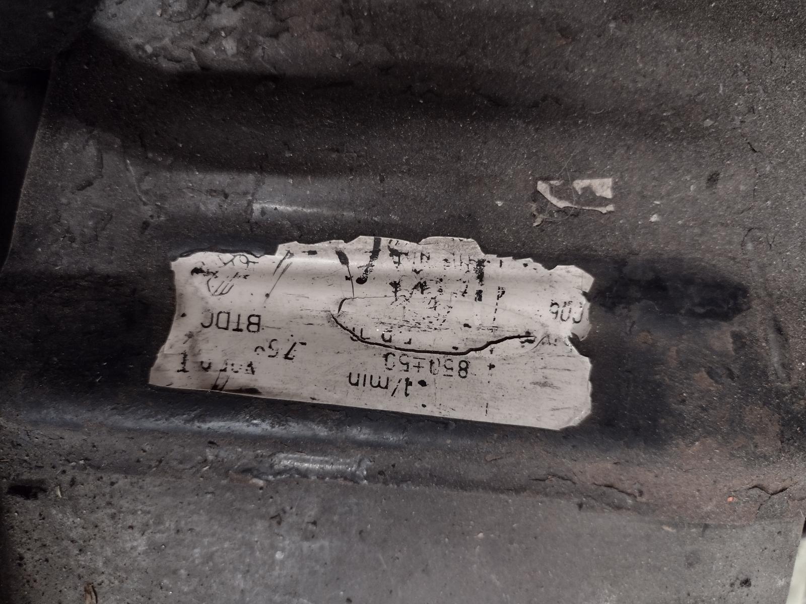

4. image of engine tune up sticker.
this is the small white sticker that is on LHS engine tin just below fan shroud.
most of them are gone by now, but some engines still have them.
Quite damaged on mine:
(IMG:http://www.914world.com/bbs2/uploads_offsite/www.thesamba.com-24690-1639061257.3.jpg)

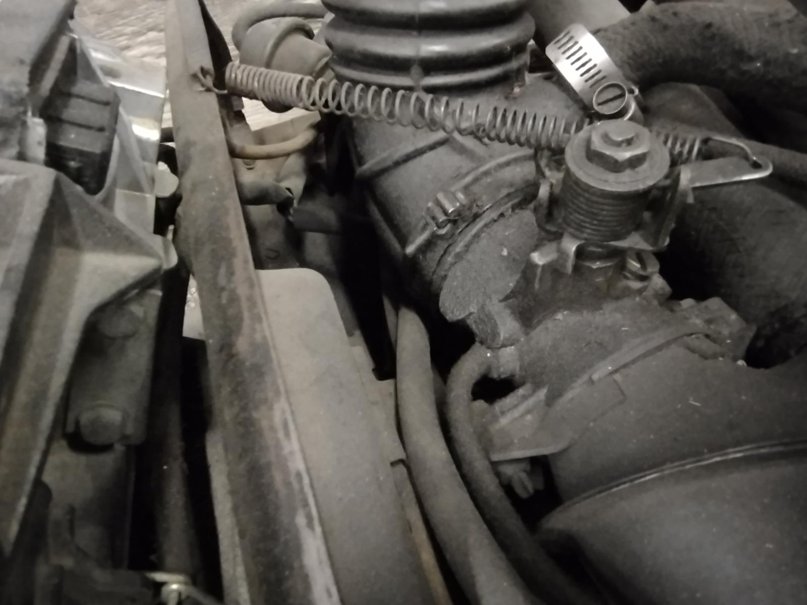

5. image of the throttle body. image of the distributor.
we are looking at the vacuum hose set up between the distributor and the throttle body.
Pretty dirty, no time for an engine cleaning yet :-(
(IMG:http://www.914world.com/bbs2/uploads_offsite/www.thesamba.com-24690-1639061258.4.jpg)
(IMG:http://www.914world.com/bbs2/uploads_offsite/www.thesamba.com-24690-1639061258.5.jpg)
(IMG:http://www.914world.com/bbs2/uploads_offsite/www.thesamba.com-24690-1639061258.6.jpg)
Cheers
Antoine
wonkipop
post Dec 9 2021, 11:41 AM
Post #115
Posts: 5,761
Joined: 6-May 20
From: north antarctica
Member No.: 24,231
@TRS63
thanks Antoine
engine looks great mate. all original in there. (IMG:style_emoticons/default/beerchug.gif)
can make out from tune up sticker its both hoses hooked up car from the start.
same set up as EC-B stickered cars so 99% its one of those.
from late in production - handy to know. 6/74
shows vw were definitely making the two hose connected set up well after jan 01 74 and one versus two hose hookup isn't about a chronological production change/improvement.

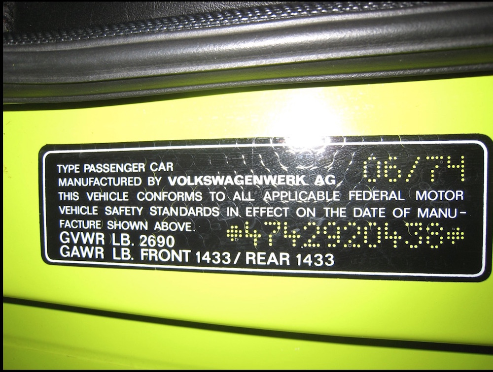

wonkipop
post Dec 9 2021, 09:21 PM
Post #116
Posts: 5,761
Joined: 6-May 20
Member No.: 24,231
Interesting one I found trawling old ads.
EC-A.
VIN date 06/74
resolution of engine photos don't allow to see hose hook up, or what tune up sticker shows.
bill of sale is sold new in cincinnati, ohio - makes it a CARB certified EC-A that is not sold new in california.
strange thing on engine seems to be for an aftermarket temp gauge made in the 70s.
