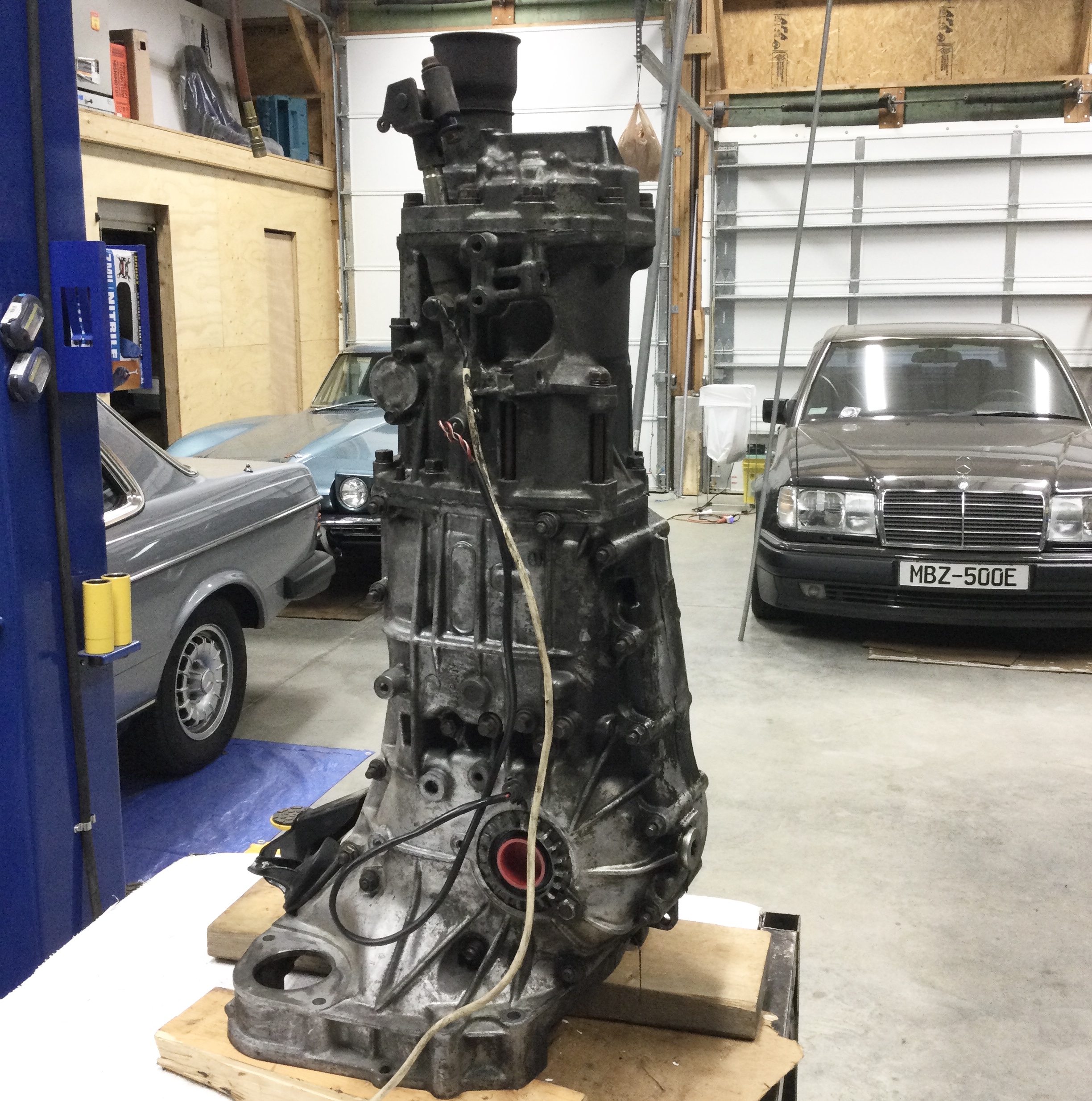

A few days after getting the donor car, I came across a 5 speed transmission.
Alain V.
post Nov 28 2022, 07:14 PM
Post #106
Posts: 212
Joined: 15-March 13
From: Kansas
Member No.: 15,655

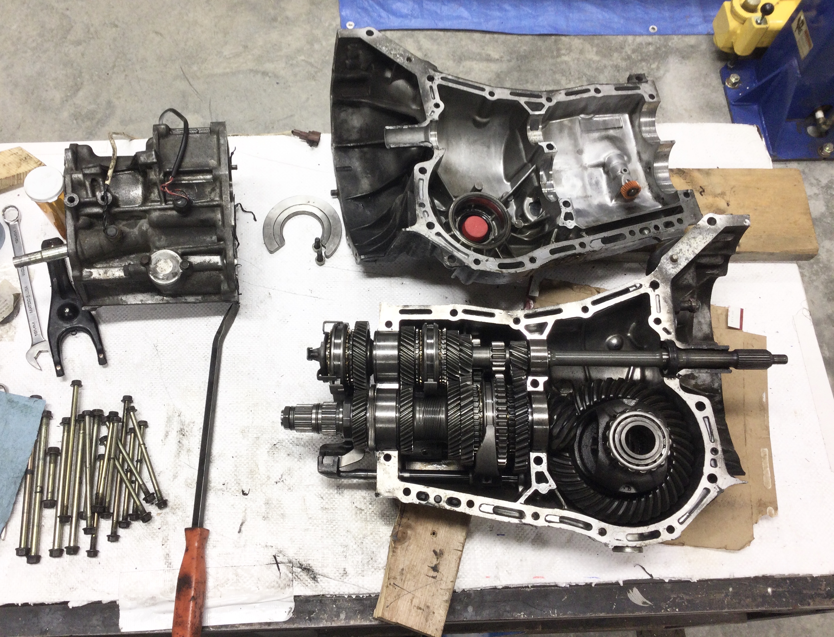

The transmission came from an 05 non turbo car. The previous owner had replaced it because he had trouble with it getting stuck in 5 th.
Upon inspection, I’m pretty sure it just needs a 5th gear bearing.
I will be installing a limited slip from subaru gears during the refurbish of the trans.Attached Image

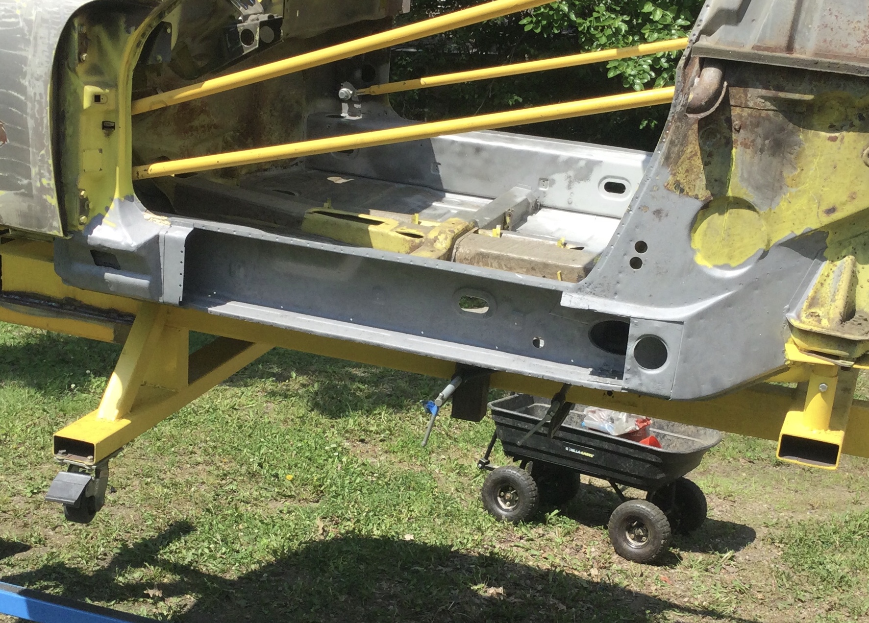

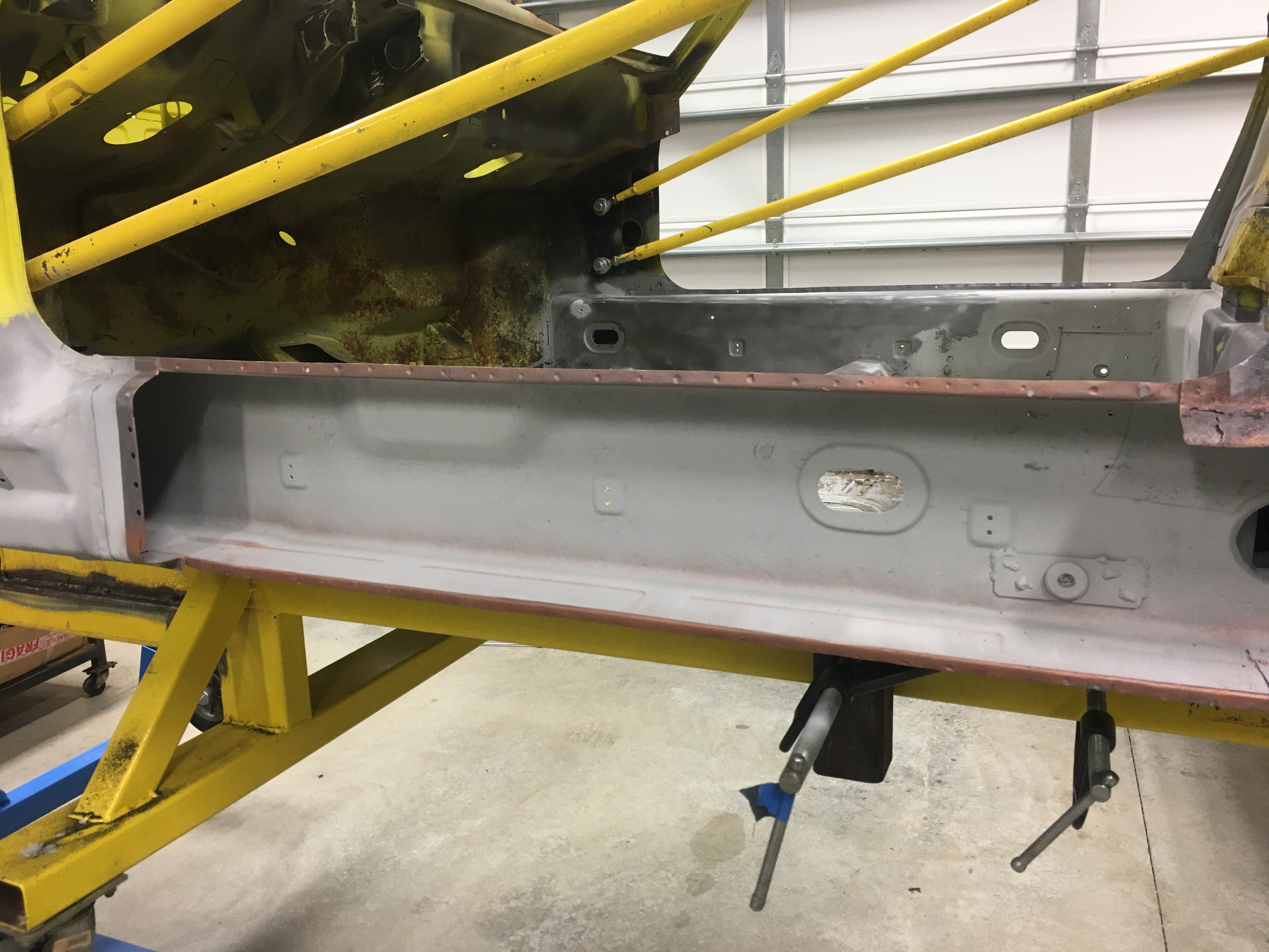

Yikes! I can't believe it's been over six months since I've made much progress.
I did finally get to spend a little "quality time" with it over the last two weeks and am making small steps forward.
I drug the whole thing outside to do some blasting on the inside of the longs in order to get all of the leftover surface rust out.

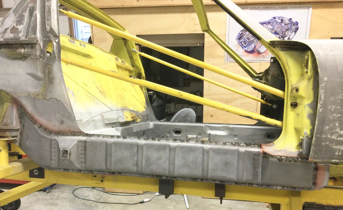

treated the area with ospho, then shot it and the inside surface of the new panels with epoxy primer.
Alain V.
post Jun 12 2023, 07:23 PM
Post #110
Posts: 212
Joined: 15-March 13
From: Kansas
Member No.: 15,655
clamped/screwed the new panels into place , then used the spot & mig welder to install.

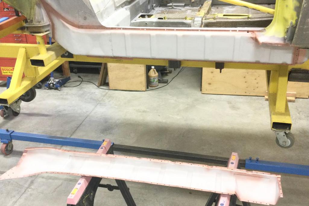

Member No.: 15,655

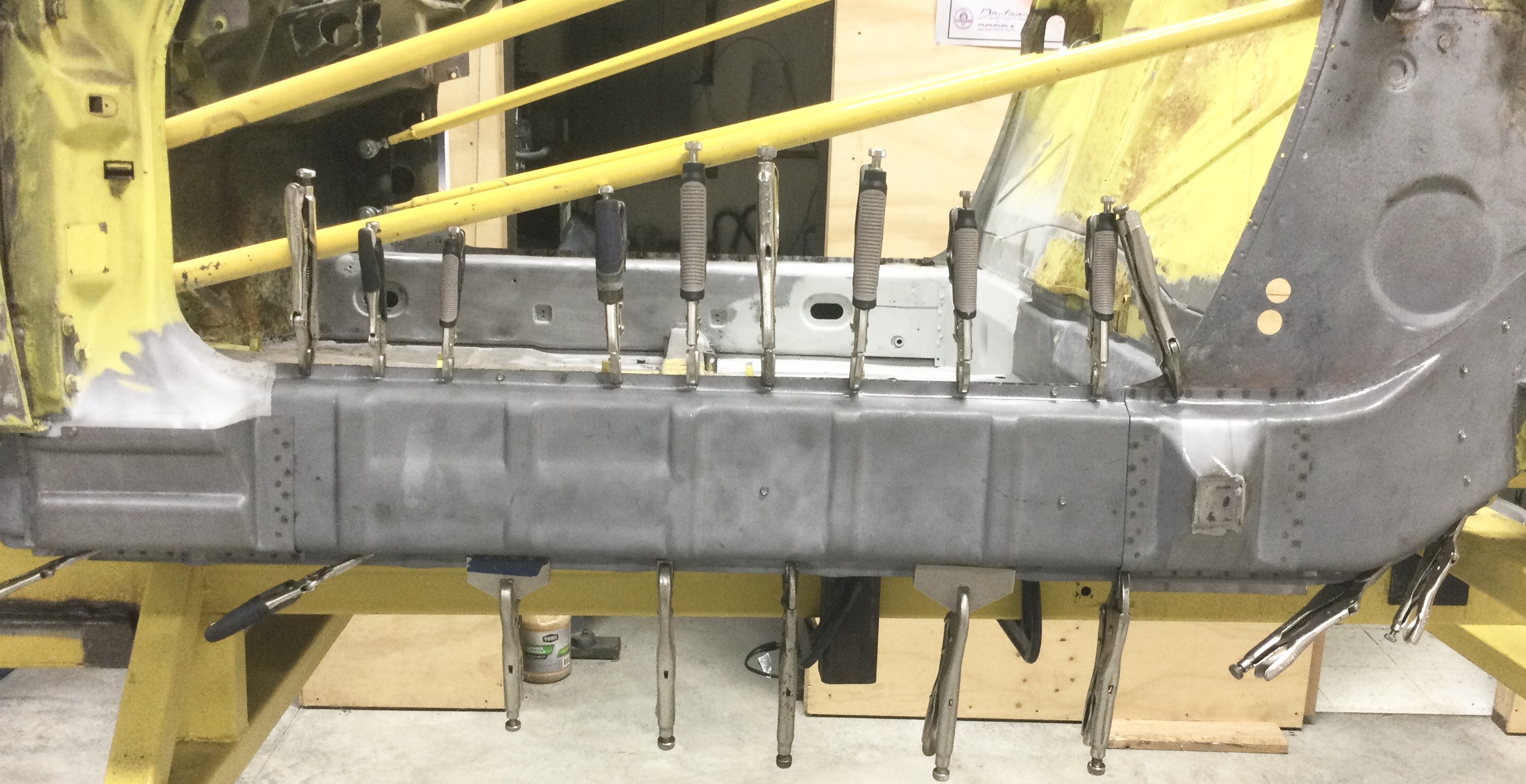

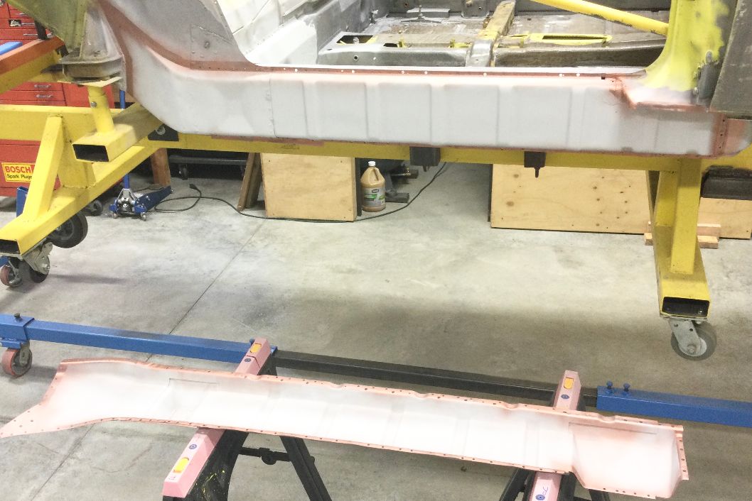

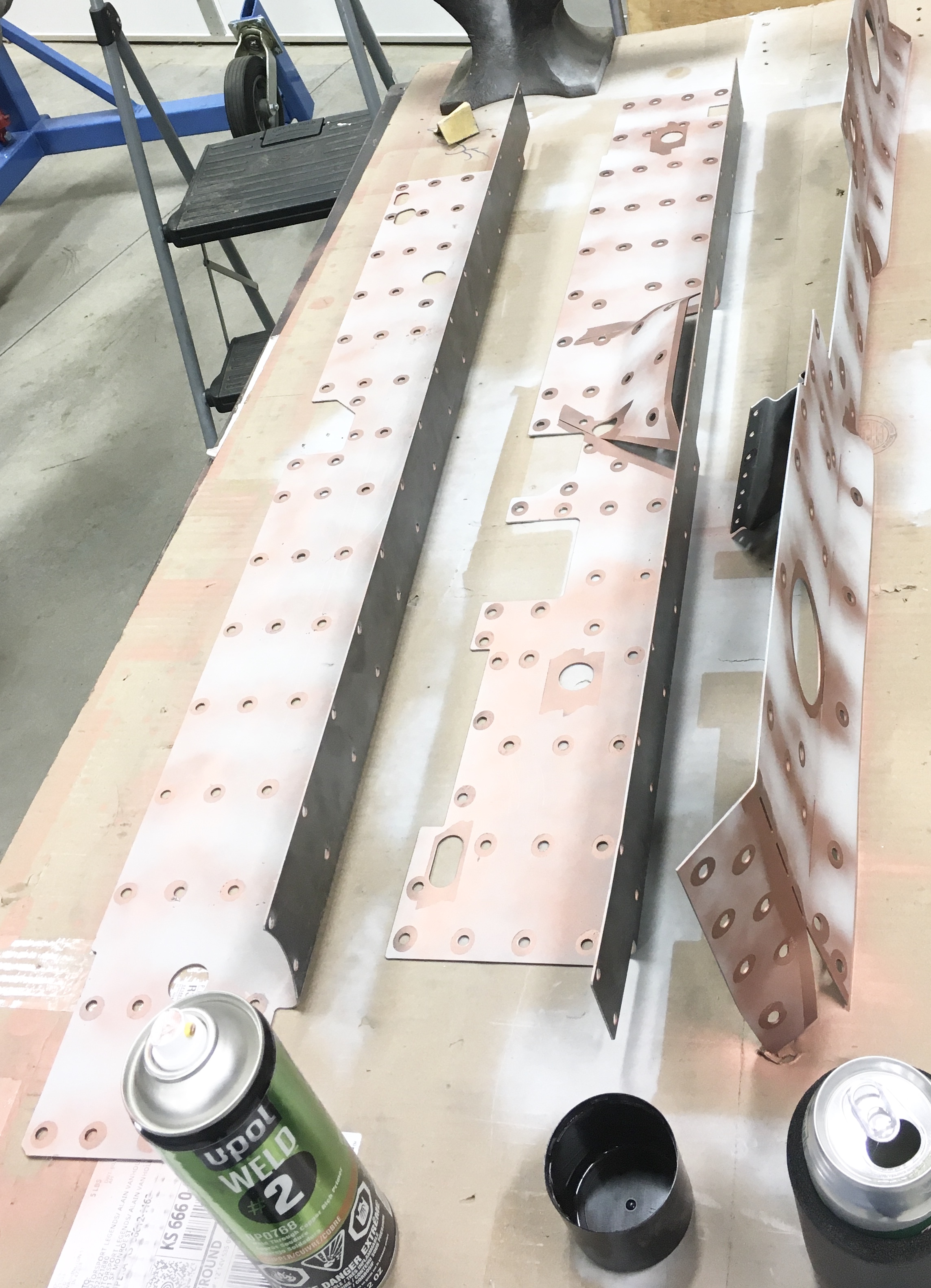

After I ground down some of the welds on the repair area, I epoxy primed and prepped the chassis stiffener panel.
Alain V.
post Jun 18 2023, 07:46 PM
Post #113
Posts: 212
Joined: 15-March 13
From: Kansas
Member No.: 15,655

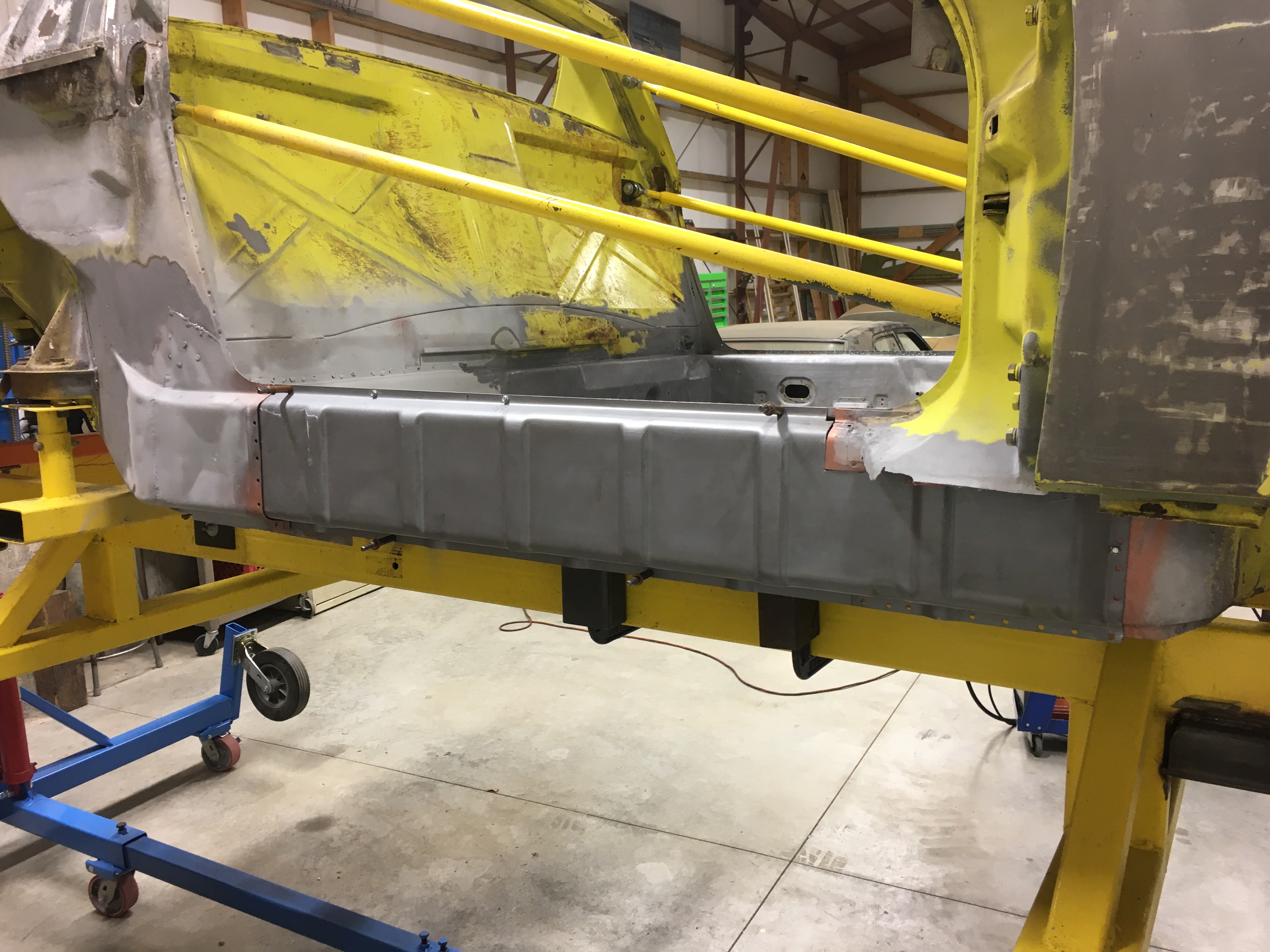

after clamping it down with tek screws and every pair of vice grips in my shop, I got about 90% of the welding done. I know some of you have seen these repairs many times, but it seems like every 914 I've ever come across needs this done.
Some may notice that I welded the jack post holes shut. This is because I have decided that I won't ever use the factory jack & want to have smooth outer rocker covers when finished.

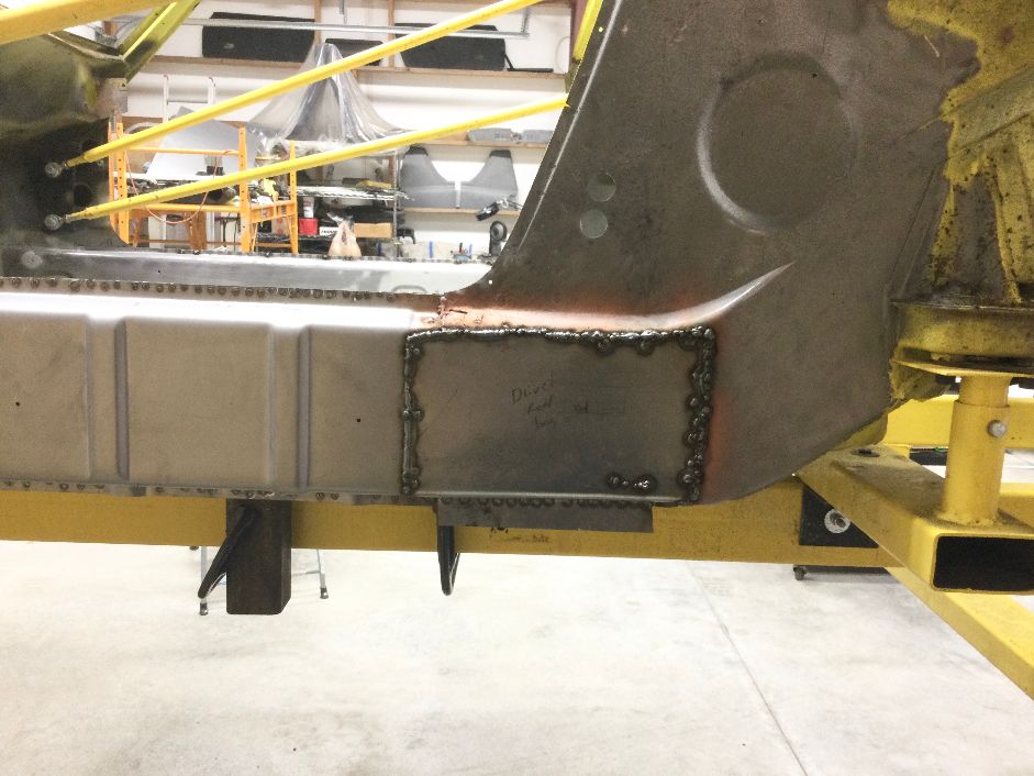

post Jun 18 2023, 07:54 PM
Post #114
Posts: 212
Joined: 15-March 13
From: Kansas
Member No.: 15,655

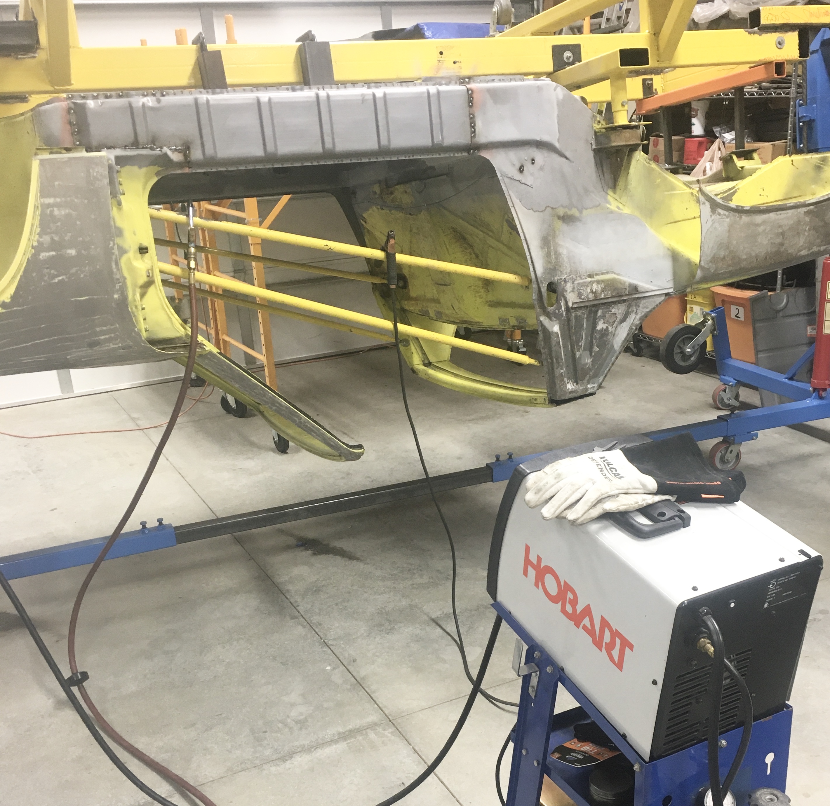

with the pass side stiffener nearly done, I welded in the last patch for the driver side.
Hopefully, I can keep this momentum going and fit/install the stiffener on the driver side next weekend.

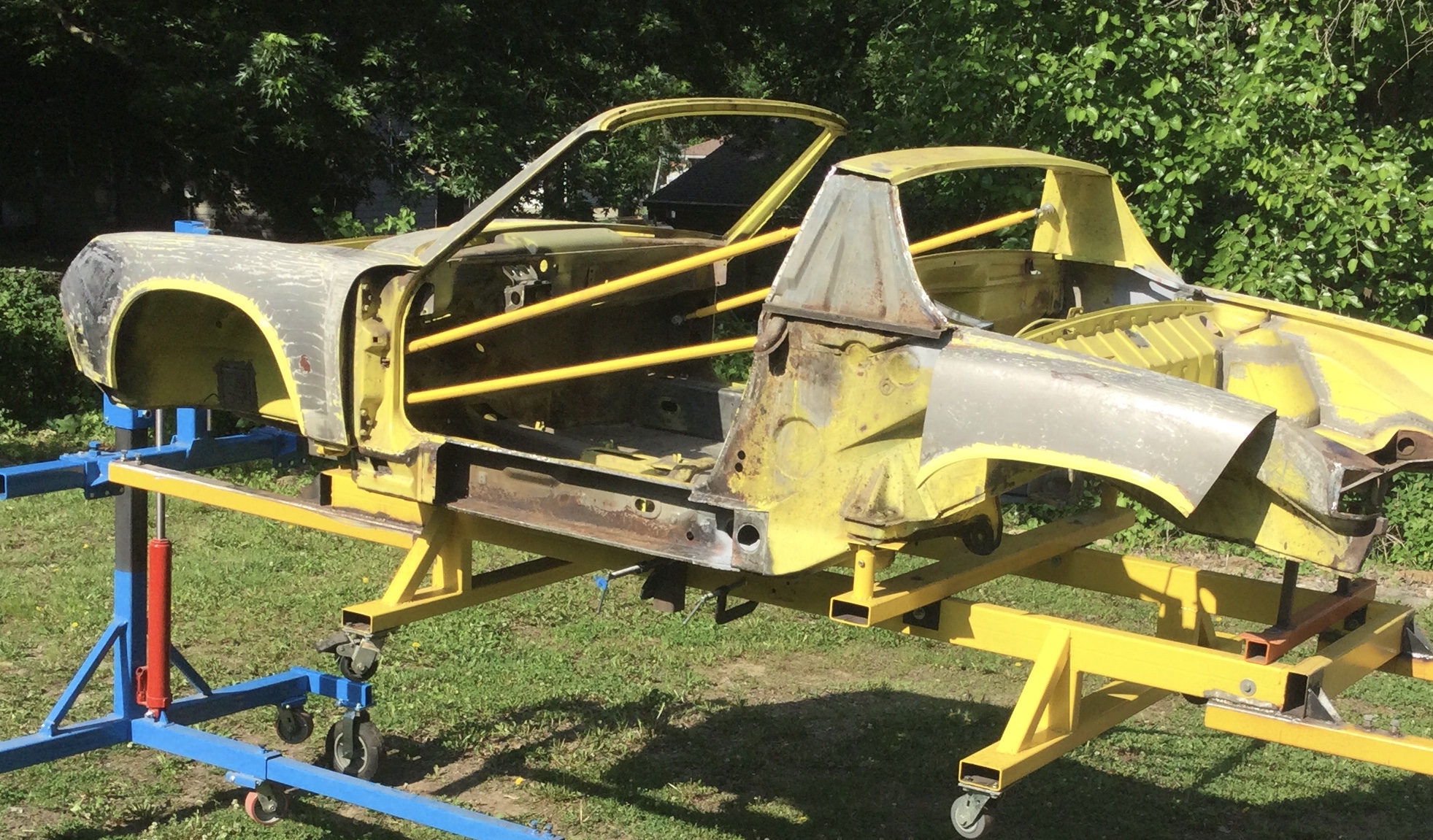

Well, I didn’t get as far as I planned this weekend,,,but I am making small steps forward.
I managed to get the driver side stiffener clamped down & mocked up, then punched/ drilled all the holes in it. Going to try and prep/ prime the inner surface, then weld it on next weekend.

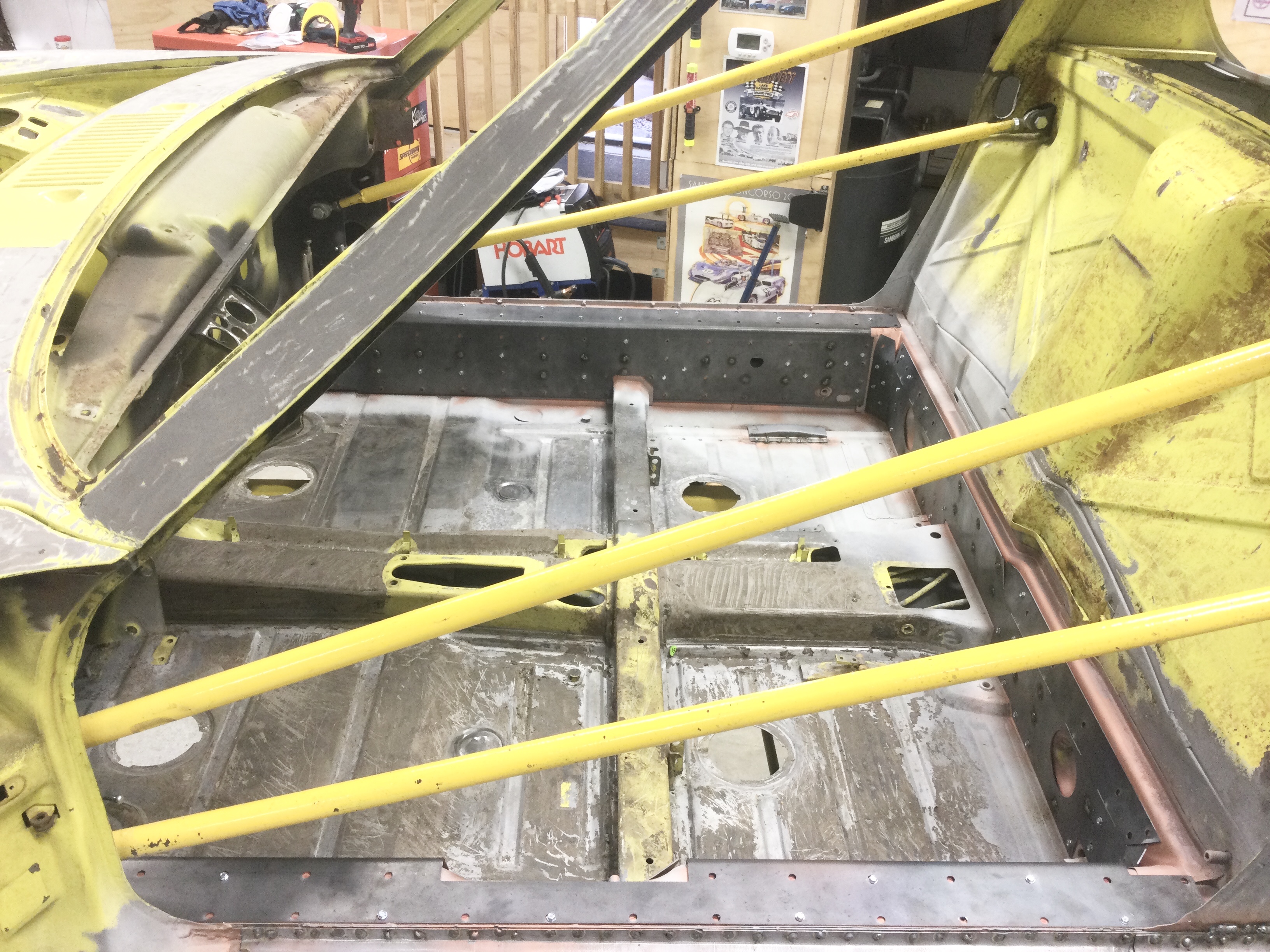

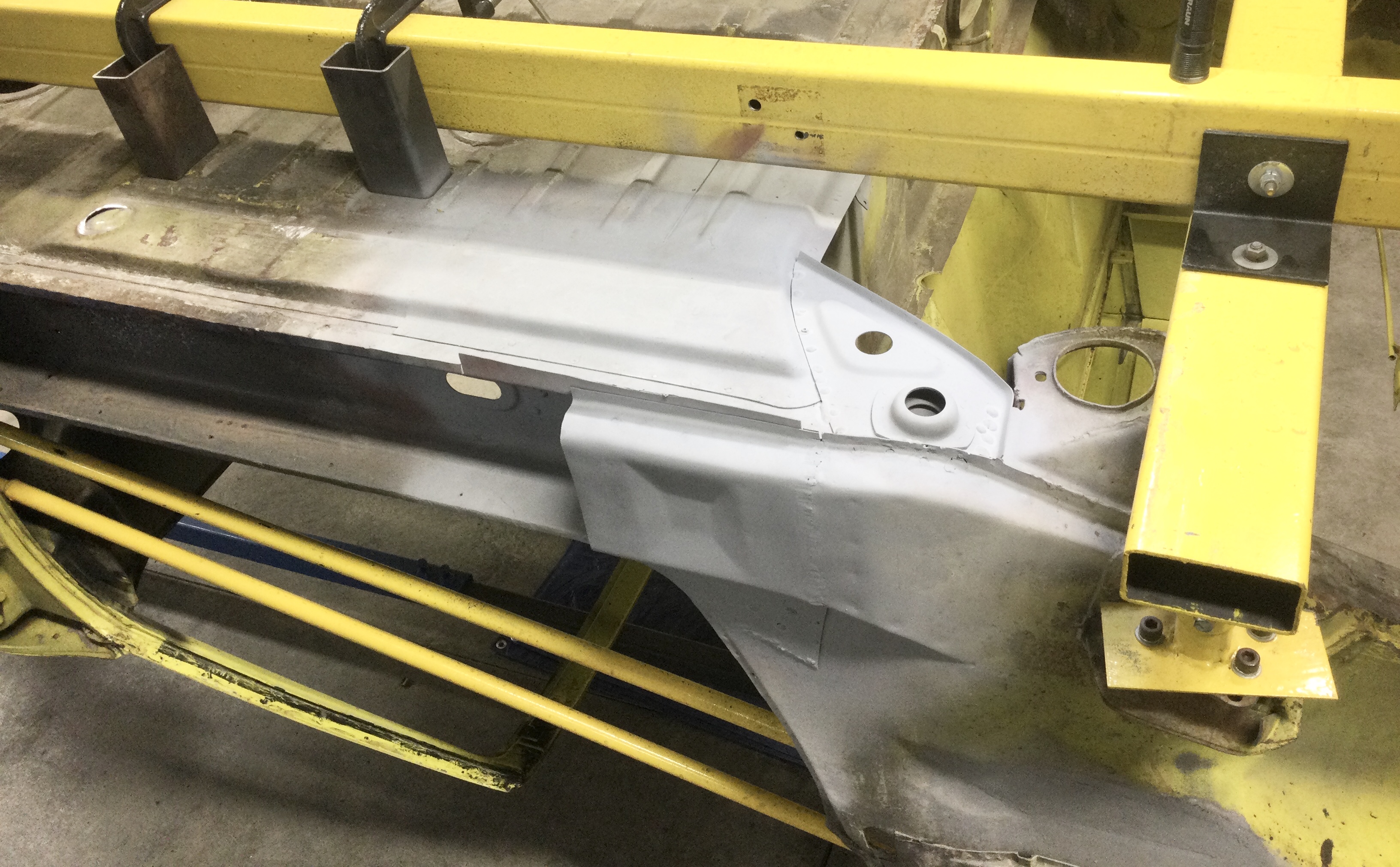

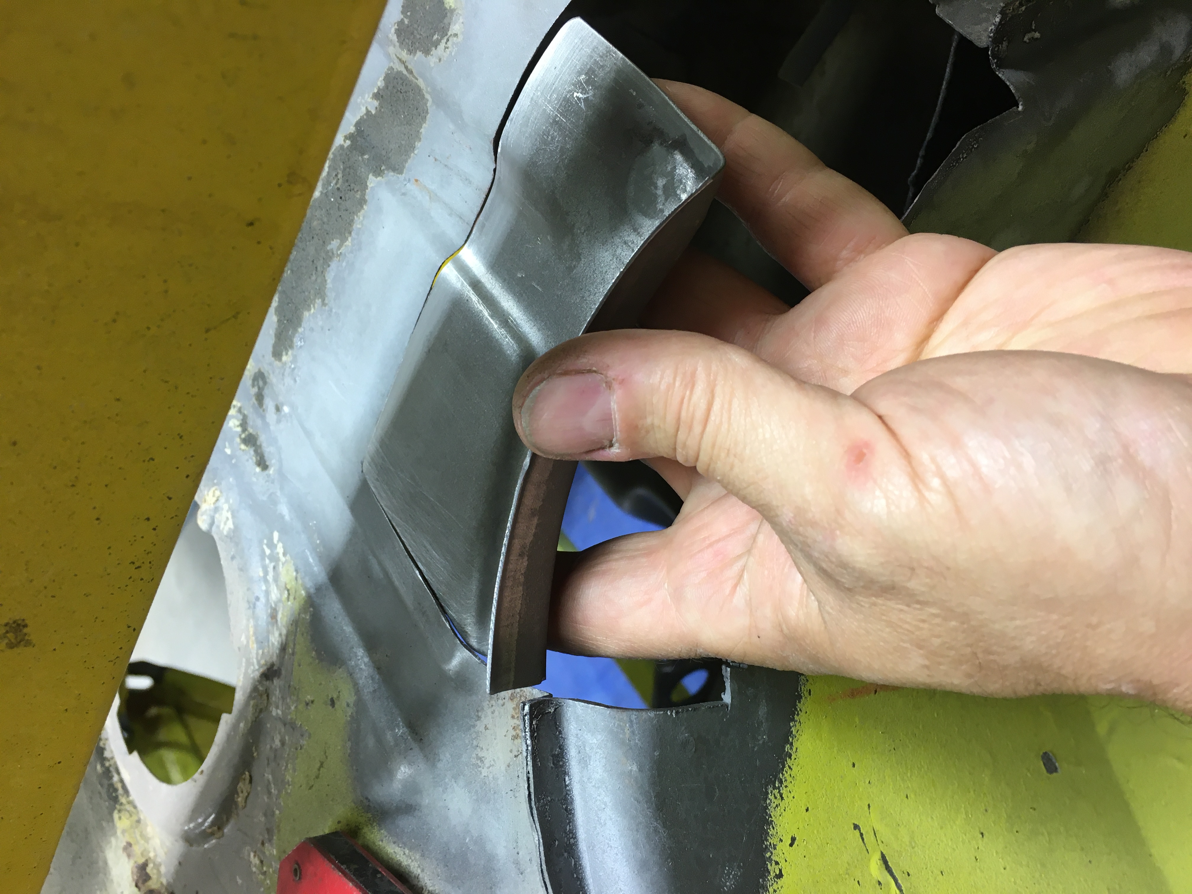

Also finally started working on the hole in the left front of the floor.
