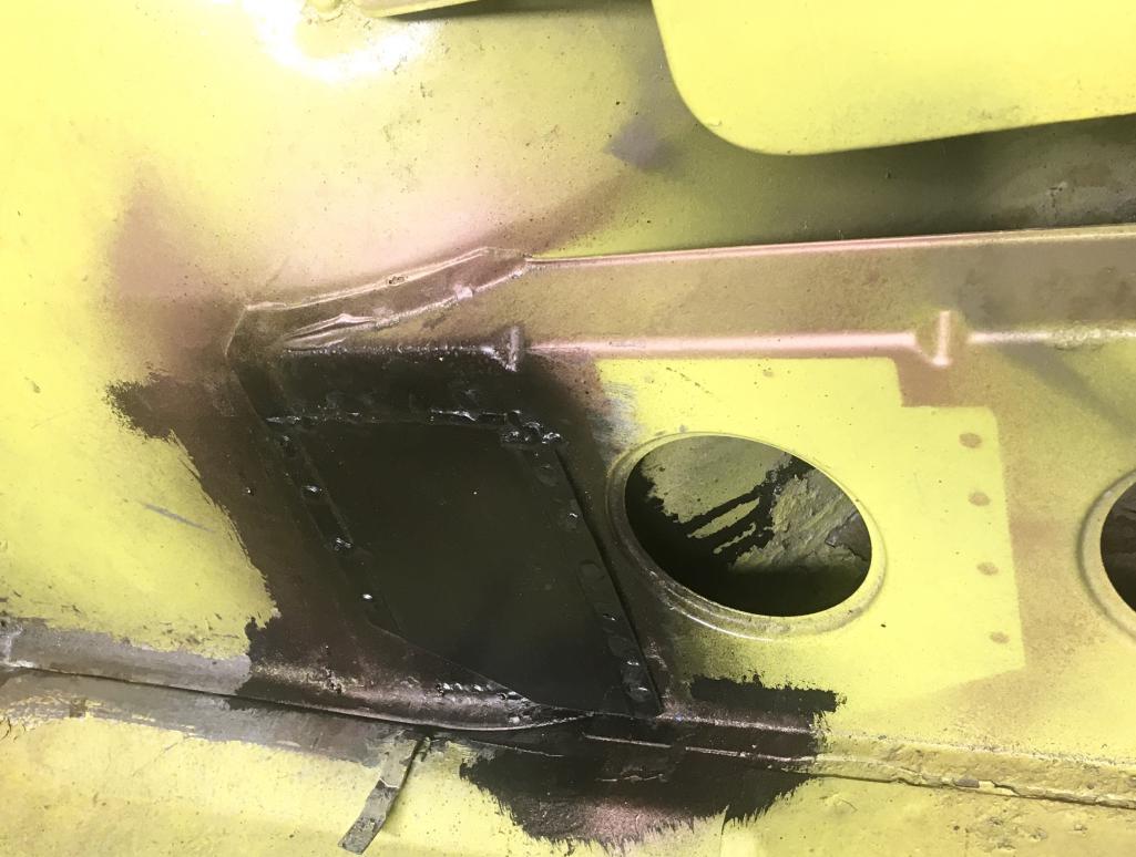

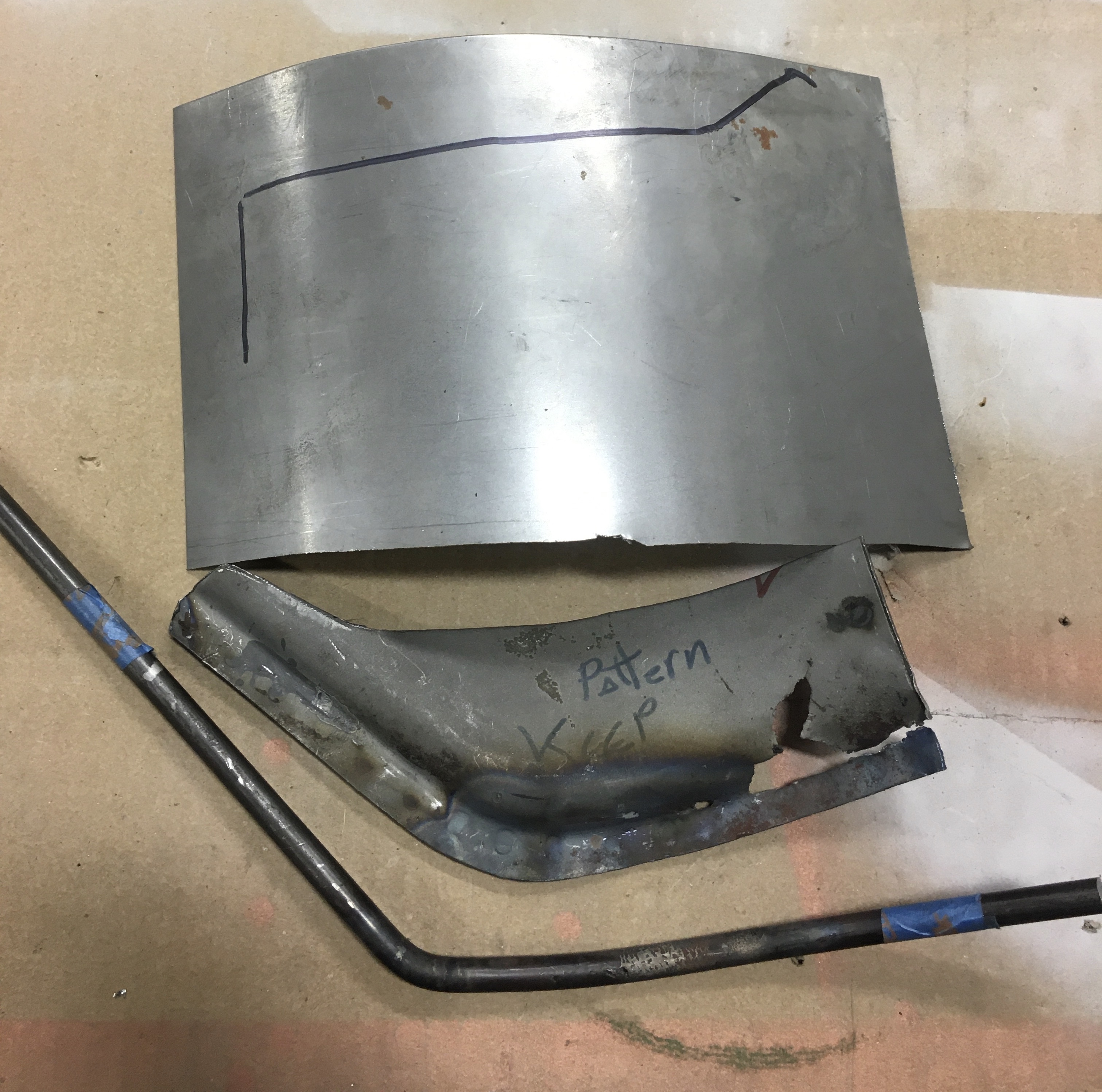

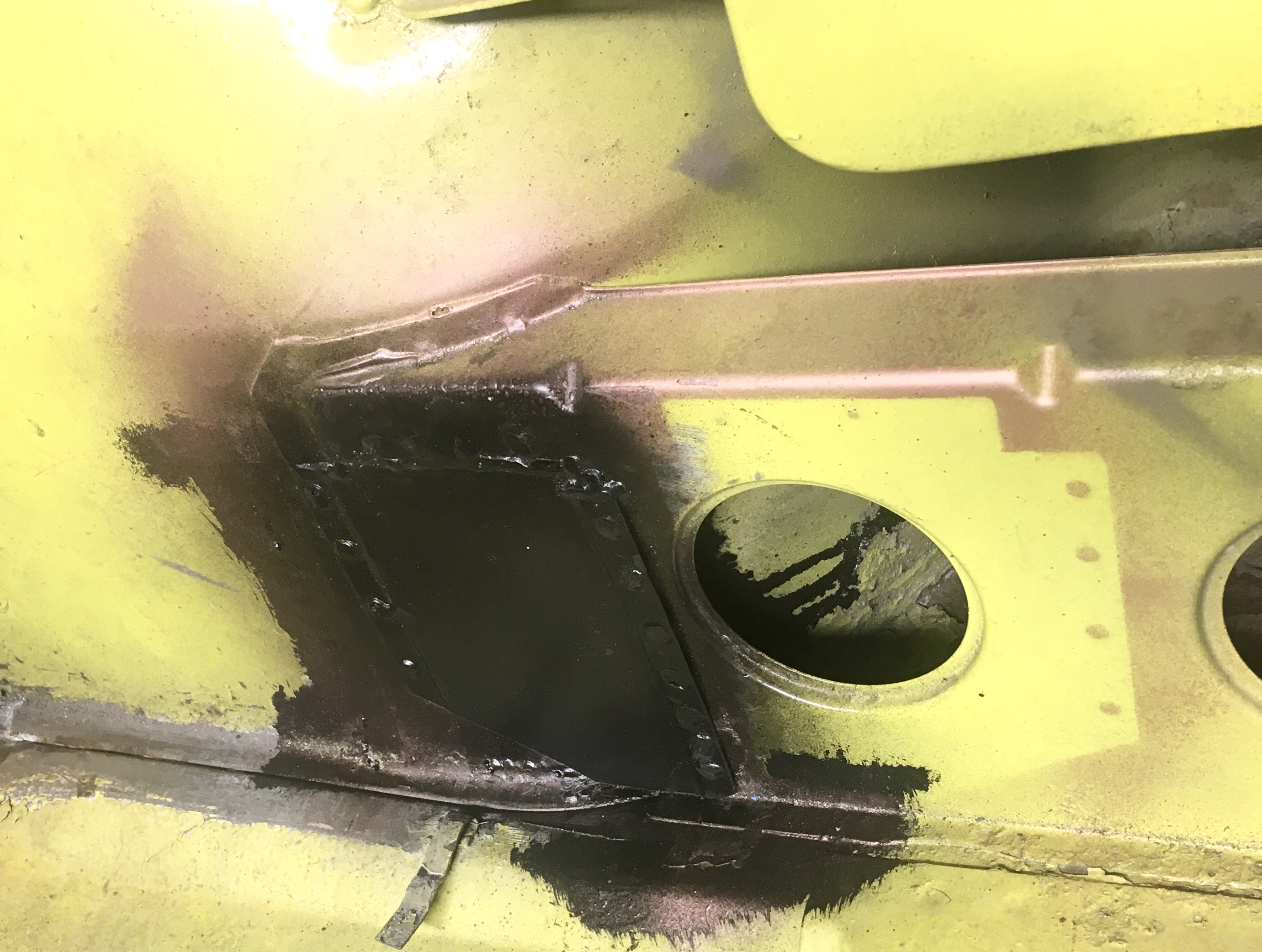

Just need to do some grinding to smooth it out, then will make the box part for the inside. A shrinker/stretcher might have made this easier,,,,,,, but I’m enjoying the challenge of trying to make shapes with what I have on hand.

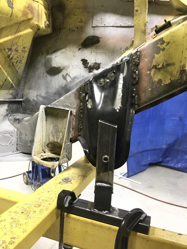

finally got around to installing my suspension console. Just need to clean up the welds and install a new bracket for the brakeline.Attached Image

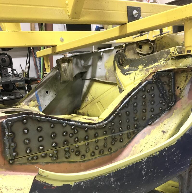

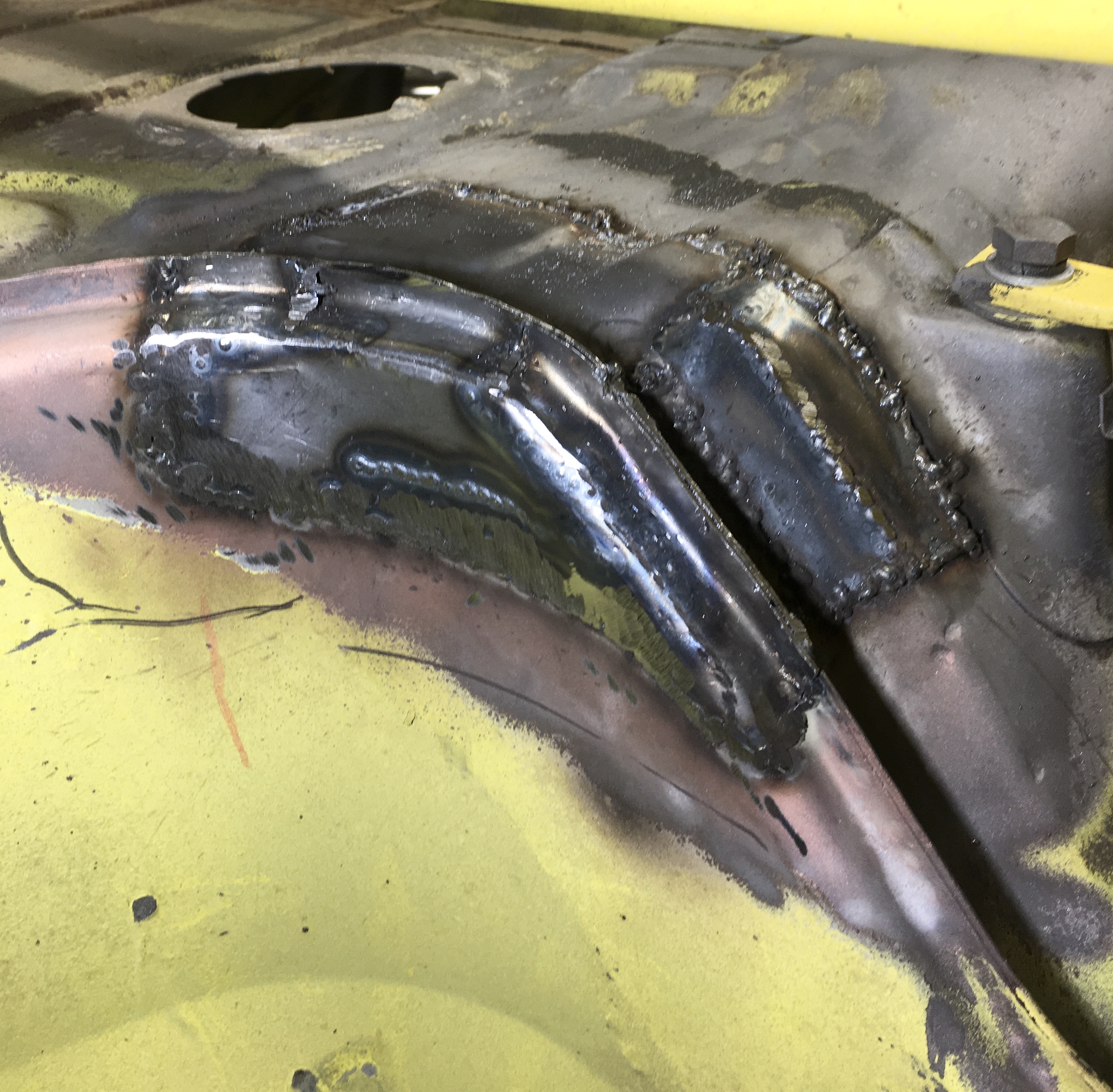

I've also started on the rear stiffening panels. ....mostly because it gives me piece of mind that the arch area above the axles has a bit of thickness added.

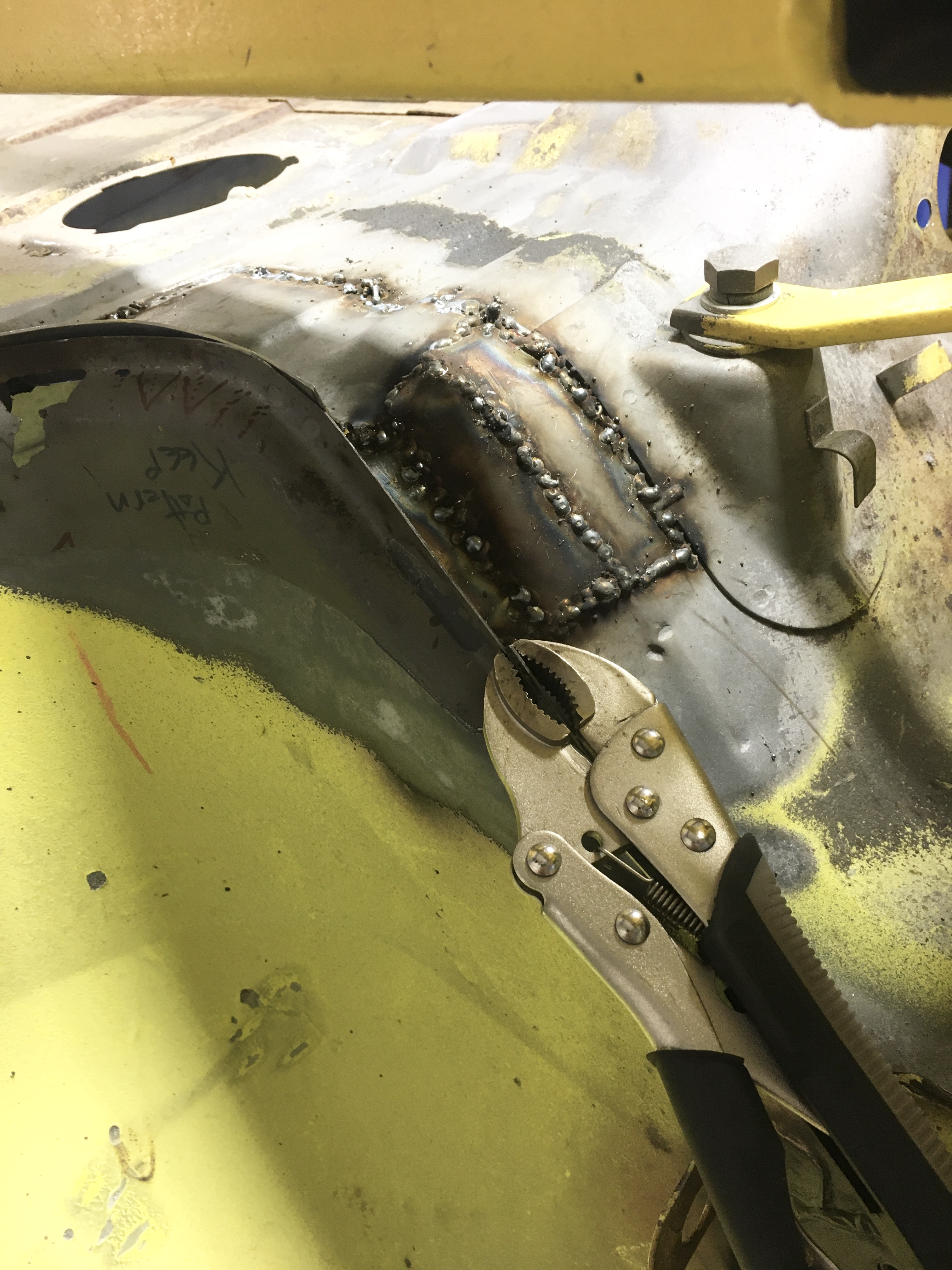

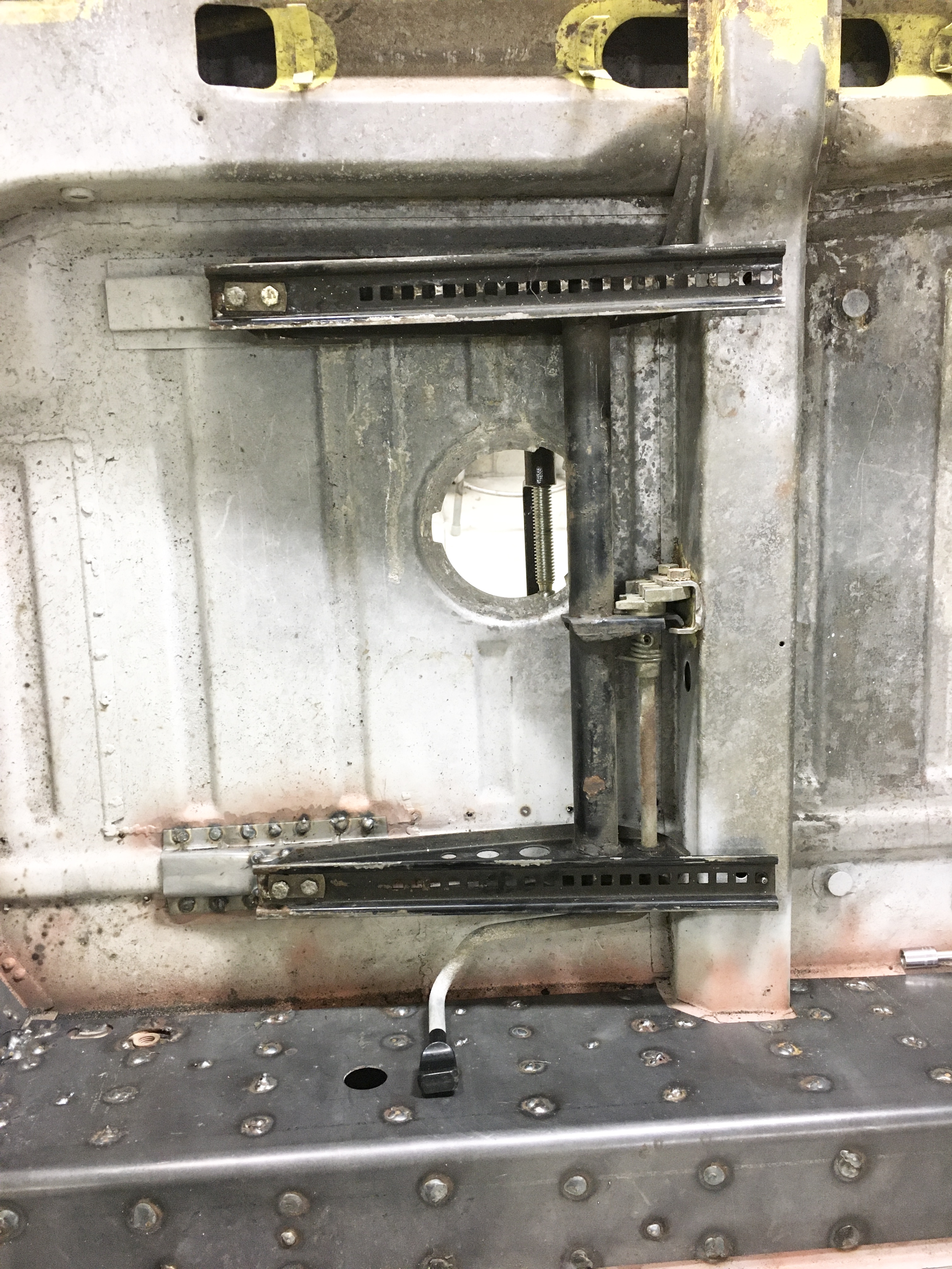

Temporarily put the pass seat bracket in place so I could locate & weld the little support hinge in the right spot .Attached Image
Just “baby steps”,,,,, but at least it’s moving forward

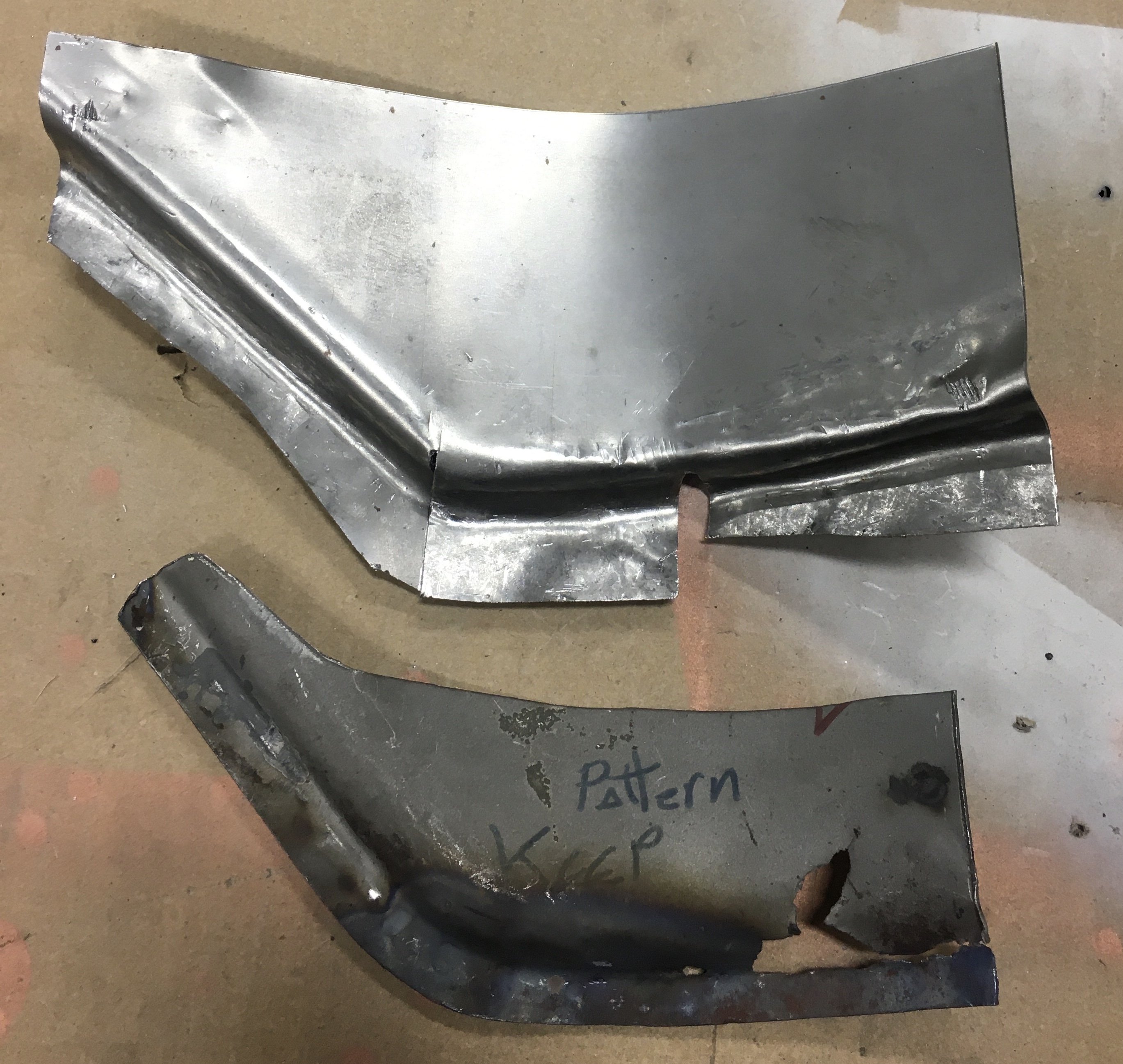

Made a quick repair on the rusted front support. I didn’t bother making it look identical to original since this area is going to end up closed in with radiator ducting.

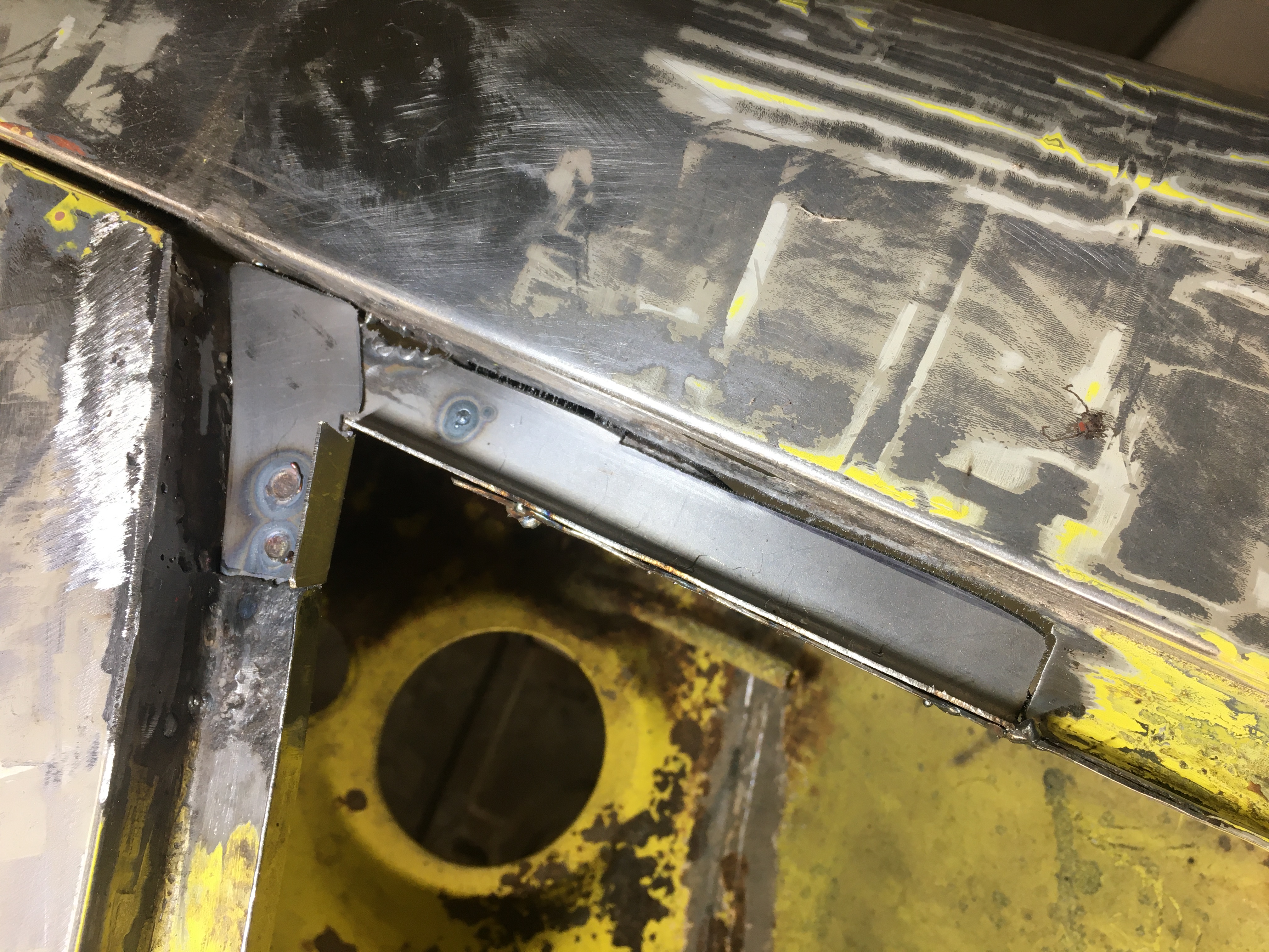

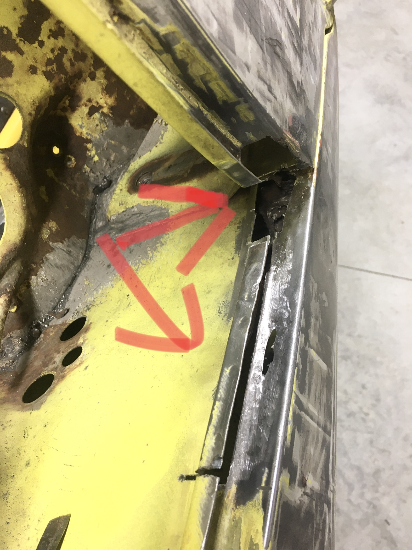

Now to try and deal with the rust in the front cowl to fender & frunk seal area.
I’ve actually been dreading this area the most as I really really don’t want to remove the front fenders. I’m going to just try to strategically clean,treat and repair with as little disturbance as possible here.
Of course the other side needs attention too. It’s definitely not as bad as some of the car’s I’ve seen though.

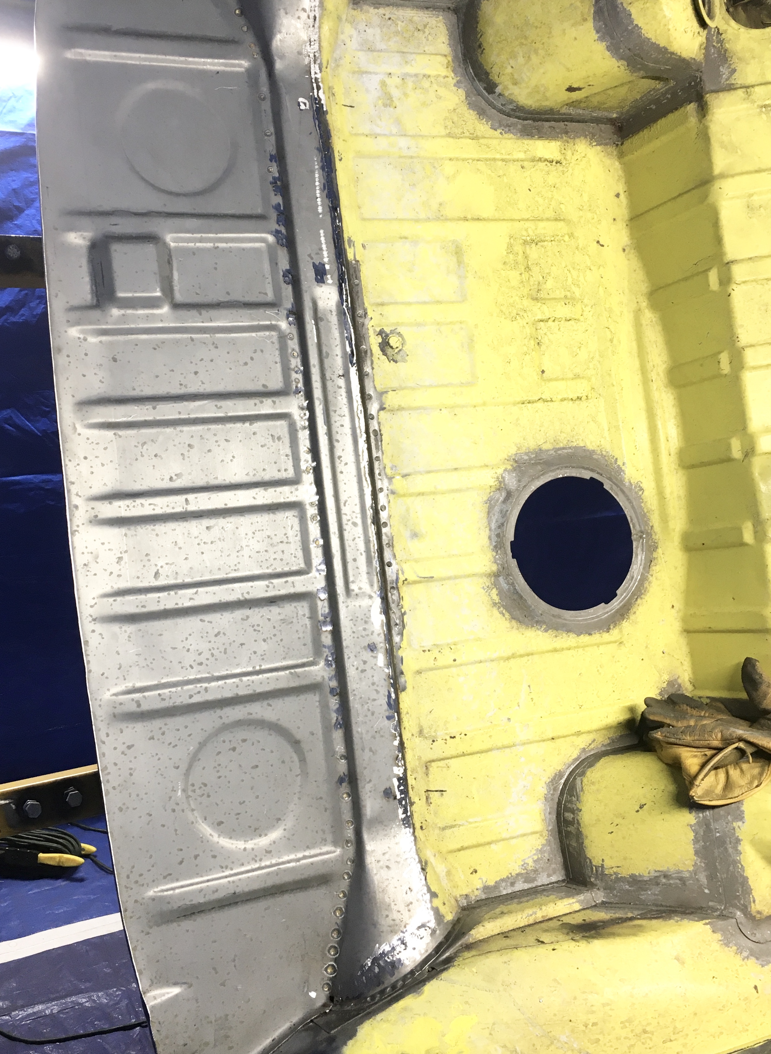

Finally fitting and welding the trunk floor piece in.

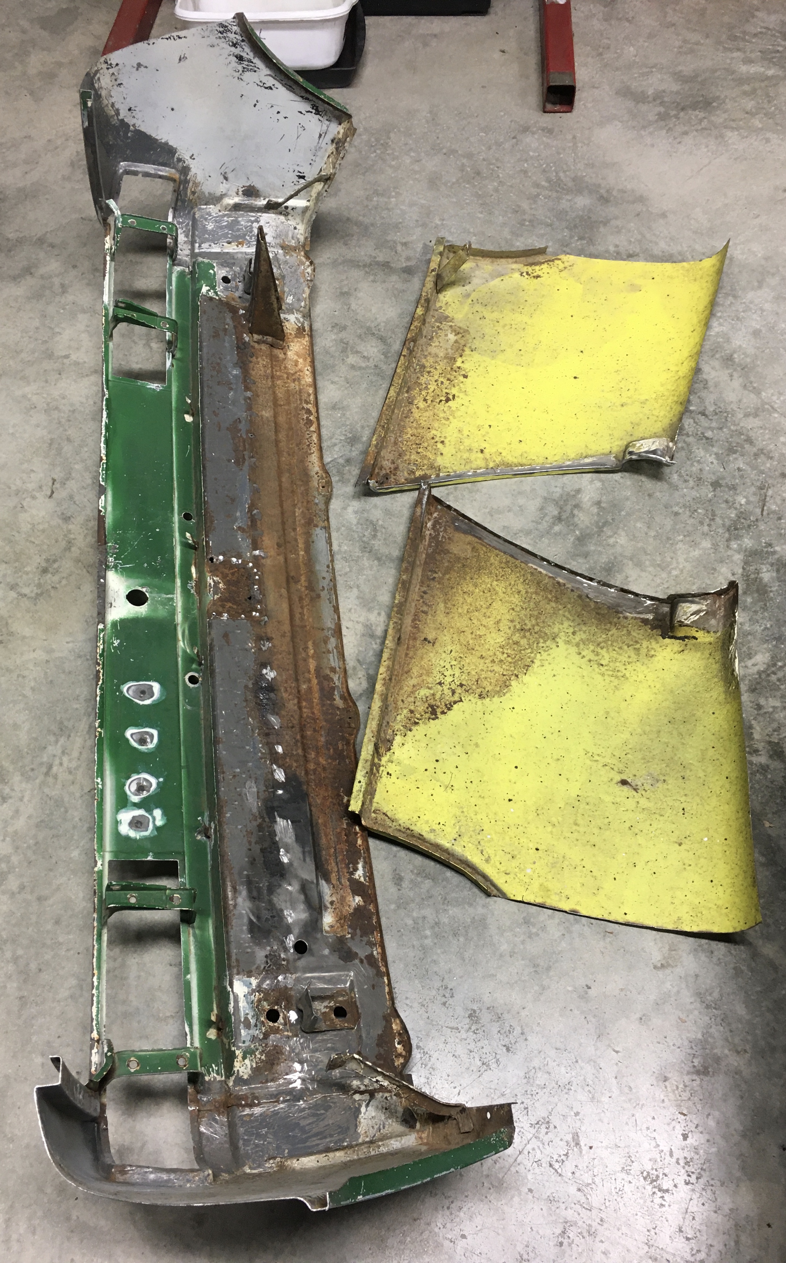

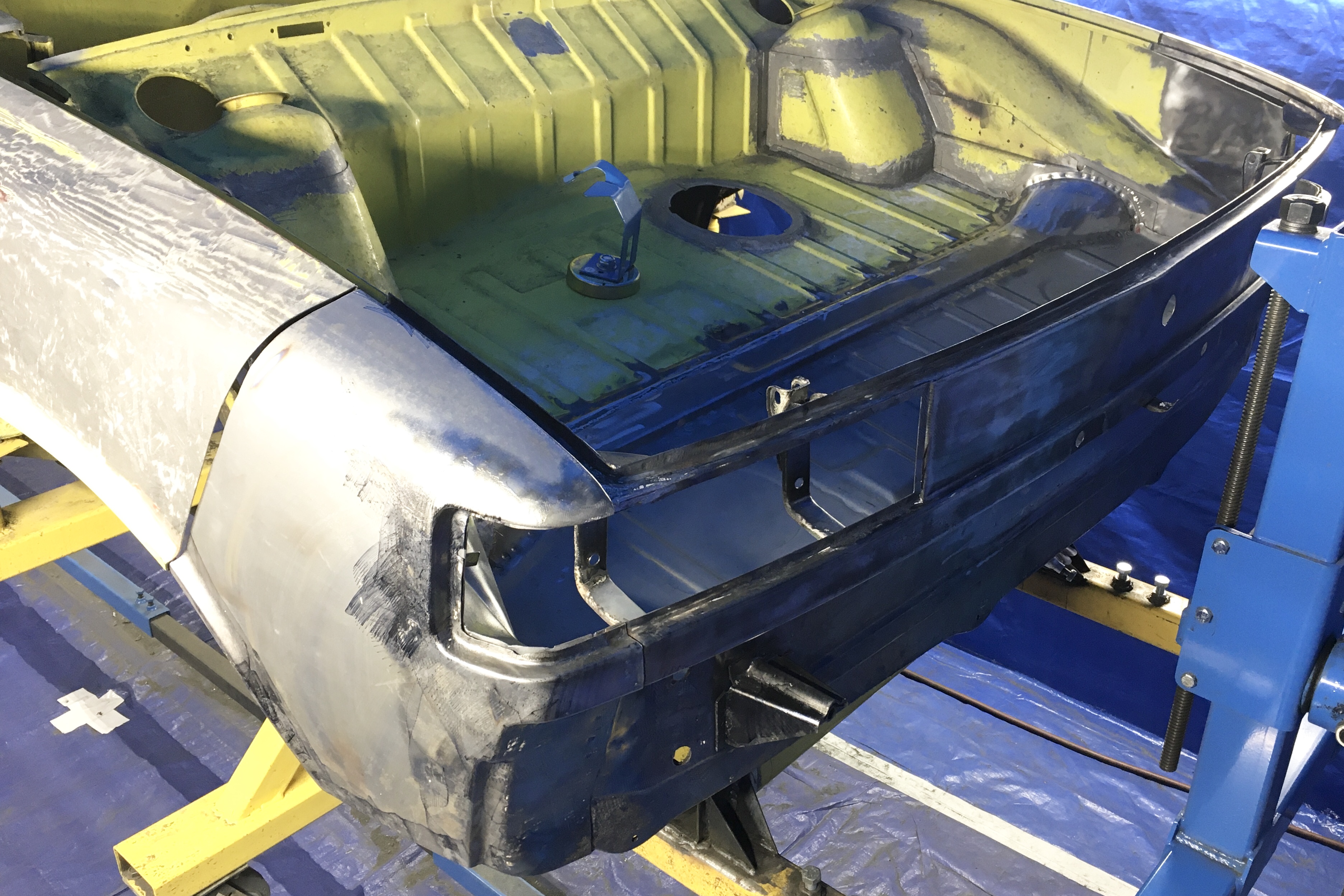

I had my donor tail panel and rear quarter pieces stripped by one of those “laser” devices. He got them stripped to bare metal, but warped my quarters so badly that I need to get some off another car. Oh well, lesson learned. Obviously that process produces quite a bit of heat.

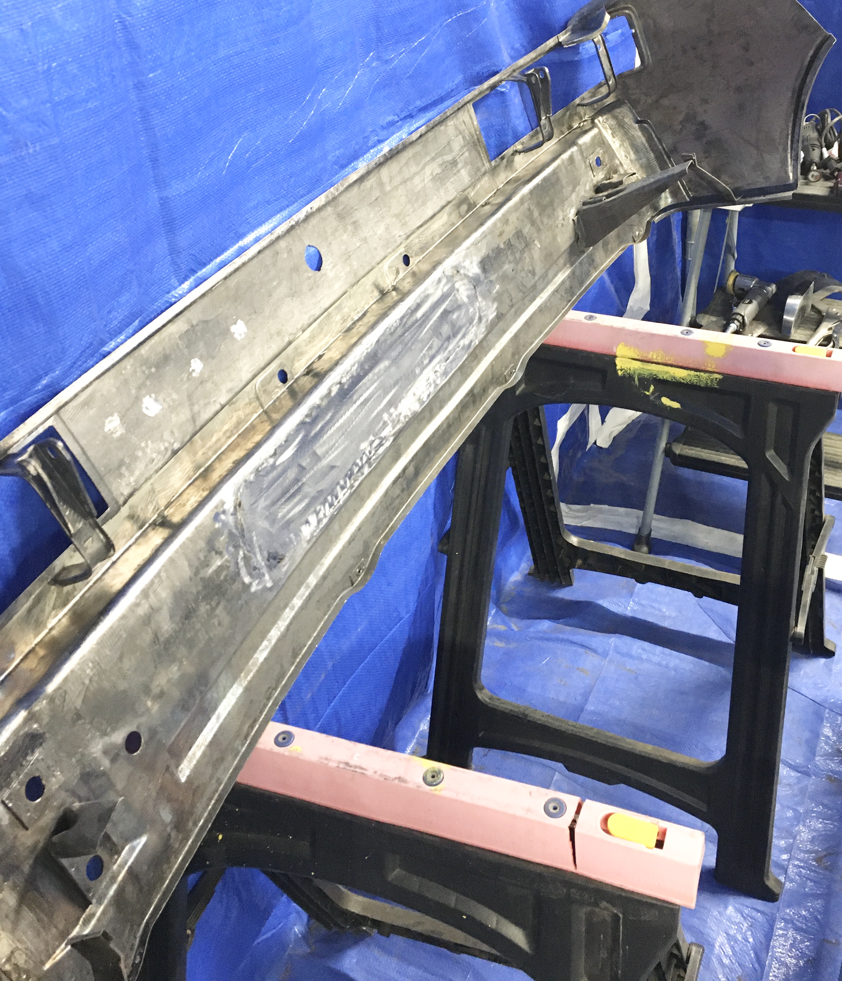

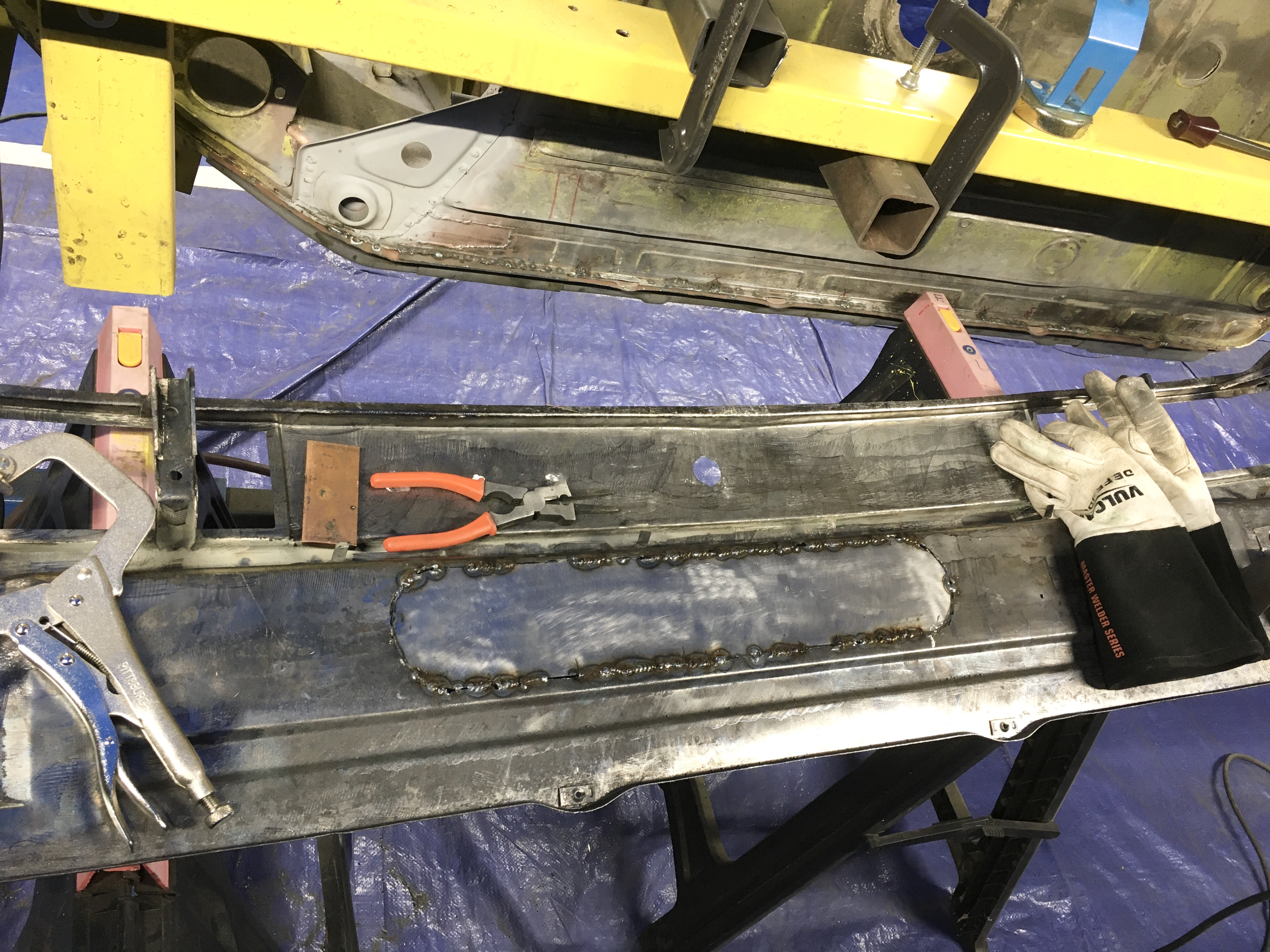

I had to patch the center of the tail panel in the bumper area because it was rusty and pitted pretty badly where it welds to the trunk pan.

I didn’t go crazy with the finish of it since the repair patch will be hidden by the bumper.

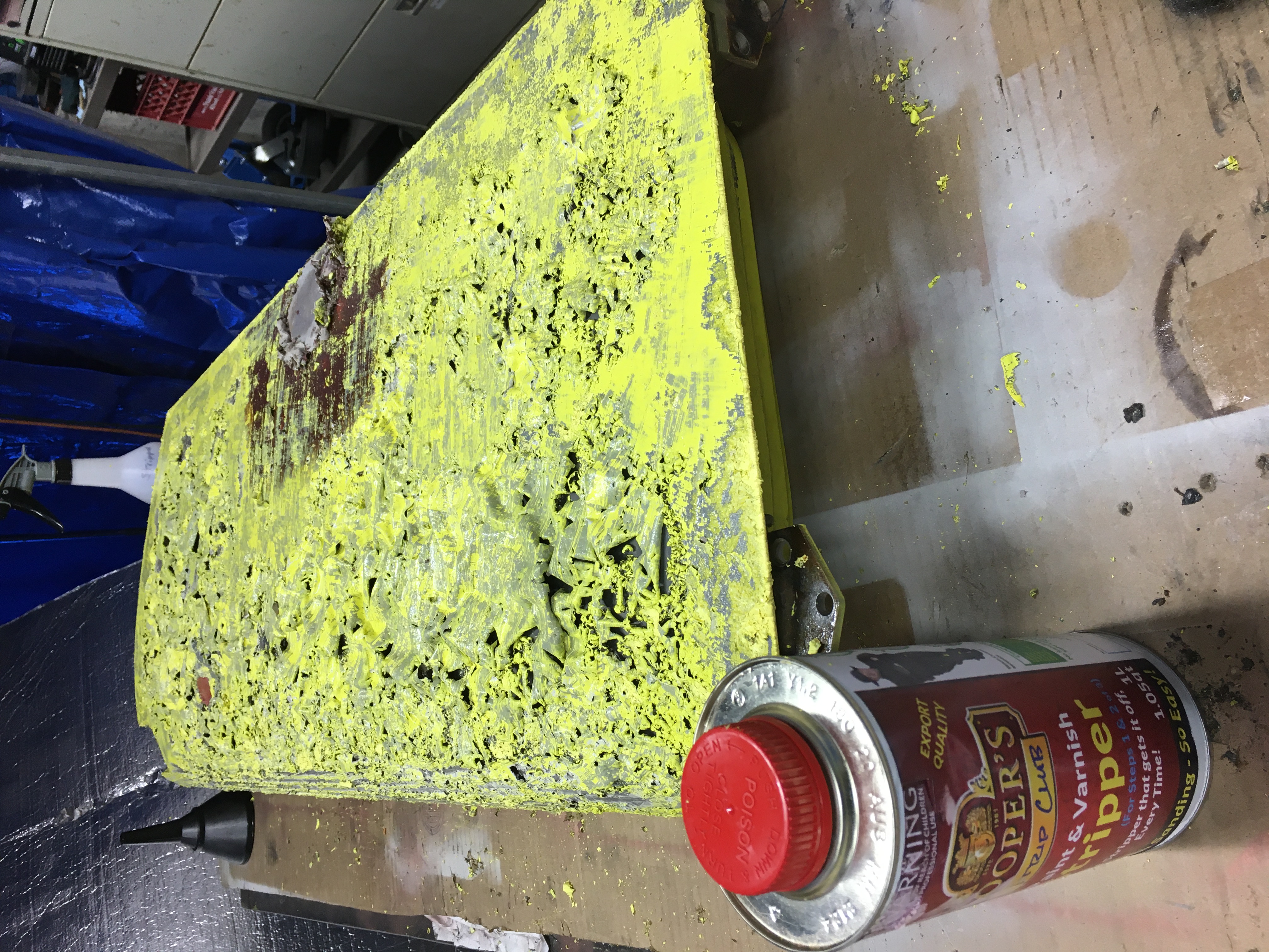

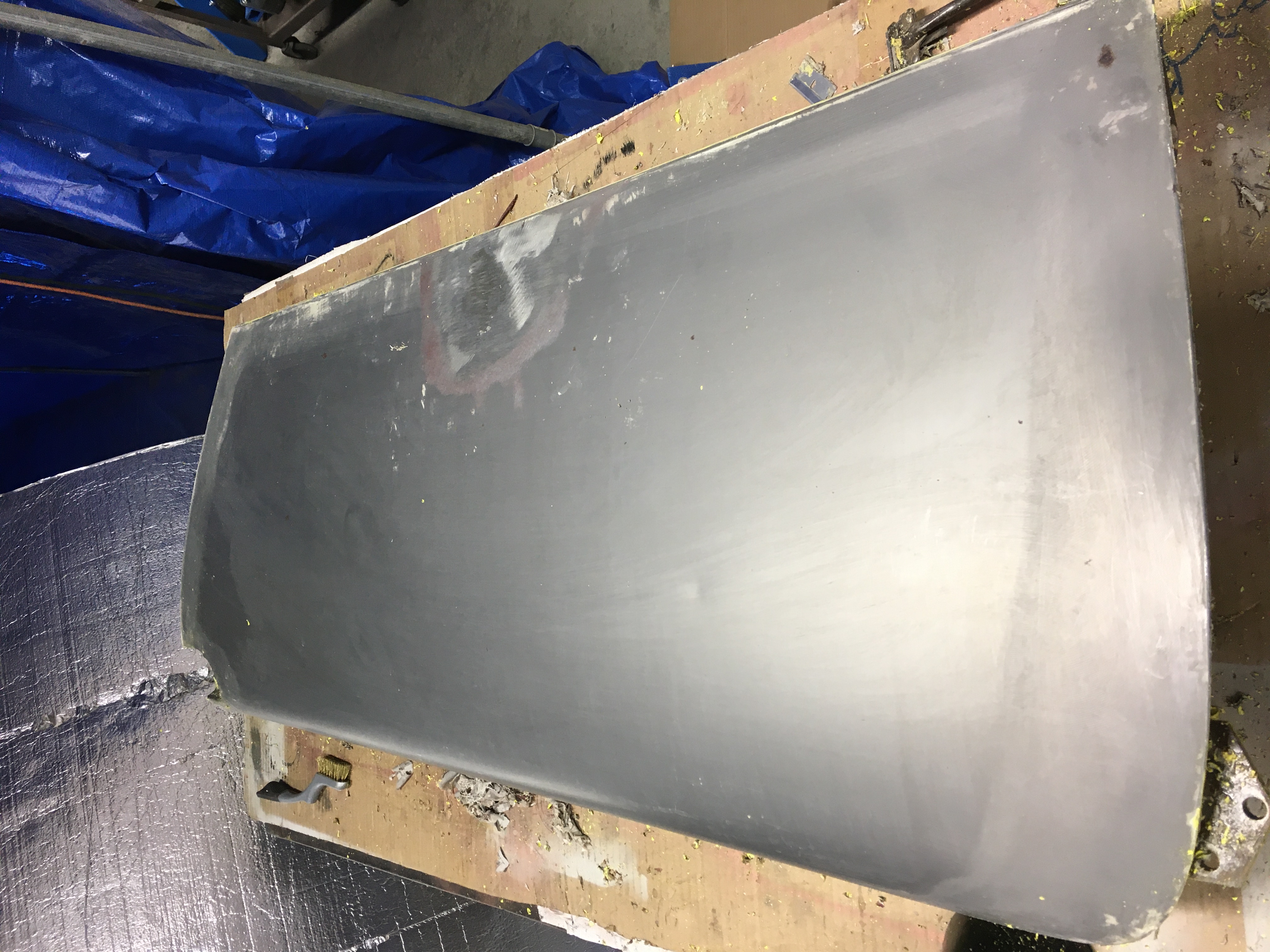

Tried out the “Coopers paint stripper”, stripped both doors and even was able to soften up/remove bondo. The stripper works good and is pretty quick to lift off multiple layers of paint.
Alain V.
post Apr 14 2024, 08:50 PM
Post #140
Posts: 212
Joined: 15-March 13
From: Kansas
Member No.: 15,655
Very happy with the results.
