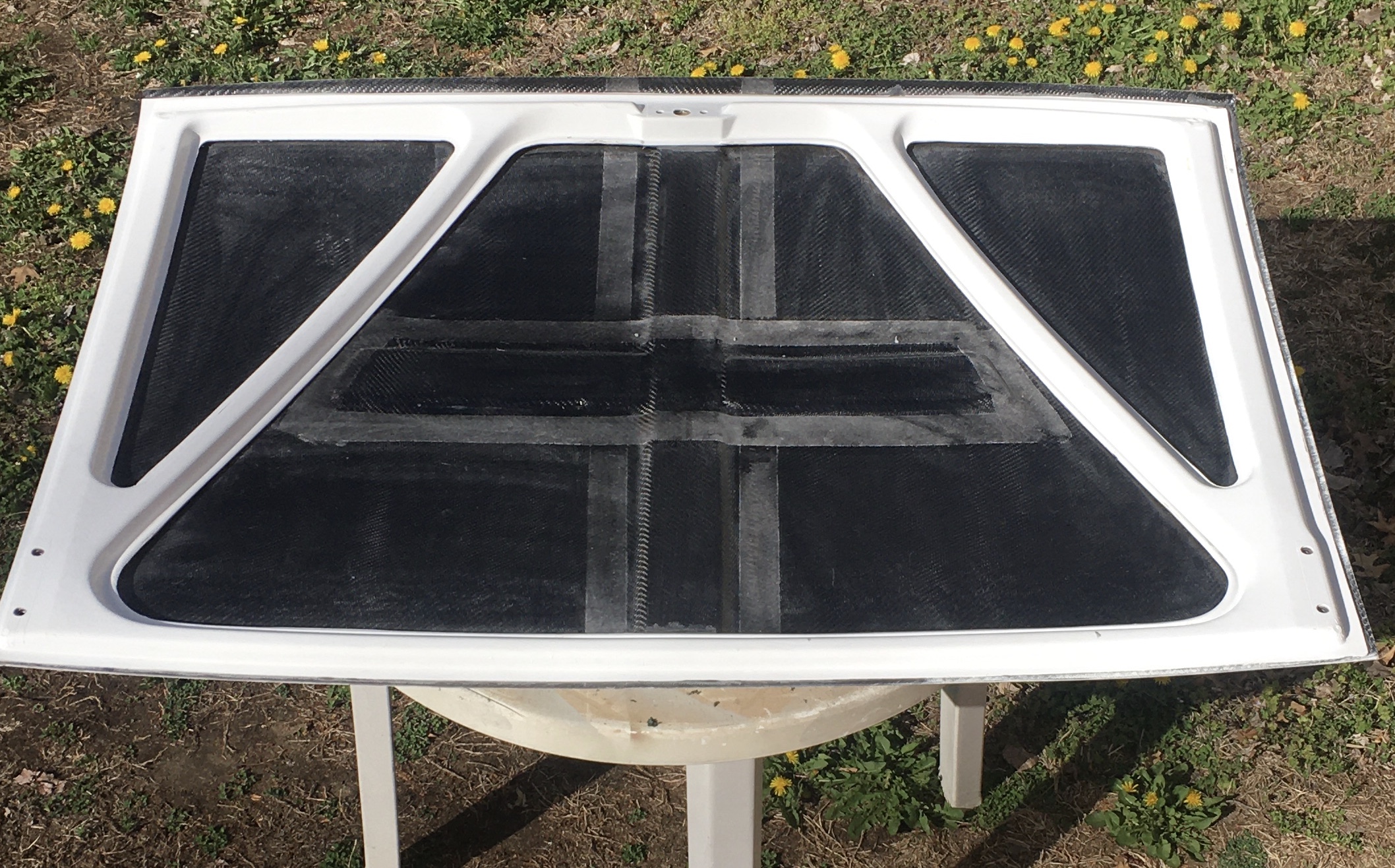

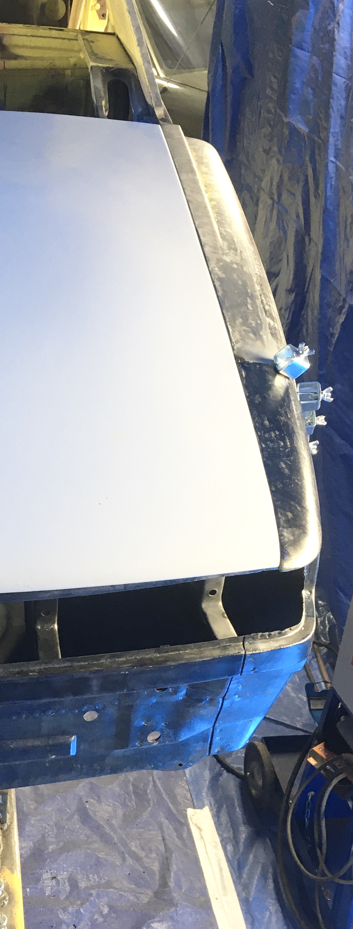

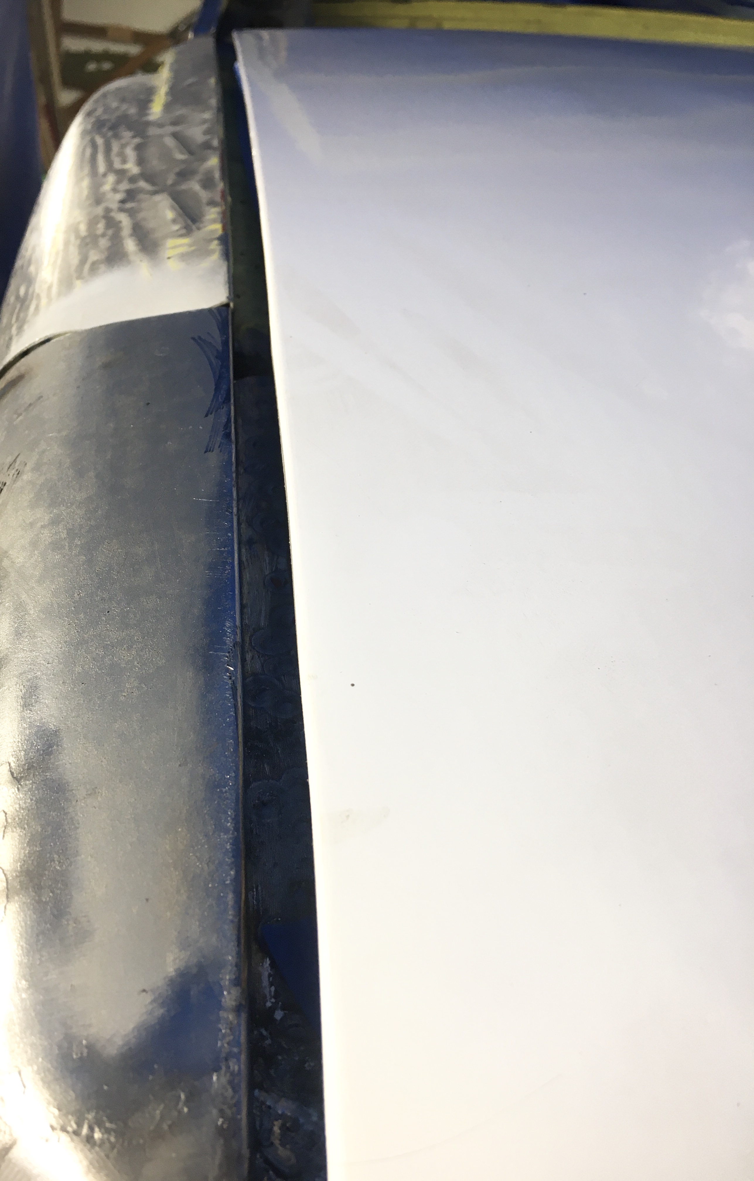

Went to test fit my carbon trunk panel, and it looks like I’m going to have to learn how to repair carbon fiber. There is a 3/8 gap on the driver side. Way too big. When I flip the trunk over, it looks like the skin was bonded on too far towards the pass side.
I wasn’t expecting a perfect fit,,,,but,,,,dang…….I didn’t think I was going to have to figure out how to add material to the skin.

Pass side fits a little tight……which is no big deal as it is far easier to remove material than add it on.Attached Image

Looking from the bottom, it looks like the skin must have shifter towards the pass side when bonded to the framework.

Yep. It should not be on you to repair poor craftsmanship. Bummer

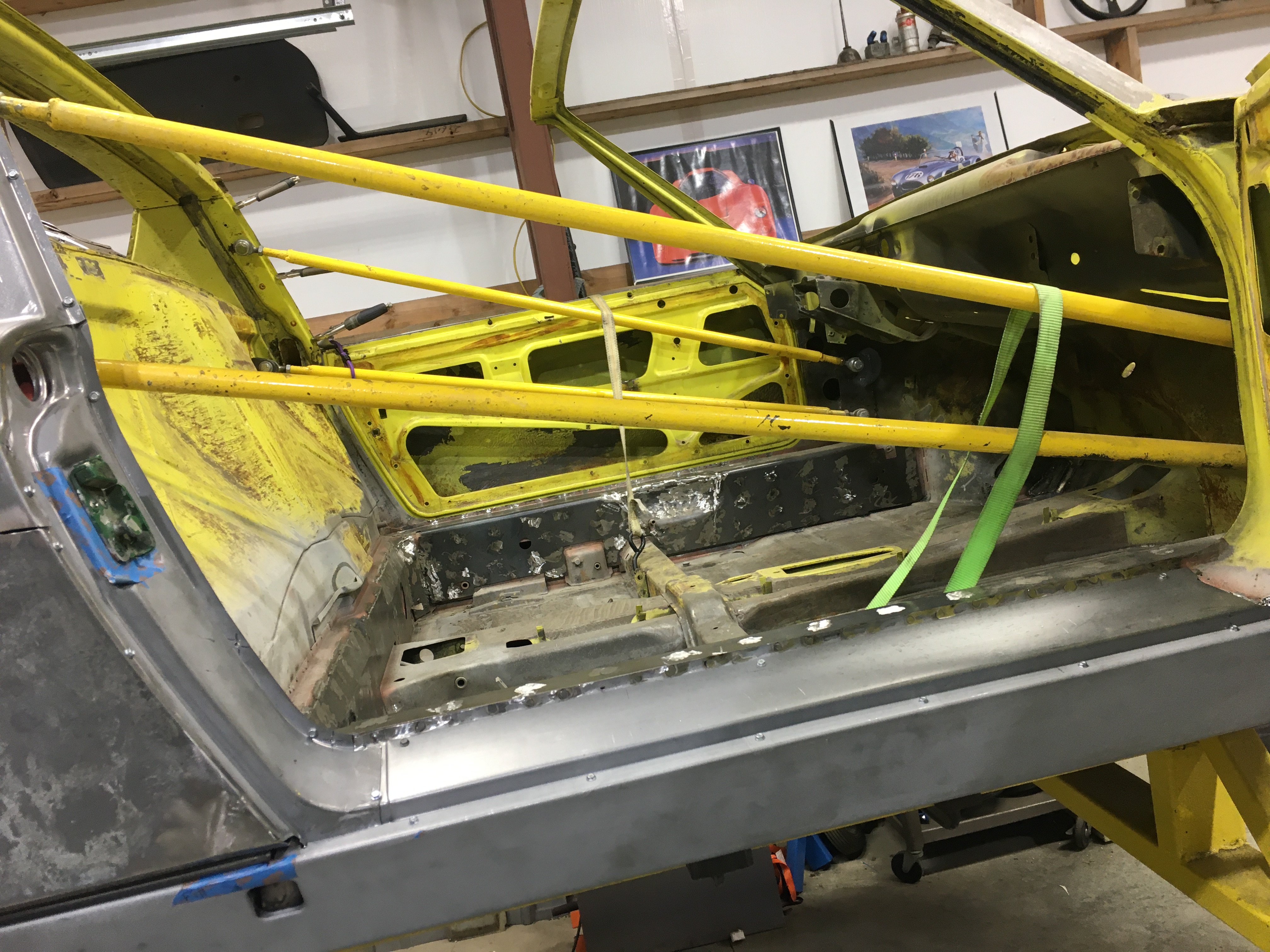

I decided to finish up all of the metal work first, before messing with the carbon trunk lid.
I temporarily reinstalled both doors so I could set the front gaps and start fitting the sail & quarter panel sections.

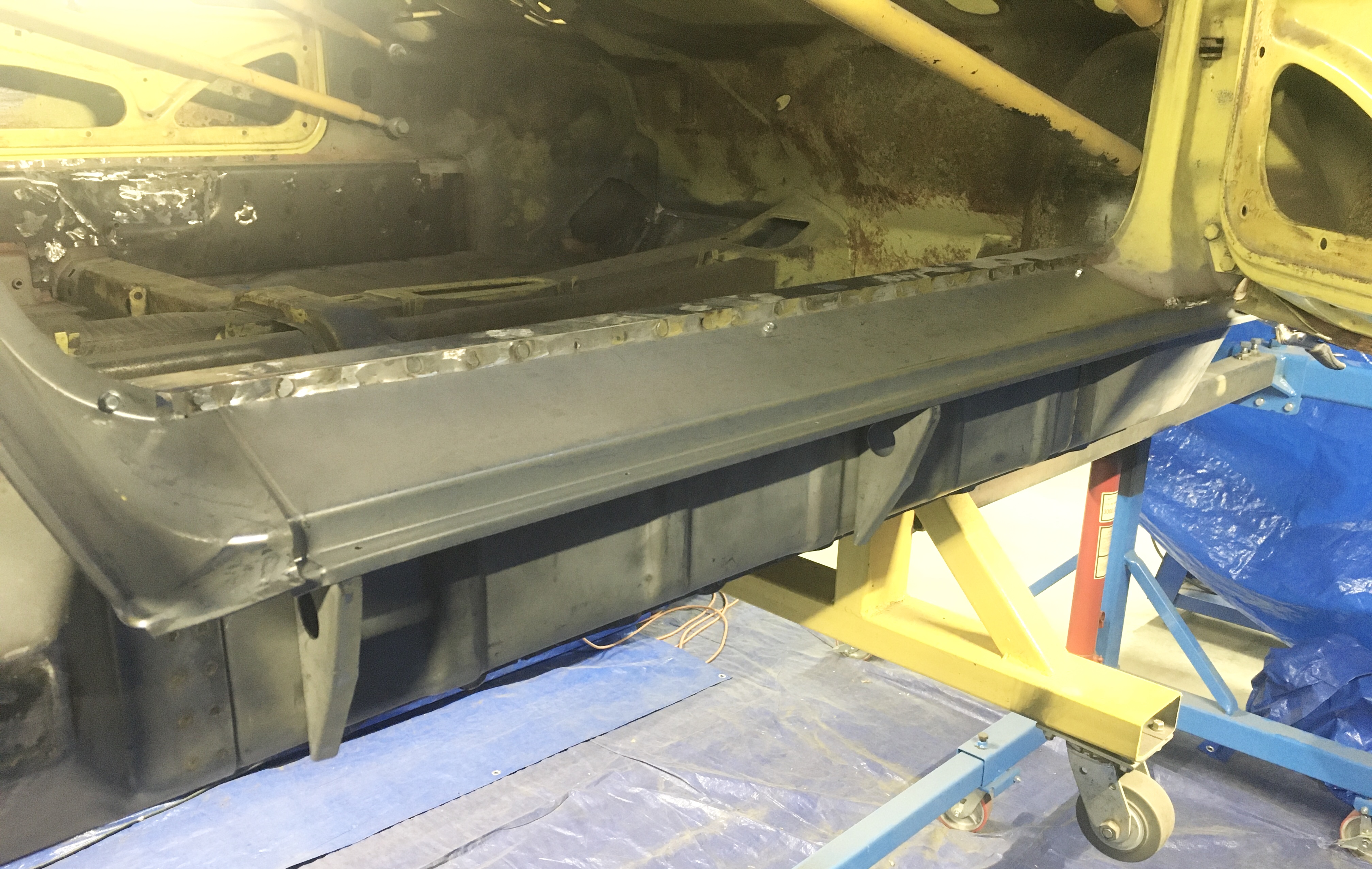

Also started test fitting the door sill.

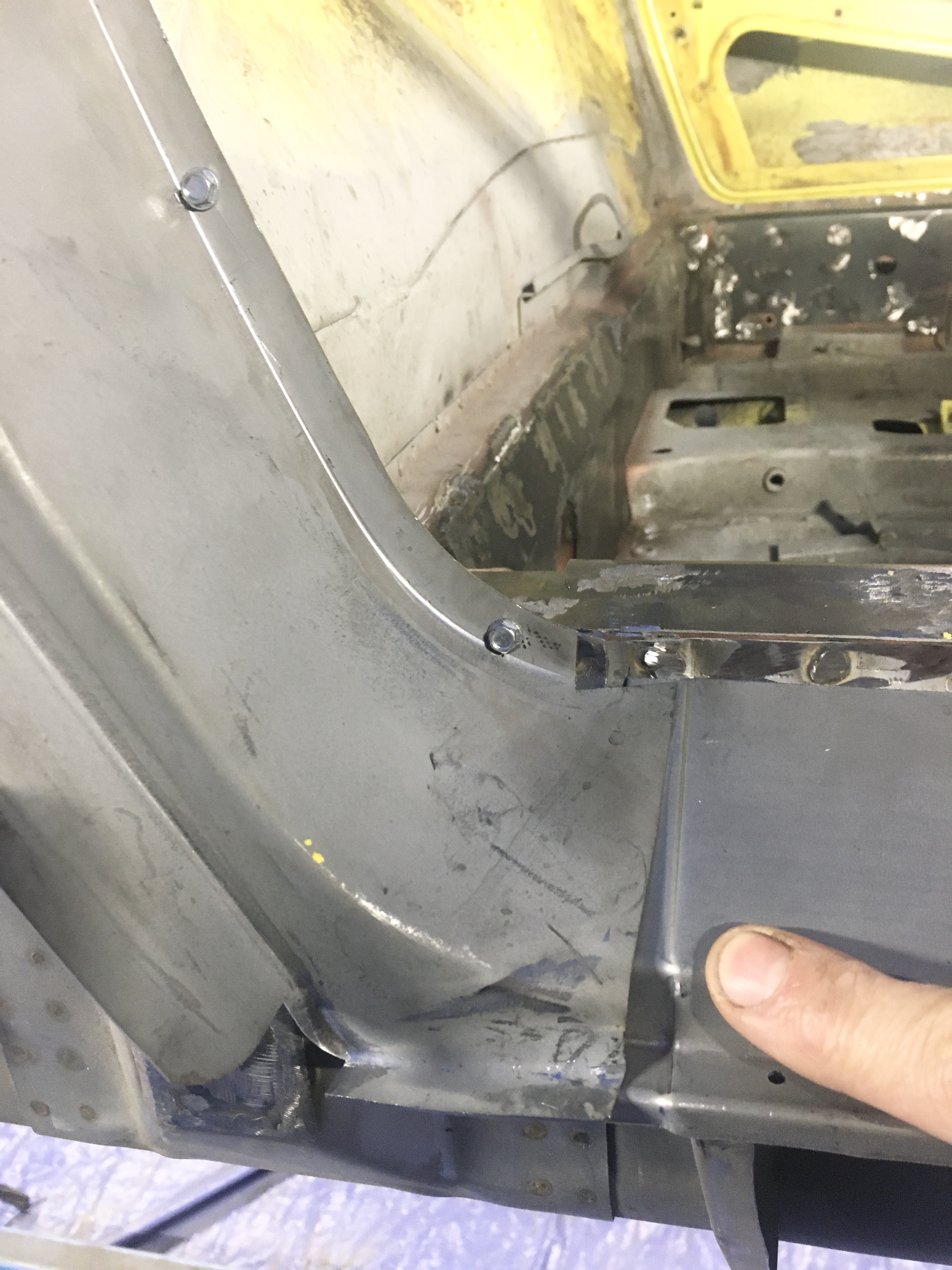

Ran into a bit of a hiccup at the bottom of the door jam here. Looks like I’m going to have to put a slit in it and narrow it a little. Been staring at it trying to find the best way to approach this.

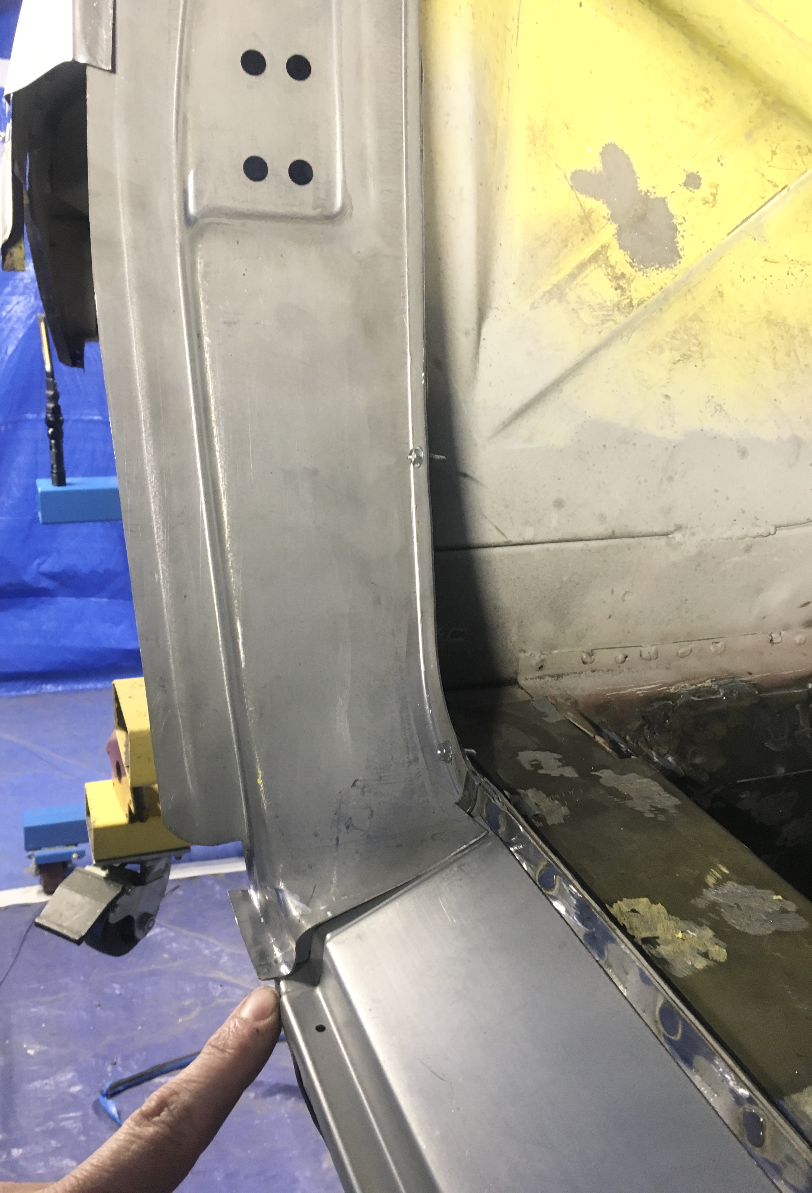

Here you can see how the bottom is hanging out too far. I’m going to try and take a look at another car and see where I need to adjust mine.

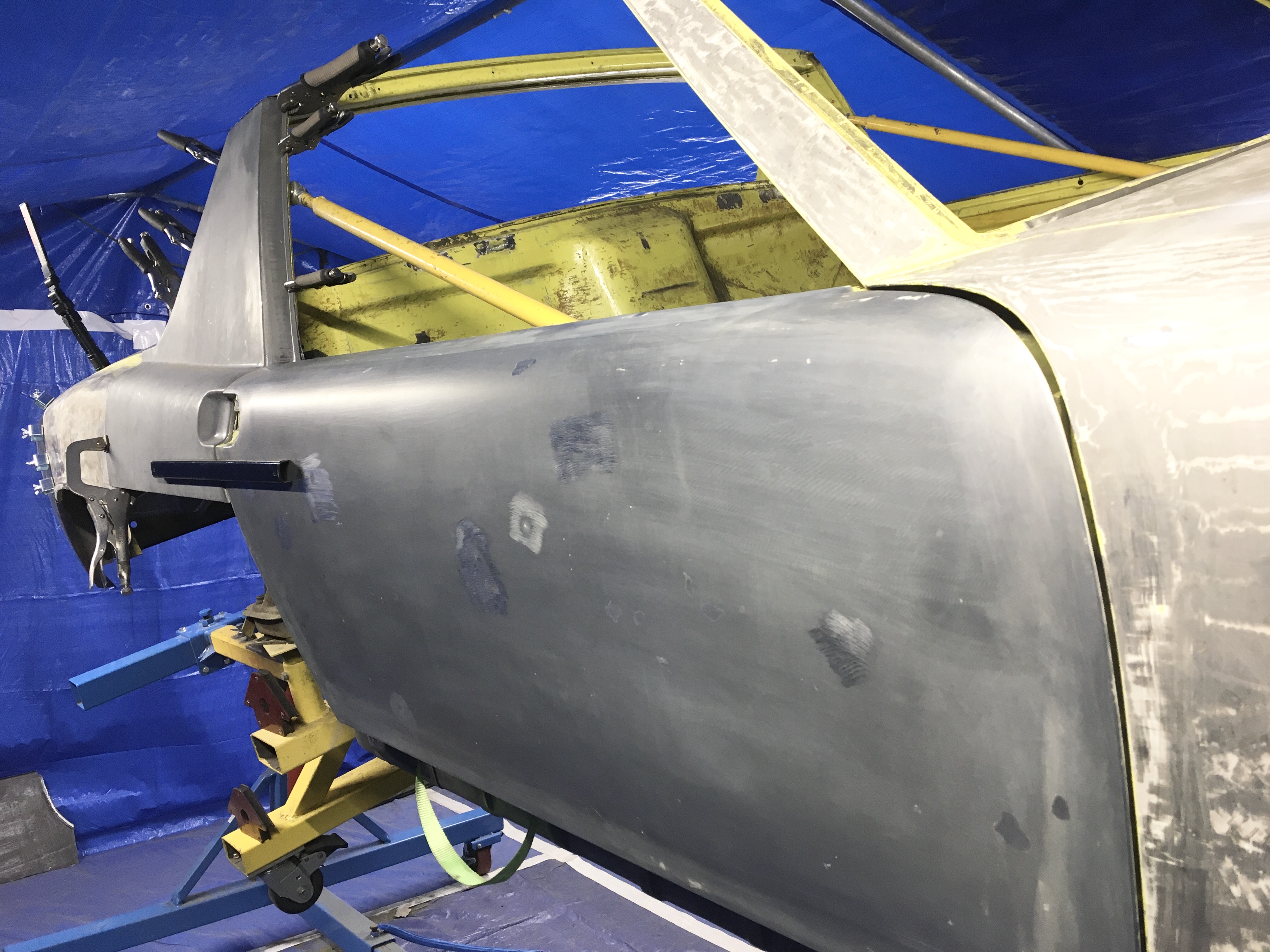

Did a little twist here and a little tweak there & everything seems to be fitting better now.
Going to start mocking up the flares on this side now and then flare the ends of the rocker panel to fit, before moving on to the driver side.
Haven't had much time to work on it in a while, but looking forward to getting back to it.

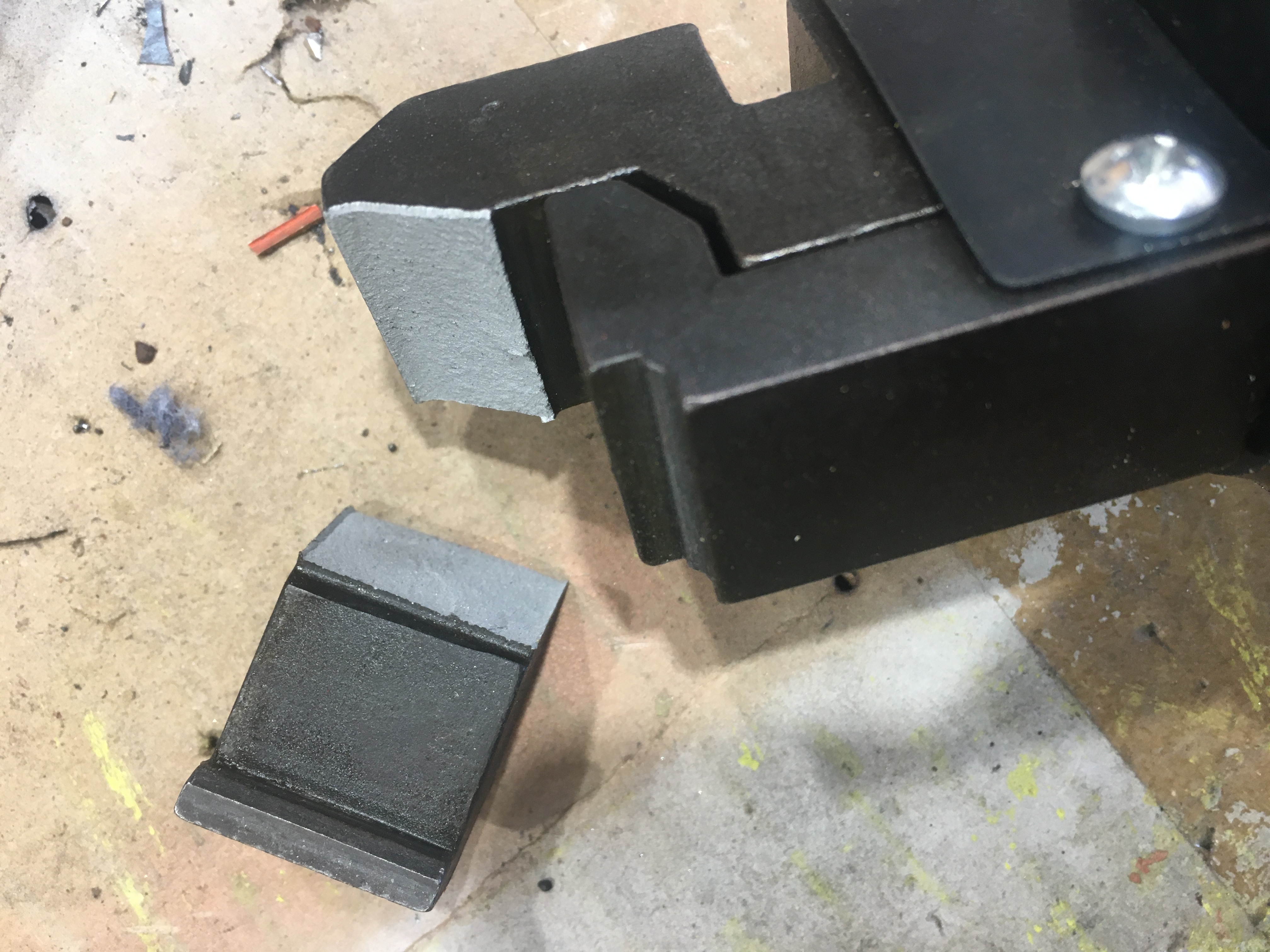

managed to work a little on the 914 this weekend.
Got this cool "panel prep tool" from eastwood that puts a slight taper on the edge of your panels before welding. Cuts down on the grinding and was excited to try it out.
I managed to test it on a piece of scrap, then wanted to use it on the bottom edge of my new sail panel to quarter panel seam. Plugged in the tool, pulled the trigger, and poof.... the top of the arbor broke clean off and shot across the garage floor.
Oh well, I sent an email to eastwood and will see how well their return policy works.

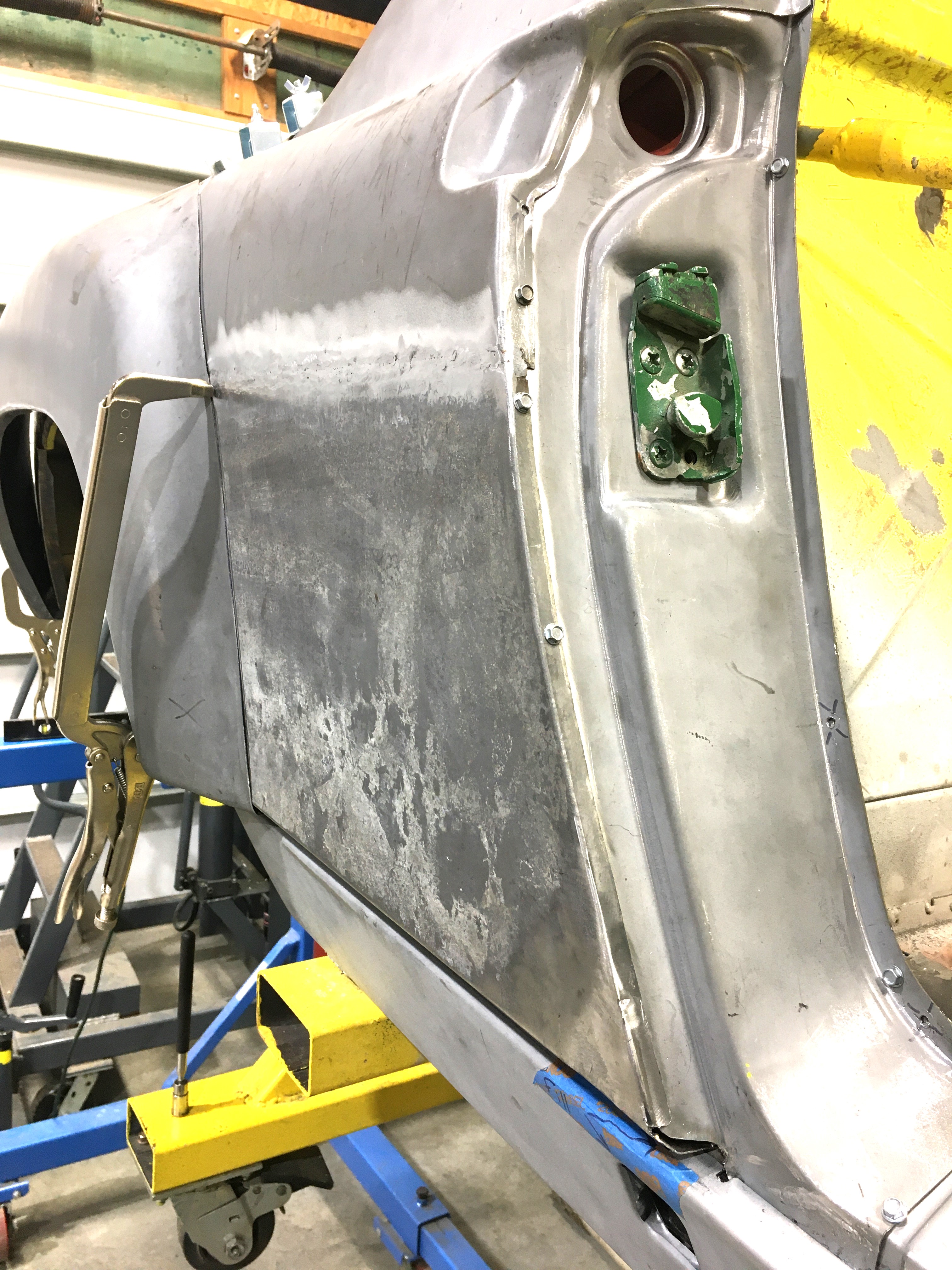

I did manage to get the pass side sail panel to quarter welded to each other,,,,,now just need to do the driver side.Attached Image

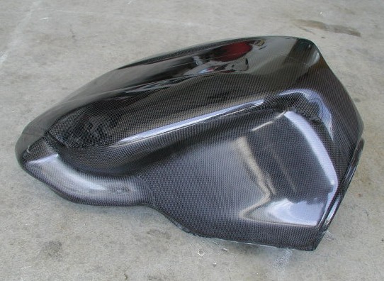

I've done some composite work and working with carbon fiber is essentially the same as working with fiberglass. You may want to check w/914 Rubber and ask which resin type they used. I'd assume epoxy but good to be sure.
I've had good luck with West Systems epoxy products and can highly recommend.
You may also want to check out www.fibreglast.com for other supplys you may need.
If I can be of any help, if you'd like to talk in more detail, PM me and we can work out a time to talk.
And because you guys are always: (IMG:style_emoticons/default/thisthreadisworthlesswithoutpics.gif) , here's a pic of a carbon / kevlar tank I made for a bike build I did.
