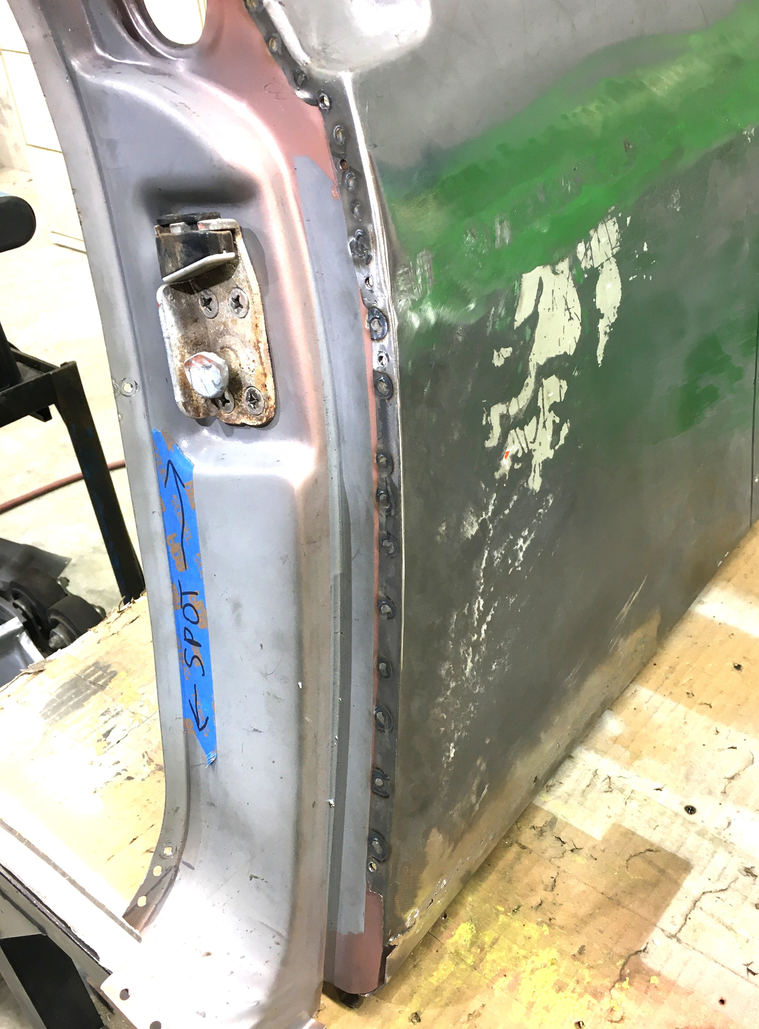

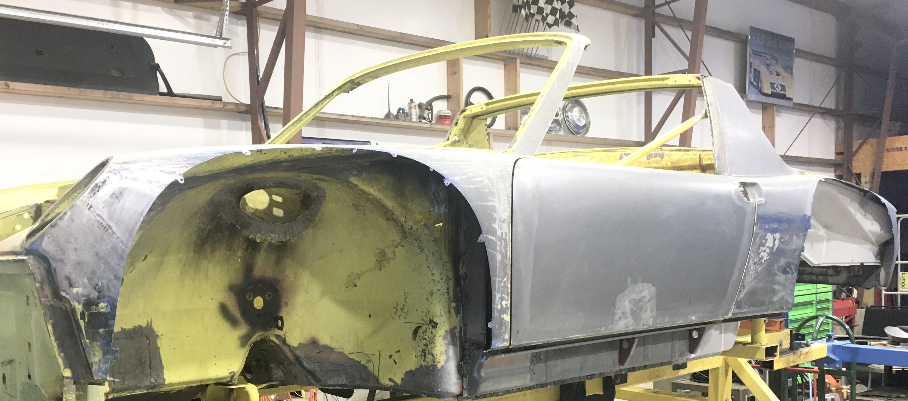

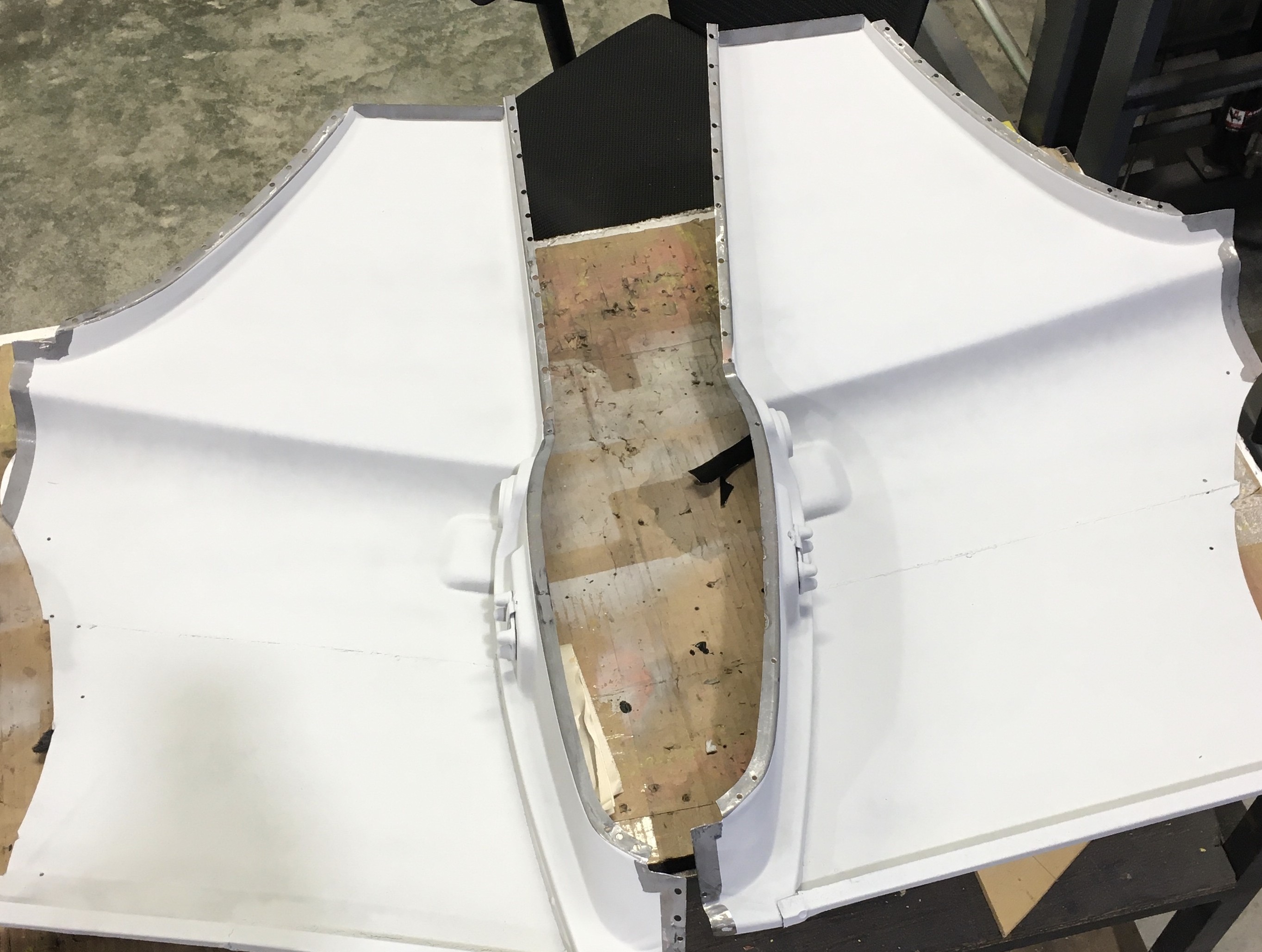

decided to attach to door jam to the quarter panel first, then attach the assembly to the car. Need to do a little repair at the bottom gap on each side.

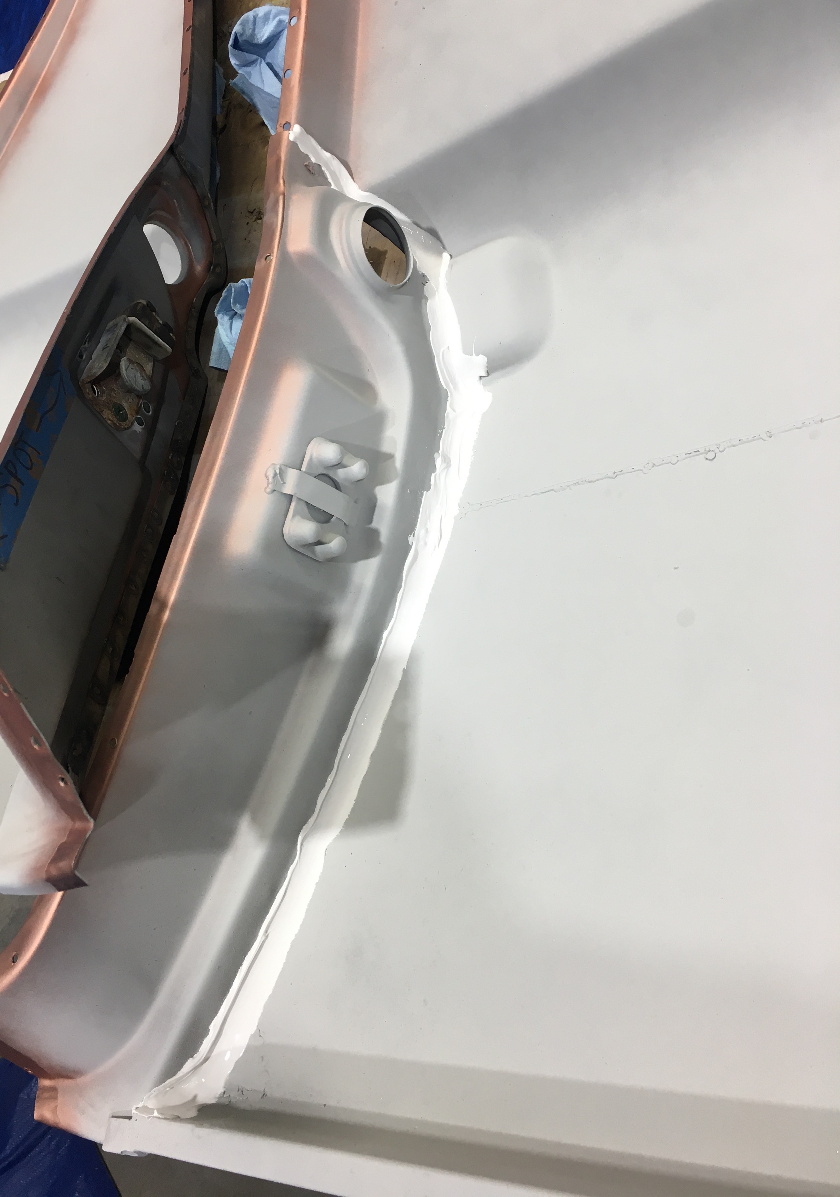

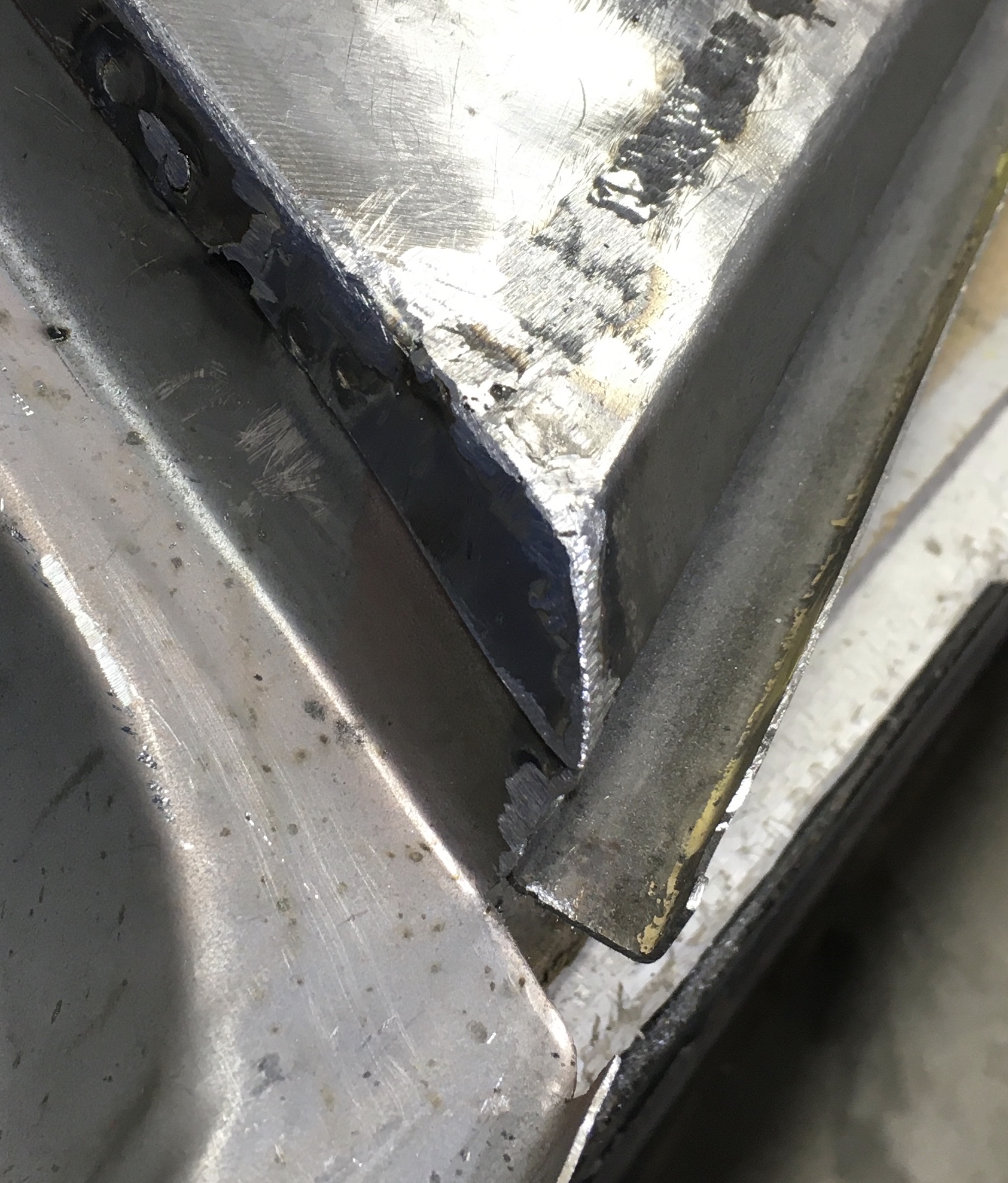

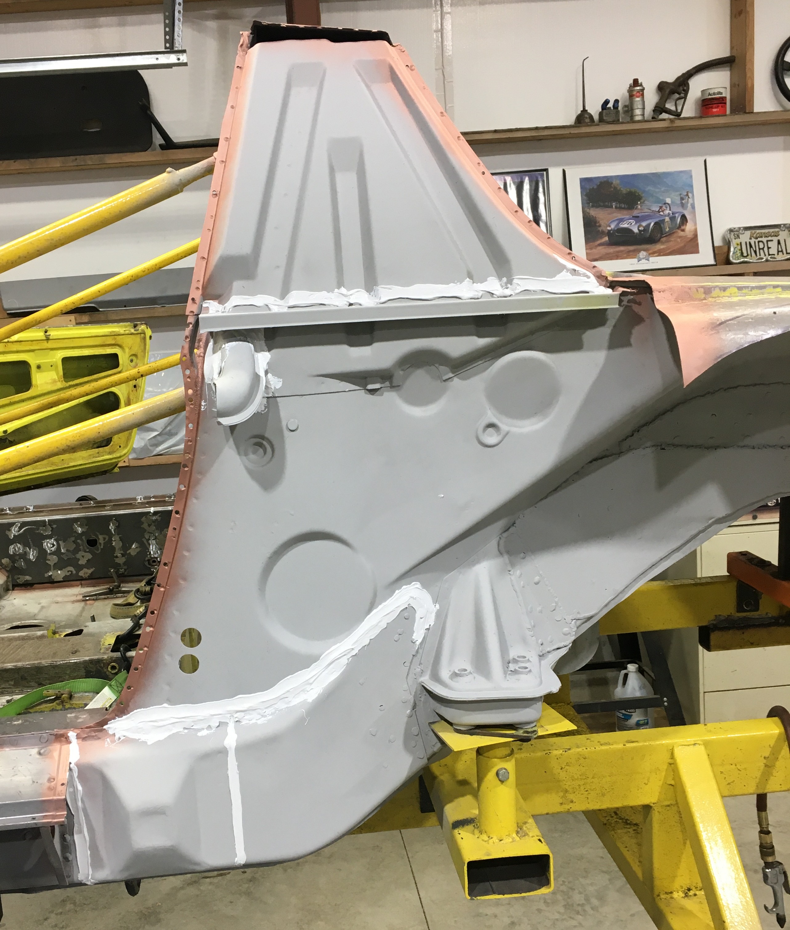

since the backside of the sail panel would be nearly impossible to get to once installed, I prepped and coated the inside them with epoxy sealer/primer

I also applied some seam sealer in the door jam area since it is easier to reach now.

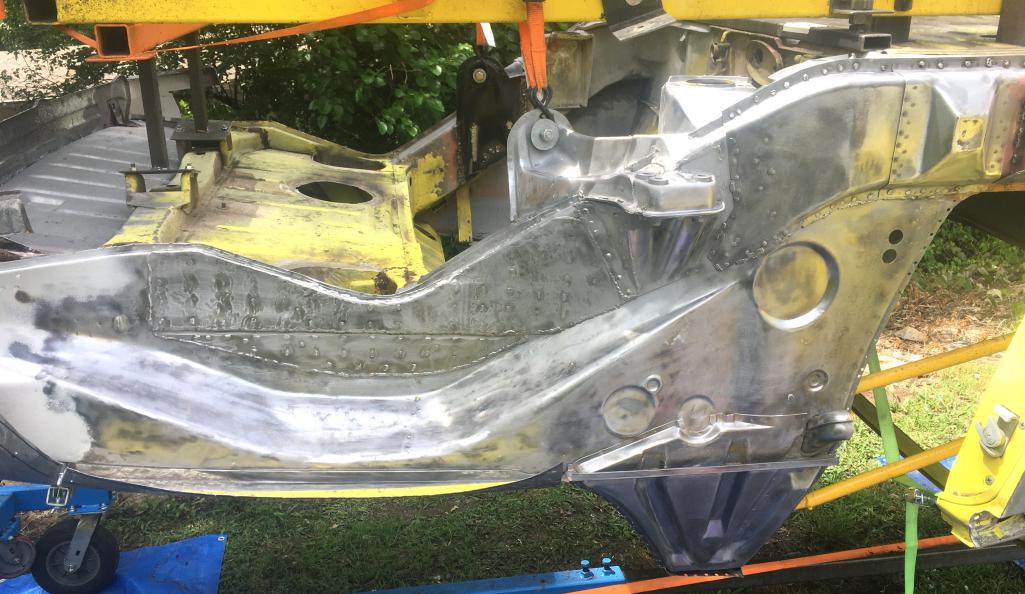

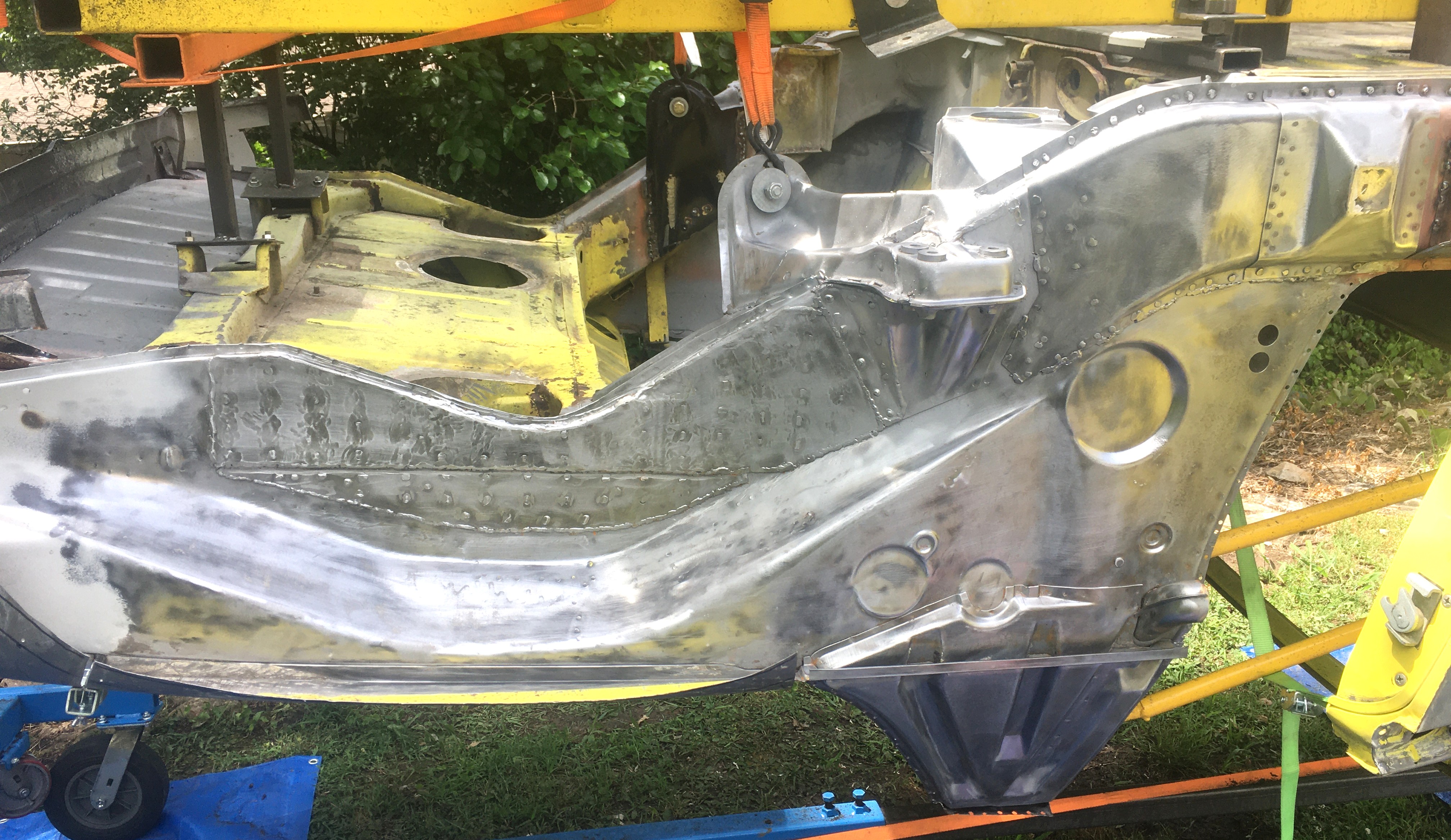

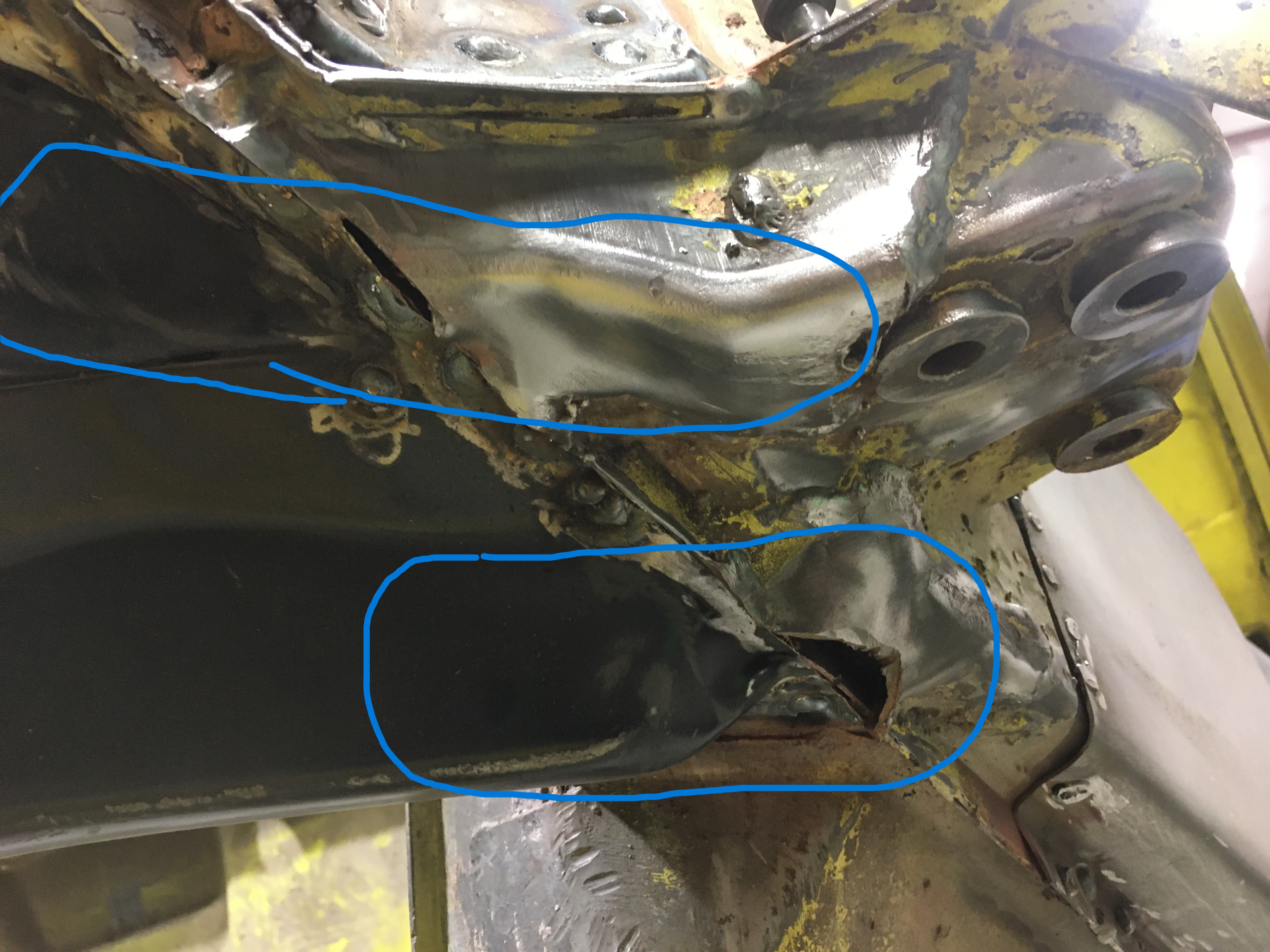

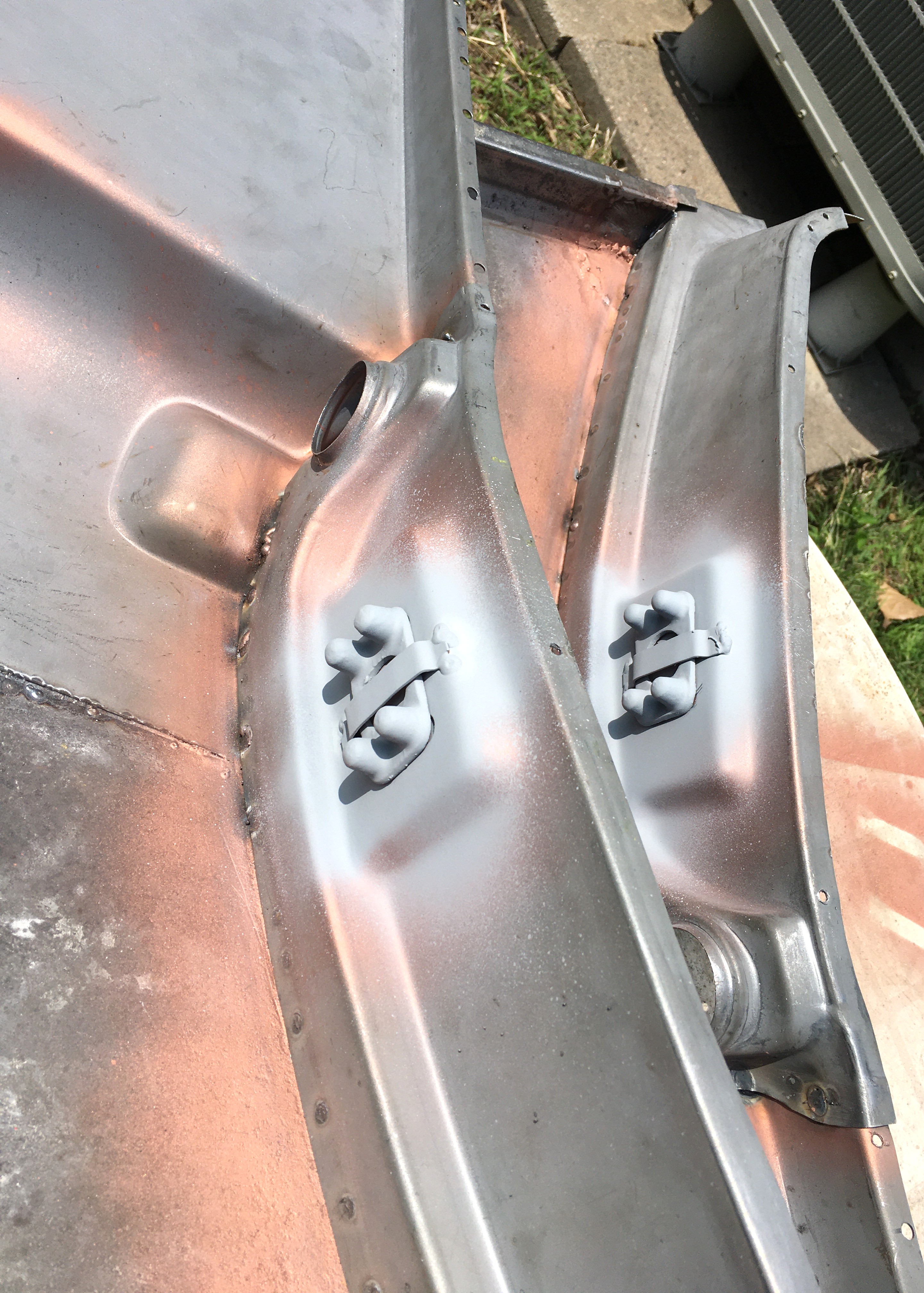

before re attaching the rear quarter panel, I finished up the braces that tie the rear lower control arm mounts together.

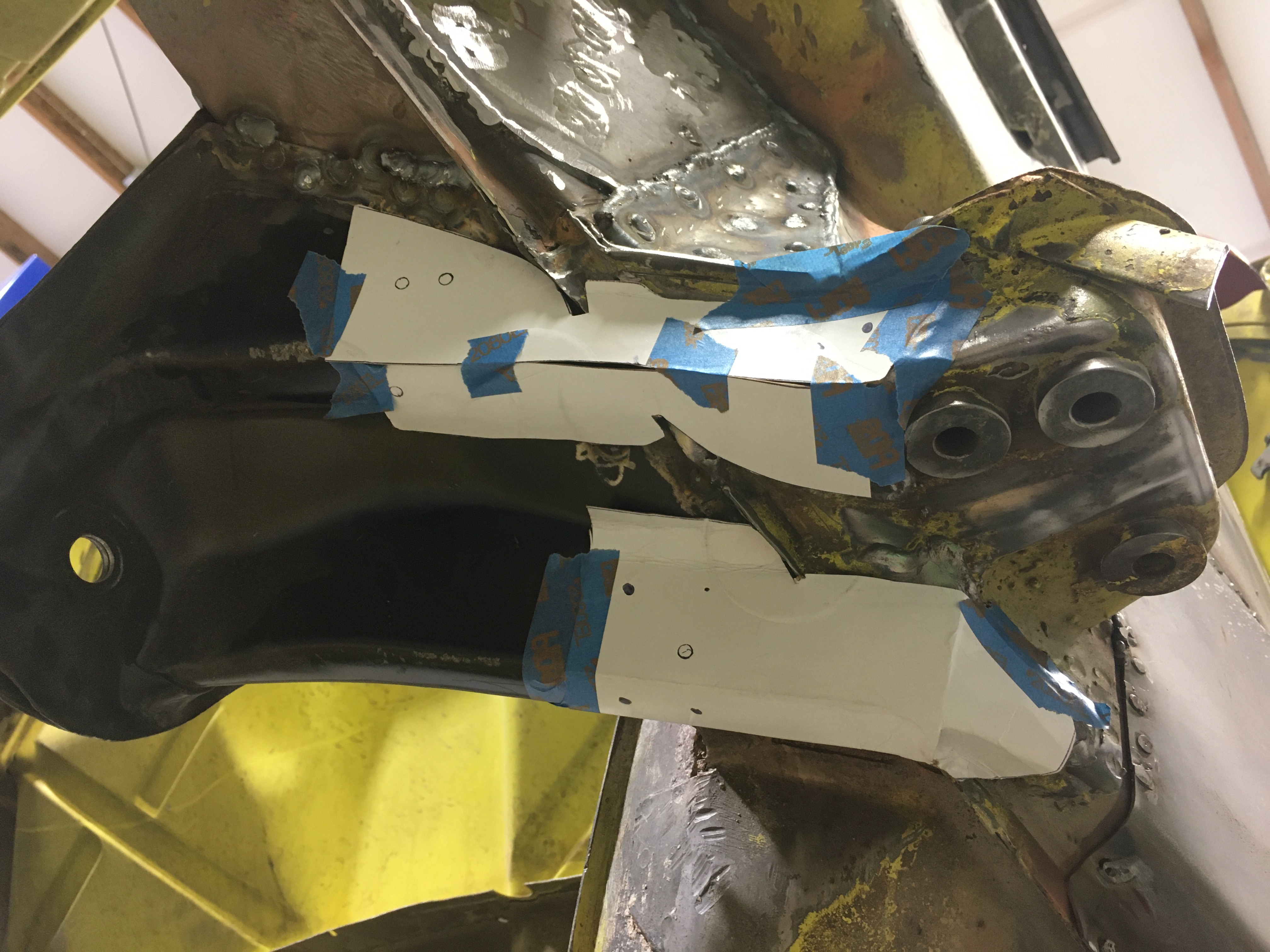

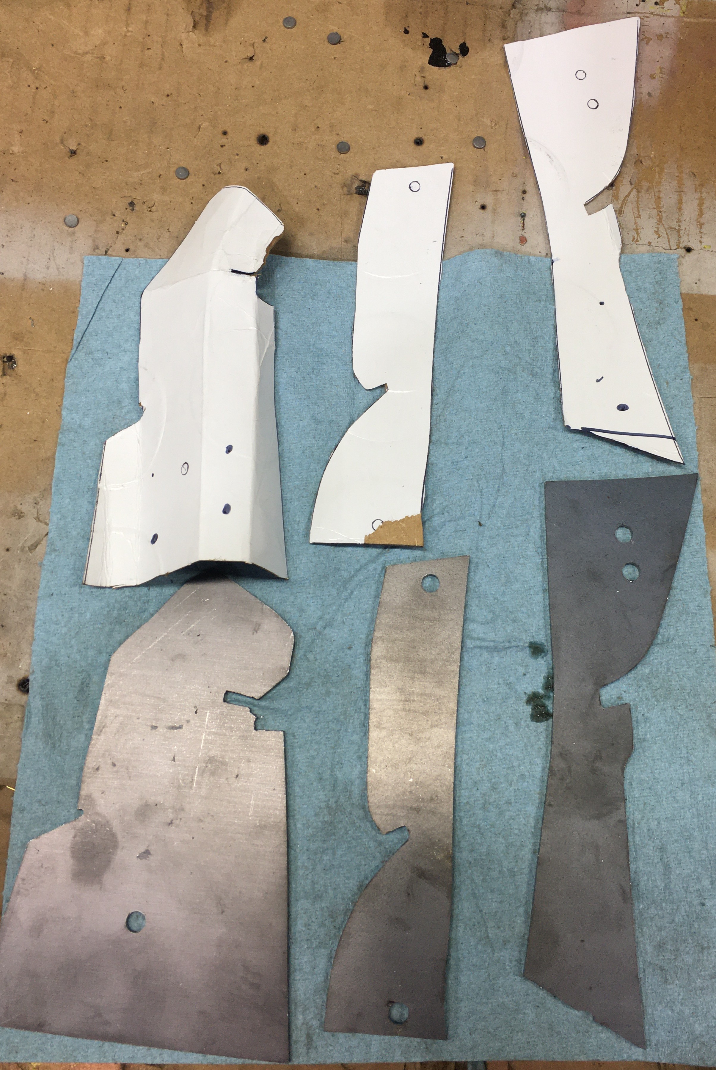

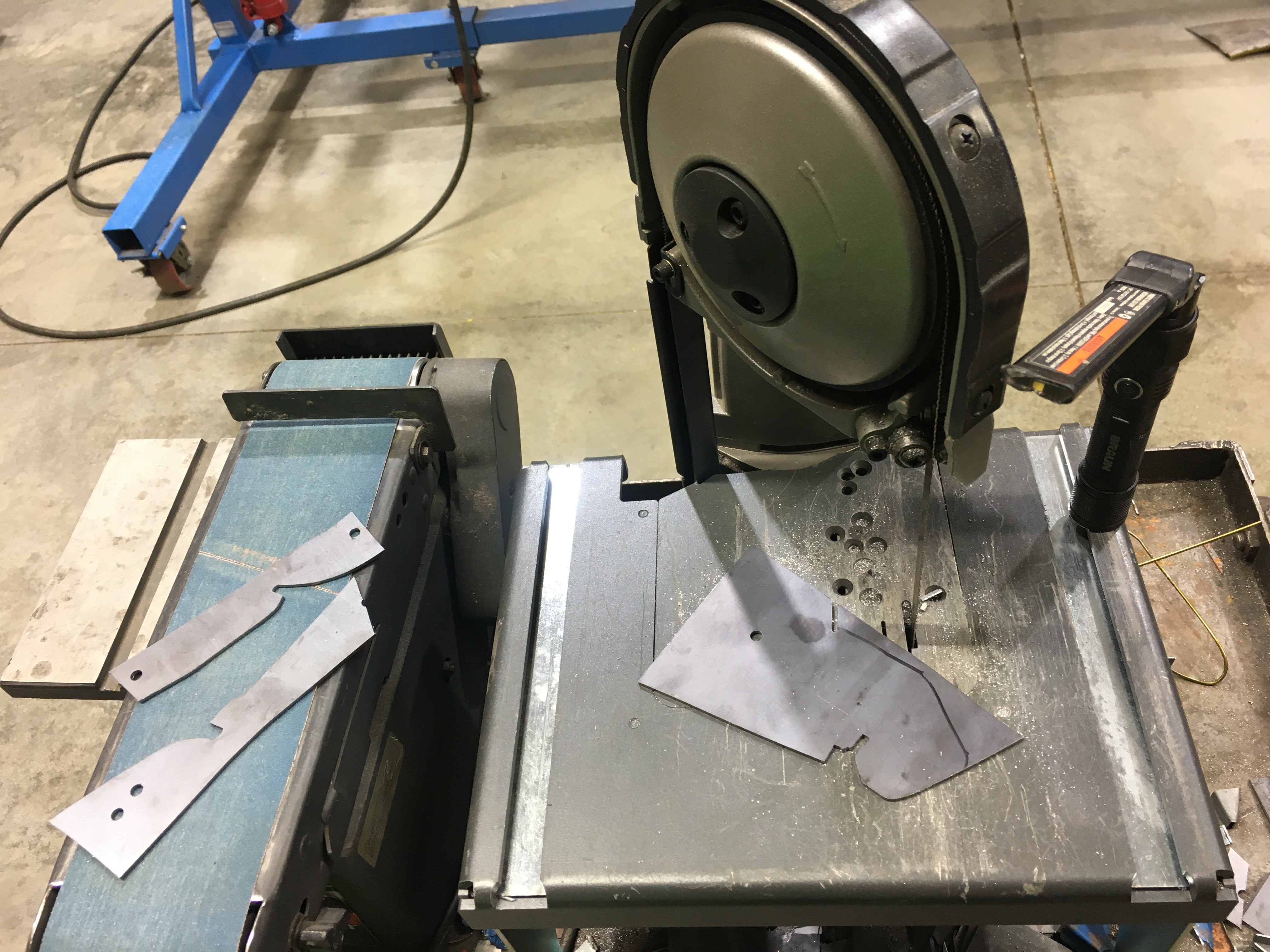

made some paper templates, to help with trimming/ bending the metal

after welding the suspension ties, it was time to blast/prep/prime the inner structure.

added seam dealer & ready to fit the sail/quarter panel.

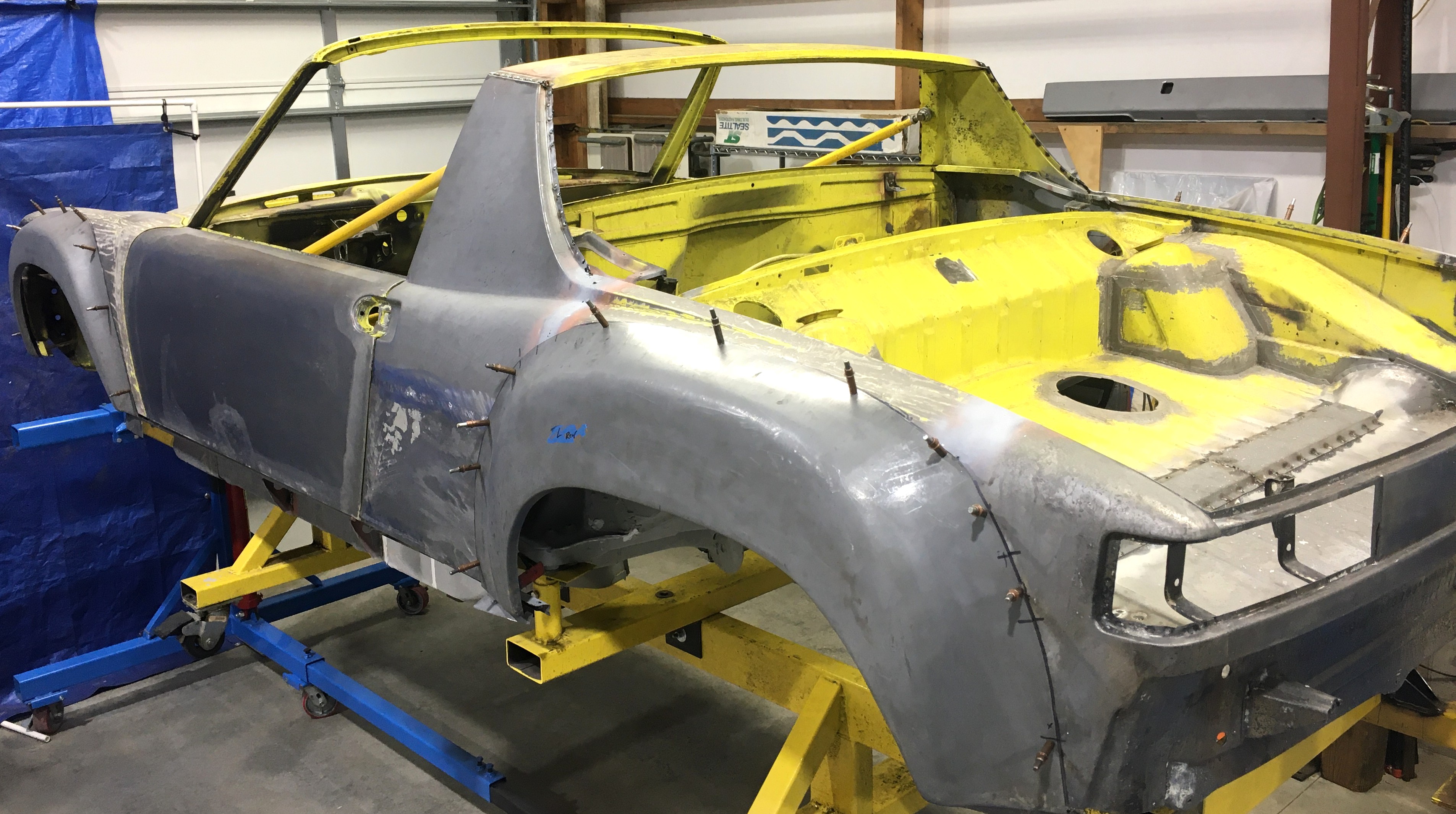

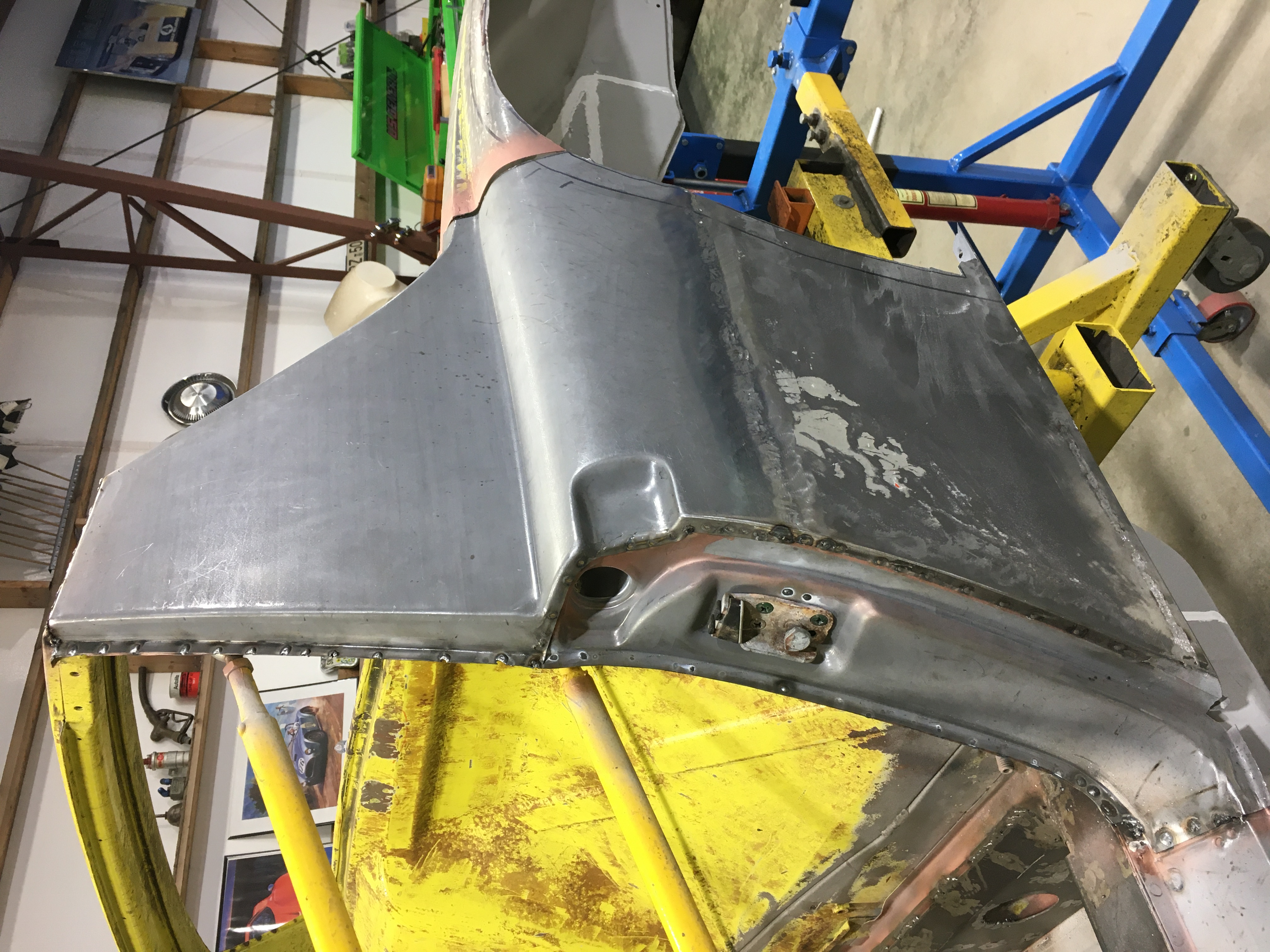

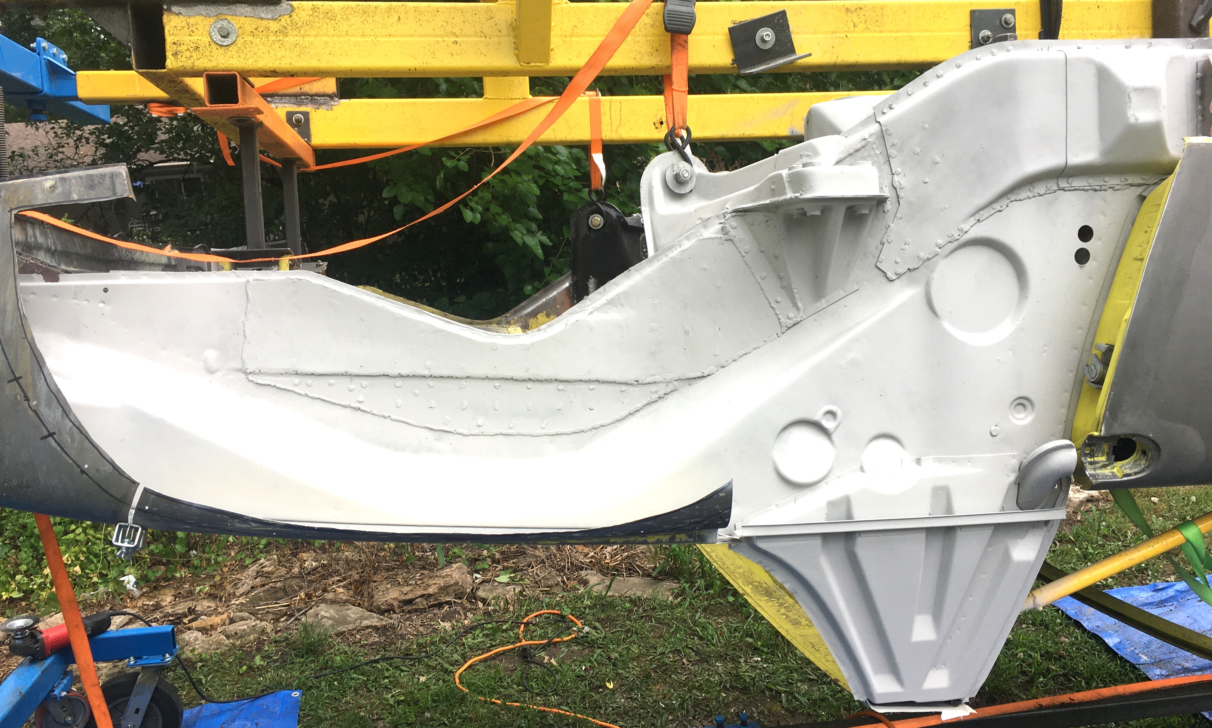

this is the extent of my progress this week end. I managed to get the suspension ties done & install both sail/ quarter panel pieces.

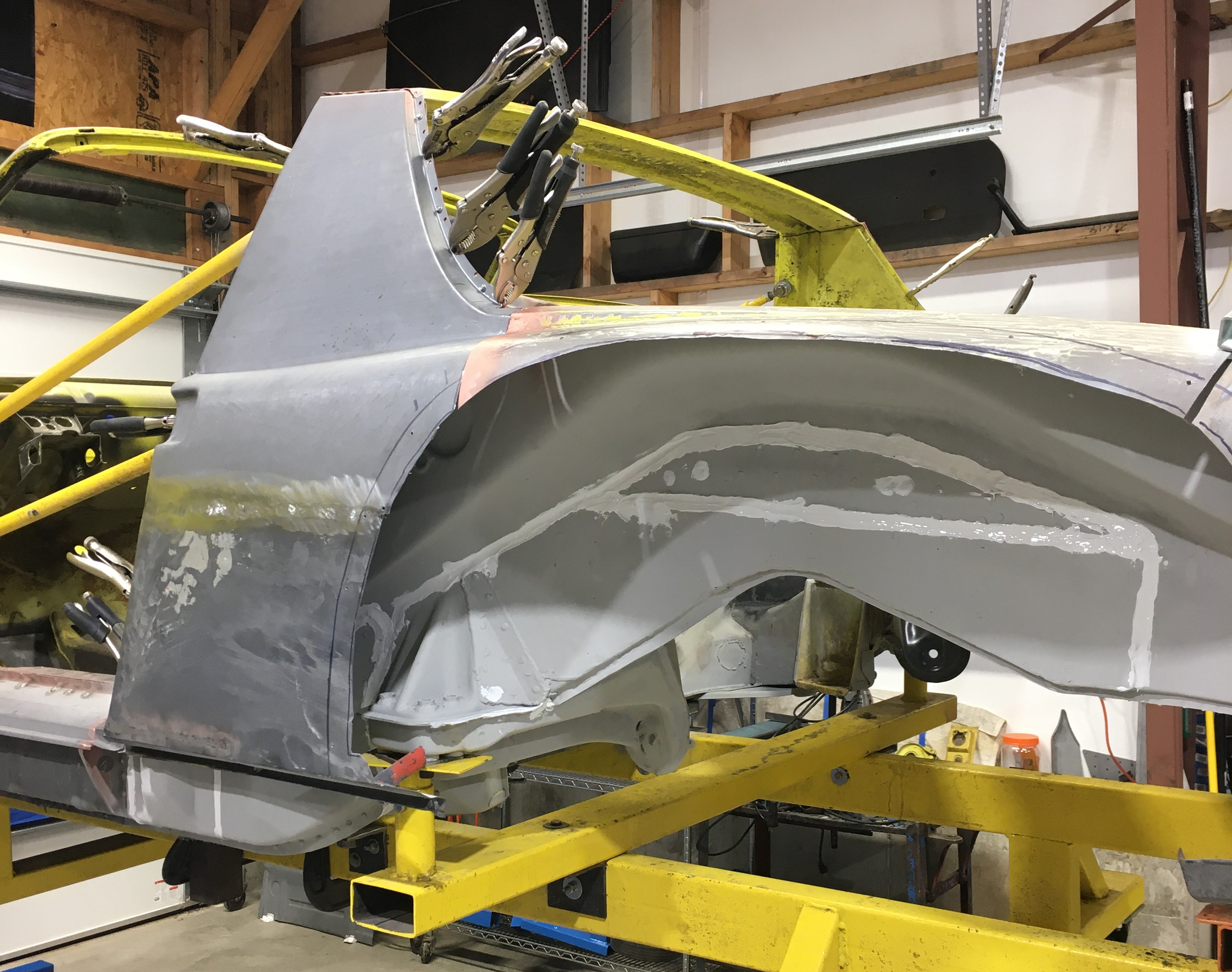

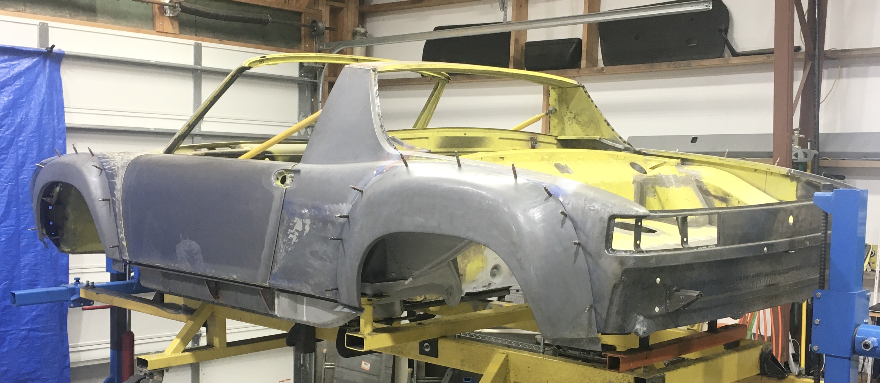

made a little progress today. welded the front/center/rear sections of the rear quarters back together.
next I'm going to start sneaking up on the fitment of the fender flares.

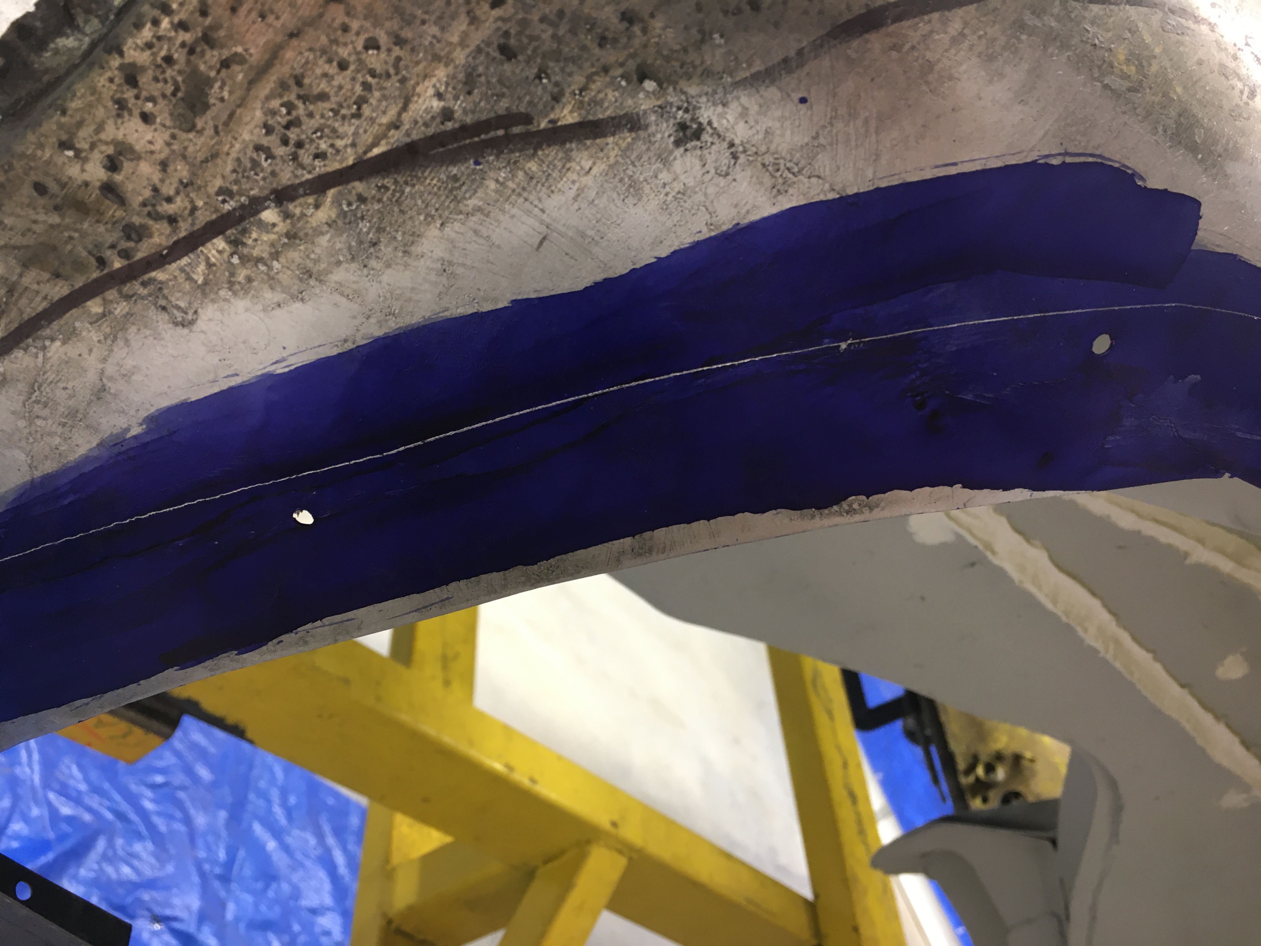

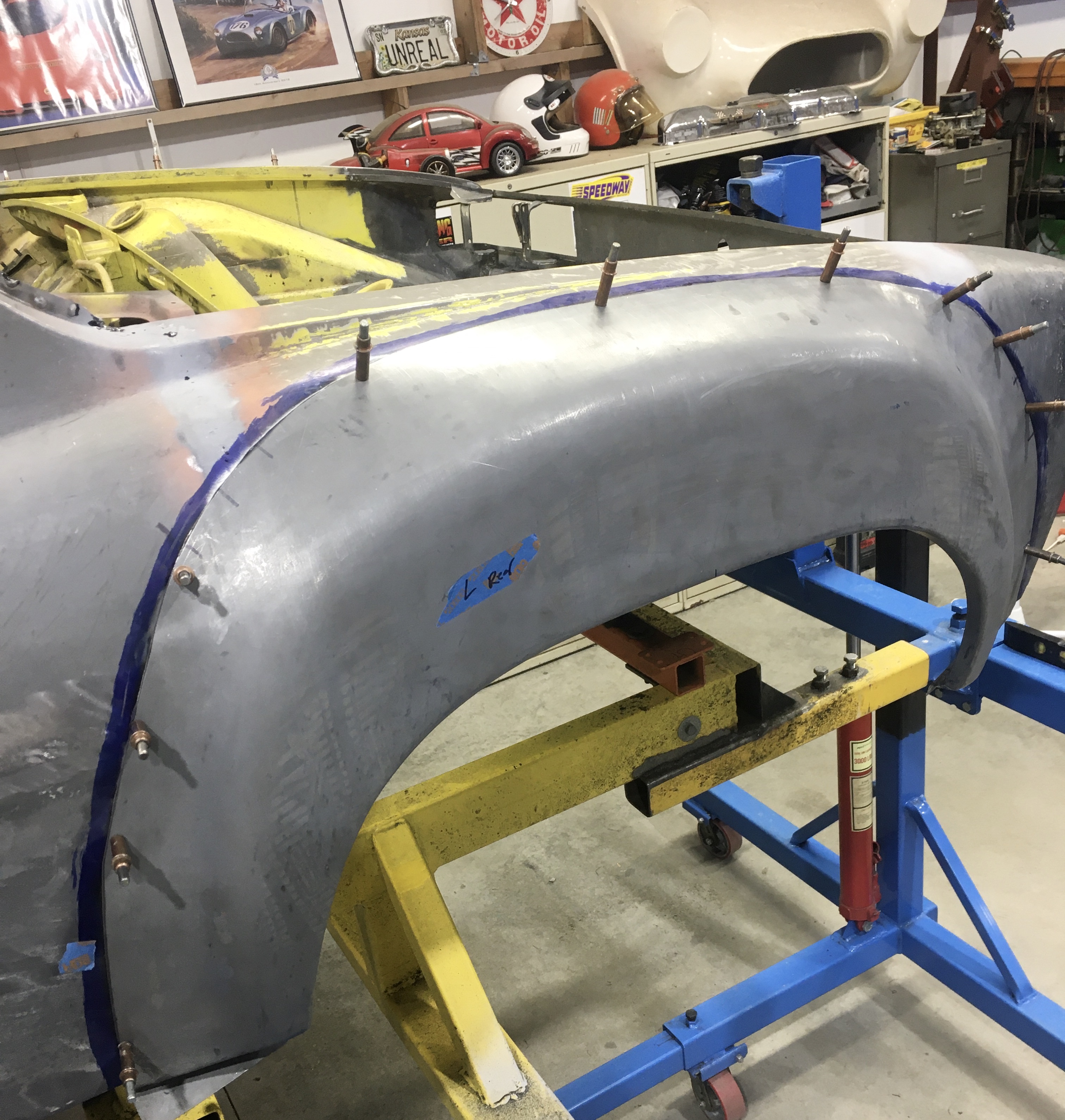

Well, took a few baby steps forward.

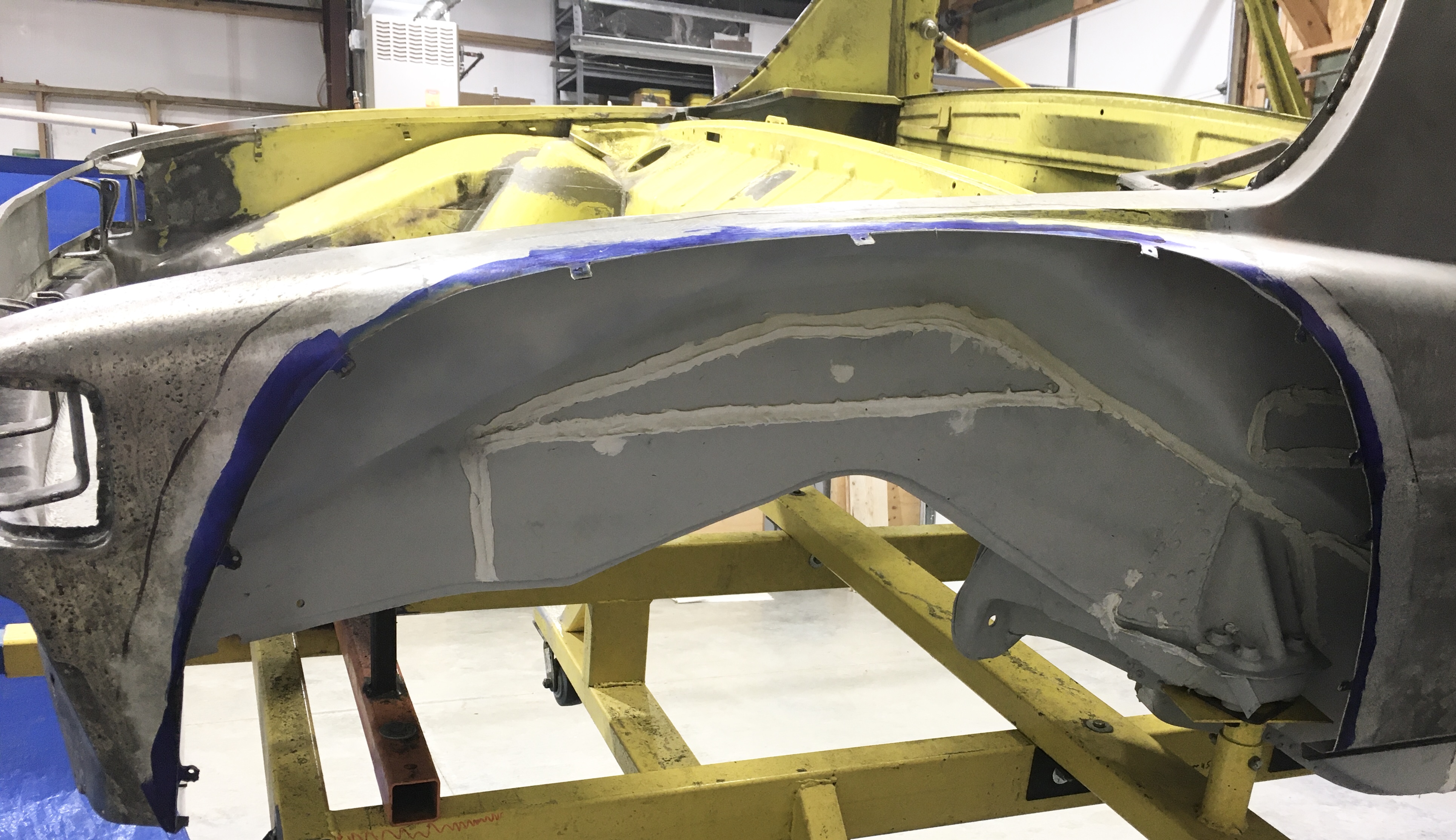

I applied dykem to the fender openings, then set the flares back on with Clecos.

Used a scribe to mark the flare out edge, then cut out the old material, but left some tabs for cleco placement.Attached Image

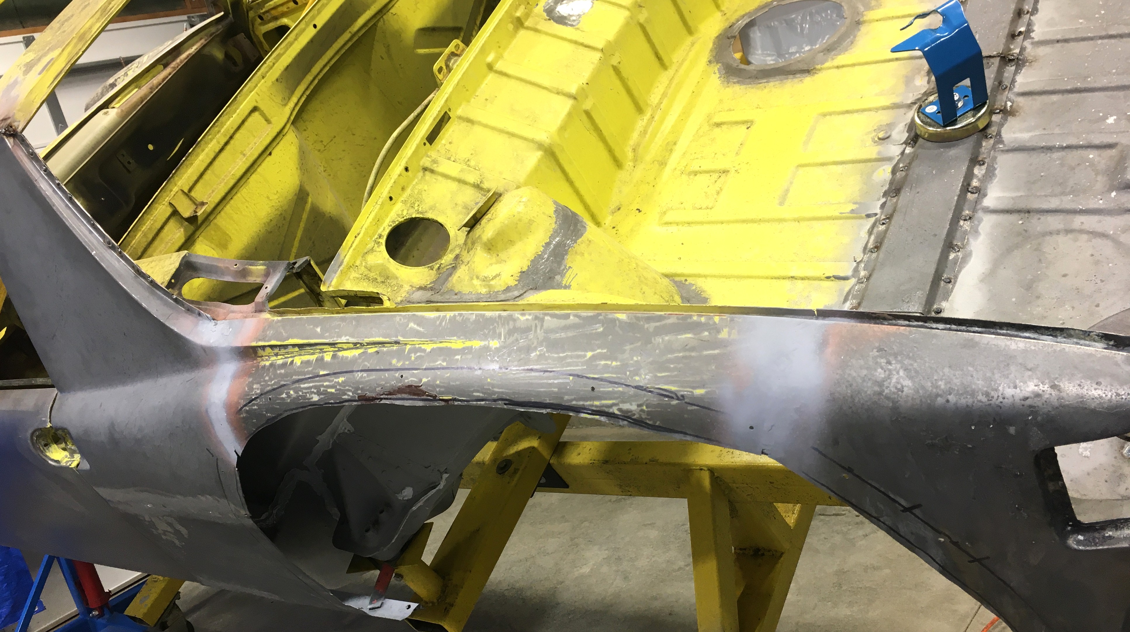

Next, I carefully cleaned/trimmed to get the flares to fit.
My plan is to tig weld them on. (More on that coming up)

Checking flare figment, before scuffing everything clean & prepping for tig welding.
