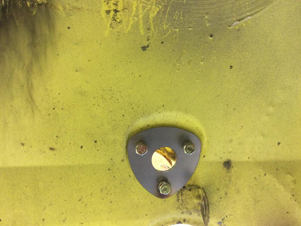

I drilled and test fit the brackets for the front sway bar today.
I’ll weld them after cleaning paint off the area and coating with weldable primer.

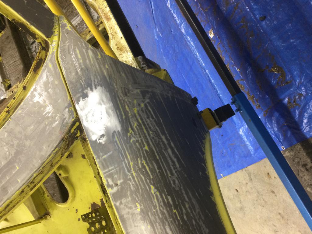

Well, making tiny amounts of progress,,,,,,,but at least I’m working on it.
I replaced the passside engine cover support as the original was broken.
Also managed to weld the front sway bar mounts into place.
Started to eliminate the front side markers as I have never liked them.
I tried doing it using the “Fitzee fabrication “ method and had so/so results.
Had a heck of a time with having little pinholes in the welds which let light through.
When I tried filling them with little tack welds, I’d sometimes pop a hole in the sheet metal about 3/16 in diameter.
Tried lowering my welder settings but that didn’t help much as I lost penetration.
Overall, it was kind of a pain in the butt, and I’m still not satisfied with it.
I think I’m going to do some practicing on some scrap pieces to get a bett feel of butt welding thin sheet metal,,,,,,before continuing on the car itself.

Still needs a little finesse work on the side marker area

Use a piece of copper sheet as a backer. it will help avoid overheating the metal and blowing holes while allowing you to get 100% penetration. I use sheet that is about .030" thick. I've also seen folks simply mash copper pipe. I prefer the thin copper sheet since it is easily formed to what ever your welding.

Thanks for the tip about using copper.
Not too much to report this weekend again, but making little steps.
I filled a number of small diameter holes here and there on the car, and made a patch panel in the area where the battery tray used to mount.
Alain V.

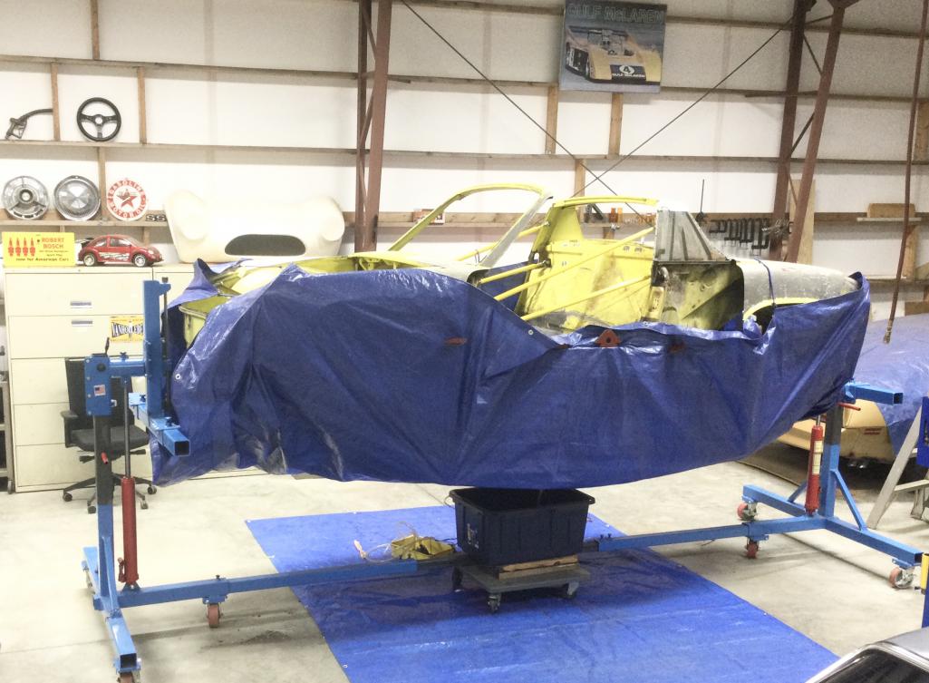

It looks great, IMHO. What rotisserie are you using? Once I get a pad poured in my “garage”, I’m planning on moving my car back to my house so I can, ideally, work on it more (easier to walk 100 feet than drive 20 minutes). Once it’s back here, I want to put it on a rotisserie, but going back and forth on how to do one.
I think the Subie conversion is a great idea! Why the six instead of the turbo 4 from an STI/ Outback GT? I’m sure the six is an easier conversion with no turbo to worry about, but just curious.
You’re giving me lots of ideas/tutorials about what I may need to do to my car! Great pictures!
Alain V.
post Feb 13 2022, 09:58 PM
Post #71
Posts: 212
Joined: 15-March 13
From: Kansas
Member No.: 15,655
Thanks, the rotisserie is an Auto twirler "PRO" model.I got it from best buy automotive.It is a bit more expensive than most other ones out there, and is overkill for a 914,,,,,,but I have a few reasons for choosing it.
#1 is that it is 3" tubing and 3/16" thick,,which is more "heavy duty" than most on the market. There no,"flex" like I have seen on other models with the car on it.
#2 is that it has bearings in each of the pivots, so it spins the car effortlessly.
#3 not only is my tub on the rotisserie, but it is also holding the weight of my "cart" that I have the tub mounted to
#4 when the 914 is done, I have a 1970 Olds cutlass (442 w-30/resto-mod clone) that will be on the rotisserie next.
#5 it is a beefy , USA made unit,,,and I usually am alone in my garage......so I did not want to take the risk of a possible tool "failure" while I'm by myself in the garage.
Here is a youtube video on it. My Webpage
