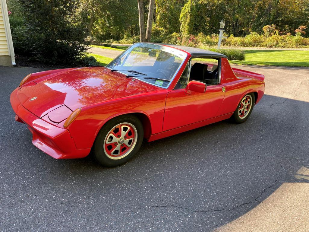

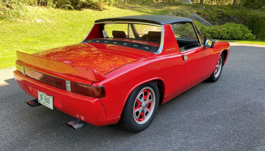

After having enjoyed several 911’s over the past 40 years, I decided about a year ago that my next project would be a 914-6 GT Tribute car. I had been thinking for some time about a mid-engine open car but the Boxster is just not my cup of tea. I am more of a 70’s air cooled hot rod type and I love my ’73 Signal Orange 911 RSR tribute car. So a 914-6 GT seemed like an obvious choice. It ticked all my boxes and I have always admired the ‘70’s GT race cars.
My friends at Auto Associates in Canton, CT knew I was considering a 914-6 GT project so when a customer’s ’73 914 2.0 became available there last fall we put it up on their lift, took a close look and deemed it an acceptable starting point. The project plan is to follow the same process I have used on my RSR and my ‘70E restoration projects. I strip the car in my home shop, send the shell to Auto Associates for the metal work, chassis stiffening and paint. The painted shell comes back to me and I do the mechanical work and reassembly.
My plan is not to do a 100% accurate GT tribute but rather to build a car that looks, sounds and drives like a street friendly GT. I am not planning on any serious track or autocross but more of a fun spirited street hot rod. I know there is a ton of expertise and experience on this forum so I will be looking for some sage advice as I document the build in this thread. So here are my thoughts:

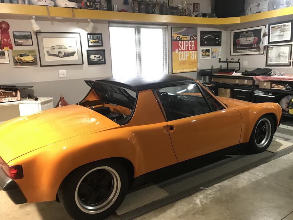

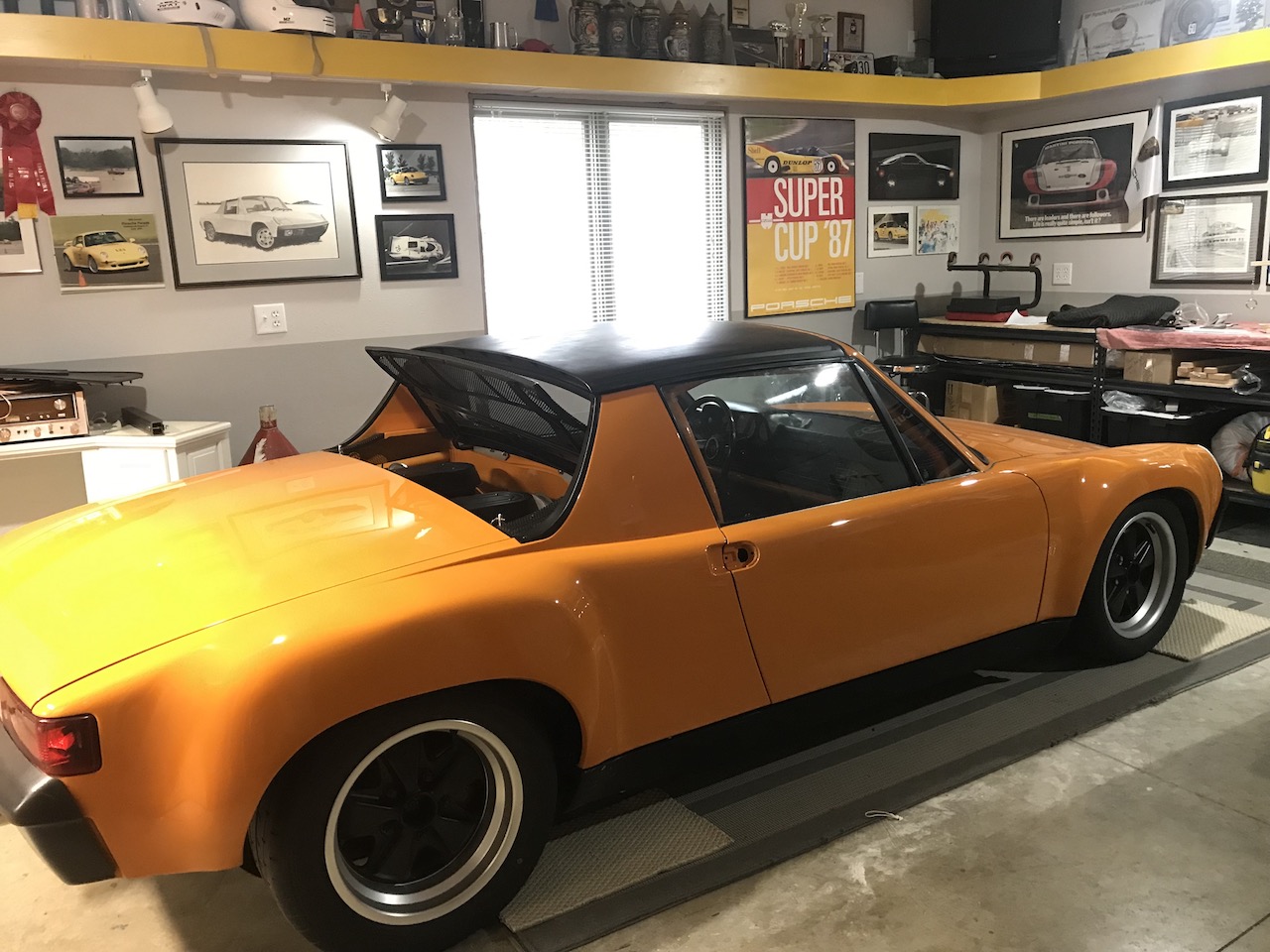

I was thinking of the exact same thing....forgot, just did that. You are going to have so much fun, post lots of pictures often. Best, MarkAttached Image

QUOTE(mlindner @ Feb 16 2022, 02:57 PM) *
Wow...That's a beauty. I love Signal Orange.
Where did you get the double grill engine cover?

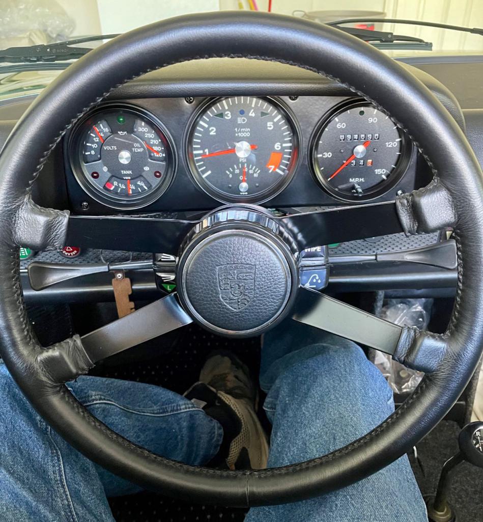

Here is a picture of my steering wheel and gauges:
Great looking dash. Original or repro wheel? Who did the gauges?
