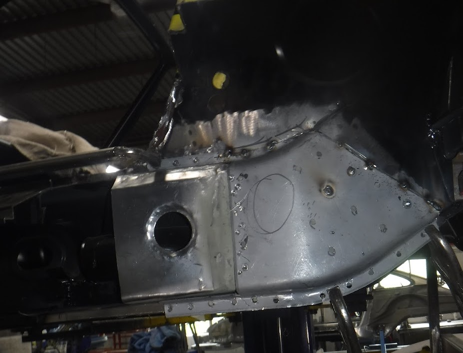

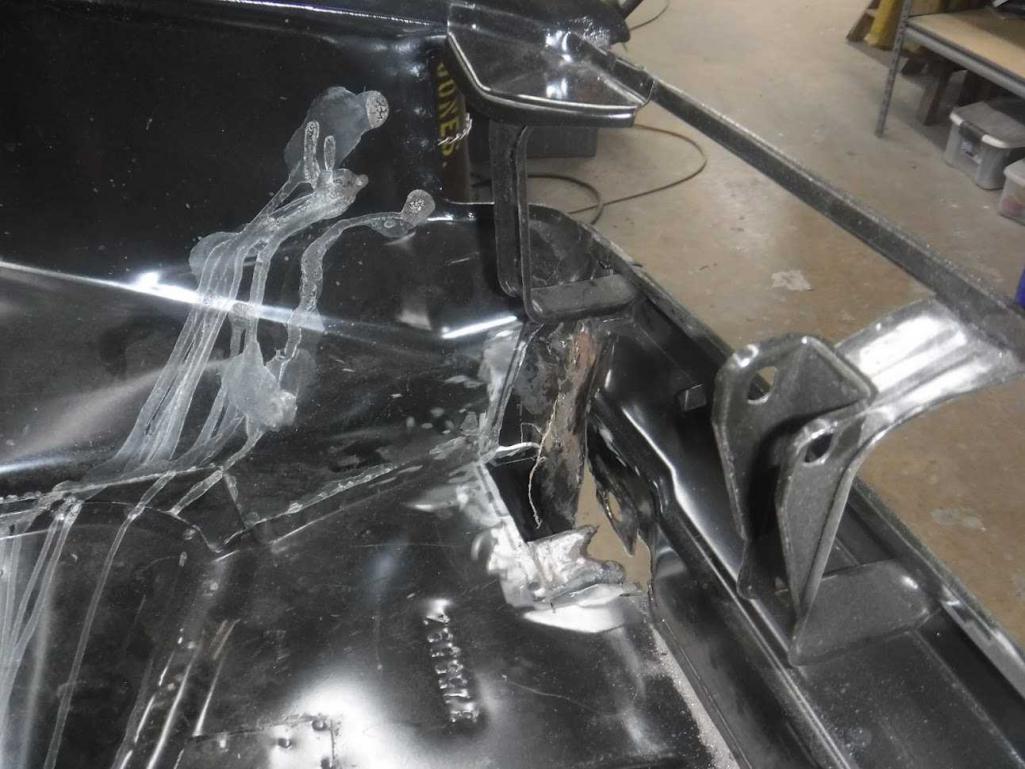

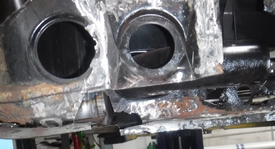

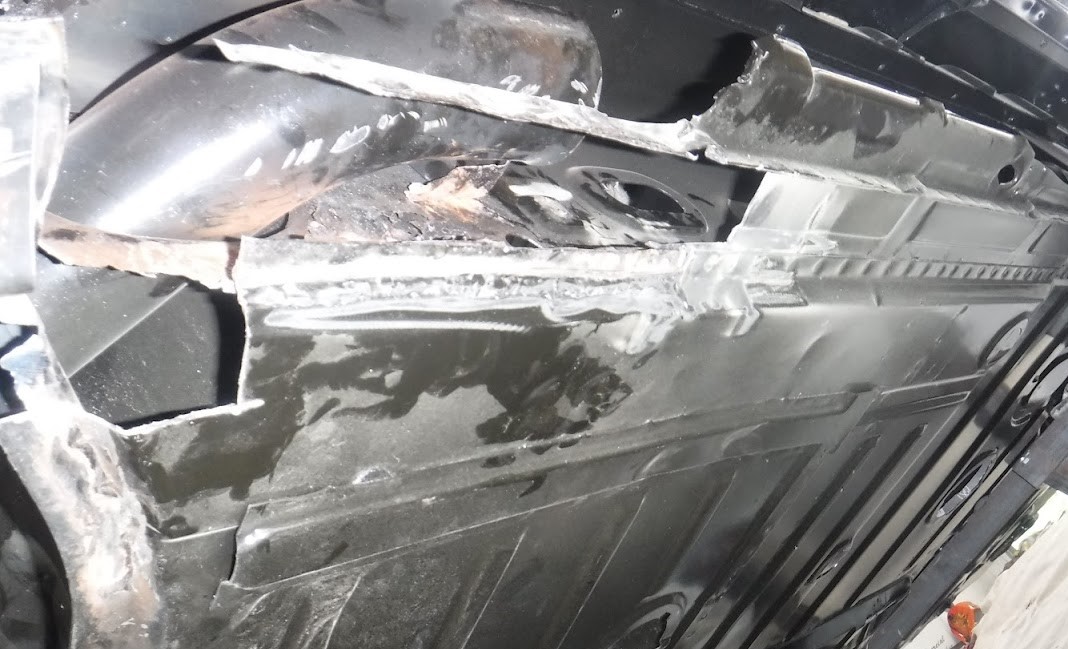

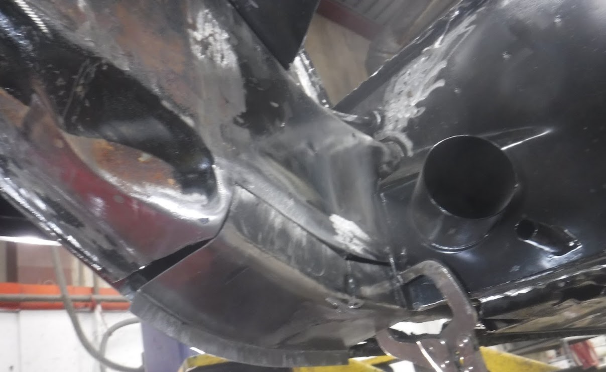

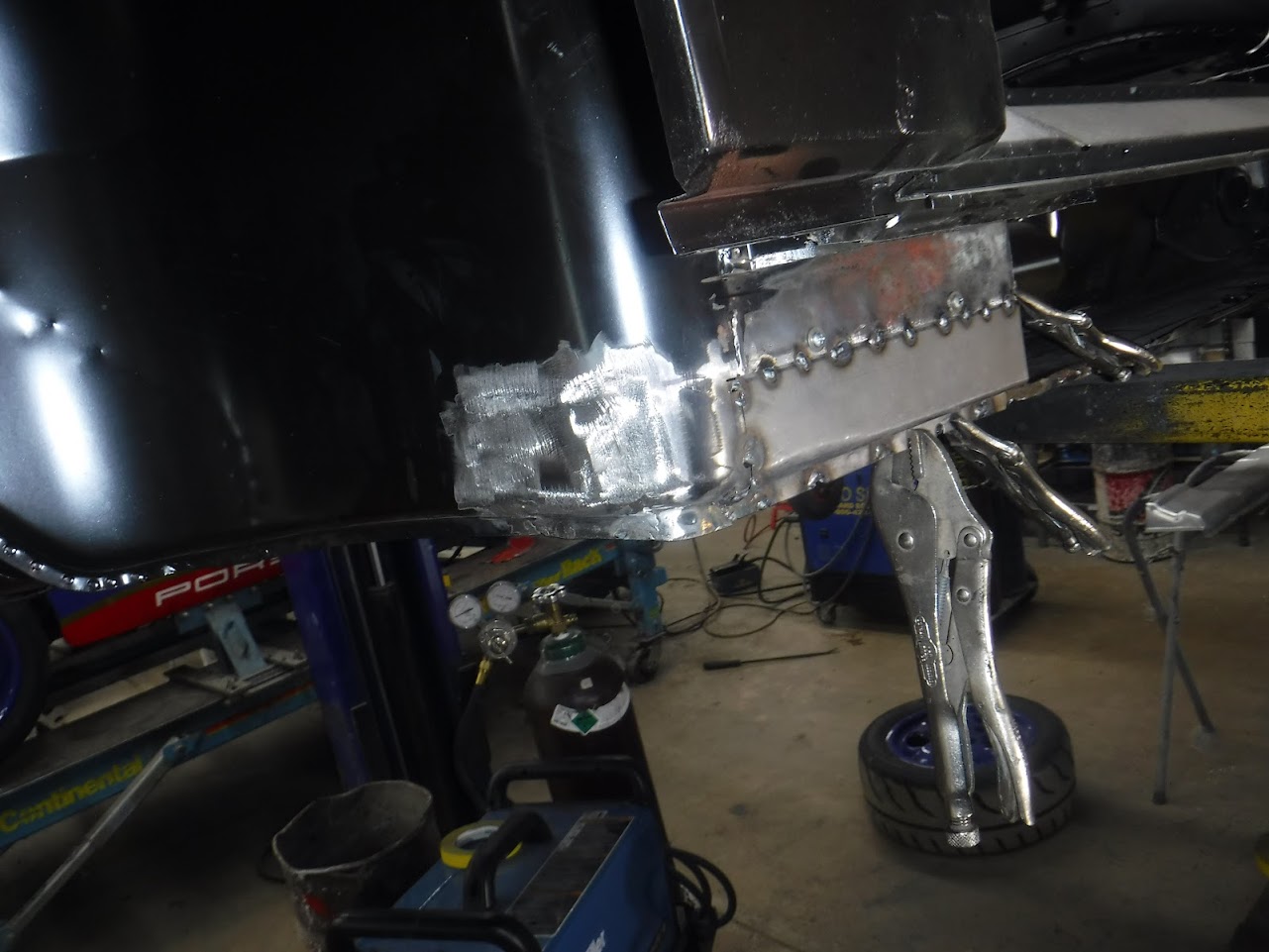

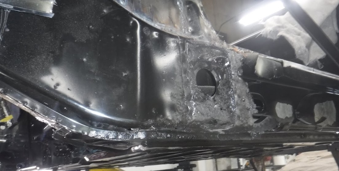

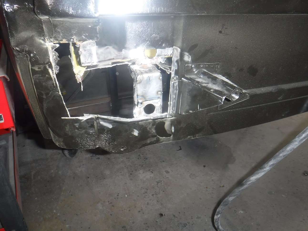

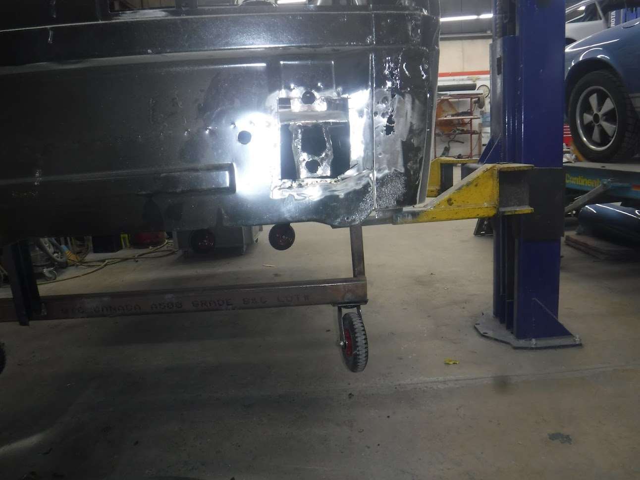

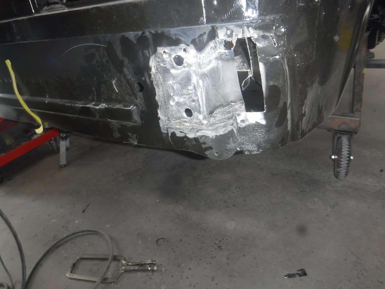

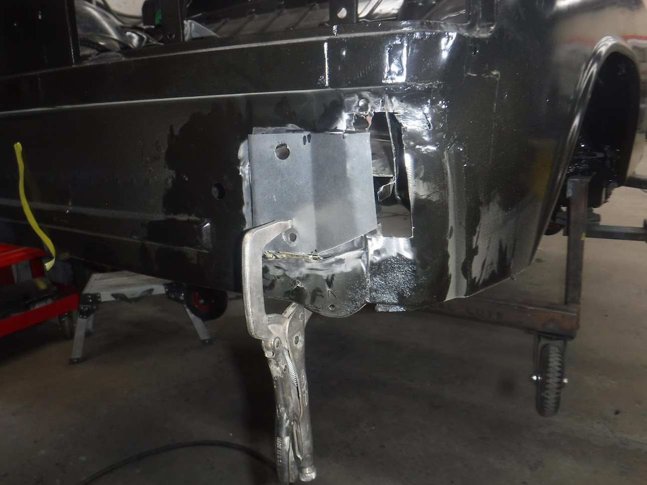

Here are some photos of the repairs in the rear bumper mount area
Attached Image Attached ImageAttached ImageAttached Image Attached Image

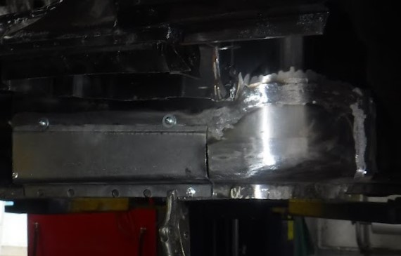

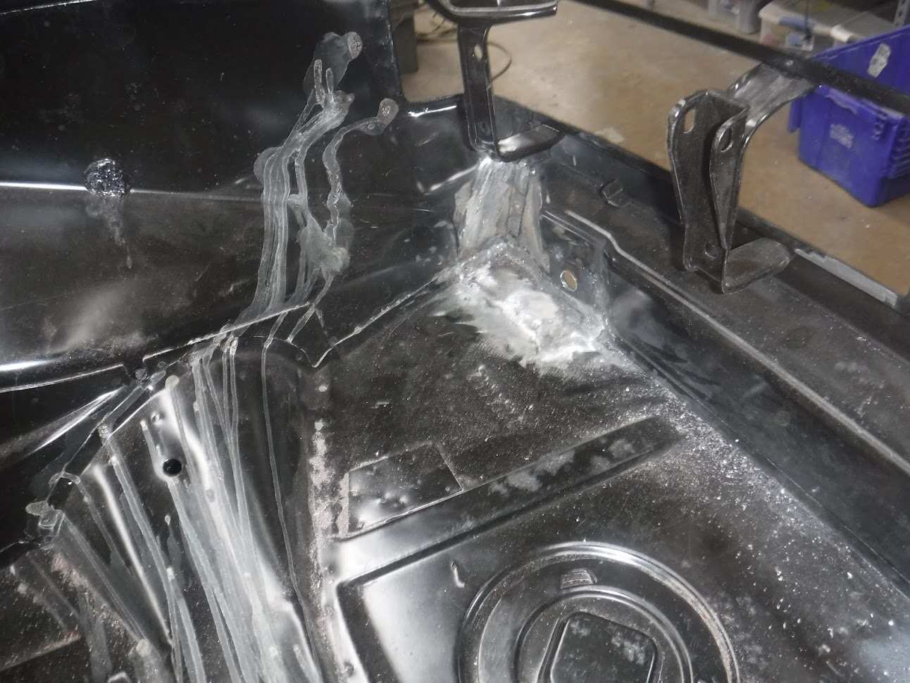

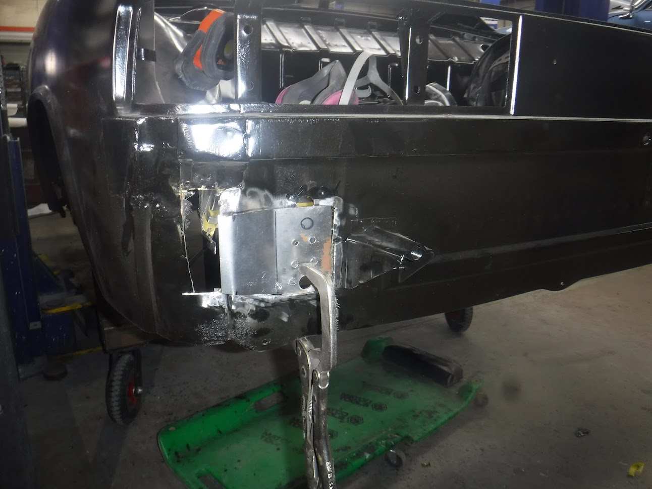

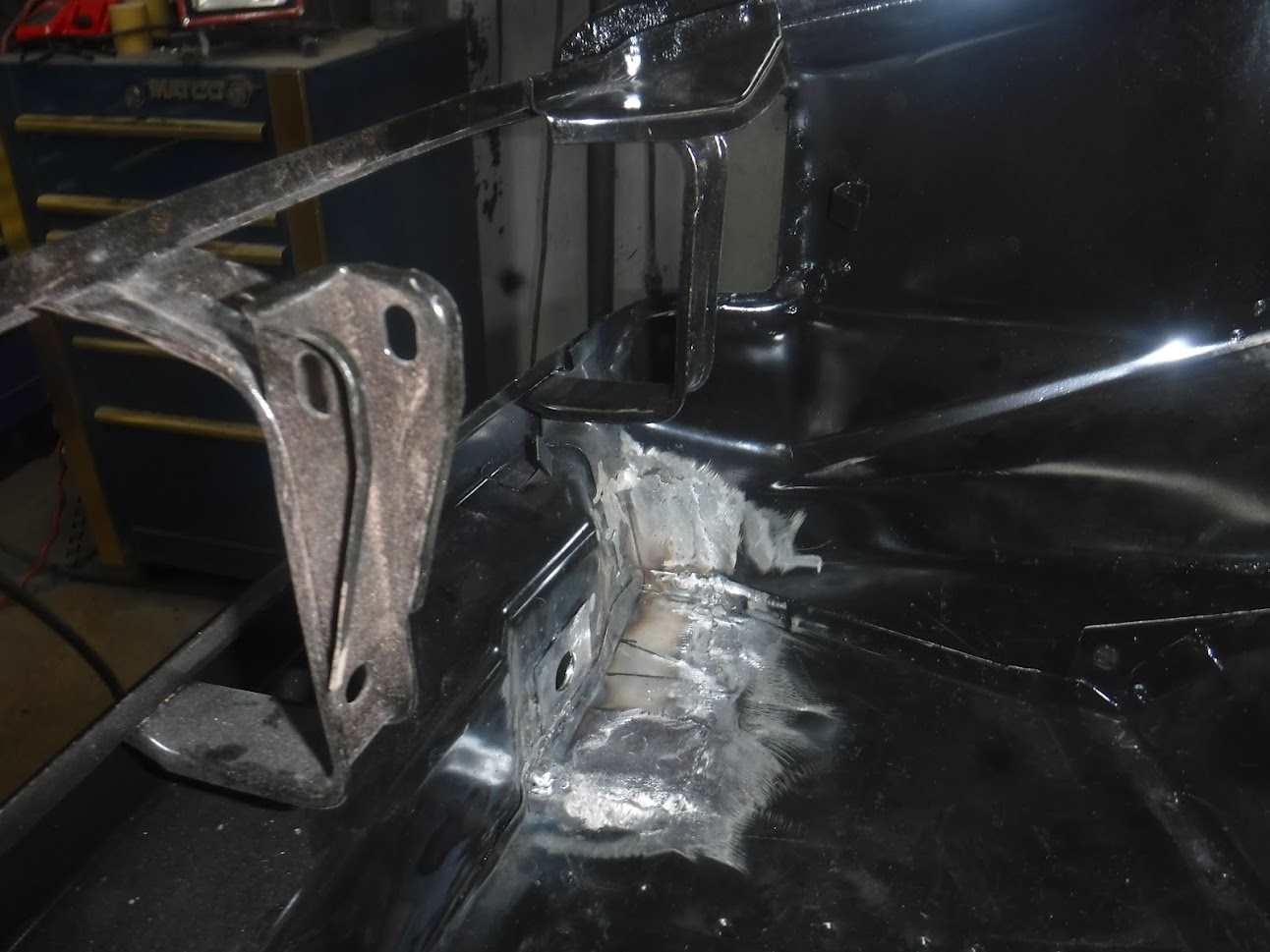

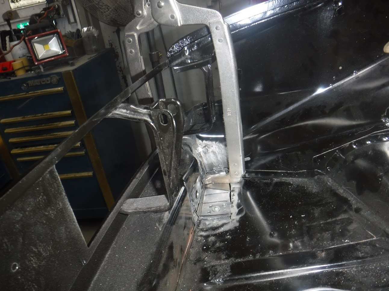

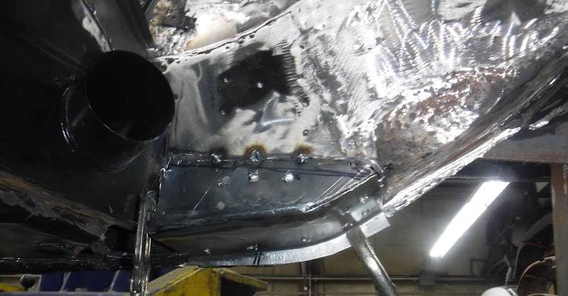

RHS Rear bumper support.
Attached Image Attached ImageAttached ImageAttached Image[attachmentid=873
925]Attached Image
Tom1394racing
post Apr 23 2023, 07:22 AM
Post #105
Posts: 525
Joined: 25-August 07
From: CT
Member No.: 8,039
Ready for NOS rear firewall.
Tom1394racing
post Apr 23 2023, 07:36 AM
Post #106
Posts: 525
From: CT

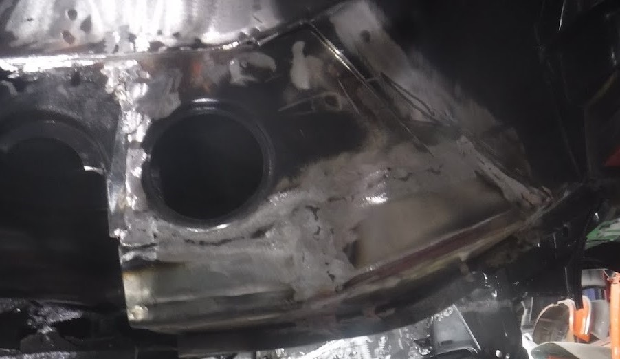

Member No.: 8,039

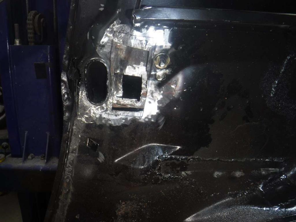

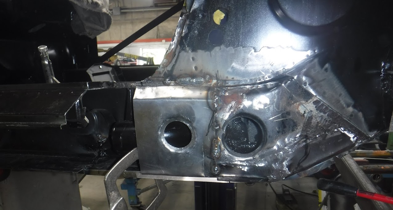

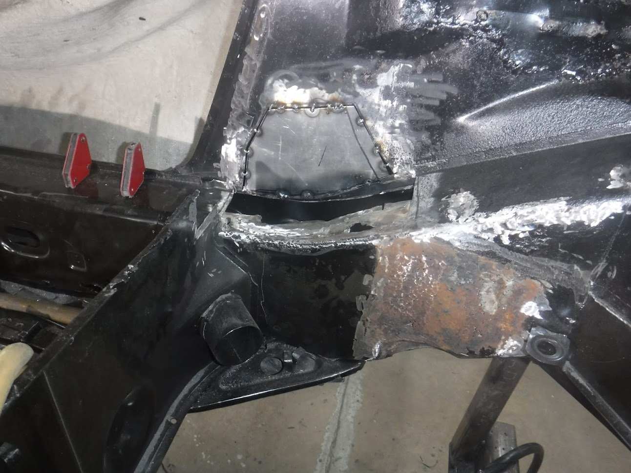

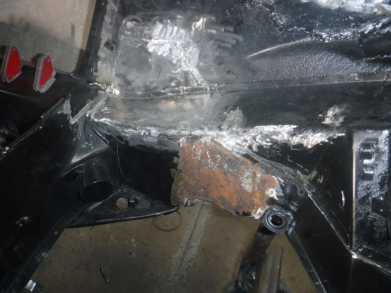

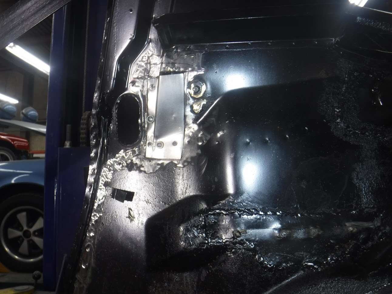

Hell Hole repairs.

Thanks Tom for the updates. Looking at the metal repairs makes me smell welding fumes...mmm. (IMG:style_emoticons/default/biggrin.gif) Time to head to the shop to work on the 6.

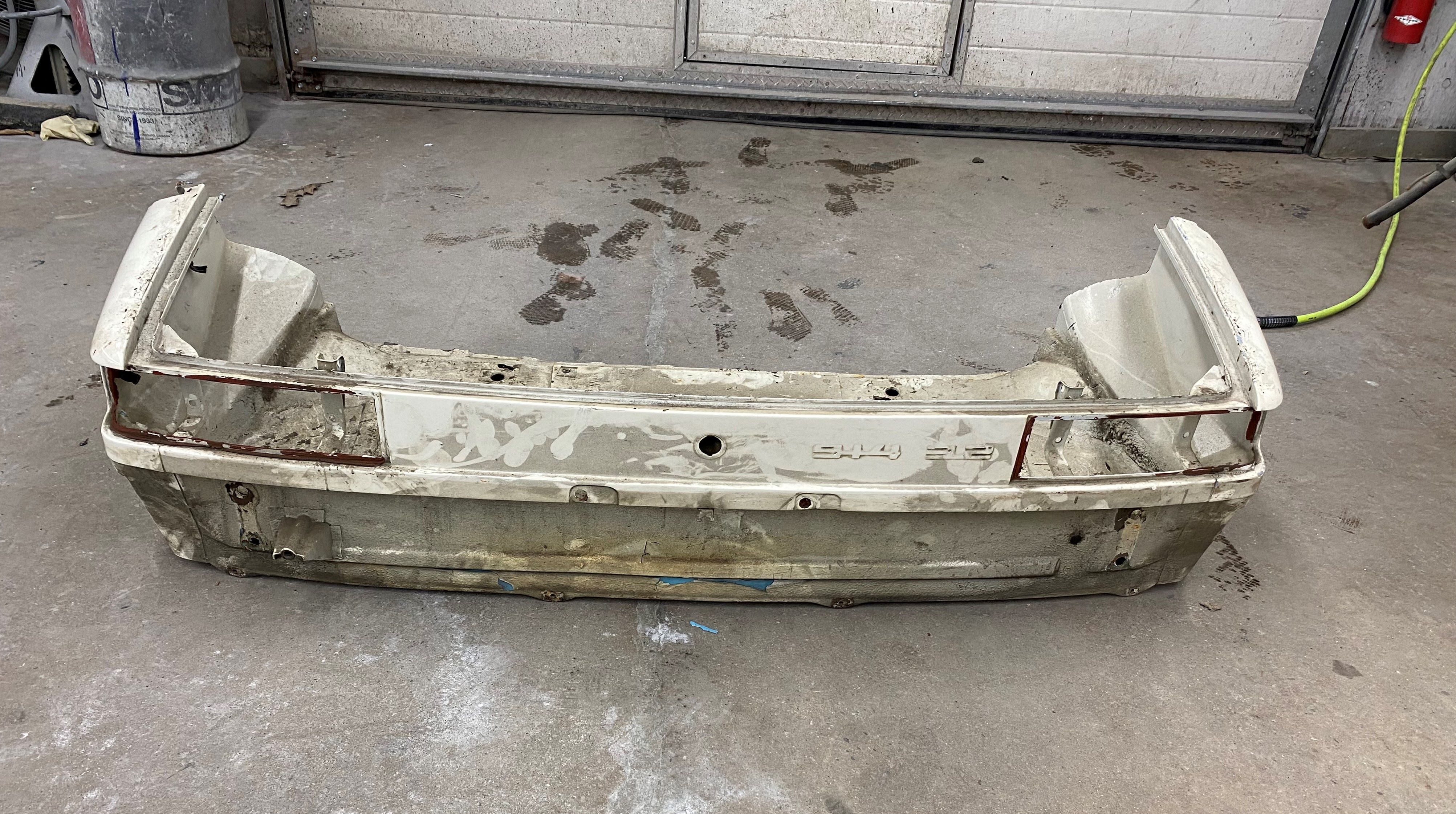

post May 27 2023, 07:48 AM
Post #109
Posts: 525
From: CT

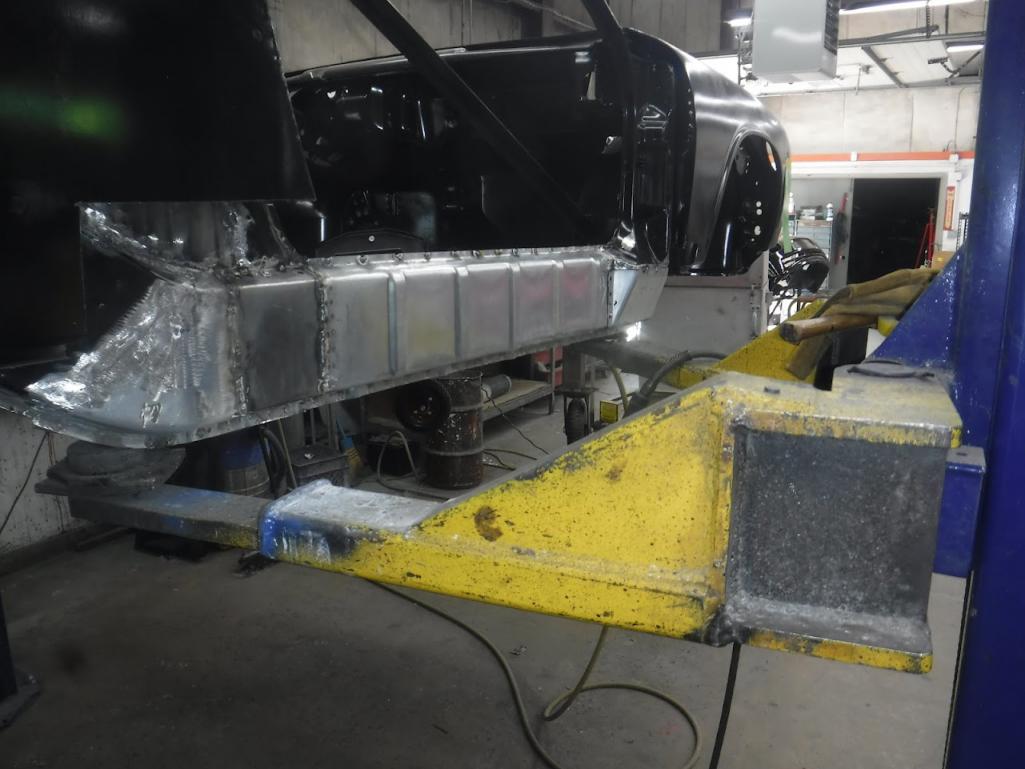

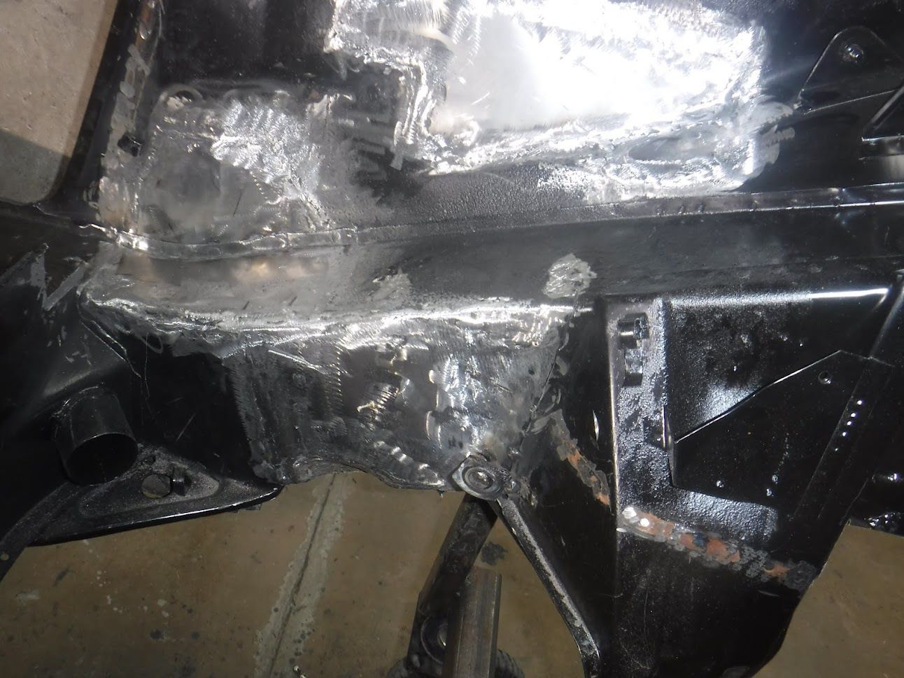

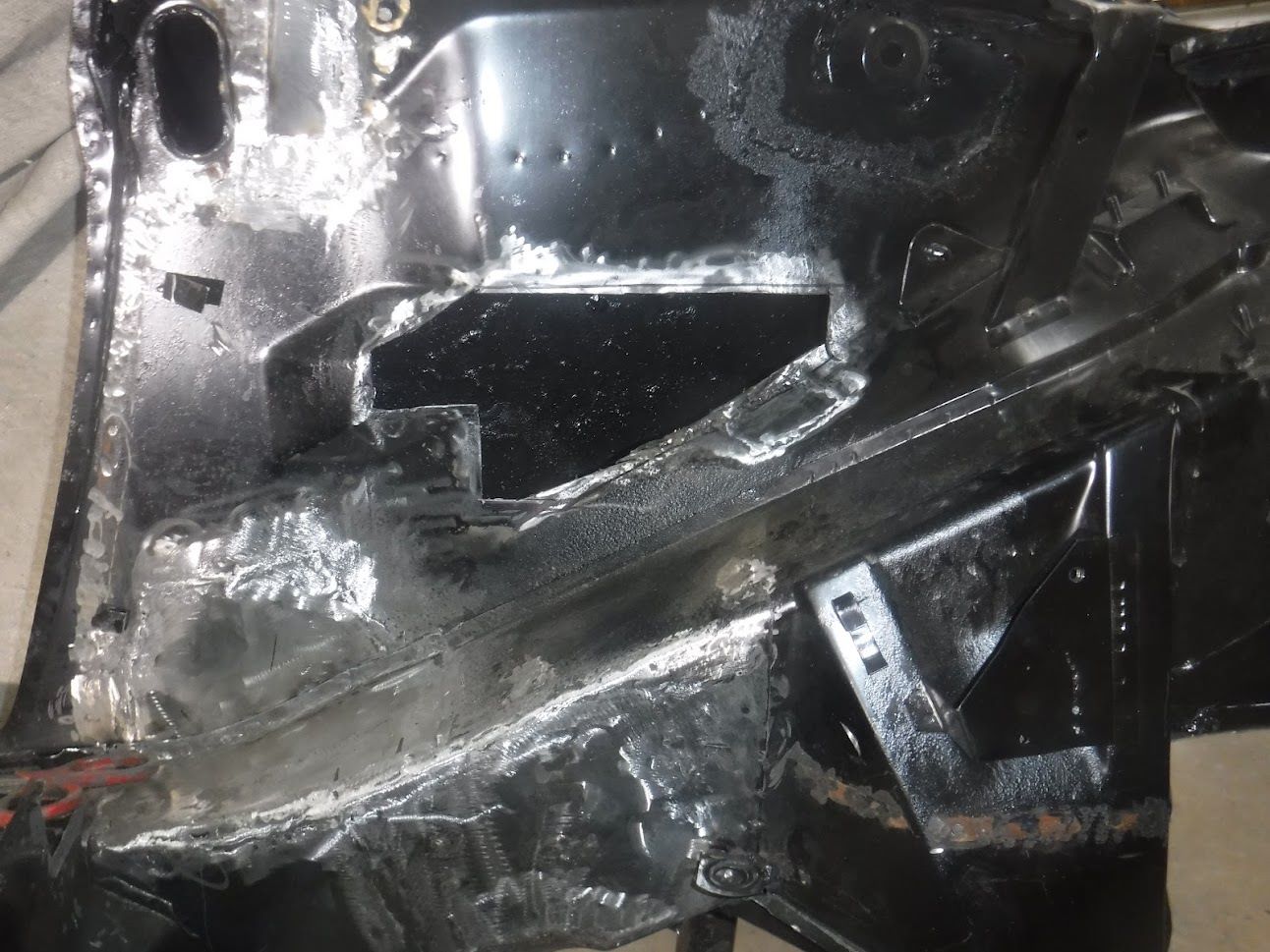

Member No.: 8,039

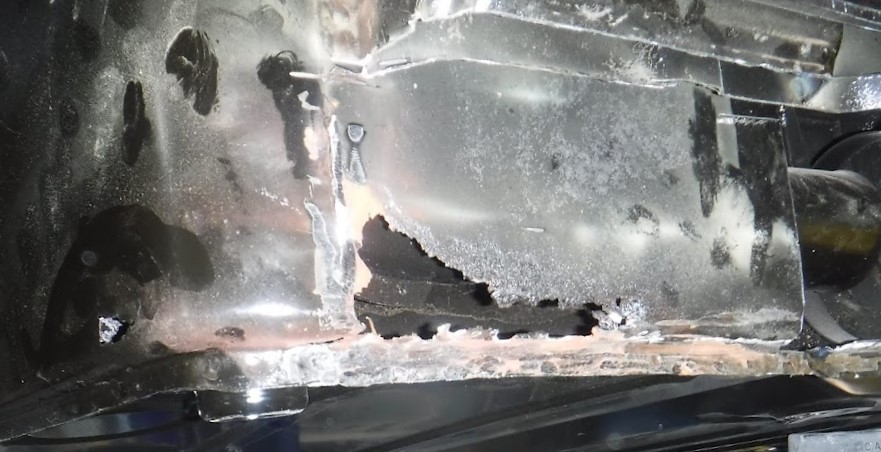

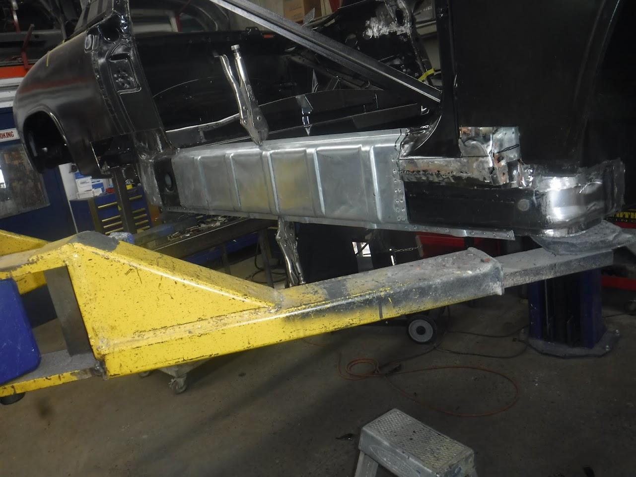

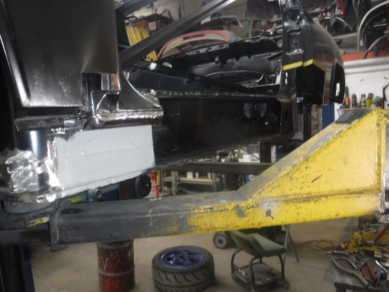

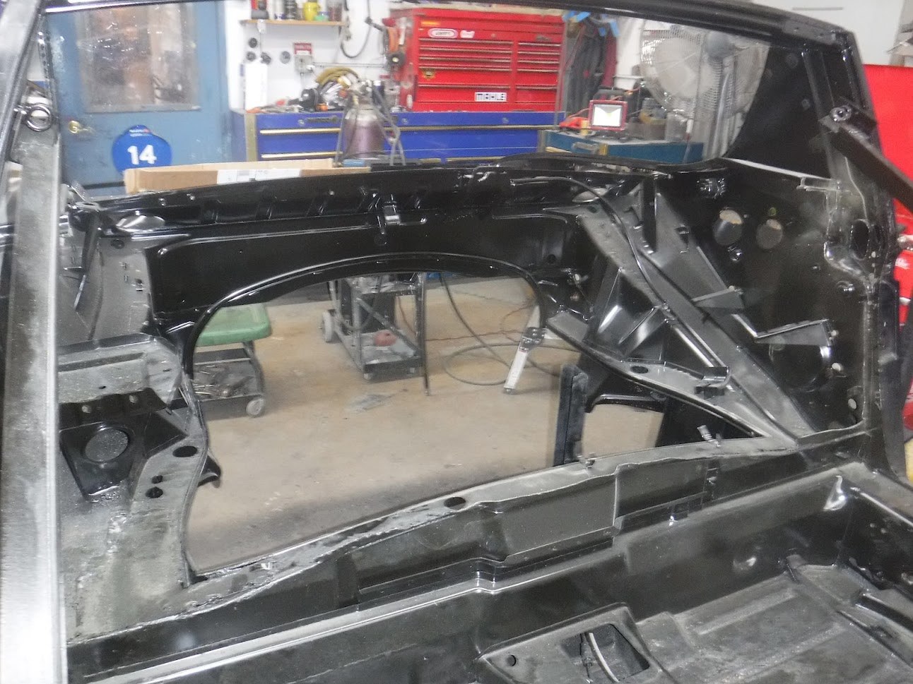

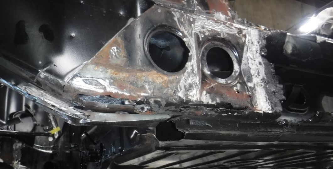

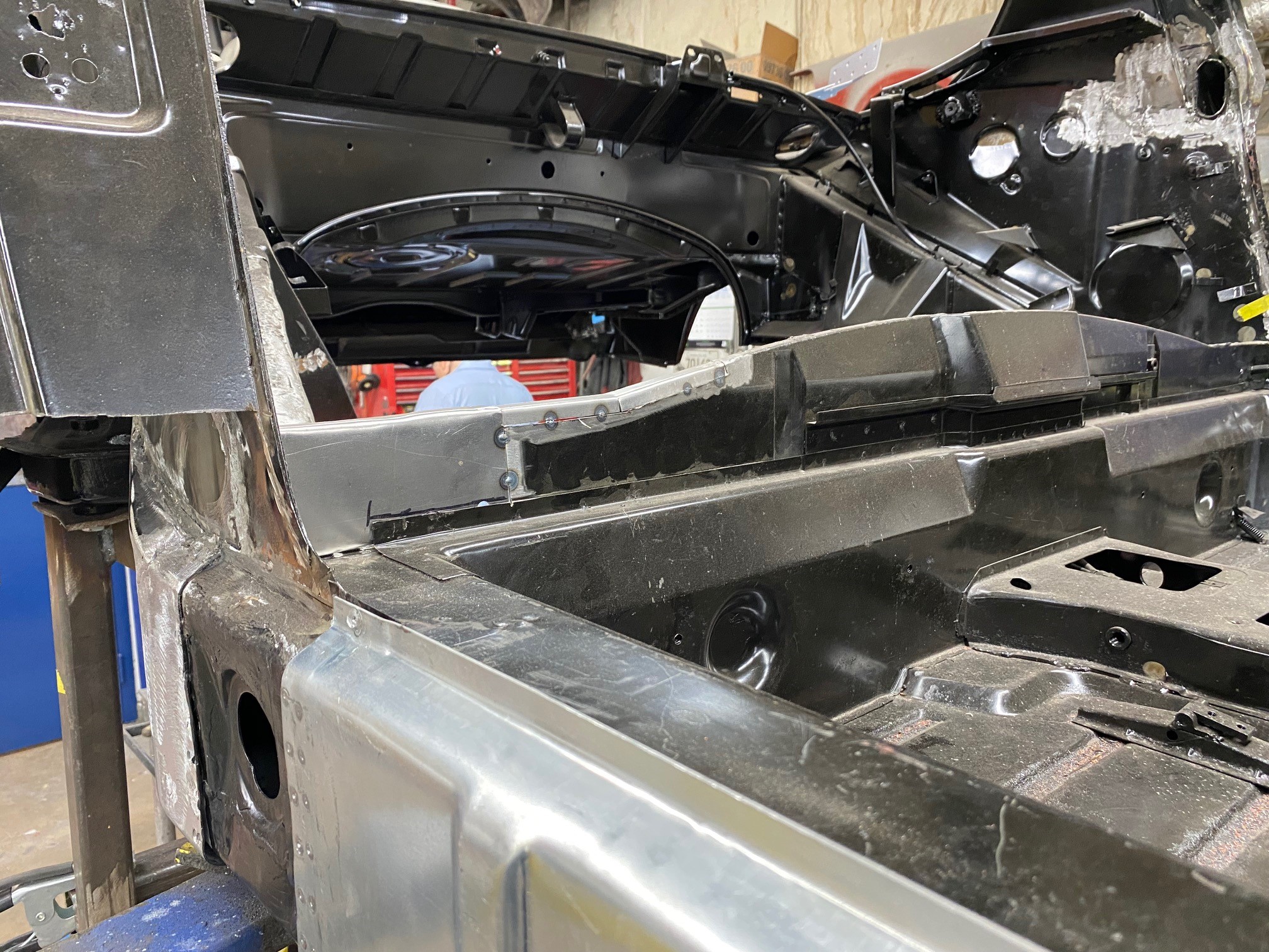

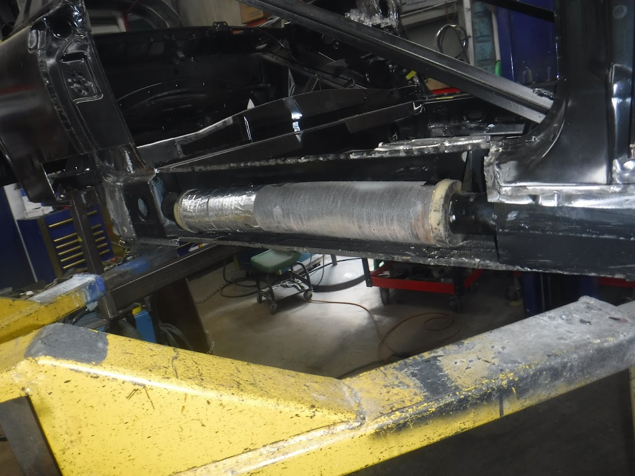

More progress on rust repair at Auto Associates. Engine bay L&R (hell hole) side rust repaired. Heater tubes reinstalled and outer longitudinals being replaced. Interesting note on the acid/e-coat dip. We have found some spots where neither the acid nor the e-coat penetrated. Fortunately, these areas also had only light surface rust.

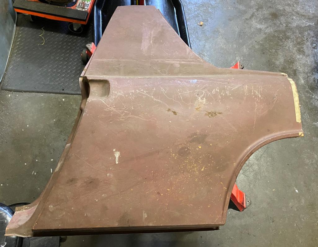

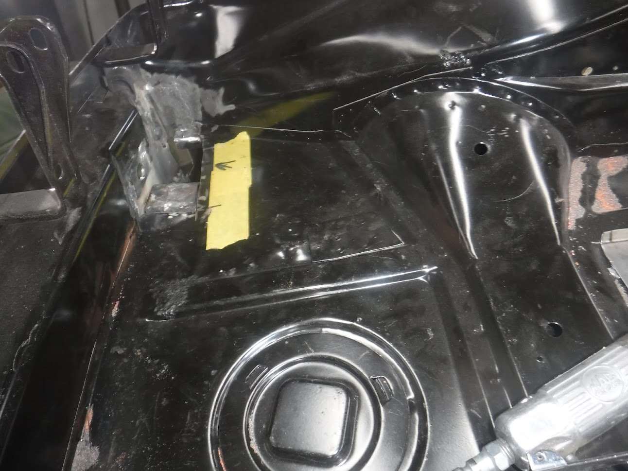

Member No.: 8,039

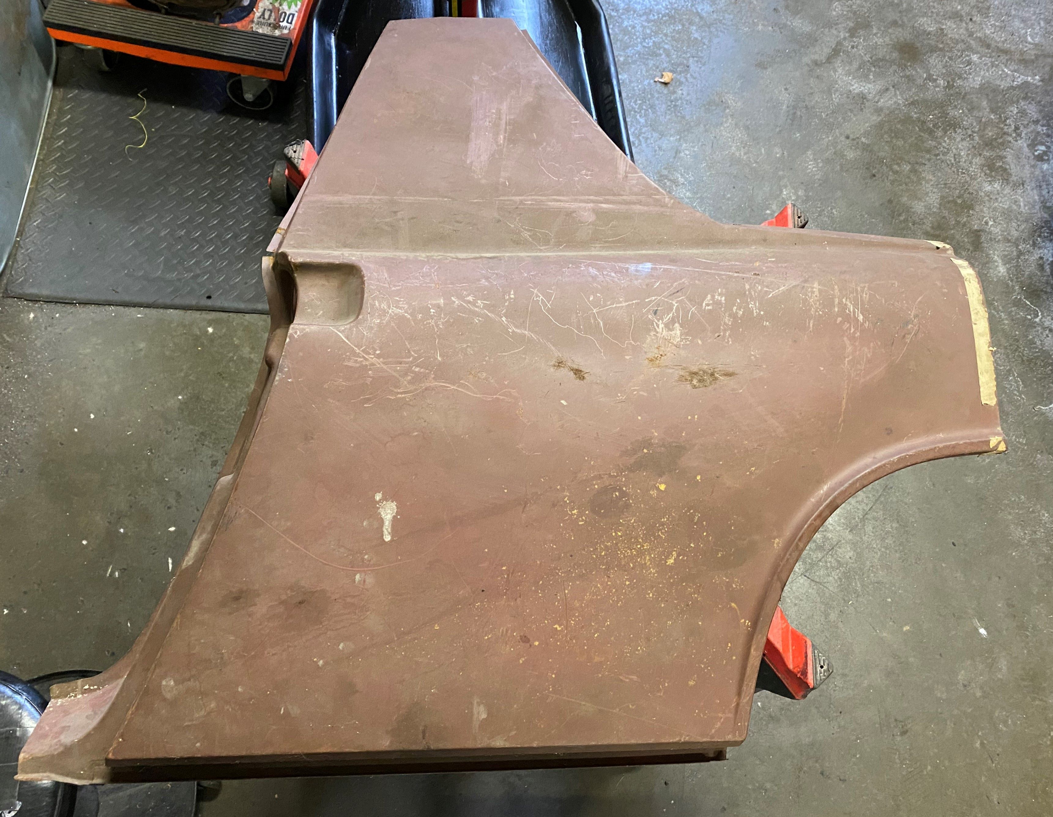

I was able to find some good replacement panels. A LHS sail/rear quarter at Carlisle and a rear panel from our friend Chris Foley. We will use only the taillight section of the rear panel. However, if anyone has a good RHS sail/rear quarter panel like the LHS I found, we could make good use of it.
Front fender well repairs are also completed.

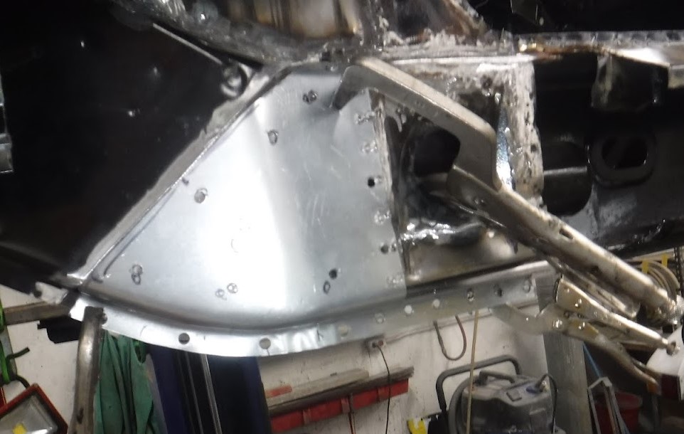

Tom1394racing
post May 27 2023, 08:16 AM
Post #111
Posts: 525
From: CT
Member No.: 8,039

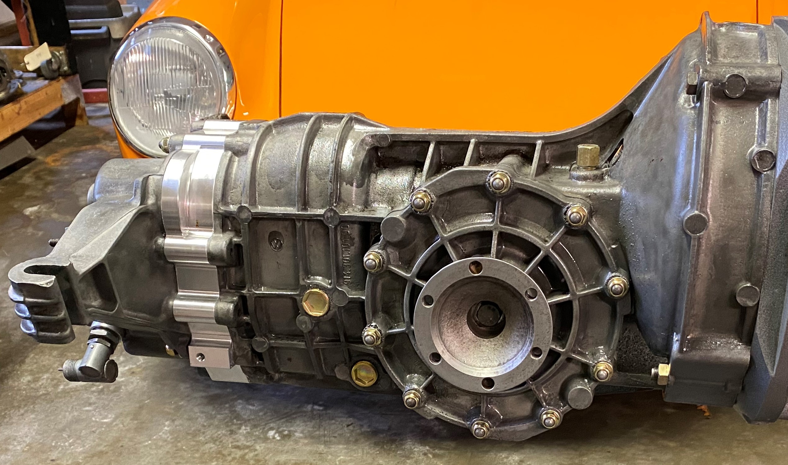

In the meantime, the original '73 side shift gearbox has been rebuilt with a billet Al intermediate plate and 108 mm output shafts to mate with sway away axles and 911 108 mm CV's. The intermediate plate was drilled and tapped to accept the 914-6 throttle bell crank. The gear box will also get the Tangerine Racing precision shift coupler.
Tom1394racing
post Jun 13 2023, 03:31 PM
Post #112
Posts: 525
From: CT
Member No.: 8,039

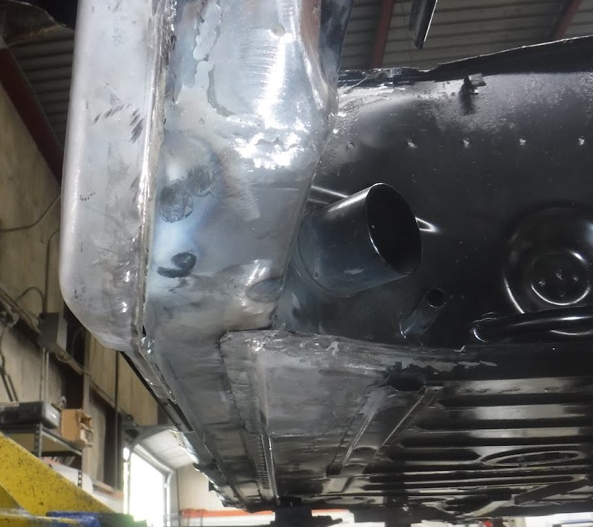

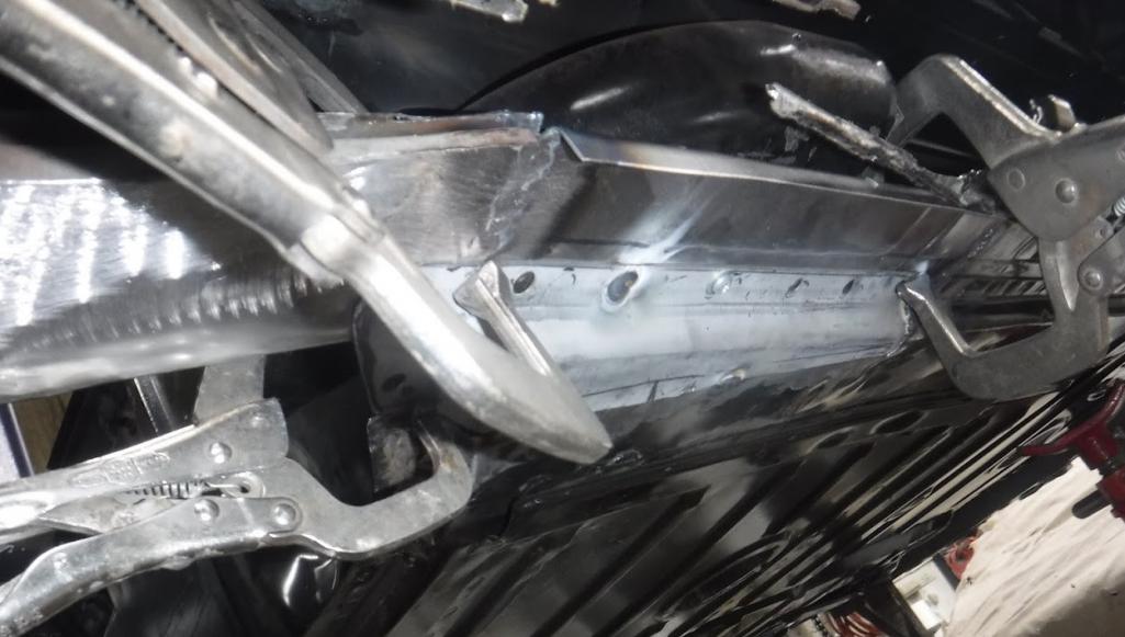

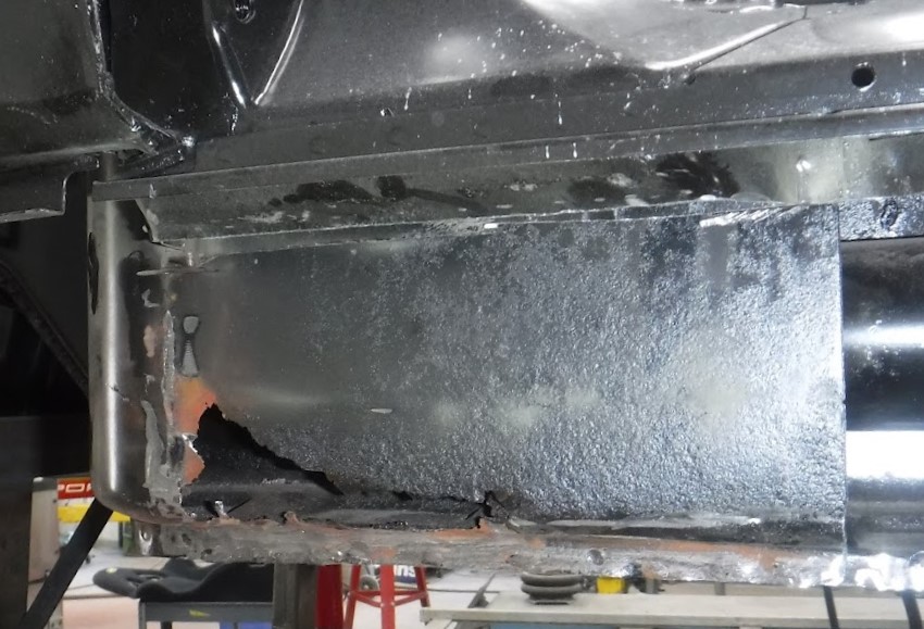

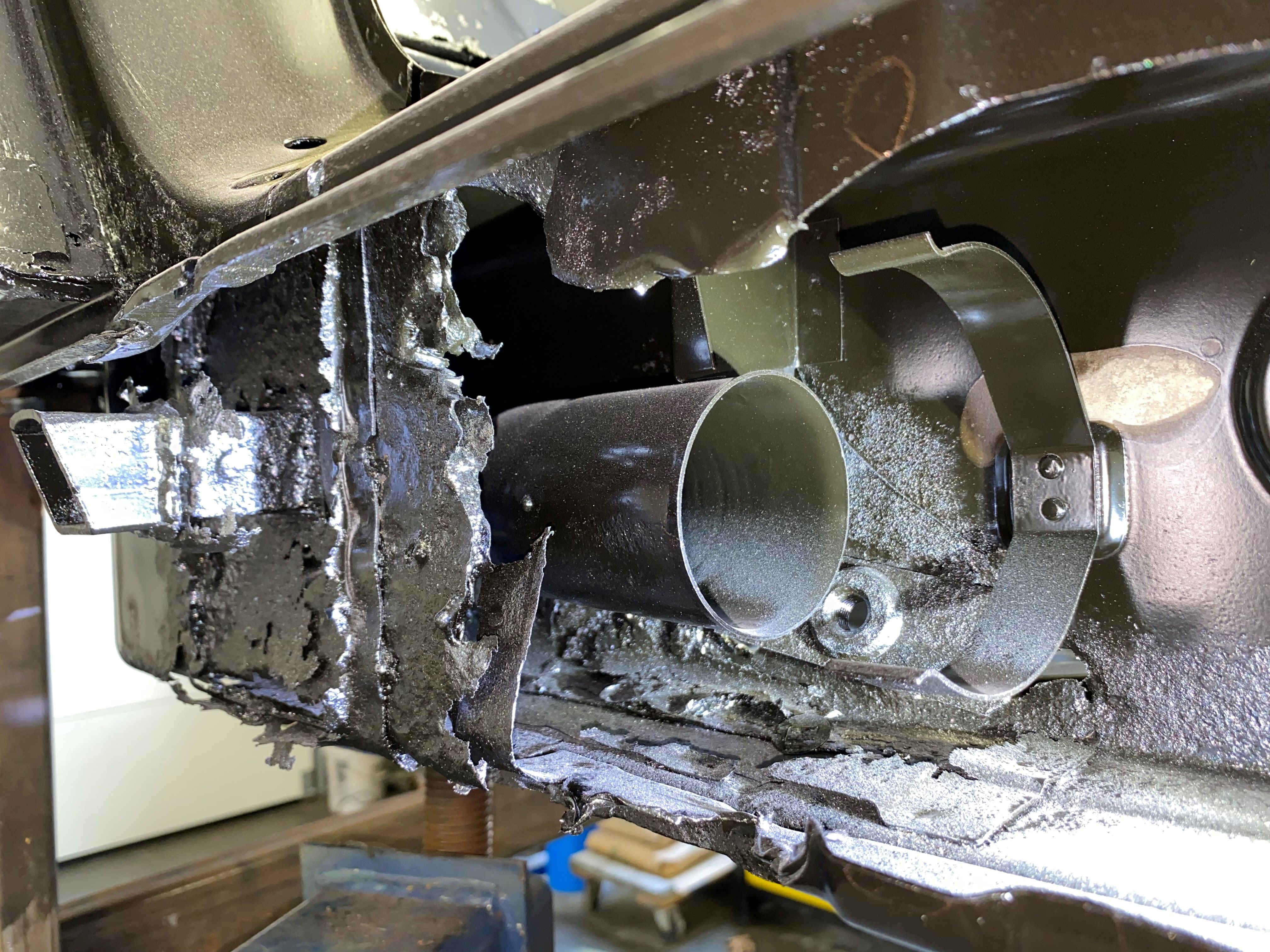

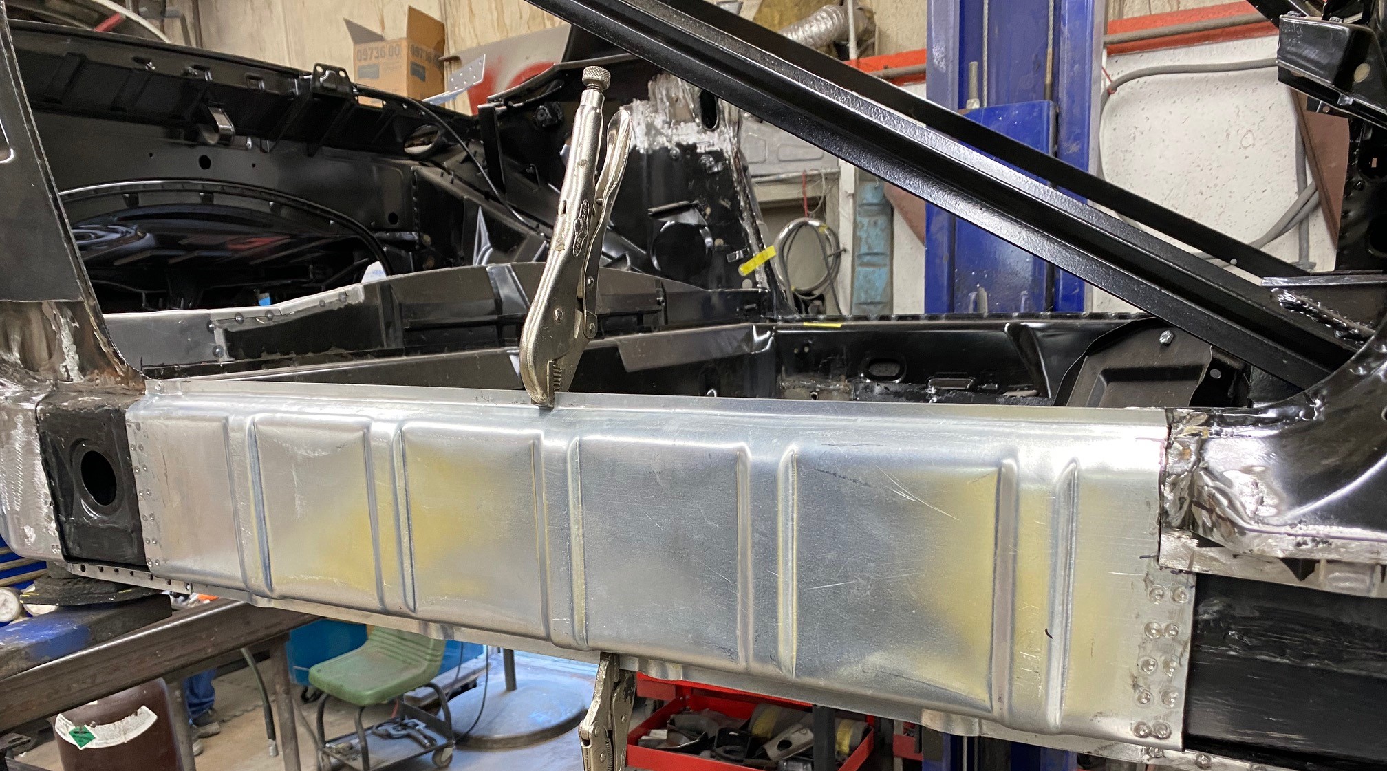

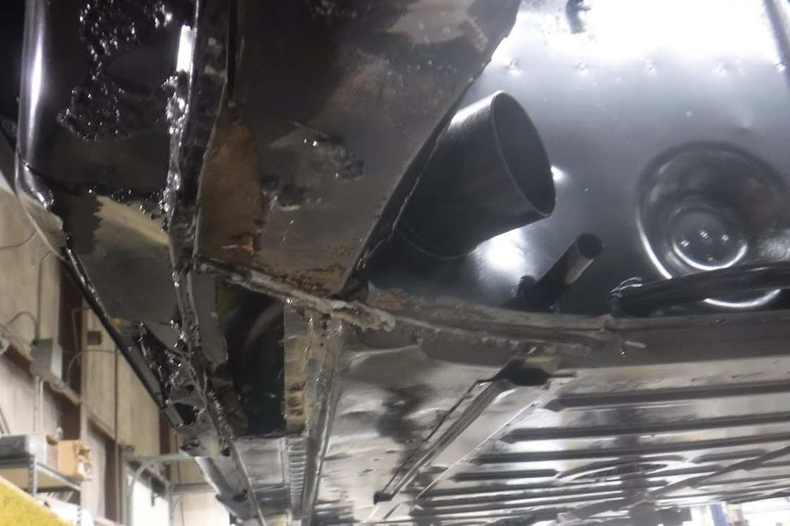

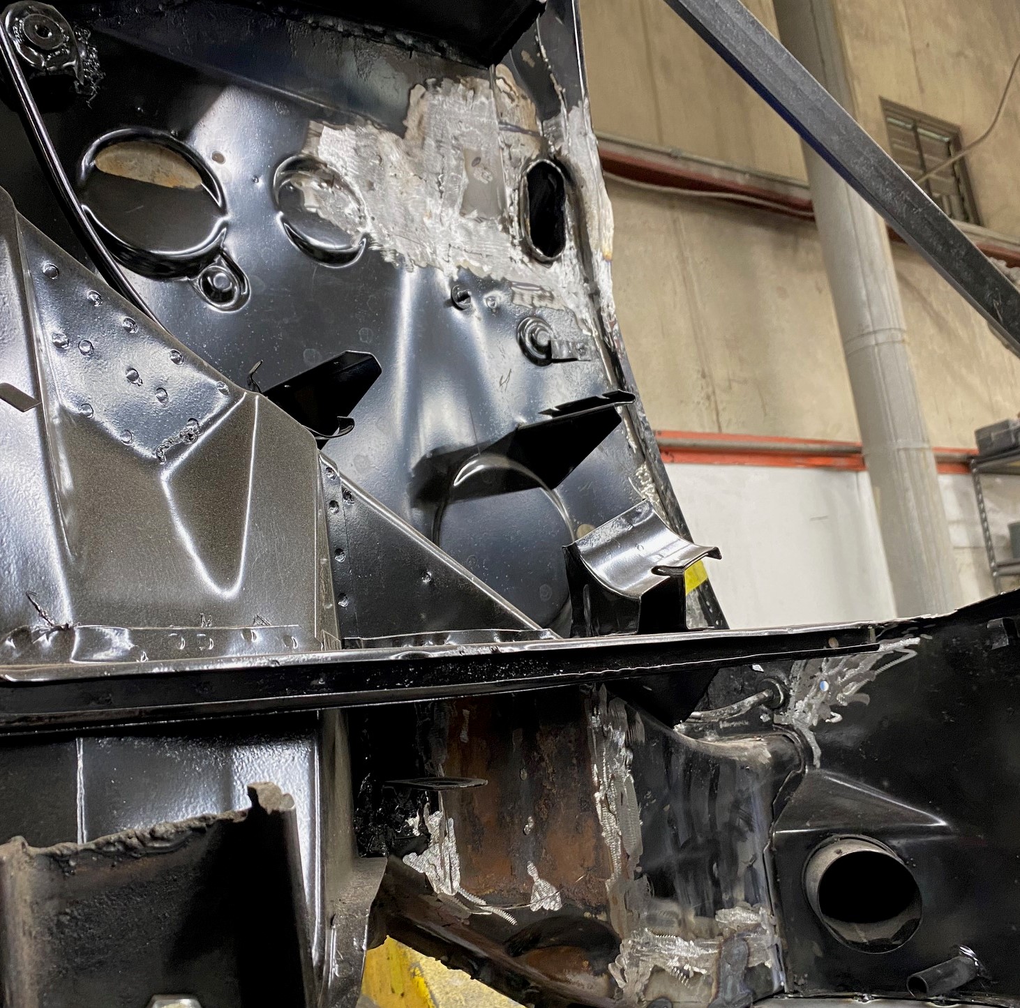

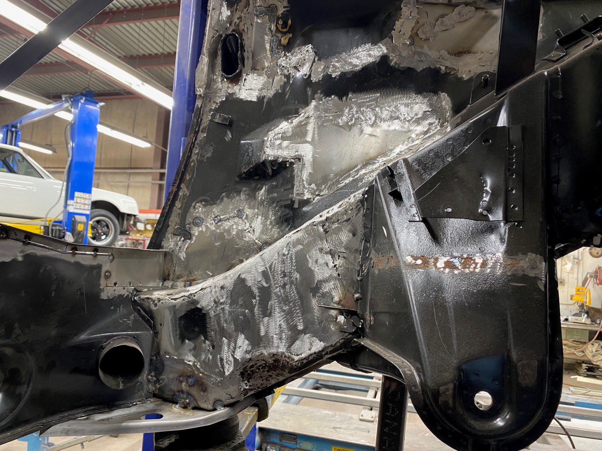

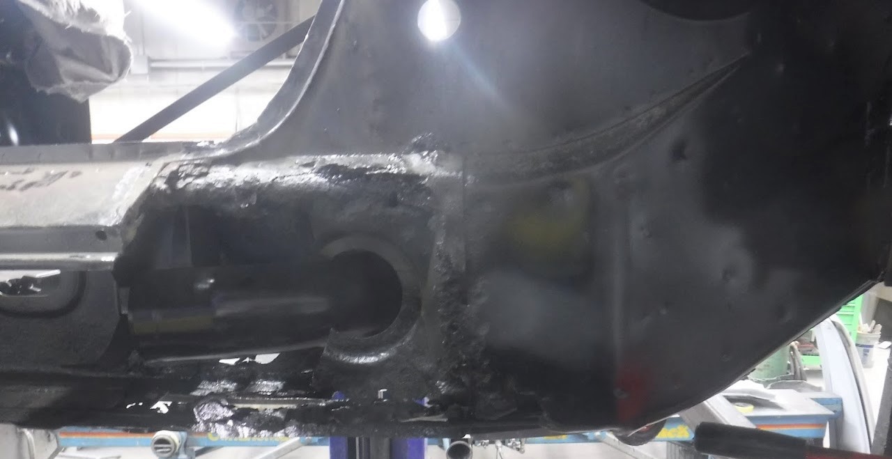

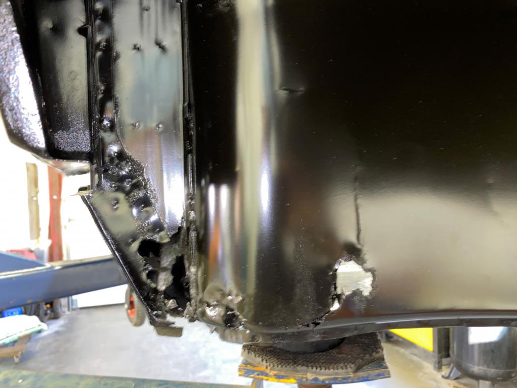

Rust repairs are continuing at Auto Associates. I thought it might be useful to post more detailed photos of the process. Here are repairs to the right front corner.

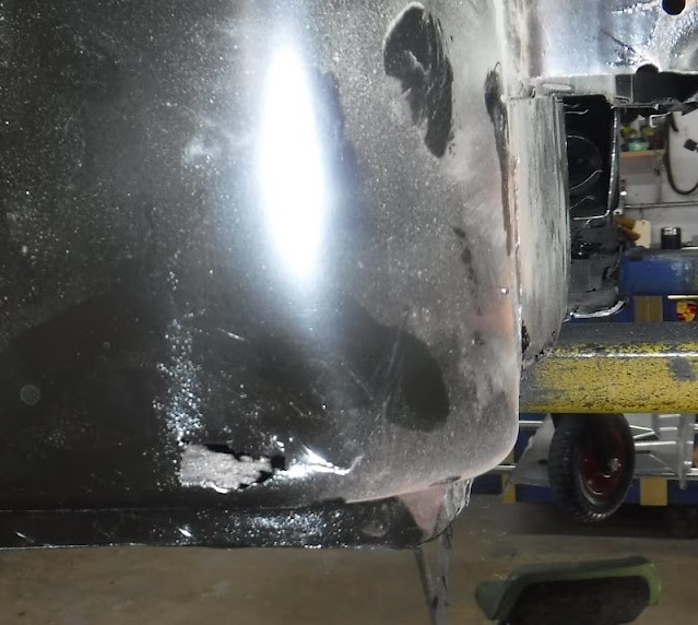

Tom1394racing

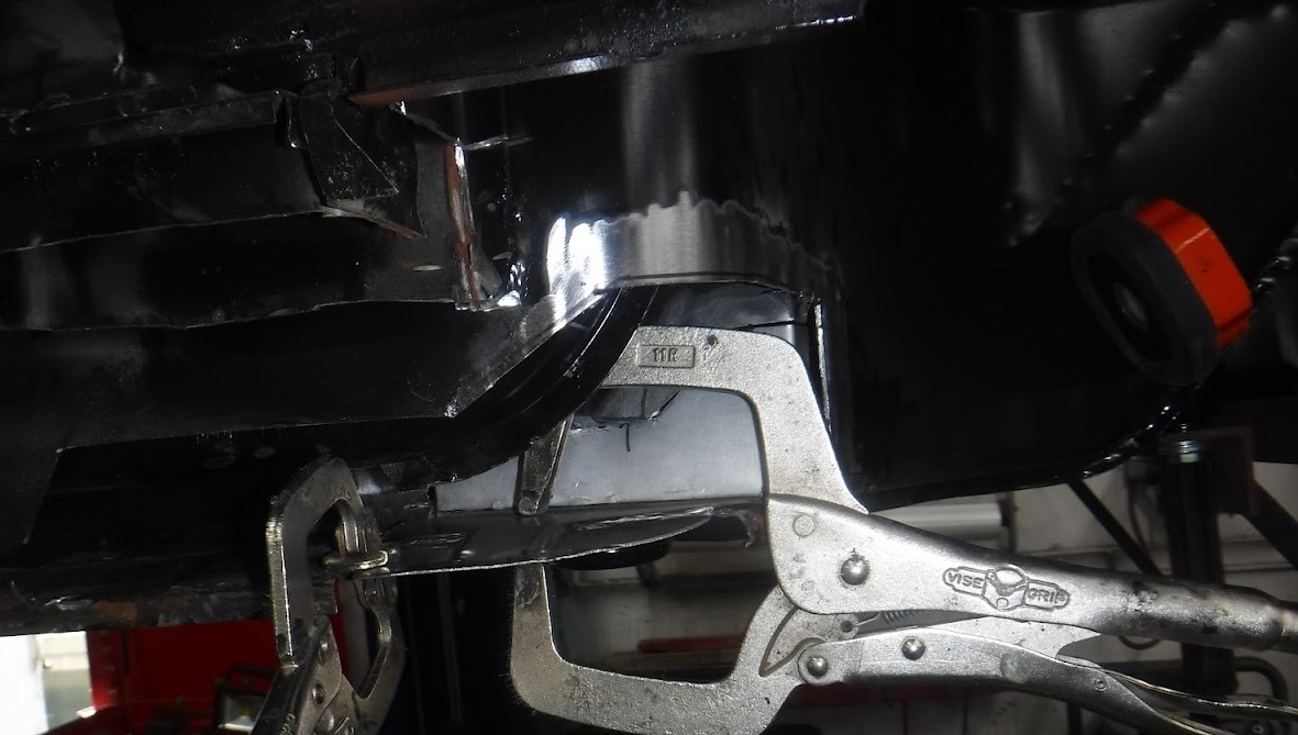

post Jun 13 2023, 03:40 PM
Post #113
Posts: 525
From: CT
Member No.: 8,039

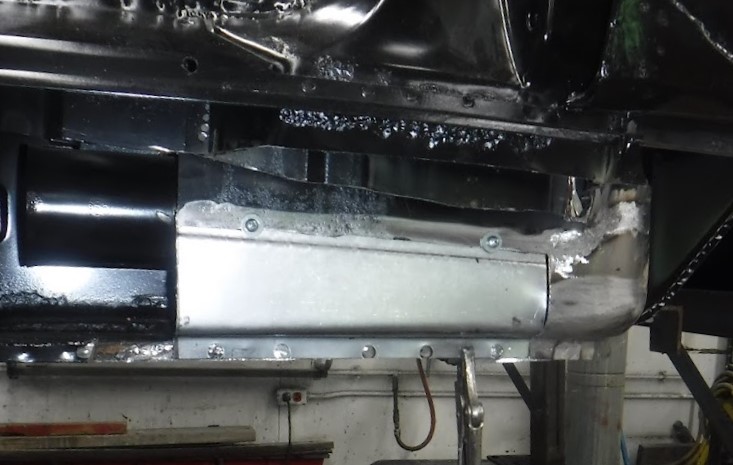

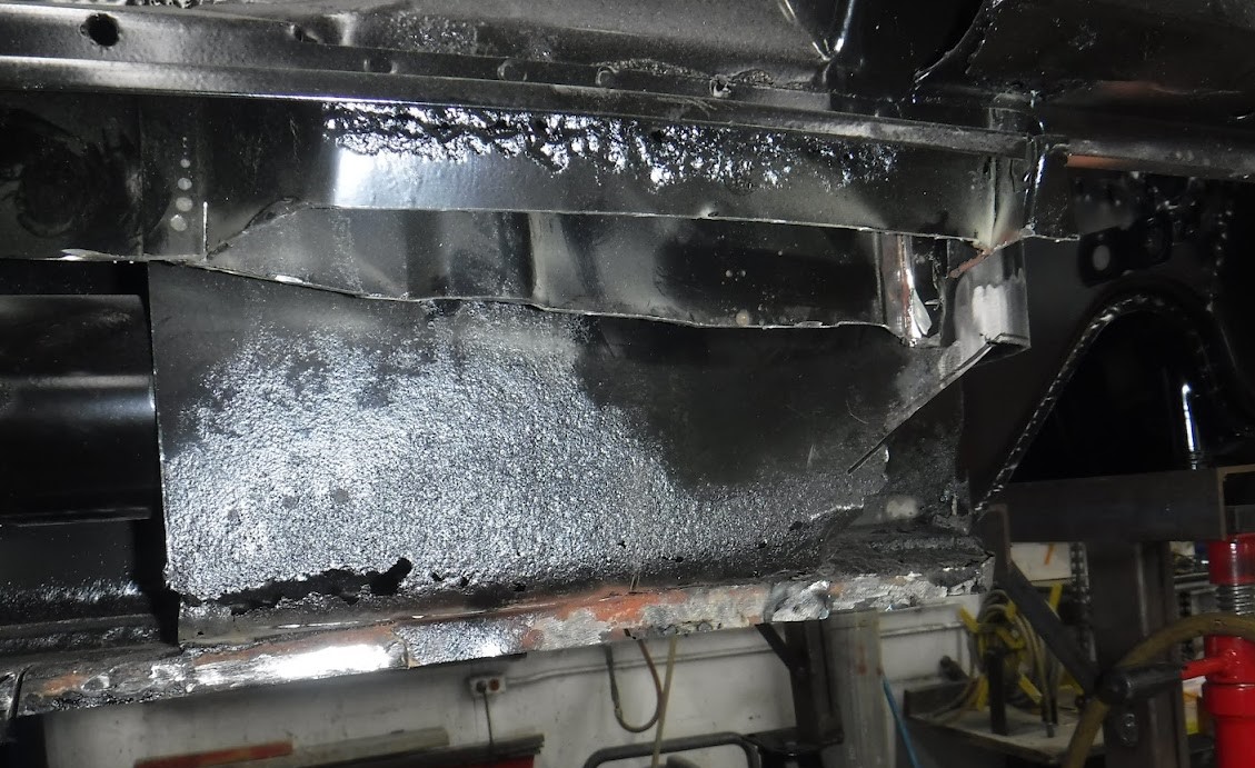

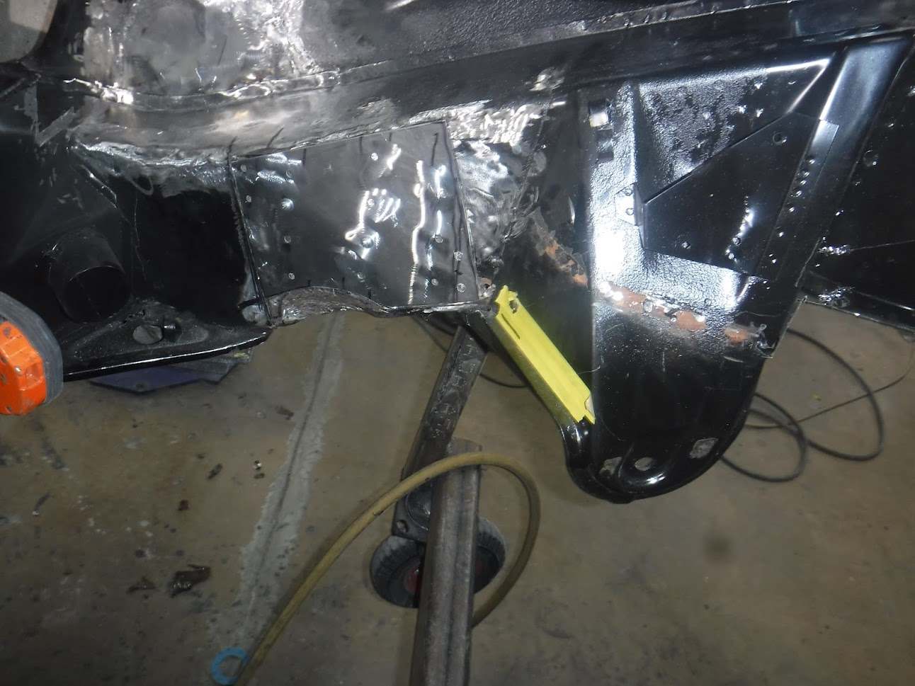

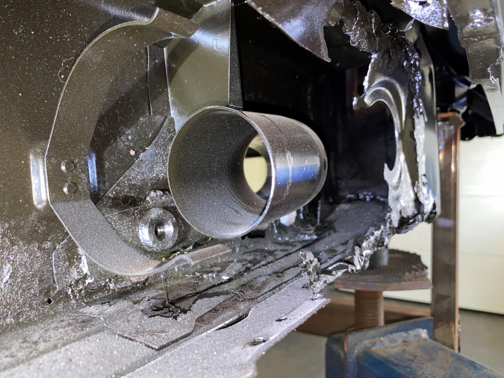

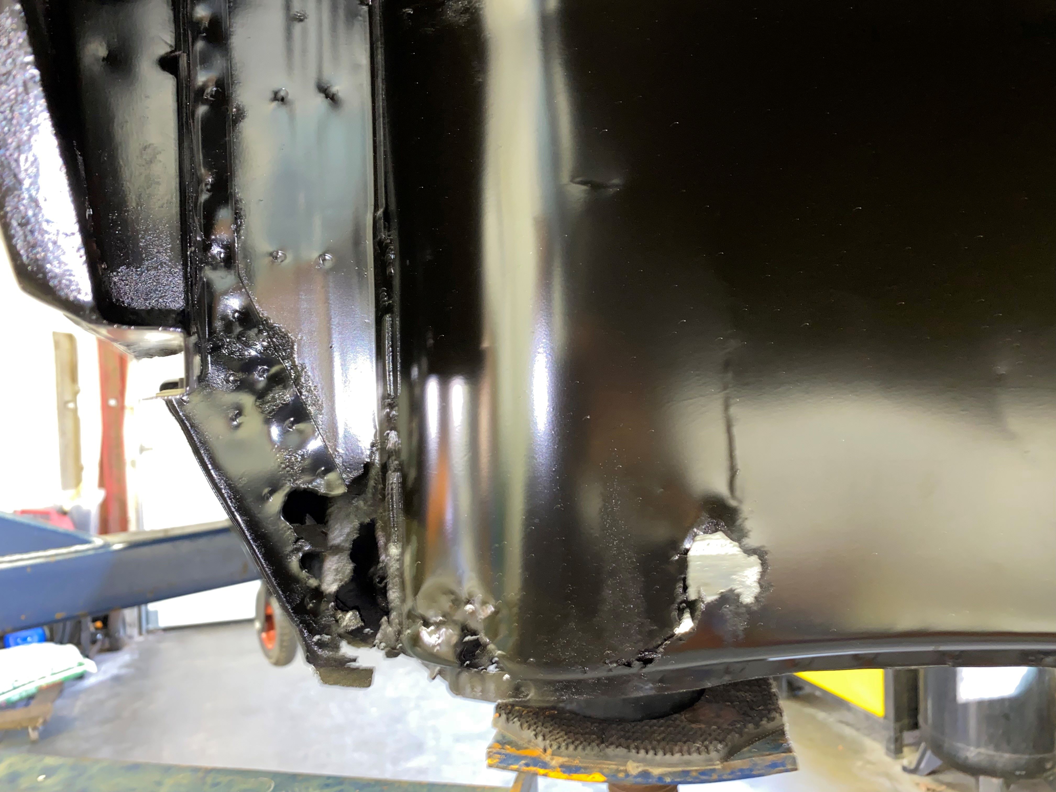

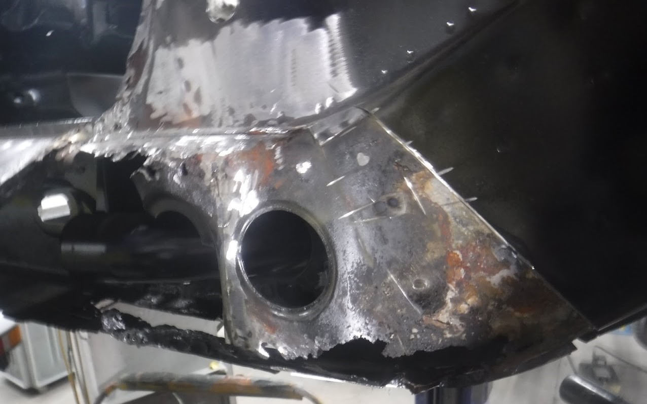

Here are the repairs to the left front corner.

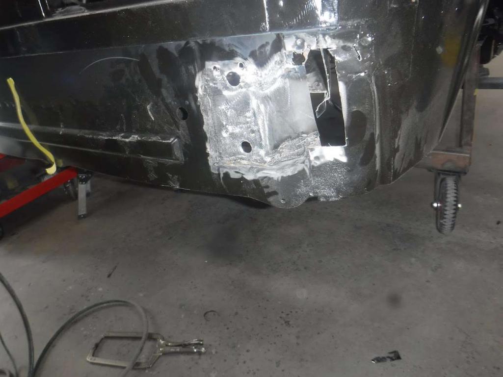

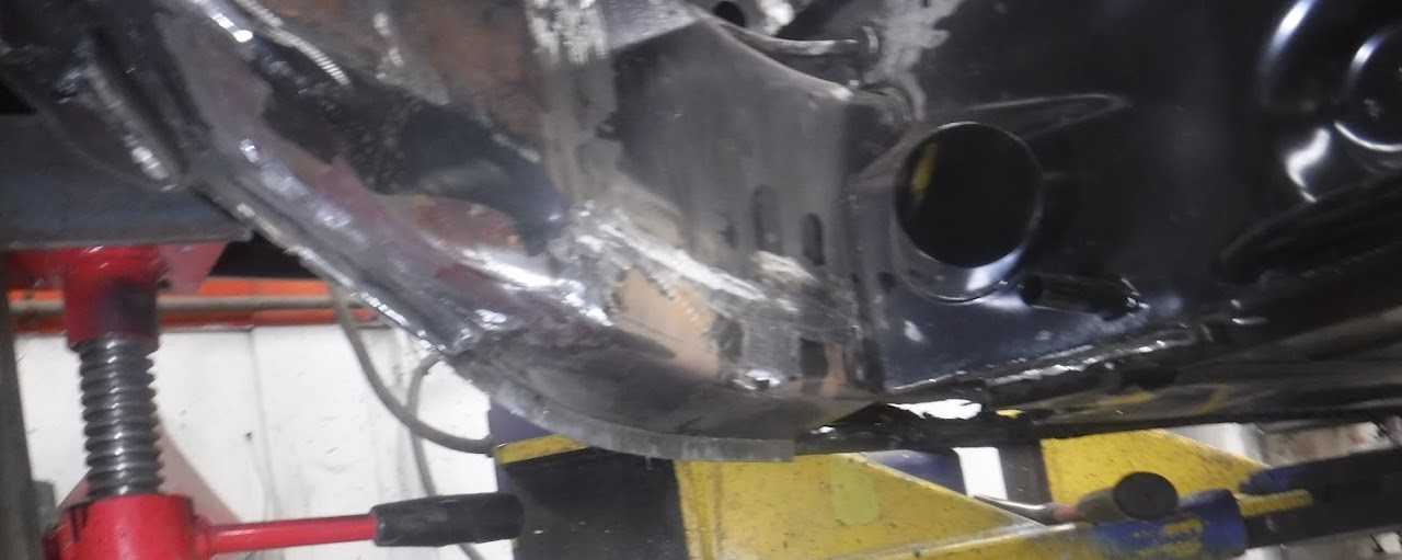

Tom1394racing
post Jun 13 2023, 03:48 PM
Post #114
Posts: 525
From: CT
Member No.: 8,039

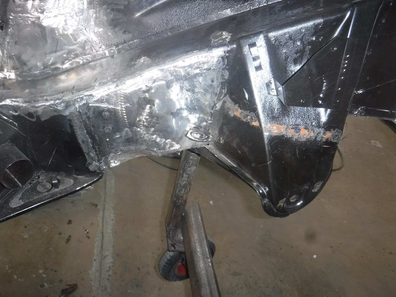

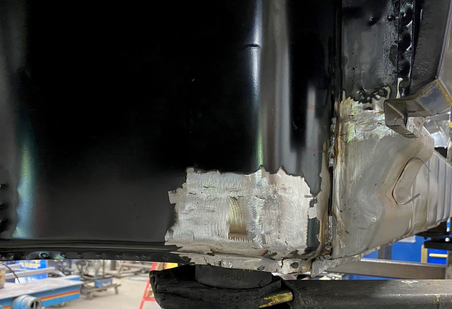

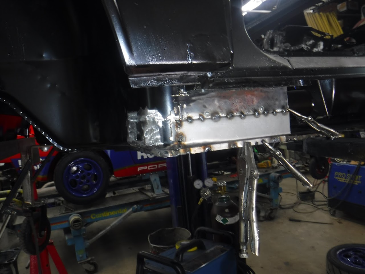

Here are the repairs to the left rear corner.

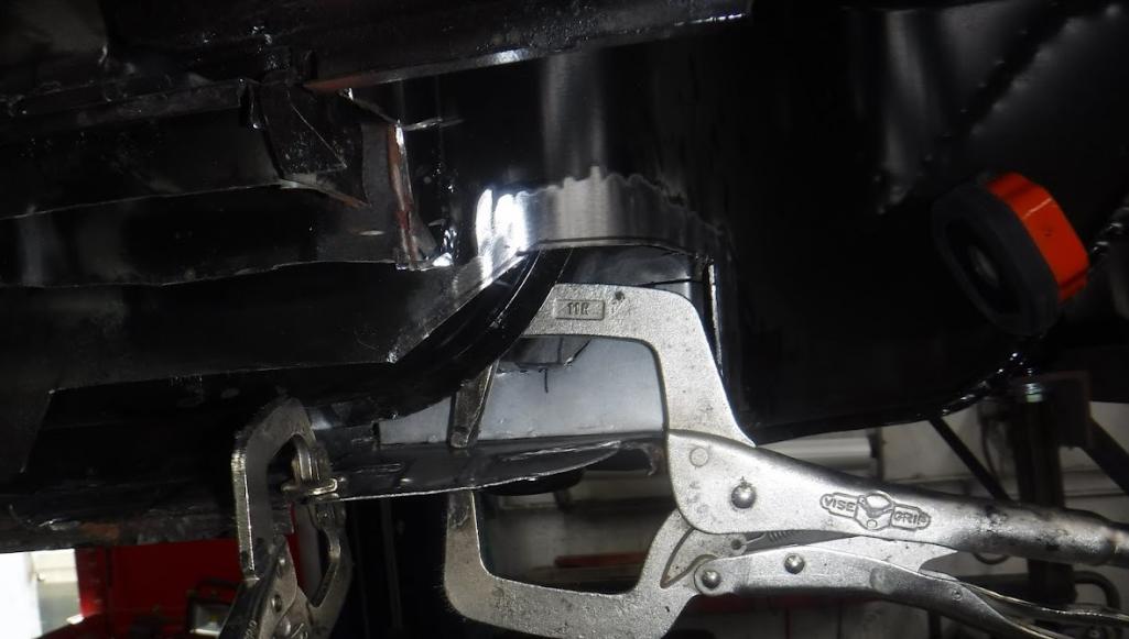

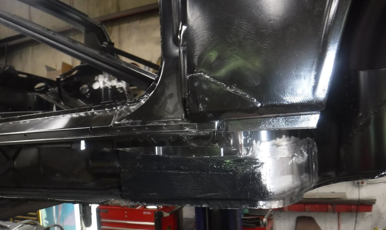

Tom1394racing
post Jun 14 2023, 04:35 AM
Post #116
Posts: 525
From: CT
Member No.: 8,039

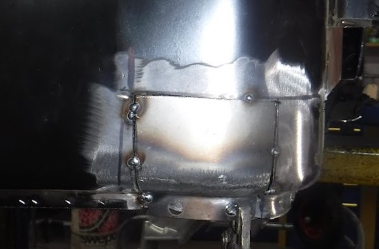

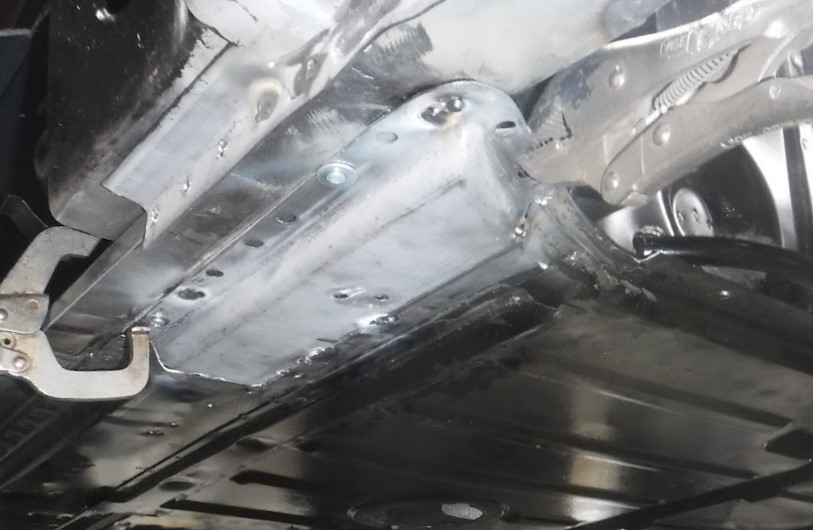

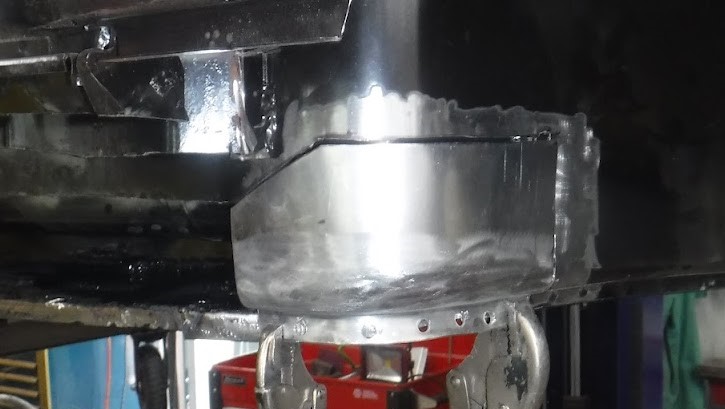

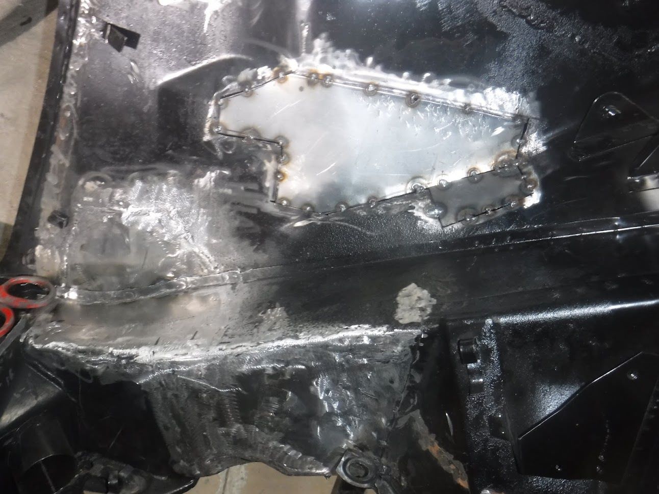

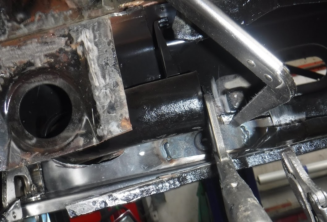

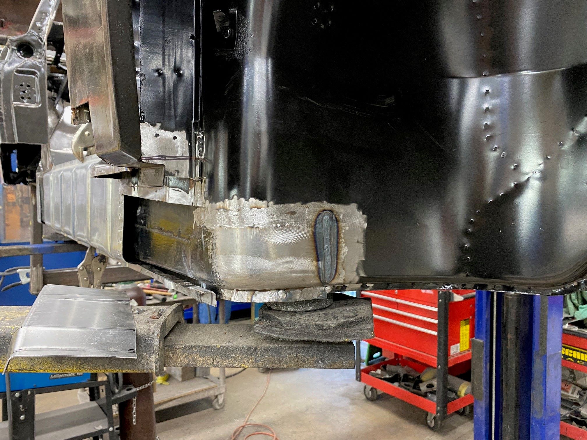

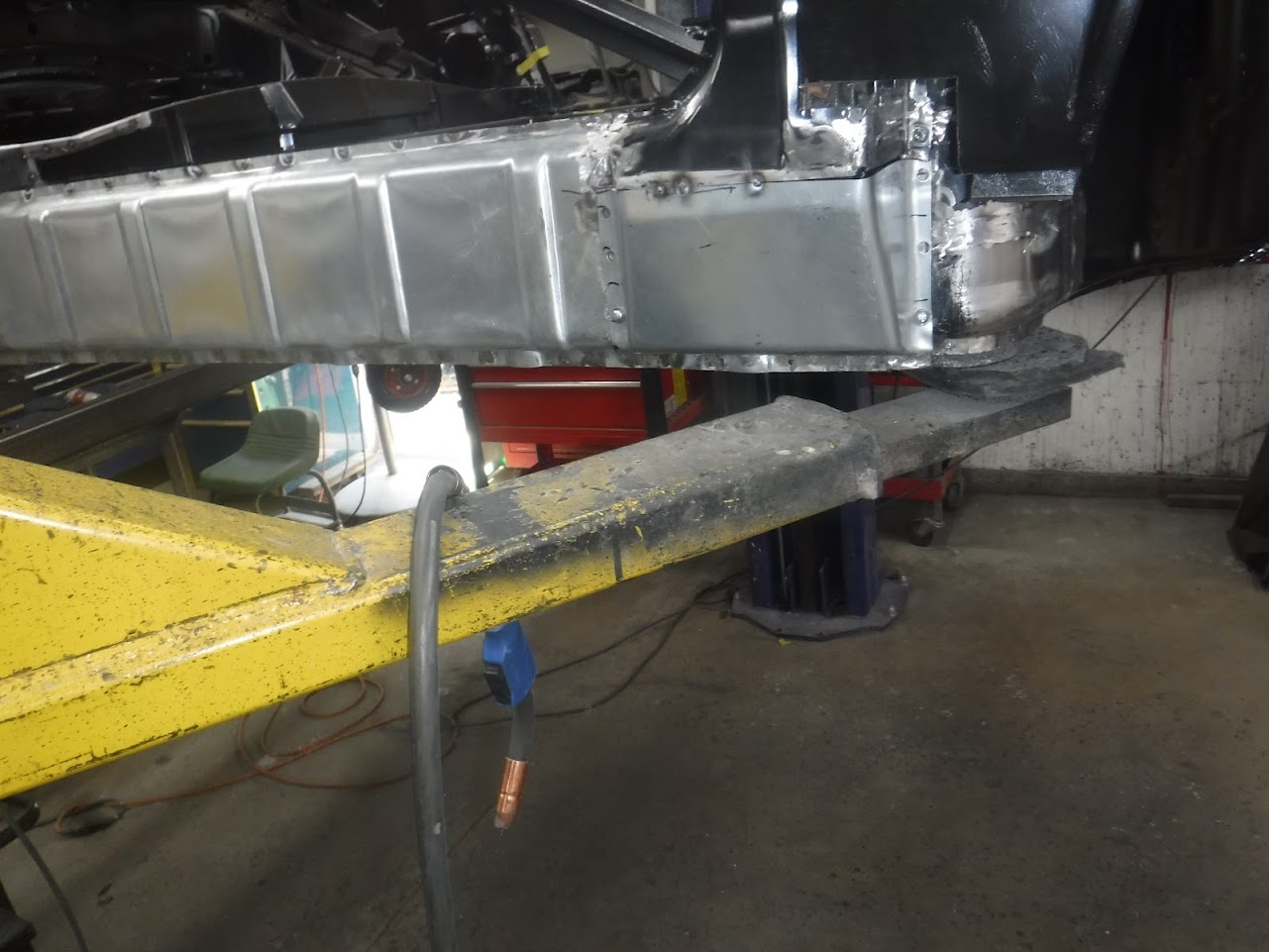

Here are the repairs to the right rear corner.

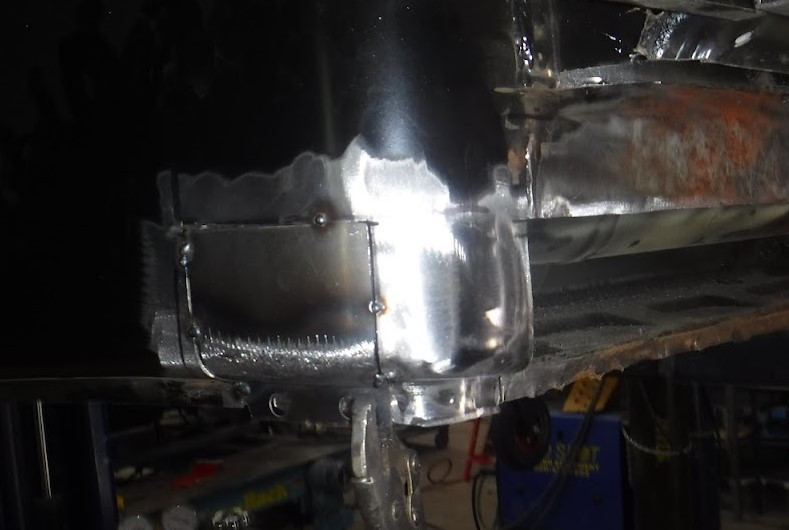

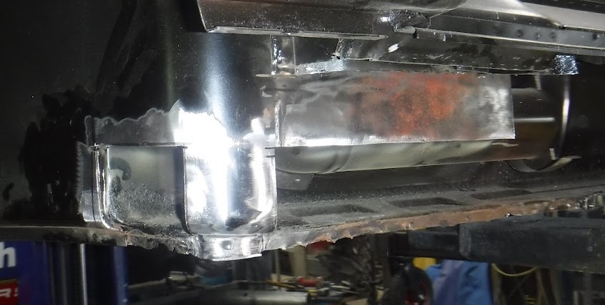

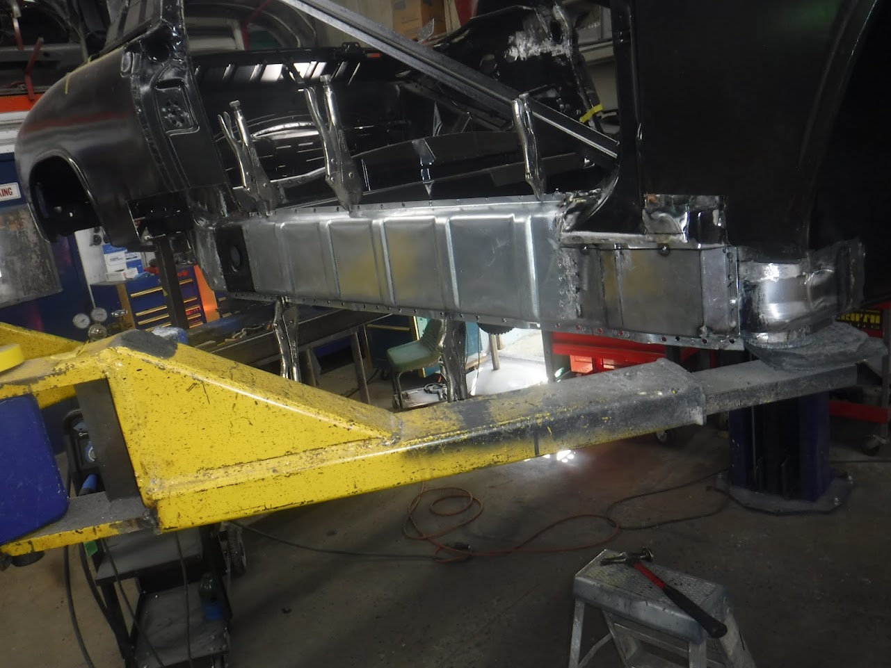

Tom1394racing
post Jun 14 2023, 04:42 AM
Post #117
Posts: 525
From: CT
Member No.: 8,039

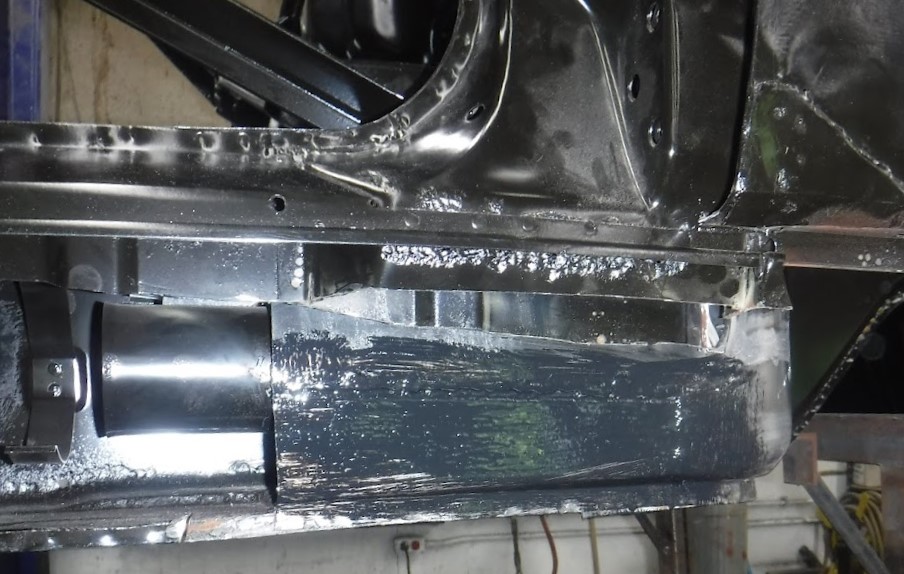

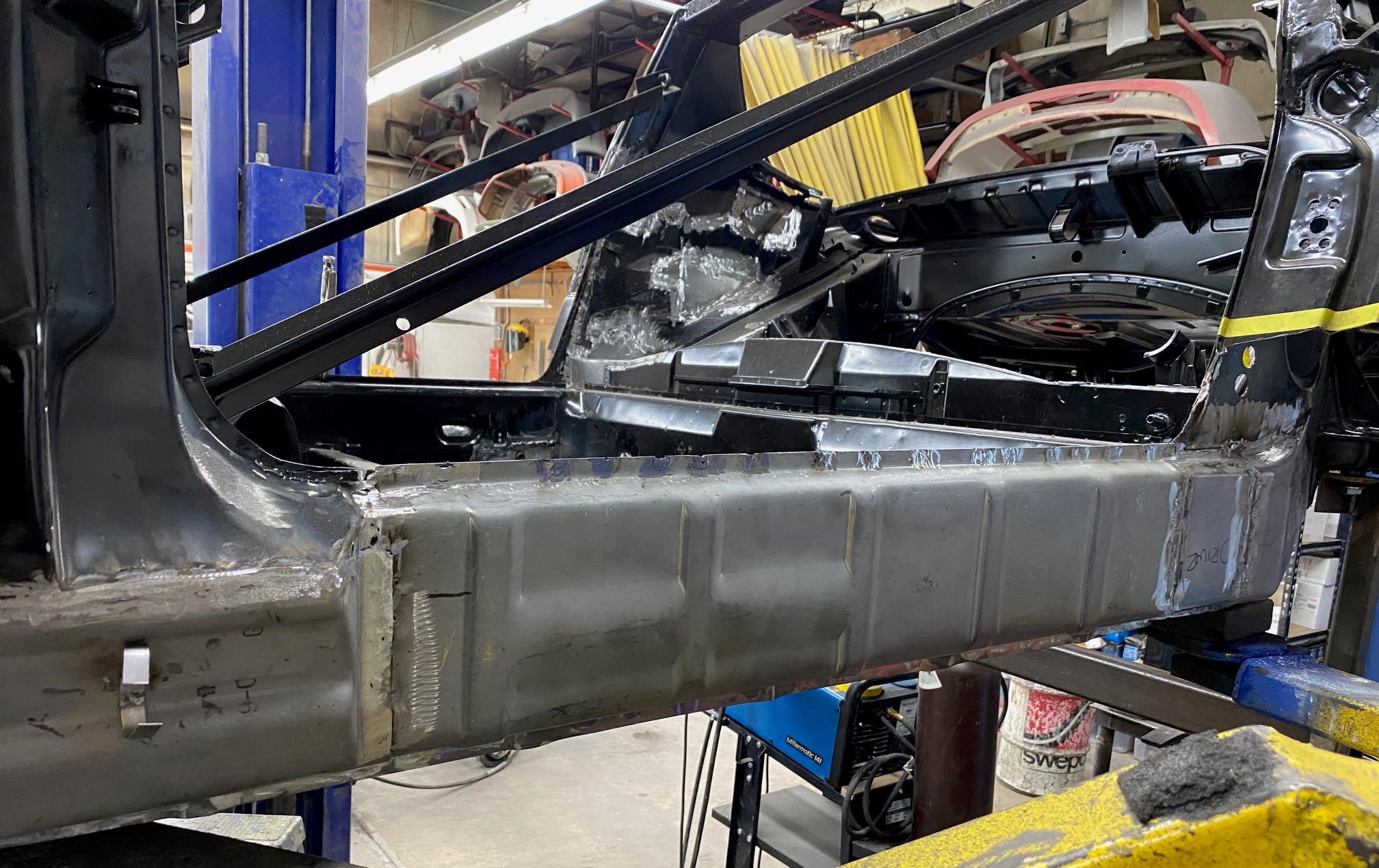

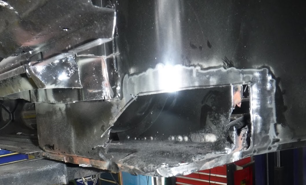

Here are the repairs to the RHS outer longitudinal.
