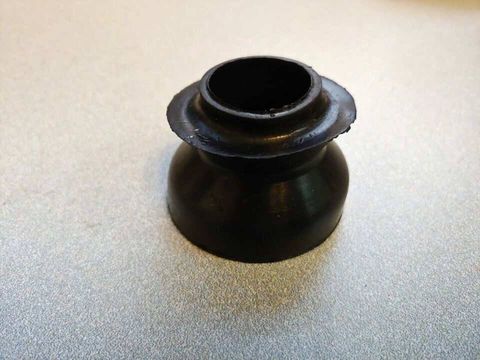

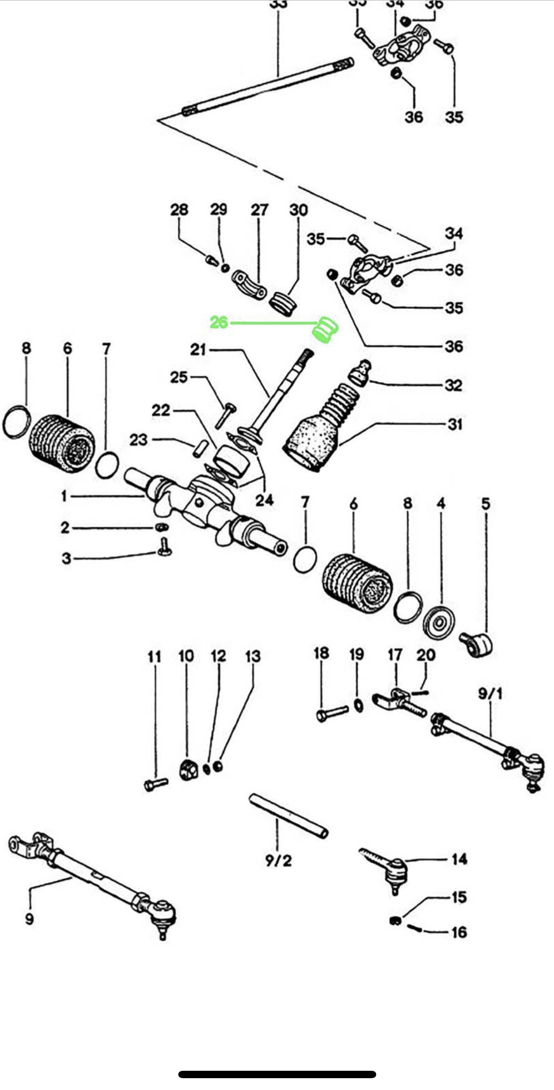

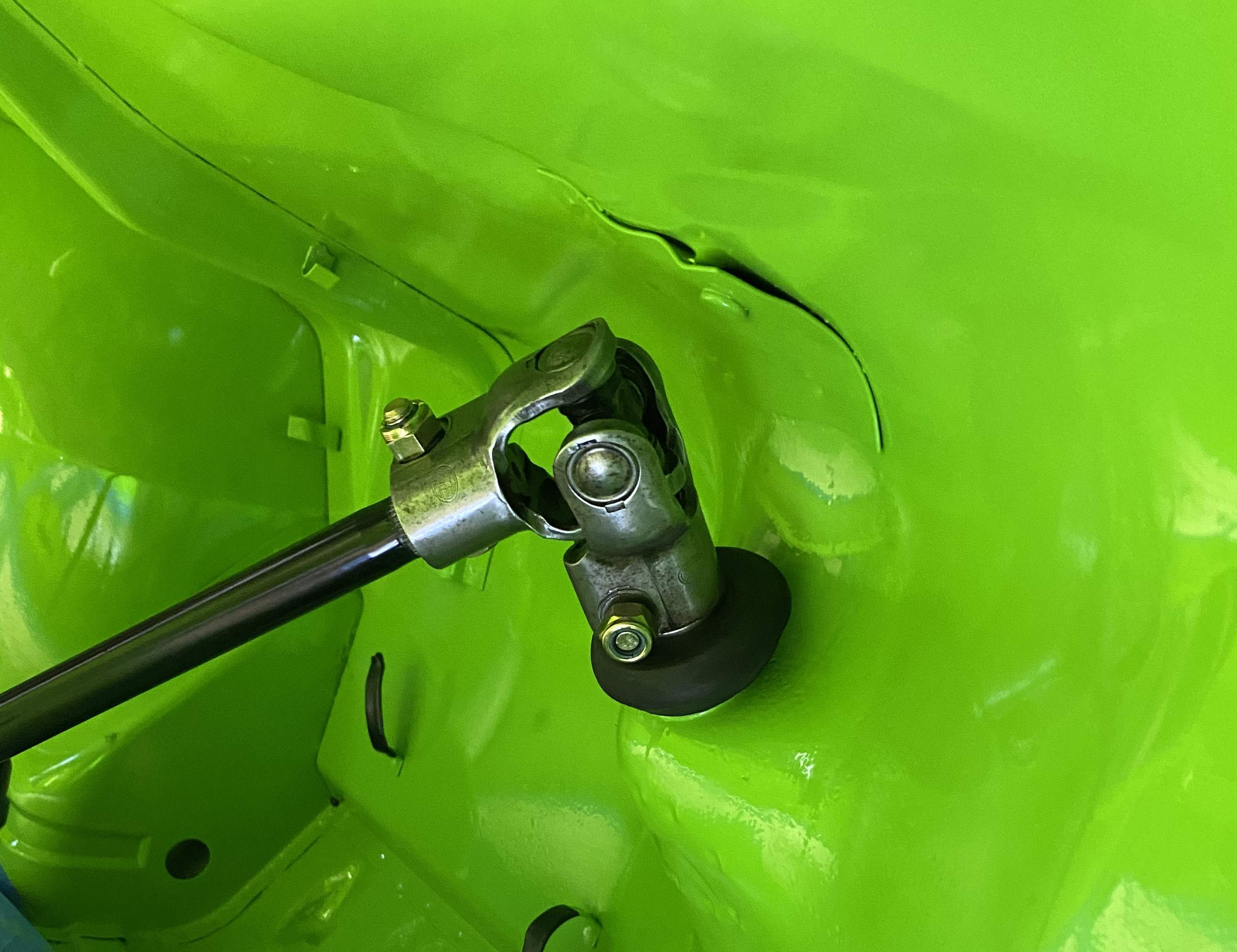

QUOTE(Tom1394racing @ Nov 3 2023, 05:11 PM) *
So what is the deal on the thru hole for the steering rack shaft? It seems there should be some type of grommet to close up the hole?? I could not see anything on the parts diagram. What do we do about this?
(IMG:style_emoticons/default/agree.gif) This flummoxed me, too... there had to be something. Whether it's correct or not, I'm making a grommet work here.

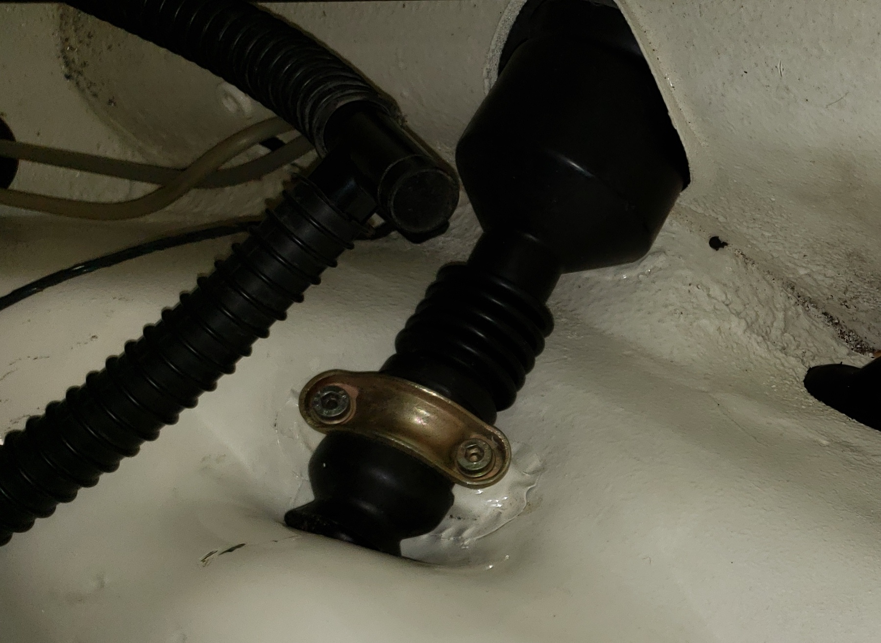

Tom the black collar/bearing that slips over the first shaft on the rack should press
against the tank side of that hole. I has a small lip to form a seal there.
Could it be reversed ?
I think you'll have to lower the rack/crossmember

QUOTE(mepstein @ Nov 3 2023, 08:40 PM) *
Thanks Mark
Any idea what that part is and where to get one?

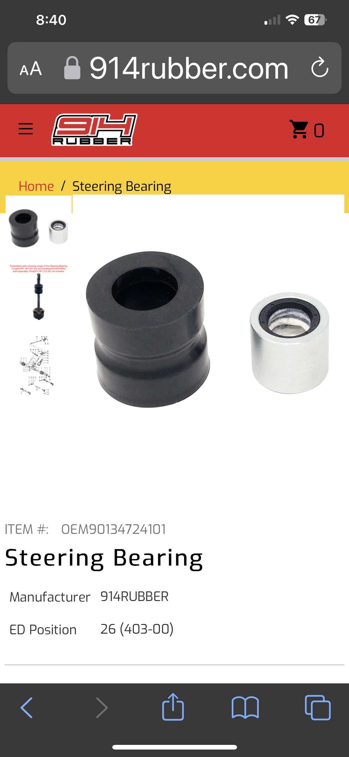

QUOTE(Tom1394racing @ Nov 4 2023, 06:51 AM) *
Thanks Mark
I may be missing something here but this is what came to mind when I saw your first post. Pretty reasonable price at 914 rubber.

QUOTE(mepstein @ Nov 4 2023, 09:35 AM) *
Thanks Mark
I think that is the rubber, two-piece steering bearing that is clamped to the chassis shown in my photo. The parts diagram shows it as two separate pieces but they fit together.

QUOTE(gms @ Nov 3 2023, 07:19 PM) *
QUOTE(Bullethead @ Nov 3 2023, 05:45 PM) *
you must be missing a piece
Ah! Thank you!

It is not the bearing it is the collar above it.
Calling @GaroldShaffer !
I bet he has 100 of them
gms
post Nov 4 2023, 09:01 AM
Post #251
Posts: 2,753
Joined: 12-March 04
From: Chicagoland
Member No.: 1,785
91434770601

I emailed Garold to see if He has any of these. I am not inclined to disassemble the front suspension to slide this on to the streeting column. I bet I could split it and fit it over the end of the column and then glue it back together with weather stripping adhesive.

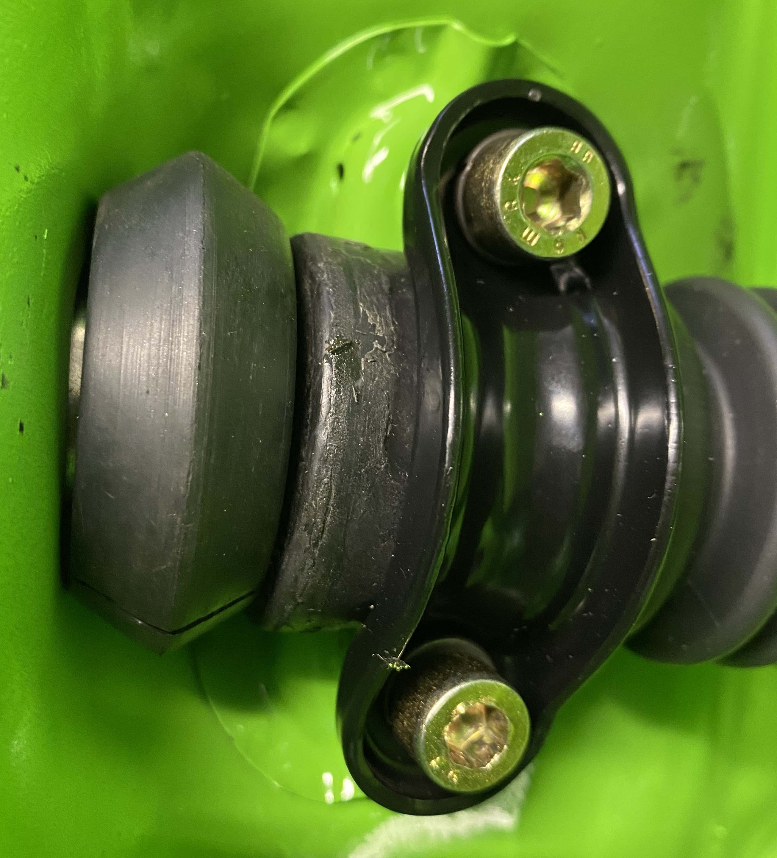

post Nov 7 2023, 06:41 PM
Post #256
Posts: 523
Joined: 25-August 07
From: CT
Member No.: 8,039

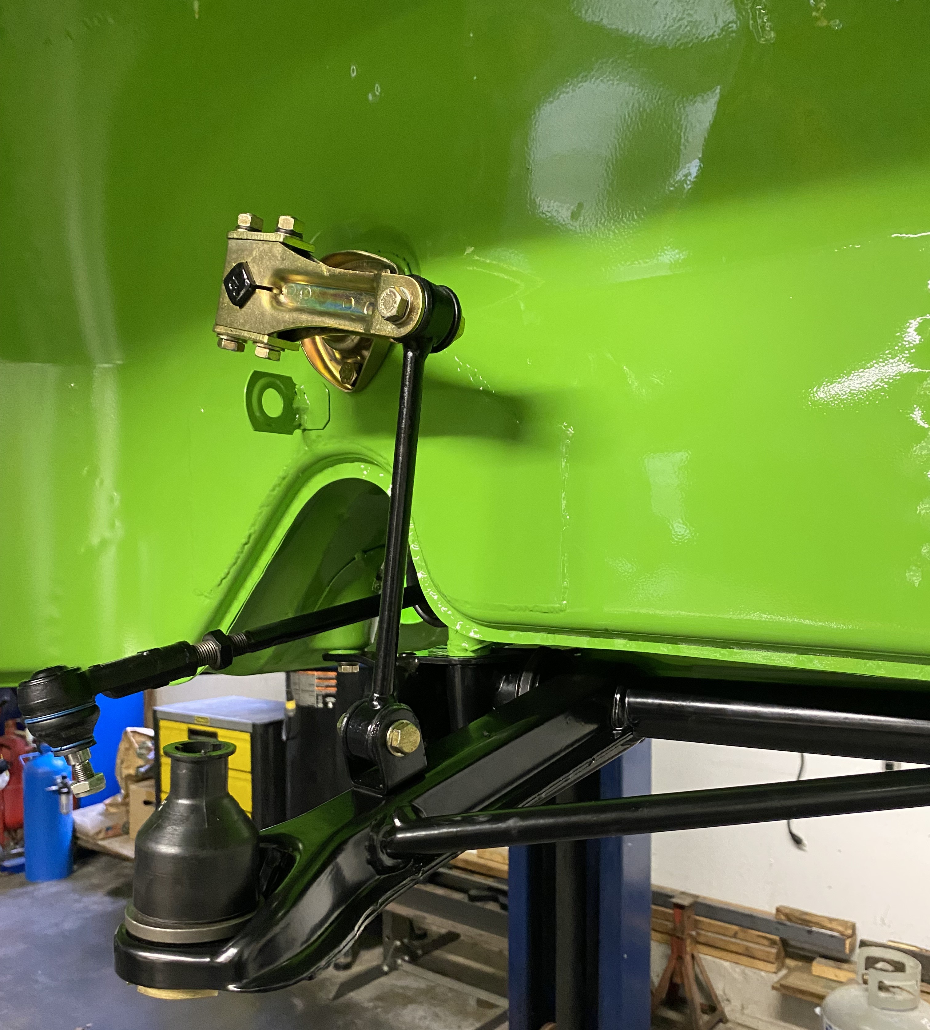

No luck on finding a replacement steering shaft bushing/seal so I improvised and tried a rear shock top bushing pair. The ID matches the steering shaft pretty close and closes up the hole nicely. Since I had gone ahead and completed the front suspension, I split the lower side of the bushing and fitted it over the steering shaft. Seems to work OK.
Next I will move to the rear suspension while I await the corrected new wiring harness from Restoration Design.

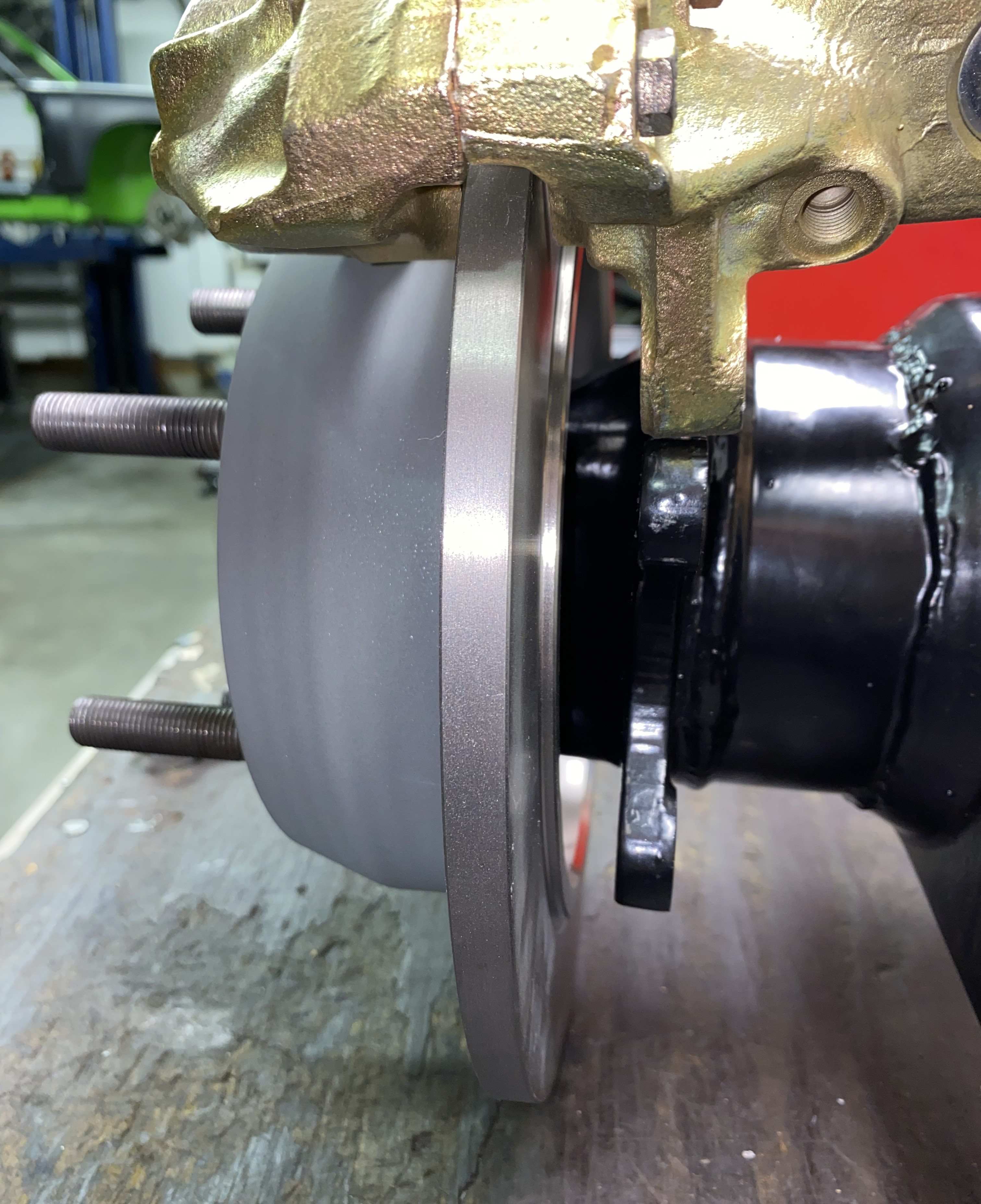

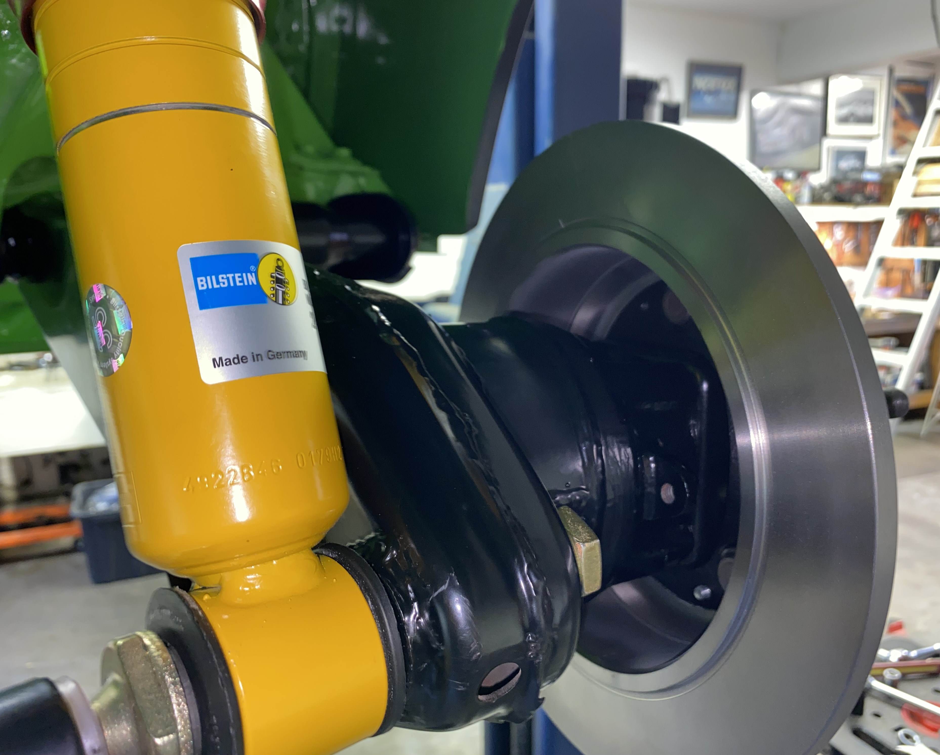

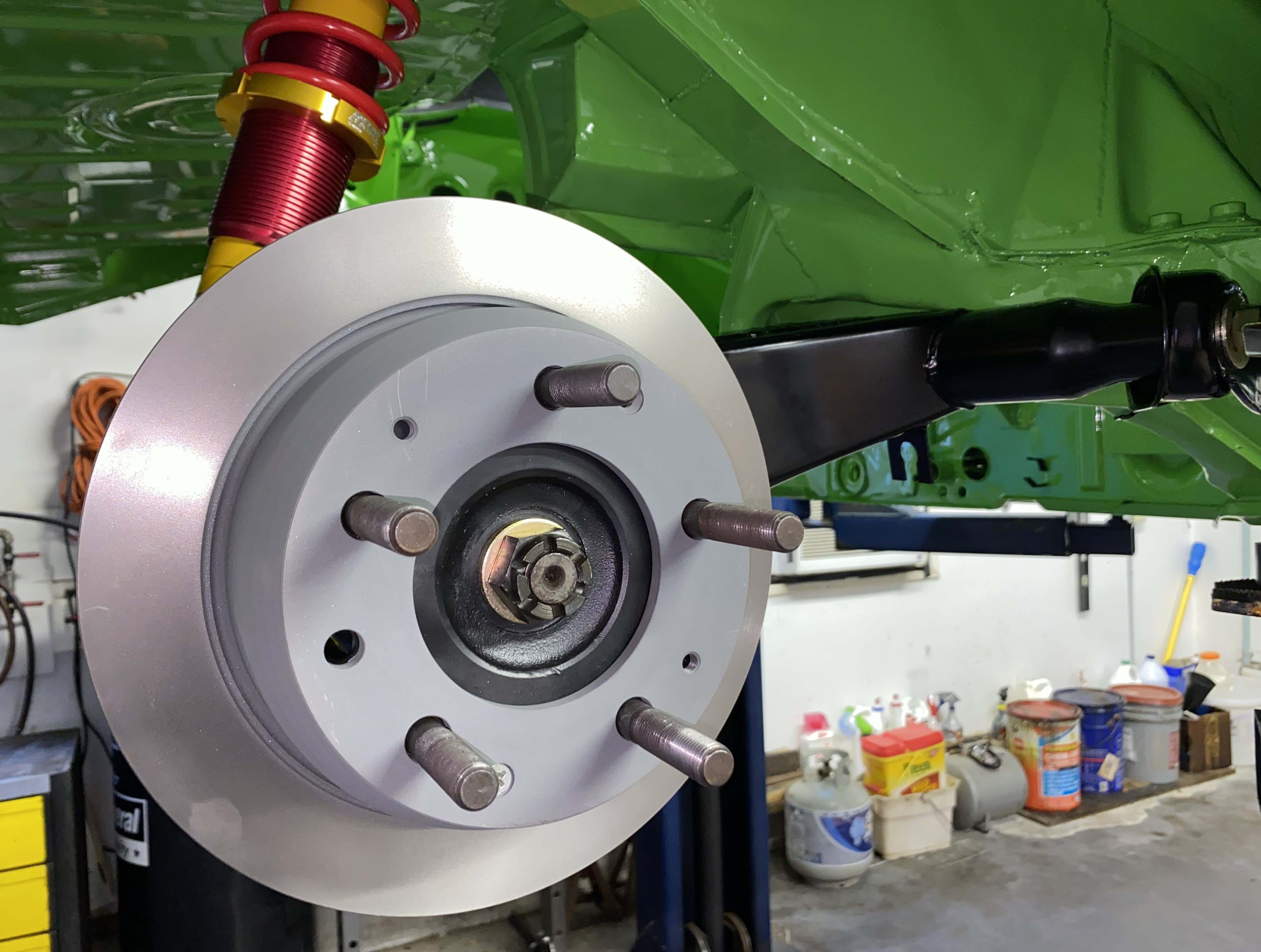

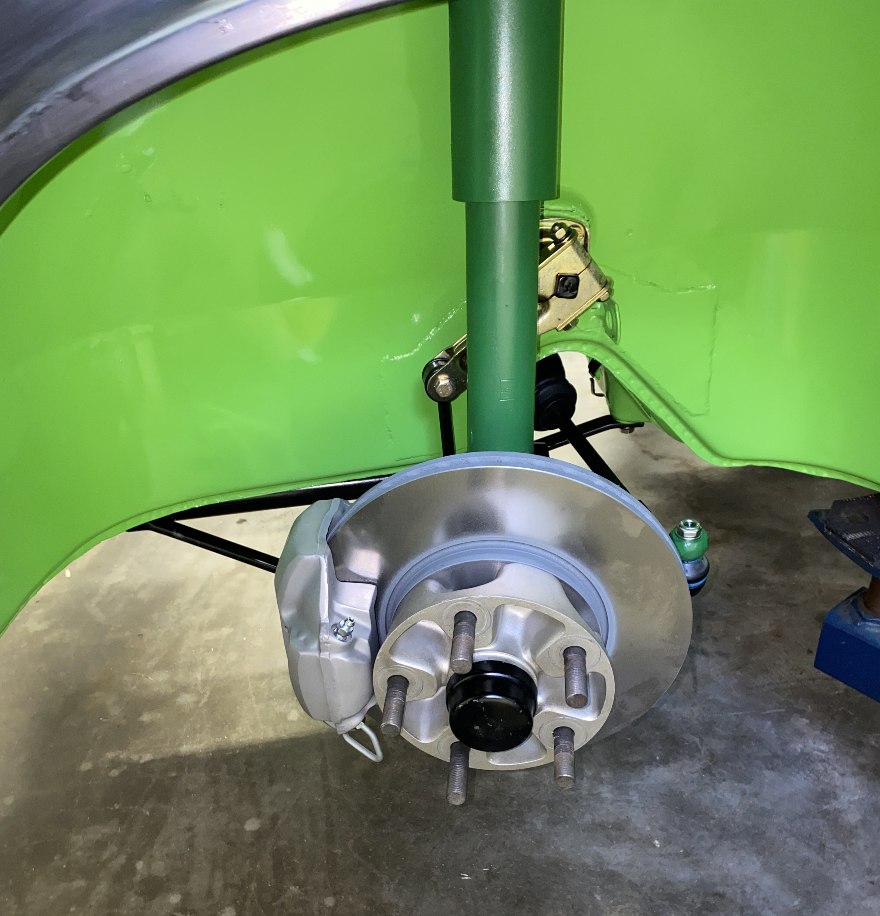

With the front suspension together and torqued to spec, I moved to the rear suspension.
Yesterday I installed the rear bearings and hubs in the trailing arms and proceeded to install the RHS arm, shock and brake rotor.
All seemed to going as planned until I tried to install the brake caliper. A significant misalignment problem.
It seems like the rotor is a good 1/2" too far outboard to align with the trailing arm tabs and the caliper. The combination of parts is:
'69-'73 911 hubs and stub axles
Early non vented 911 rotors with the diameter trimmed as recommended
Stock '73 914-4 rear calipers
I based this combination on recommendations from our members with previous experience.
http://www.914world.com/bbs2/index.php?sho...=363935&hl=
I was not expecting a problem. Any suggestions? I am stuck at this point.

Tom if I remember correctly the hat of a 911 rotor is shorter than that of a 914 or
914 6.
Also, if you intend to run dust shields the bracket has to be included.
Luke M
post Nov 9 2023, 07:42 AM
Post #259
Posts: 1,565
Joined: 8-February 05
From: WNY
Member No.: 3,574
Tom,
You'll need the 914-6 rear rotors as the 911 offset is different.
If using the 914-4 rear calipers you have to turn down the o/d of the rotor to clear the caliper. Pretty sure that's how it all works together. Maybe Eric can chime in on this to confirm.
I have a sets of 911, 914-4, 914-6 rotors around. I'd have to dig them out and see what's off with all of them.
Otherwise looks good.

Luke and Rory

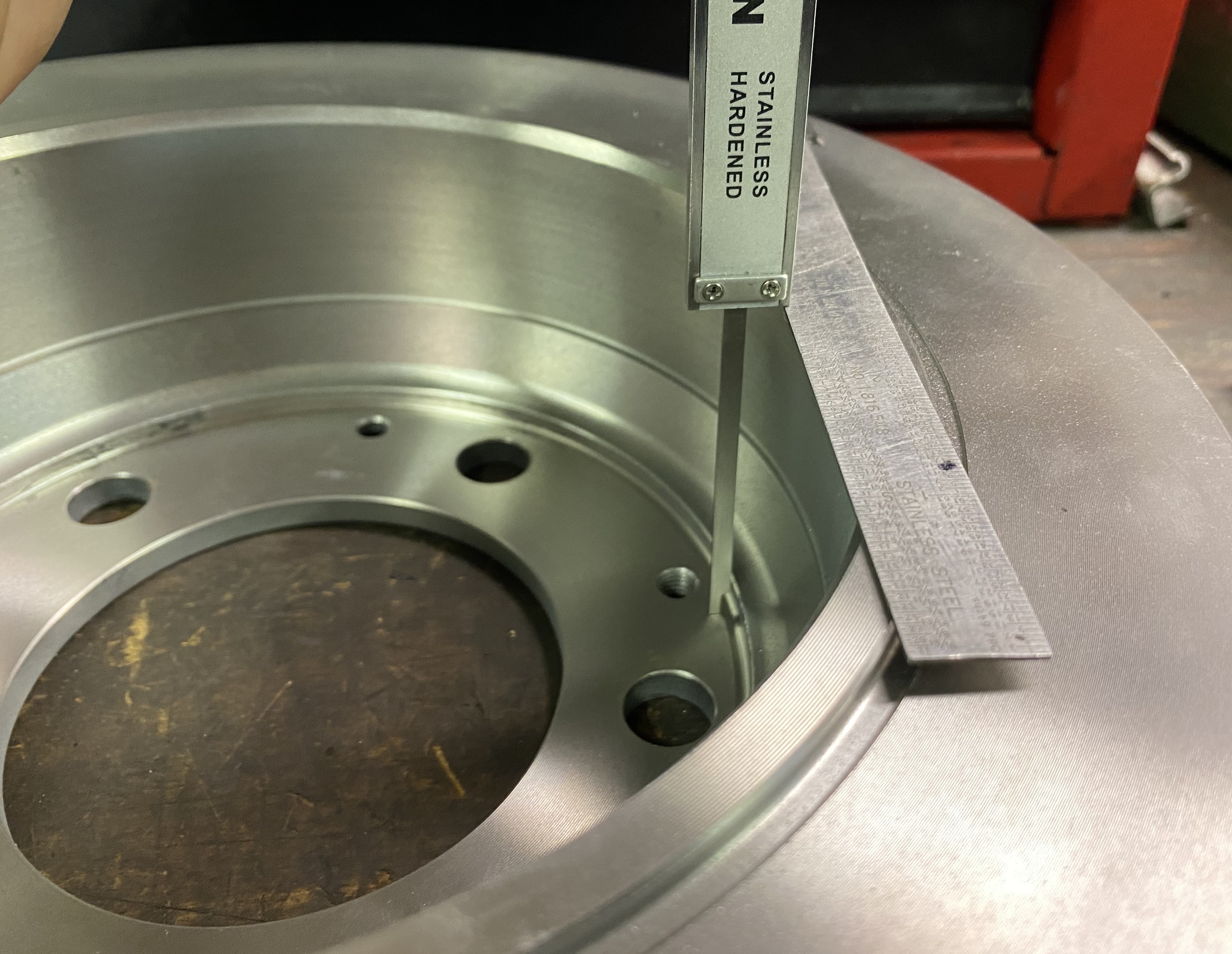

Thanks for chiming in. I was aware the solid rotors needed to be turned down 3 mm. I did that to these rotors. I did not realize that the 914-6 rotors had a different offset as compared to the 911 rotors.
The 911 solid rotors I am using have an offset distance (from the inside mount face to the inside friction surface) of around 62 mm.
Luke or Rory....If either of you could check the offset on your 914-6 rotors, that would be most helpful.
