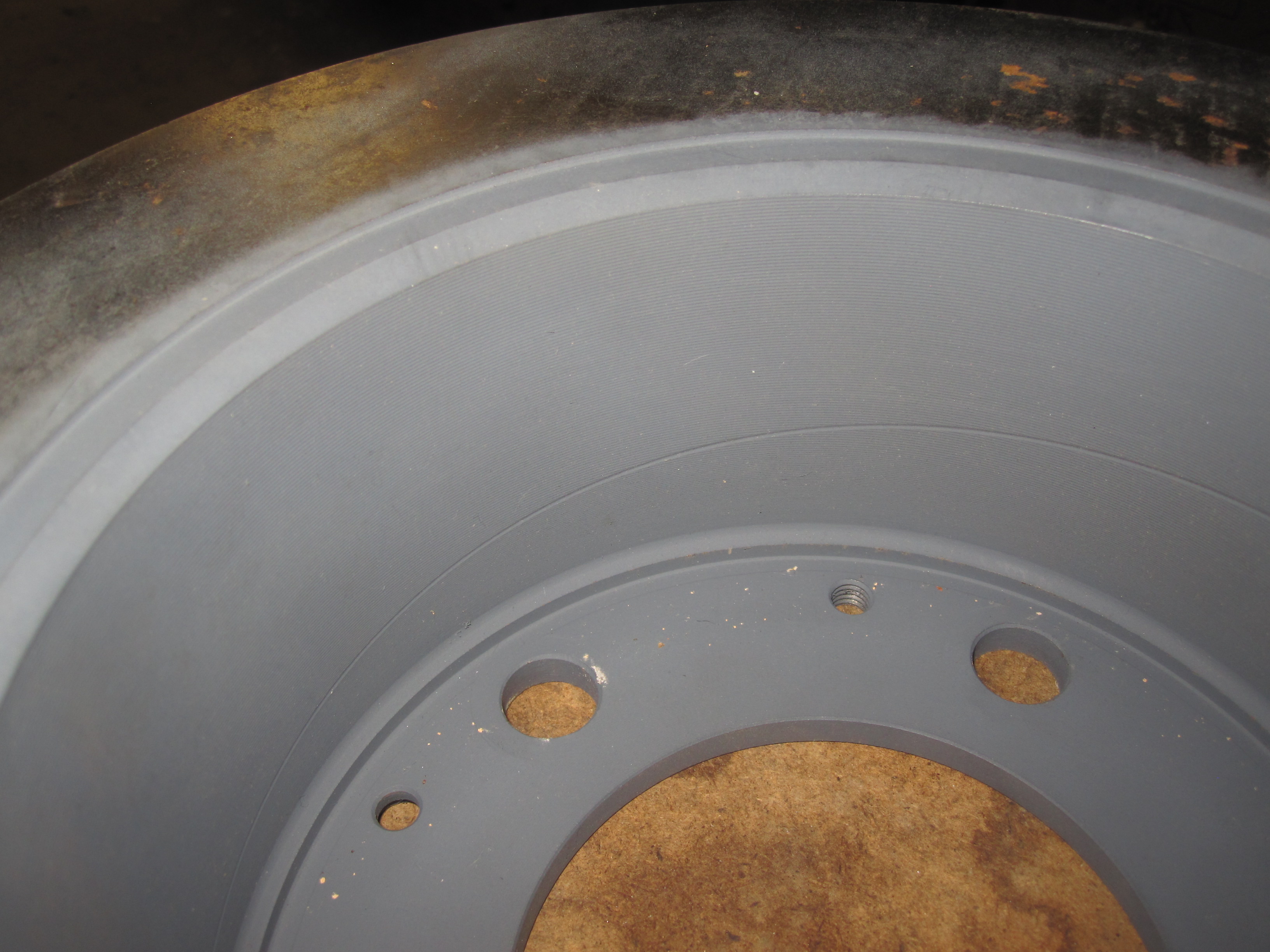

Another update...I checked the P/N on my rotors and found that I am using the SWB 911 version of the solid rotor (P/N 901-352-401-10). I was advised that the LWB version of the solid rotor (P/N 901-352-4-1-17) for the '69T and 912 would work. I am guessing that this rotor has the same offset as the 914-6 and is very different that the SWB rotors I have now. I do not have one of these in my stash to check.

QUOTE(Tom1394racing @ Nov 9 2023, 09:51 AM) *
Luke and Rory
Thanks for chiming in. I was aware the solid rotors needed to be turned down 3 mm. I did that to these rotors. I did not realize that the 914-6 rotors had a different offset as compared to the 911 rotors.
The 911 solid rotors I am using have an offset distance (from the inside mount face to the inside friction surface) of around 62 mm.
Luke or Rory....If either of you could check the offset on your 914-6 rotors, that would be most helpful.
Rory measured the offset on a 914-6 rotor. He got 73 mm which is about 11 mm deeper than the 911 SWB rotor I have. That is about the thickness of the mount flange on the trailing arm so I think my mystery is solved. I believe the 911 LWB solid rotor has the same offset and will work for me once I trim 3 mm off the OD.
My mistake...I bought the wrong rotors.

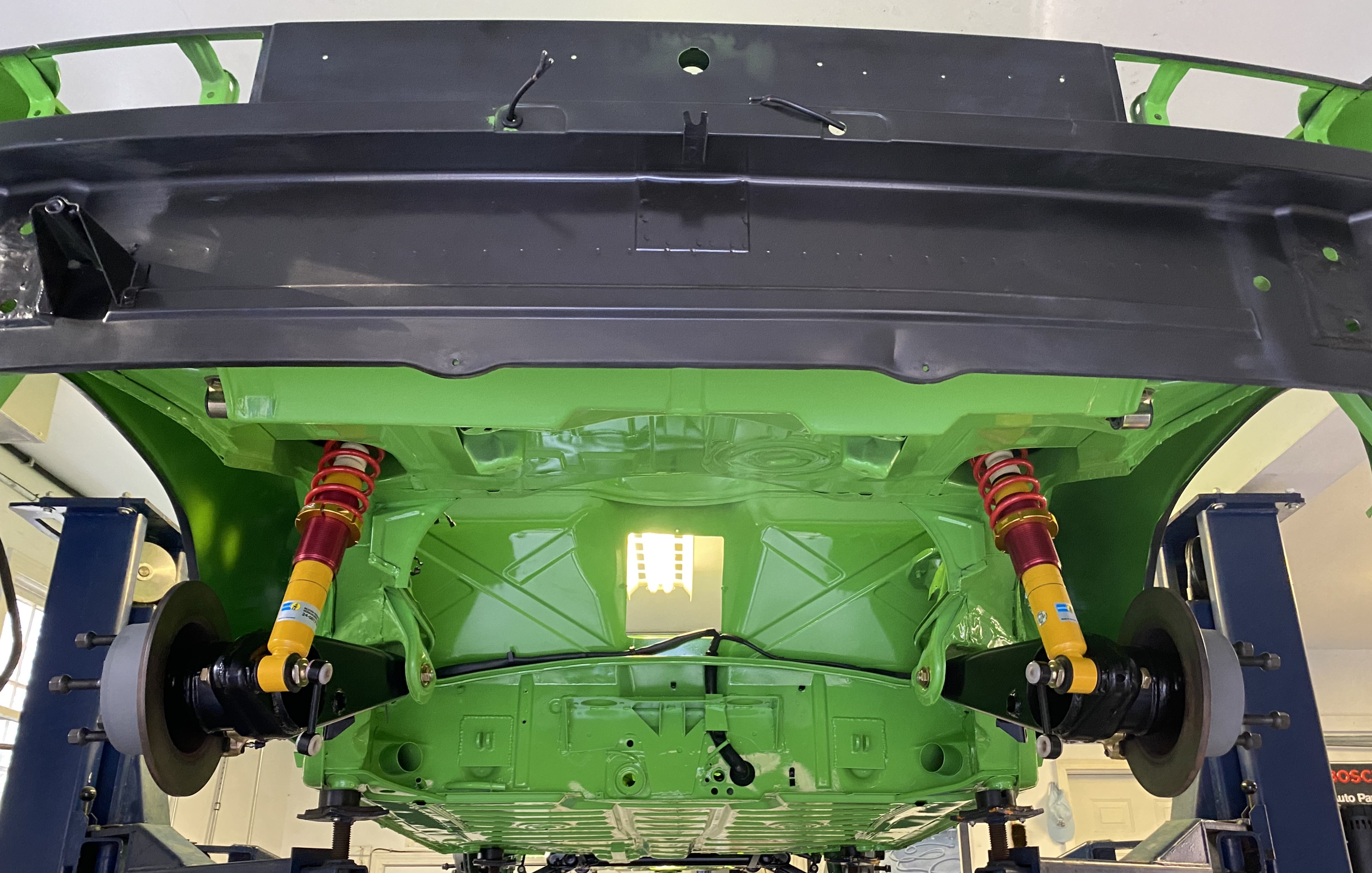

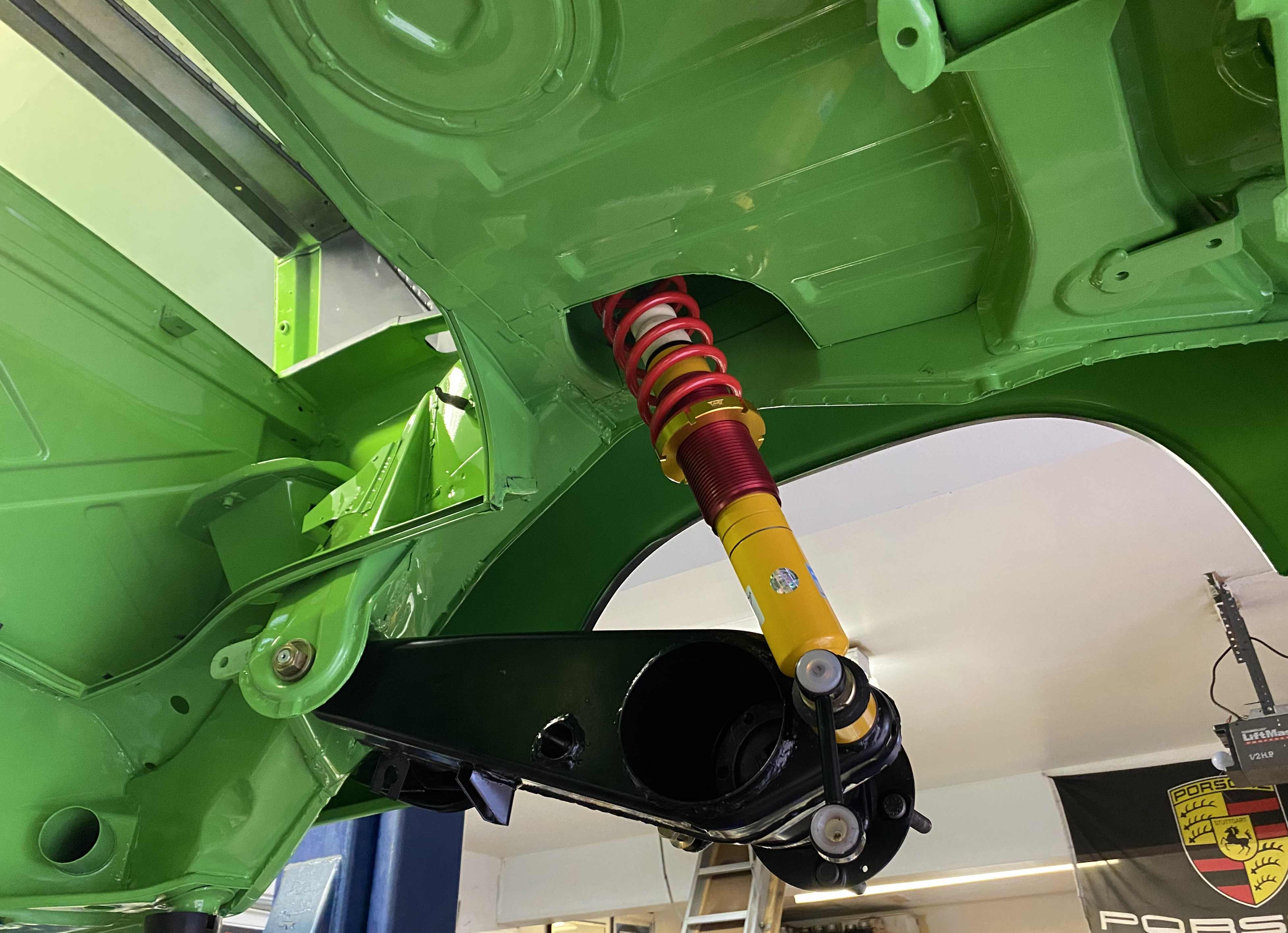

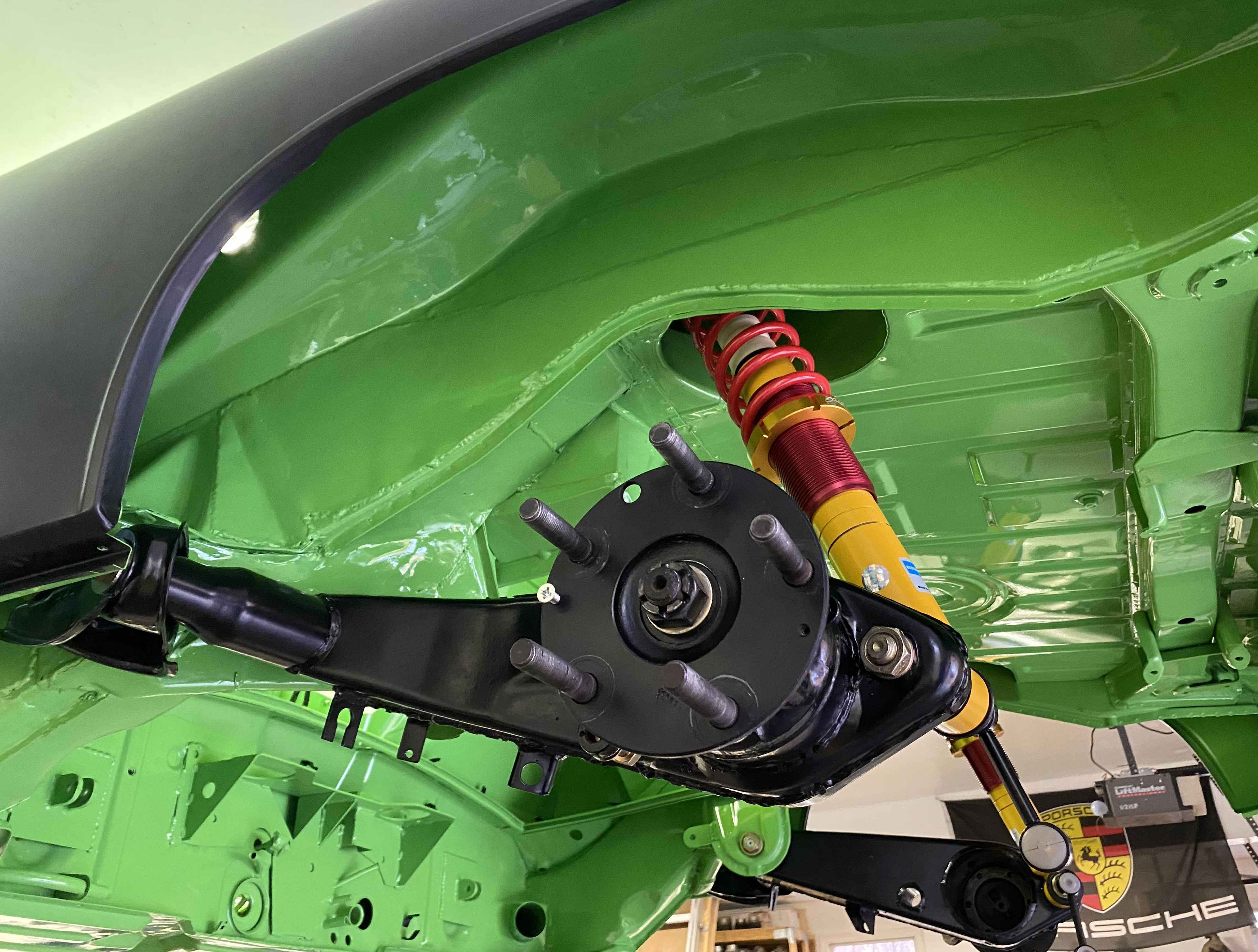

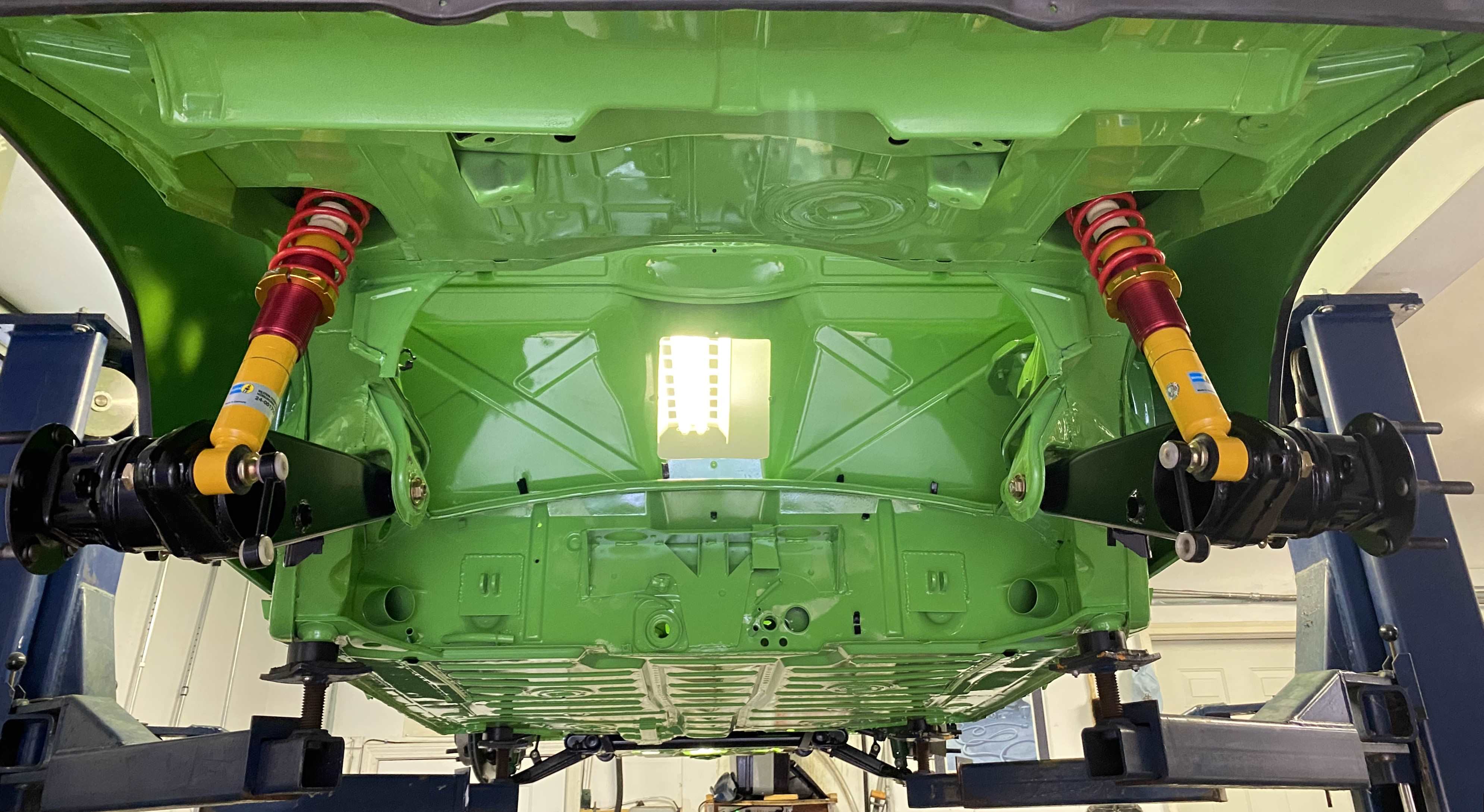

Having solved the mystery with my rear brake rotors, I went on the complete the rear suspension minus the brakes.
So now I need a pair of non-vented rear brake rotors. I think either the 914-6 rotors or the '69 911T or 912 rotors will work. I think the 911T/912 rotors will need to be reduced in OD by 3 mm. What is the difference between these and the 914-6 rotors?
Anyone have a NOS pair to sell?

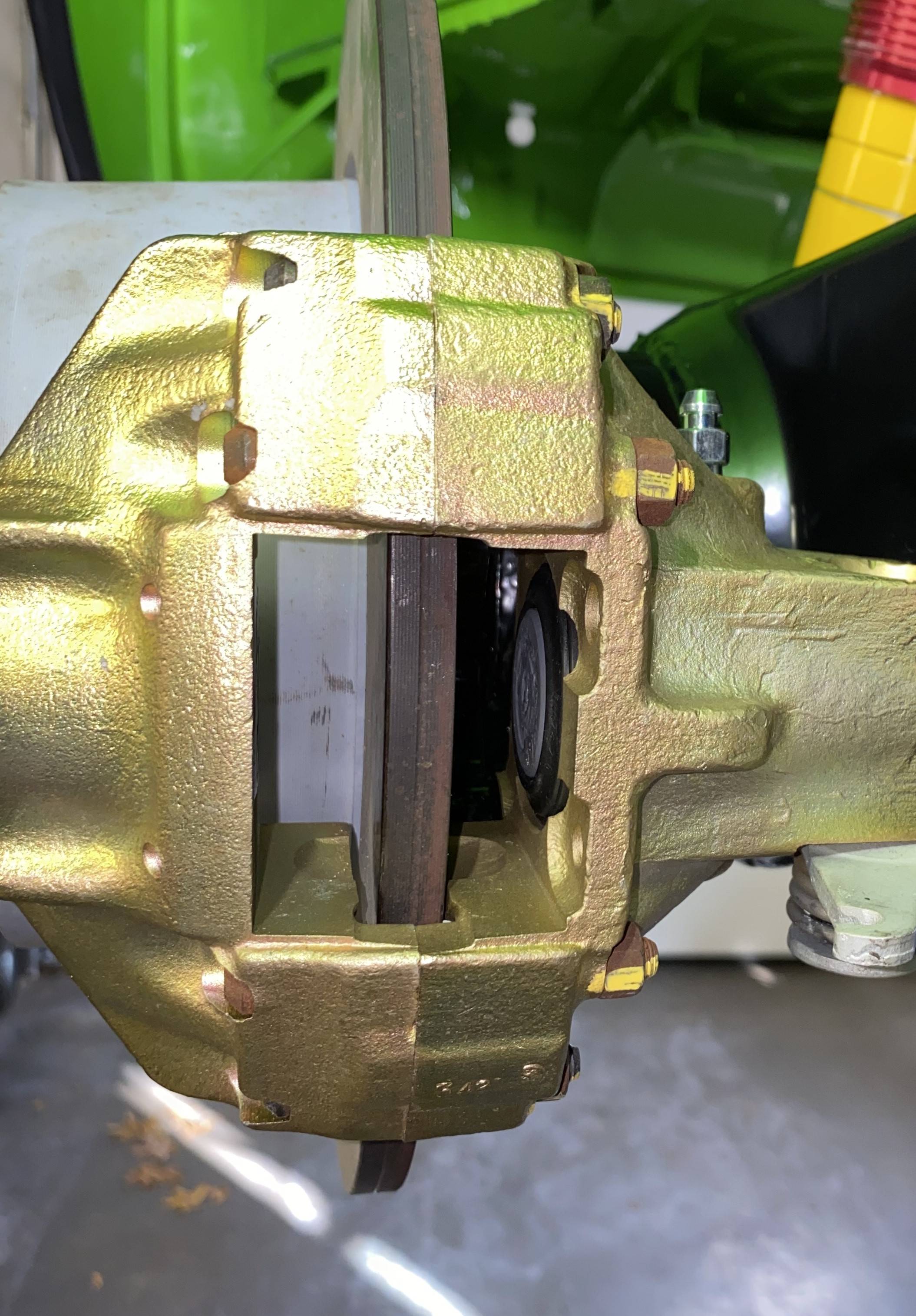

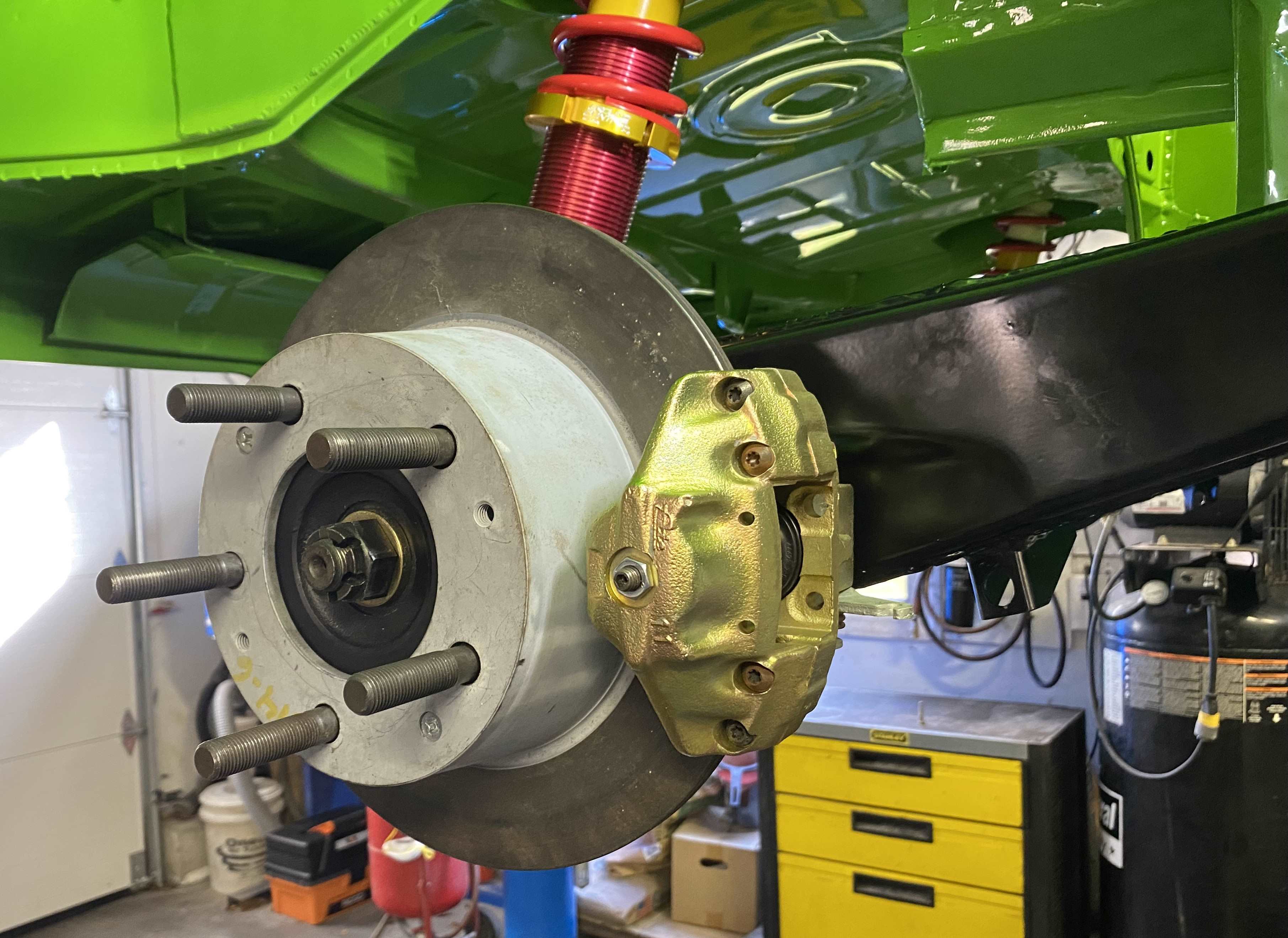

I figured out my rear brakes and got the spacing correct with thin washers instead of the dust shields. Fitted a set of SWB 911 drilled pads to the LHS but the RHS inner caliper piston needed adjustment to slip the new pad in. As luck would have it, no inner adjuster gear in the caliper. PMB did the brakes. Called them, no explanation why, but they are sending me near gears.

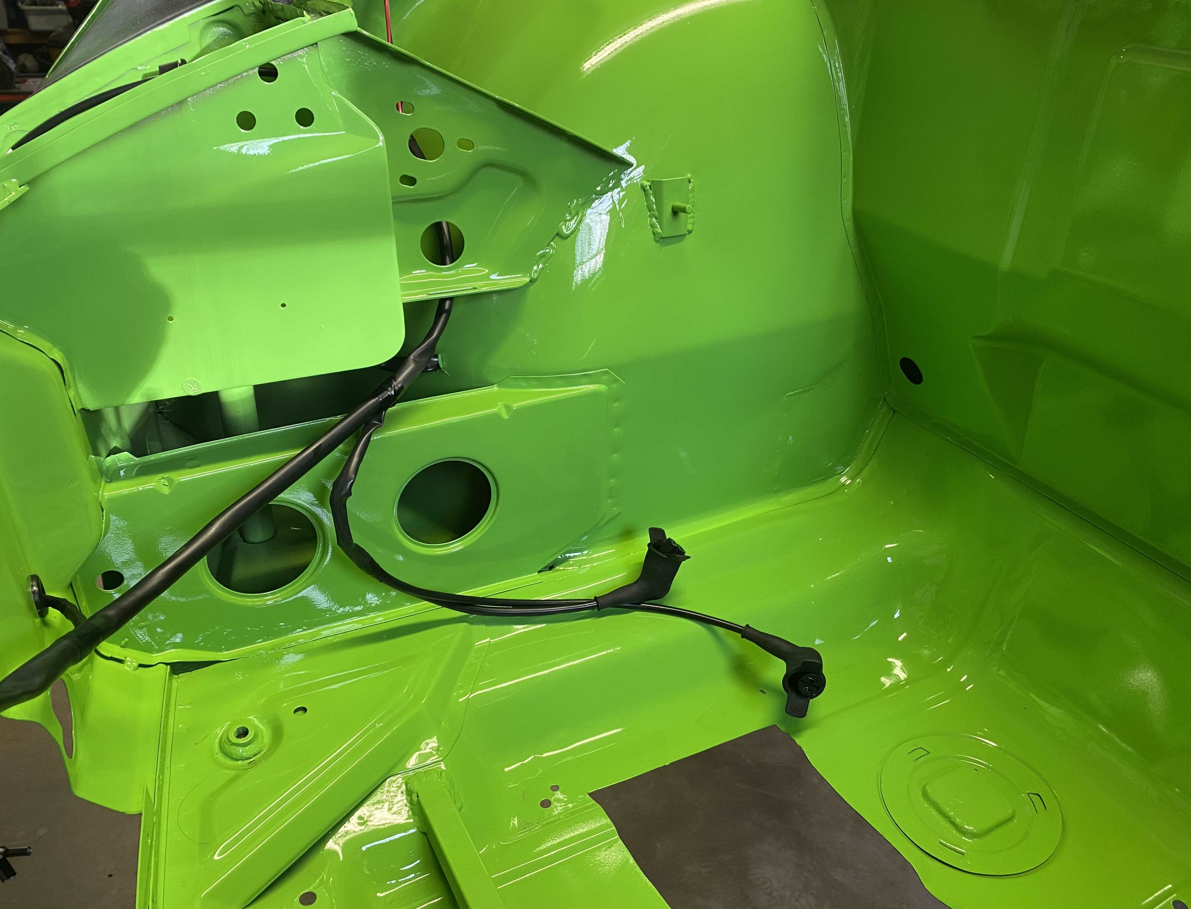

Member No.: 8,039

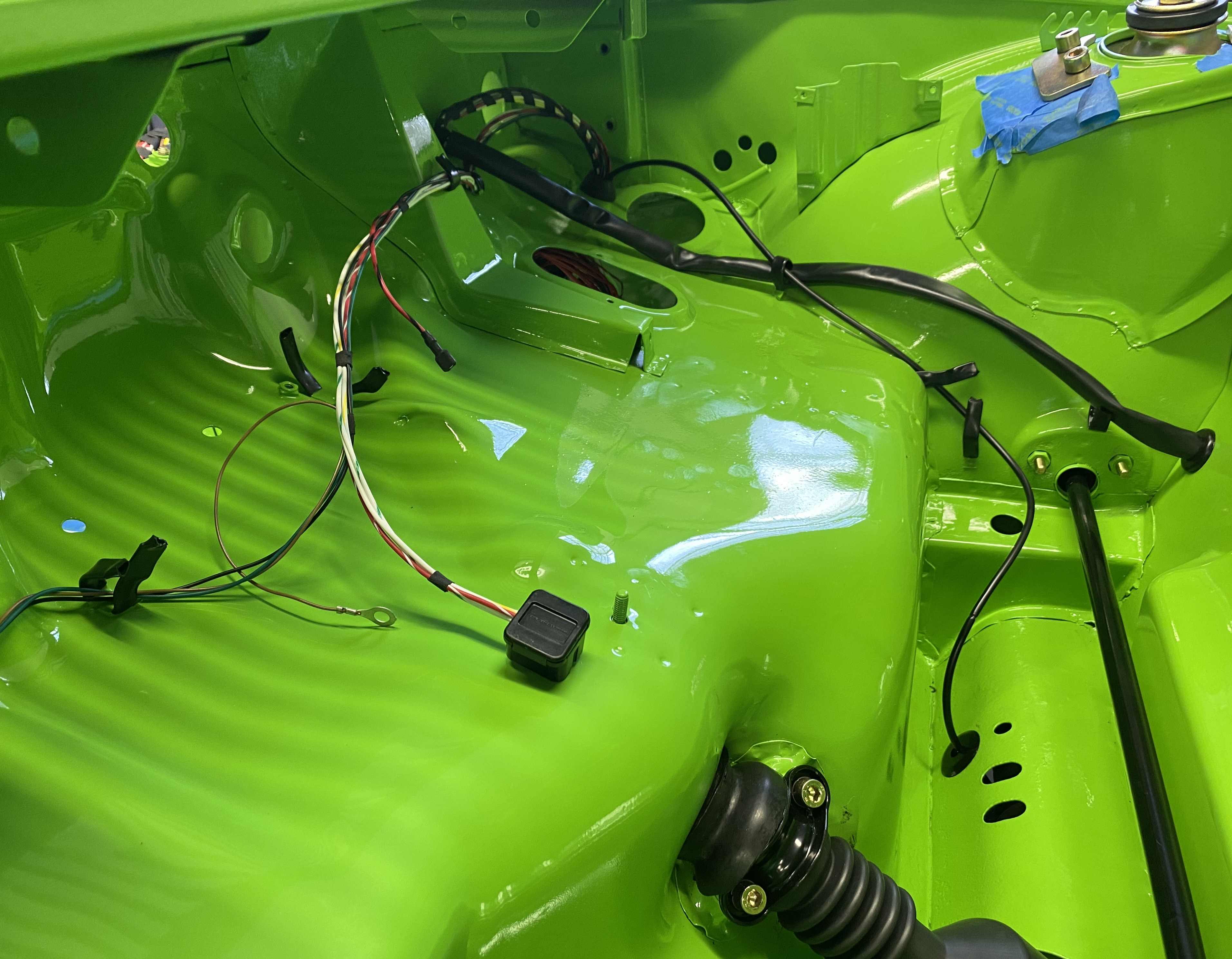

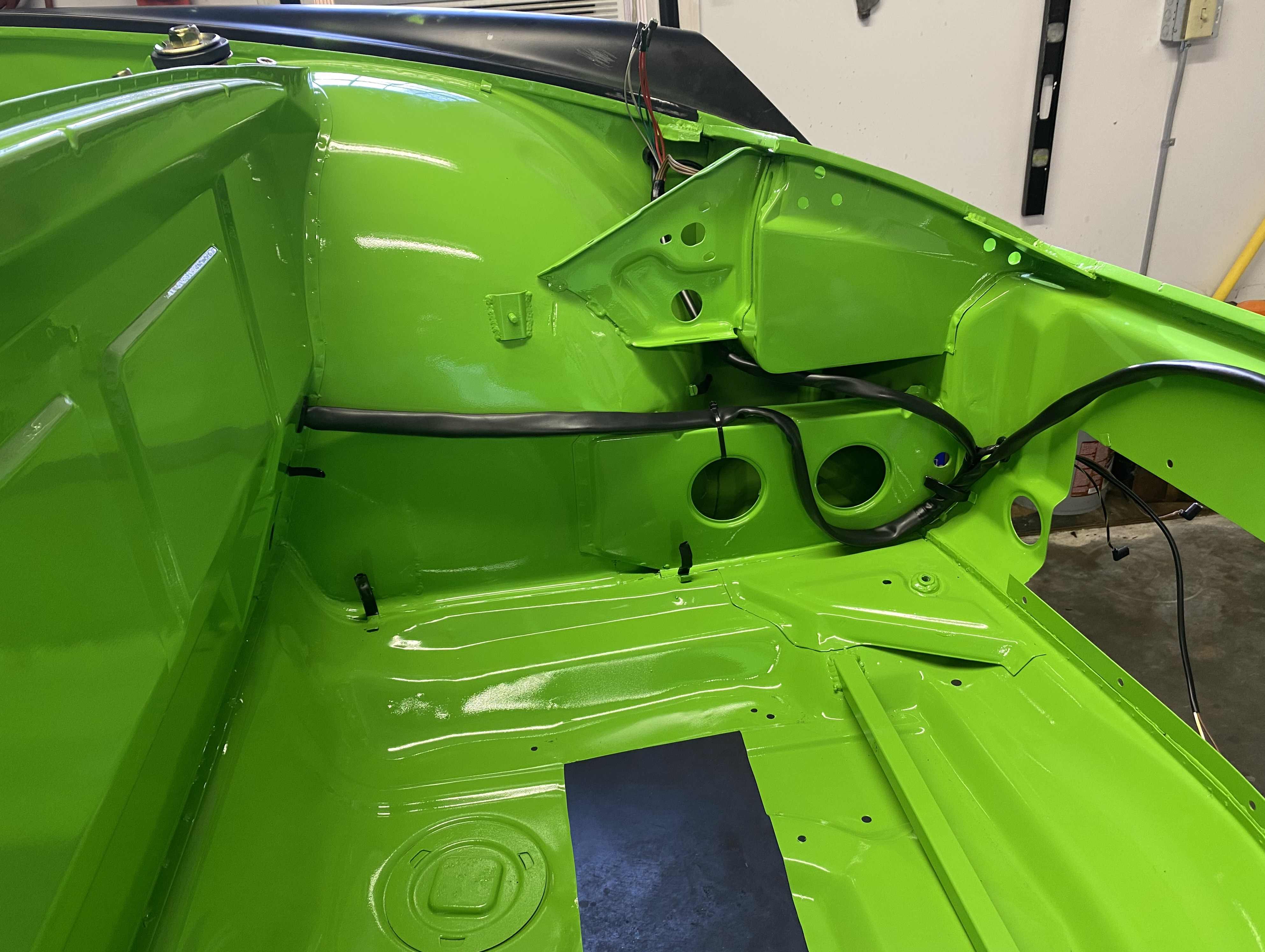

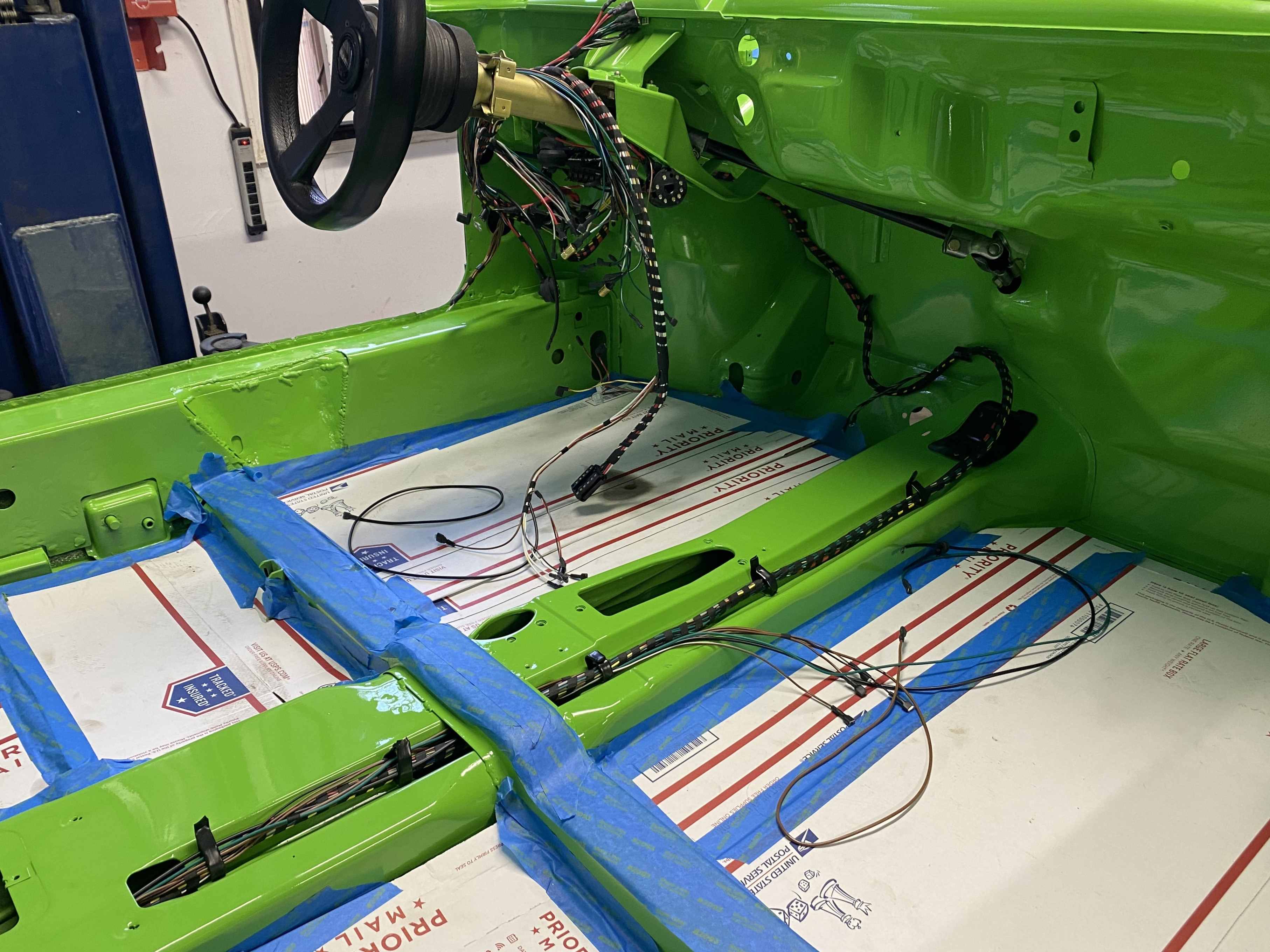

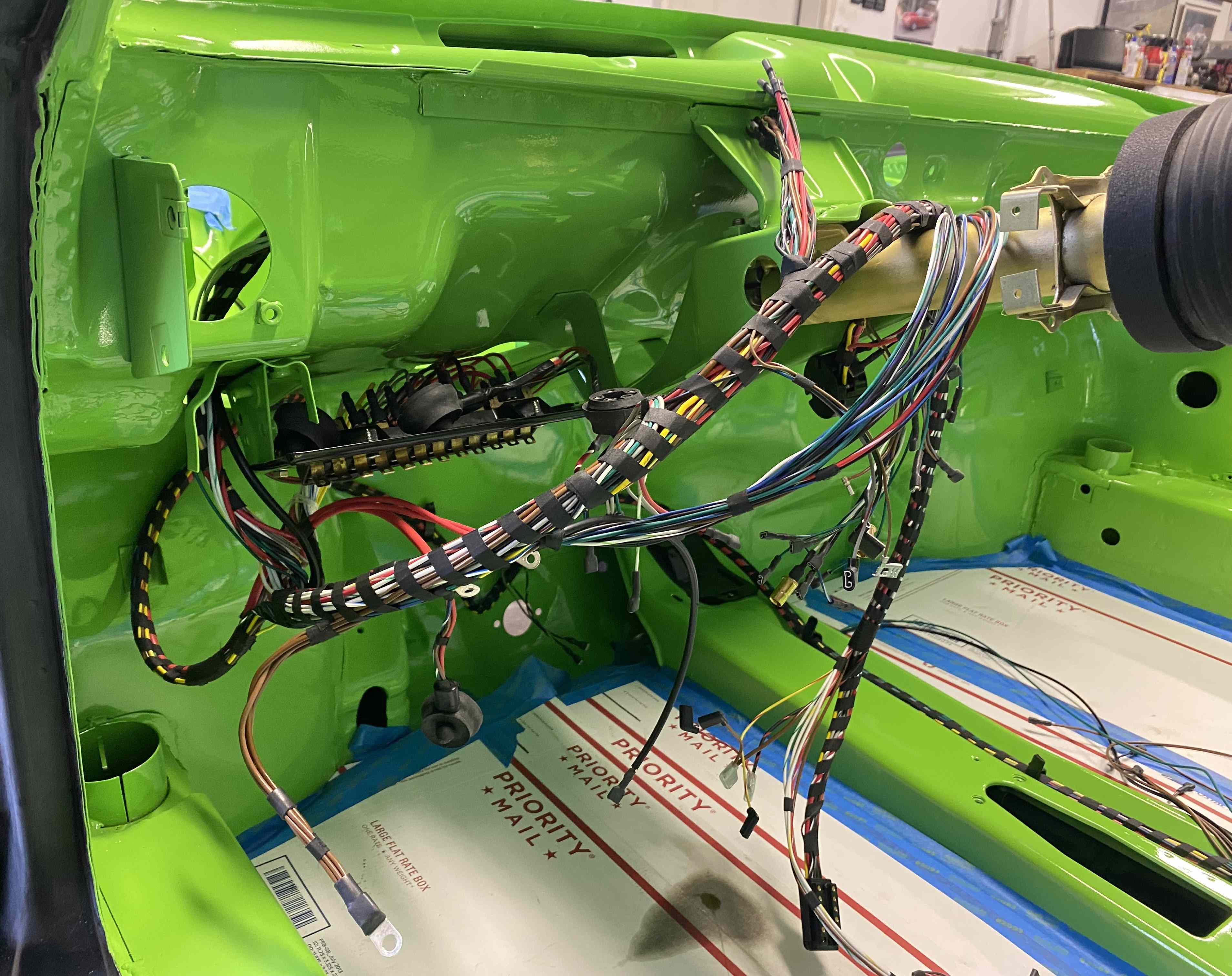

In the meantime, my corrected, new 914-6 wiring harness came back from Restoration Design. Thanks to Peter who corrected it for the front dual fuel pumps and had it back to me in less than 2 weeks. I am very happy with the quality and workmanship on this harness. The installation YouTube video made it a breeze. I am in the process of finalizing the exact placement especially in the front trunk where the original wire routing will clash with the oil cooling system.

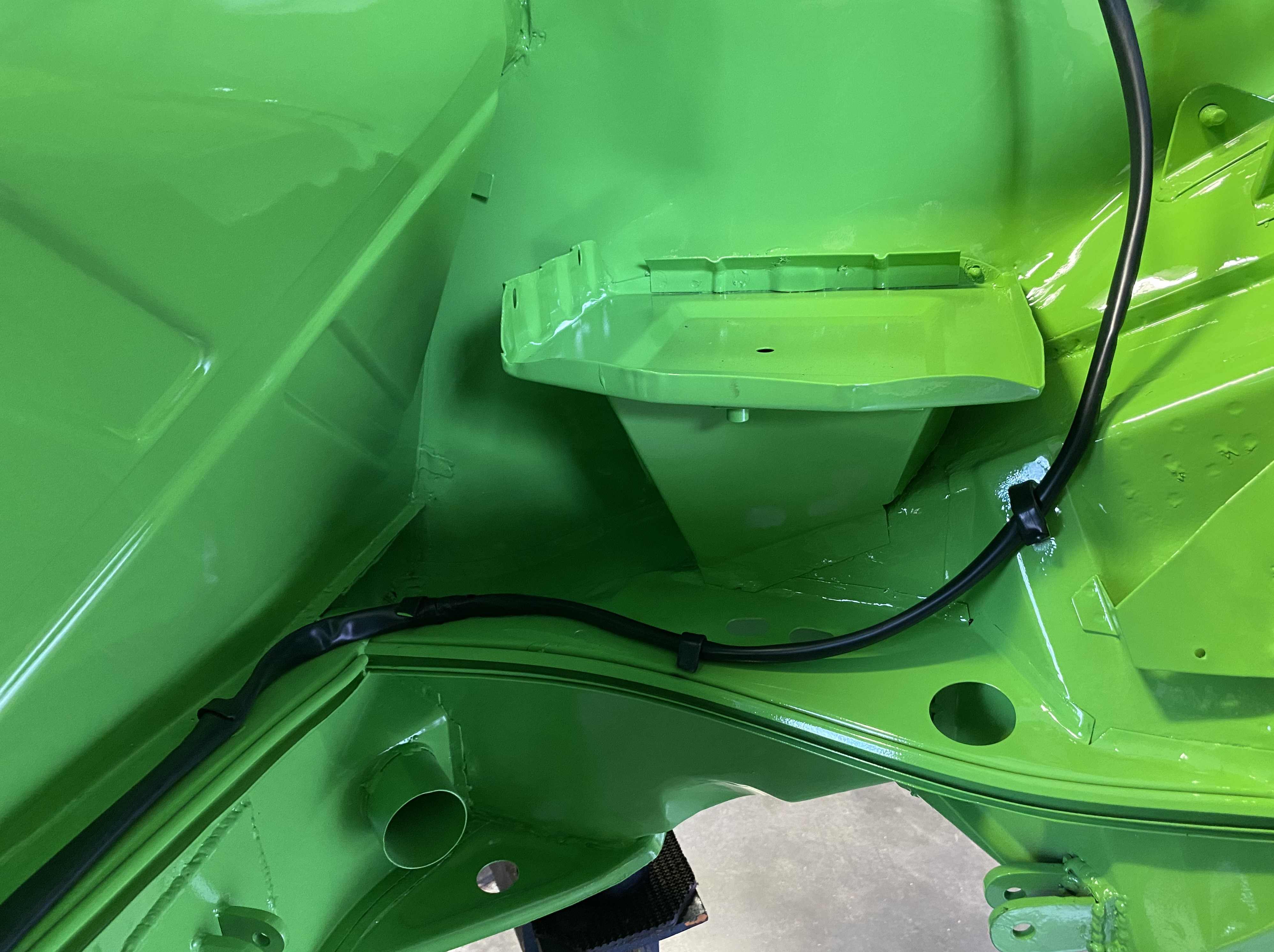

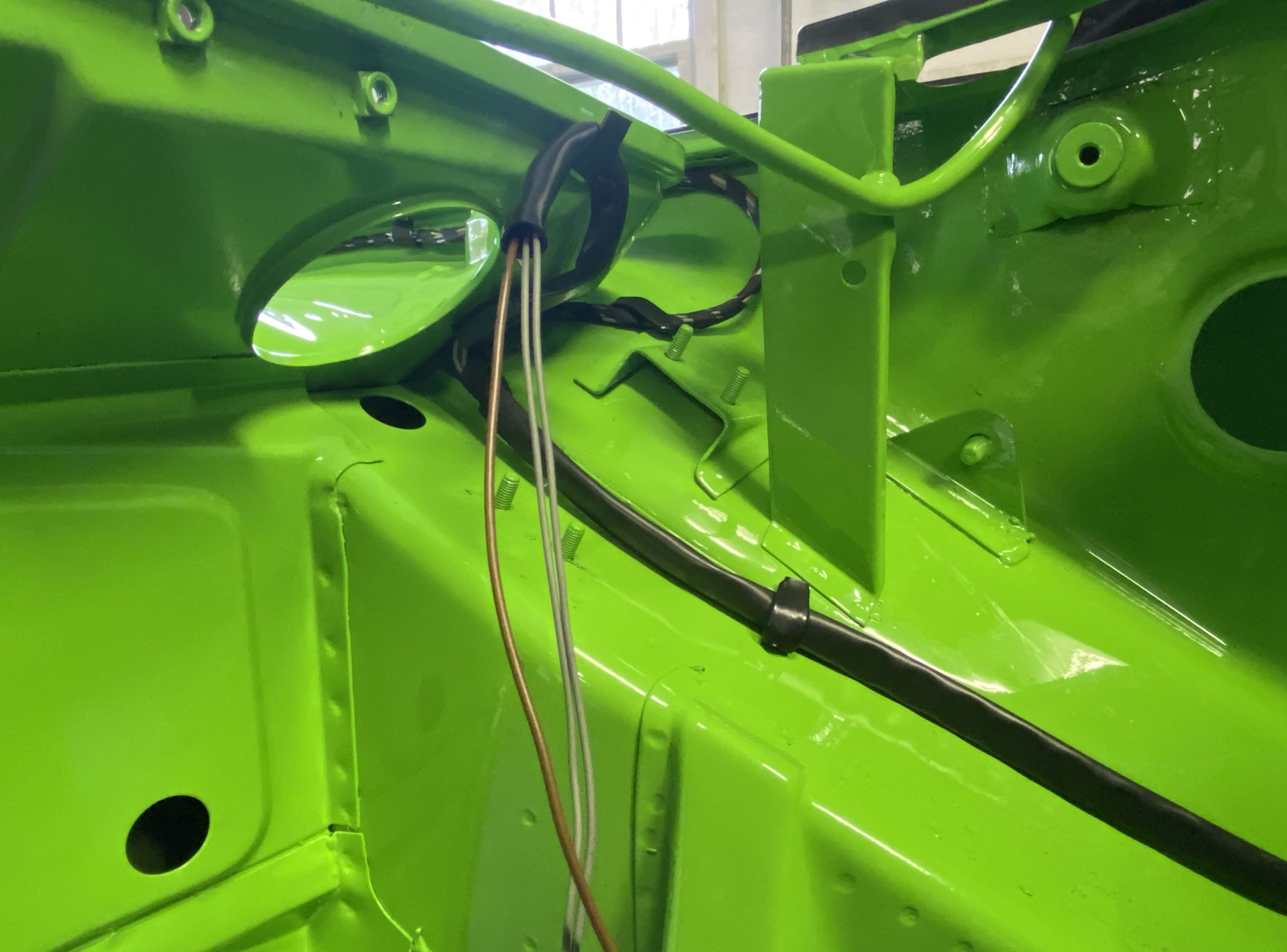

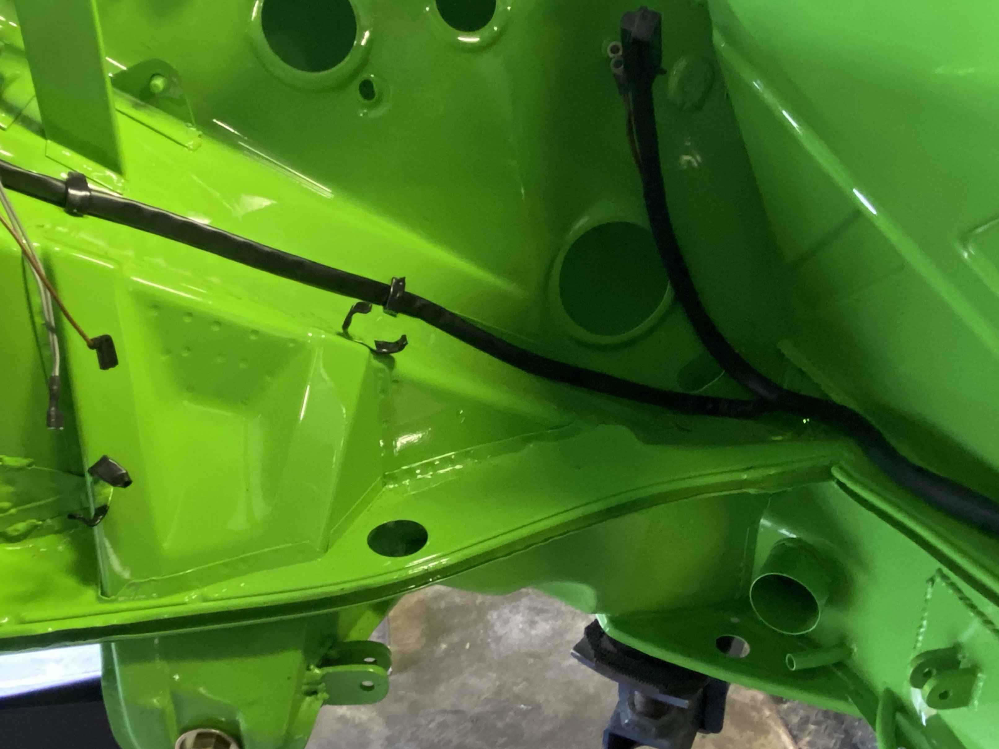

More wiring pics. It seems like every factory GT did things a little differently with regards to the front trunk wiring.

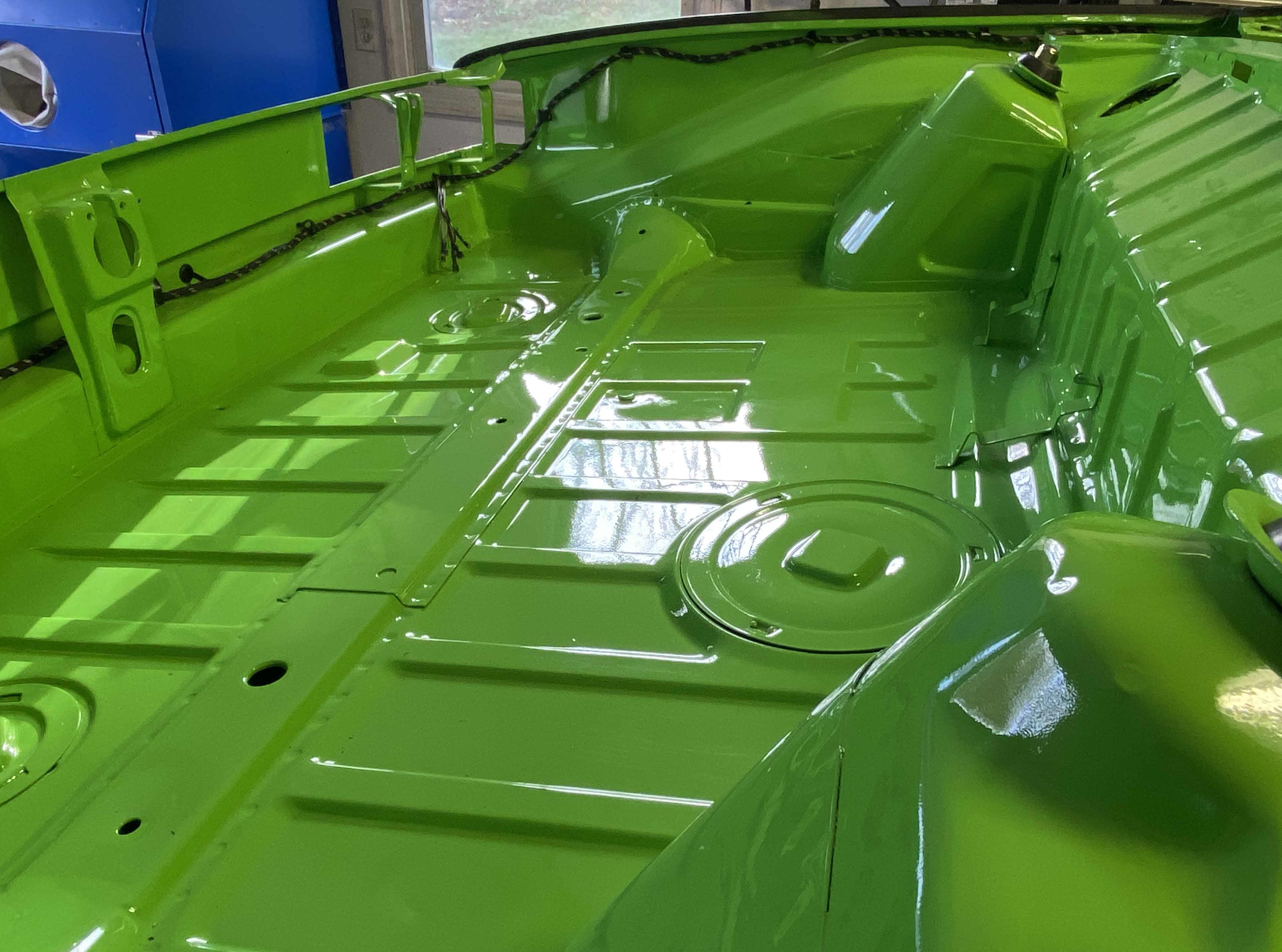

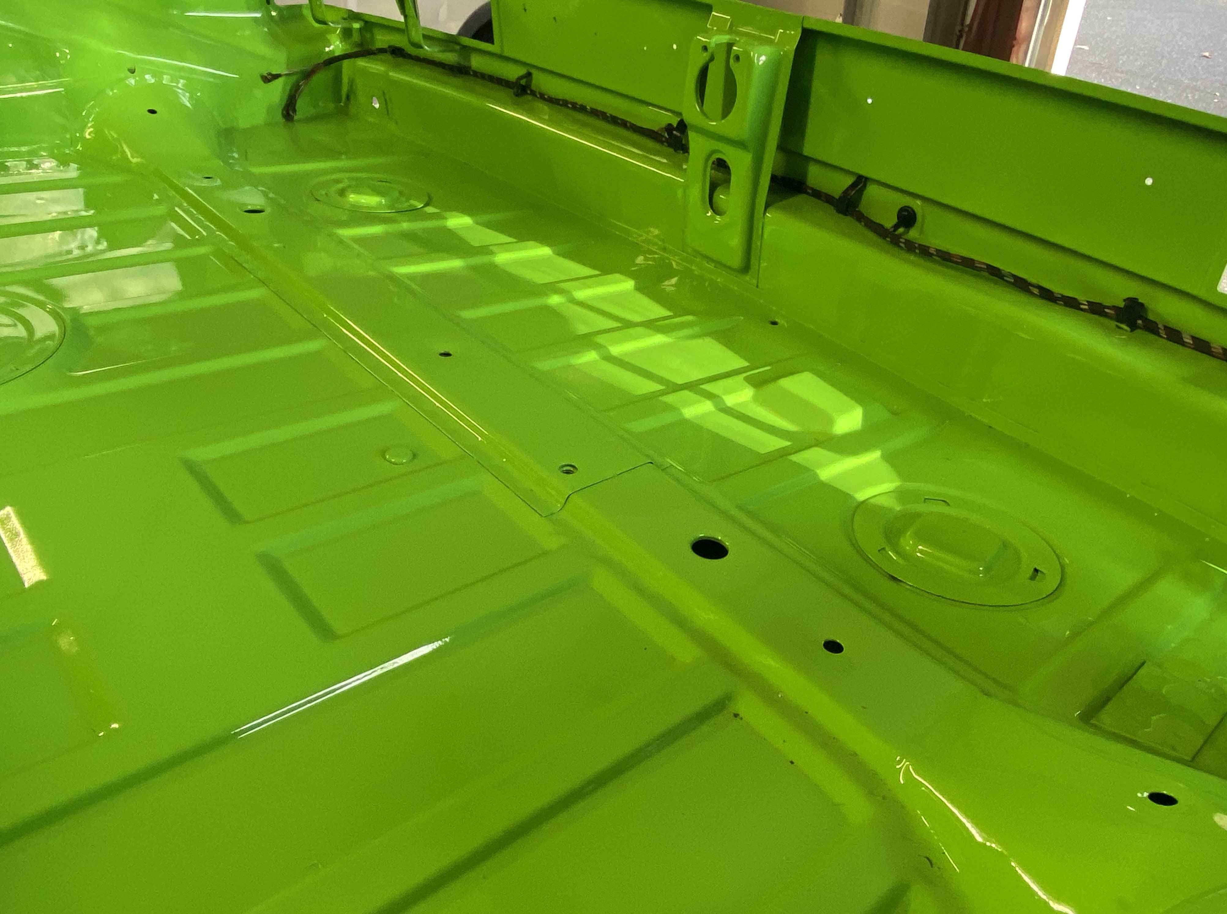

Tom - did you use seam sealer on the car or are you leaving it bare?
Tom1394racing
post Dec 5 2023, 07:20 AM
Post #279
Posts: 523
Joined: 25-August 07
From: CT
Member No.: 8,039
QUOTE(mepstein @ Dec 3 2023, 09:40 AM) *
That is a good question...I don't believe that Auto Associates used any seam sealer. I will confirm that with them. There is a very light undercoating on the bottom and in the rear of the wheel wells.
post Dec 5 2023, 07:51 AM
Post #280
914-6 GT in waiting
Posts: 20,857
Joined: 19-September 09
Member No.: 10,825
QUOTE(Tom1394racing @ Dec 5 2023, 08:20 AM) *
I was wondering the need for it on an e-coated car. I haven’t decided yet.
