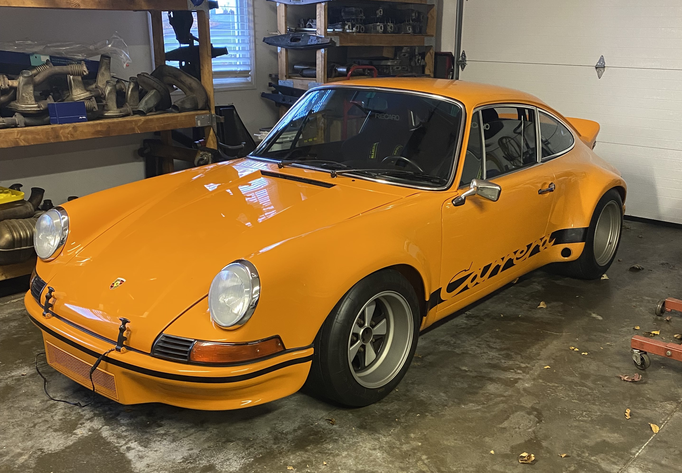

Yes. This is my 3rd project with Auto Associates. My '73 RSR tribute car still looks and runs great after 23 years.
They also worked with me on the concourse restoration of this 1970 911E.
Their work is top notch and reliable. With their help, I hope to have the 914 on the road next spring/summer.

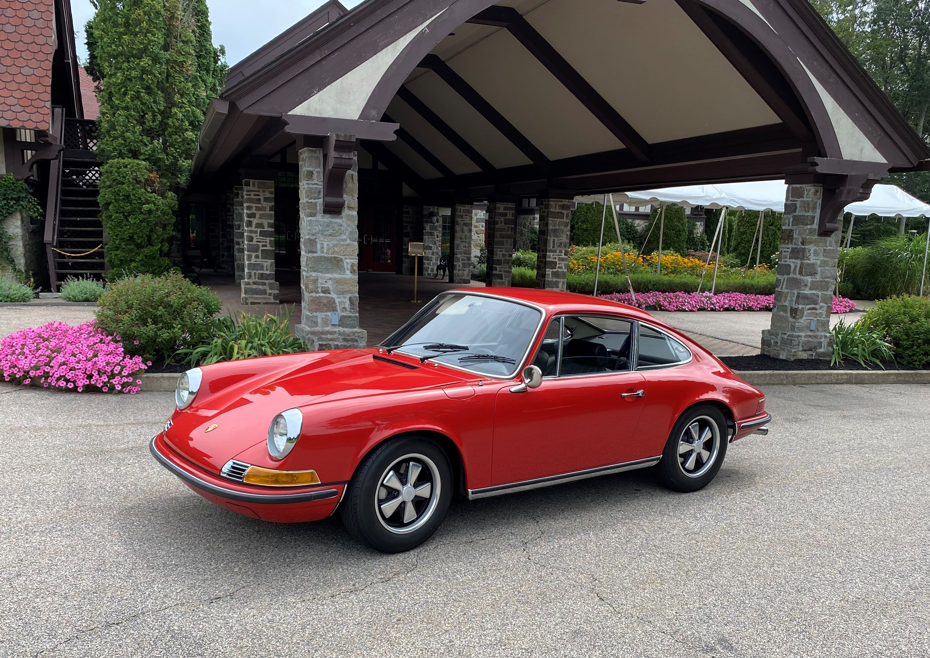

If I may ask. what color red is your 911E?
Love the RSR Tribute. Hope my IROC Project comes out that sweet!

The '70E was restored to it's original Bahia Red. It was sold 2 years ago on BAT
https://bringatrailer.com/listing/1970-porsche-911e-31/

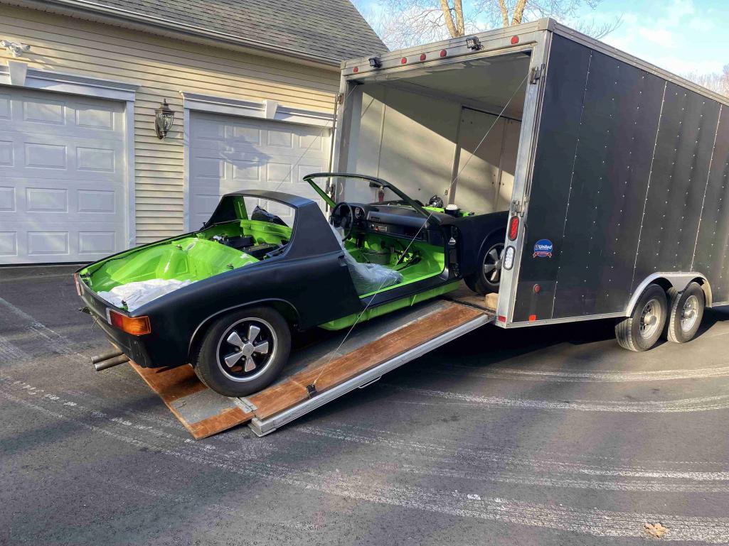

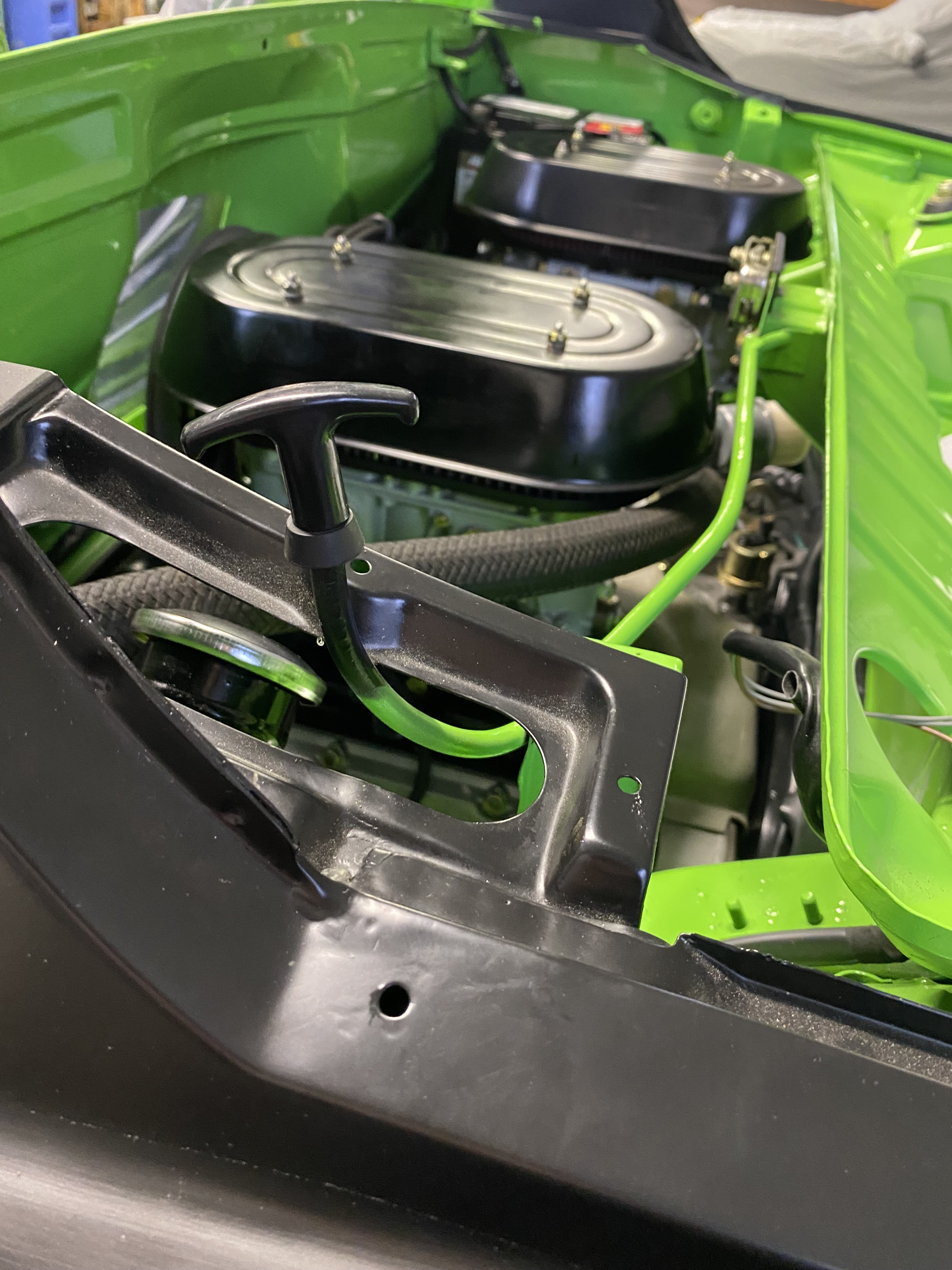

Not a lot of progress over the Holidays. I re-did the GT head light cables with bicycle derailer cables. Much smoother operation as compared to the hood release wires I had initially installed. Thanks to Mark Epstein for the tip.
I also installed the GT engine release cable and handle.
The car is now off to Auto Associates for the finishing work and completion.
