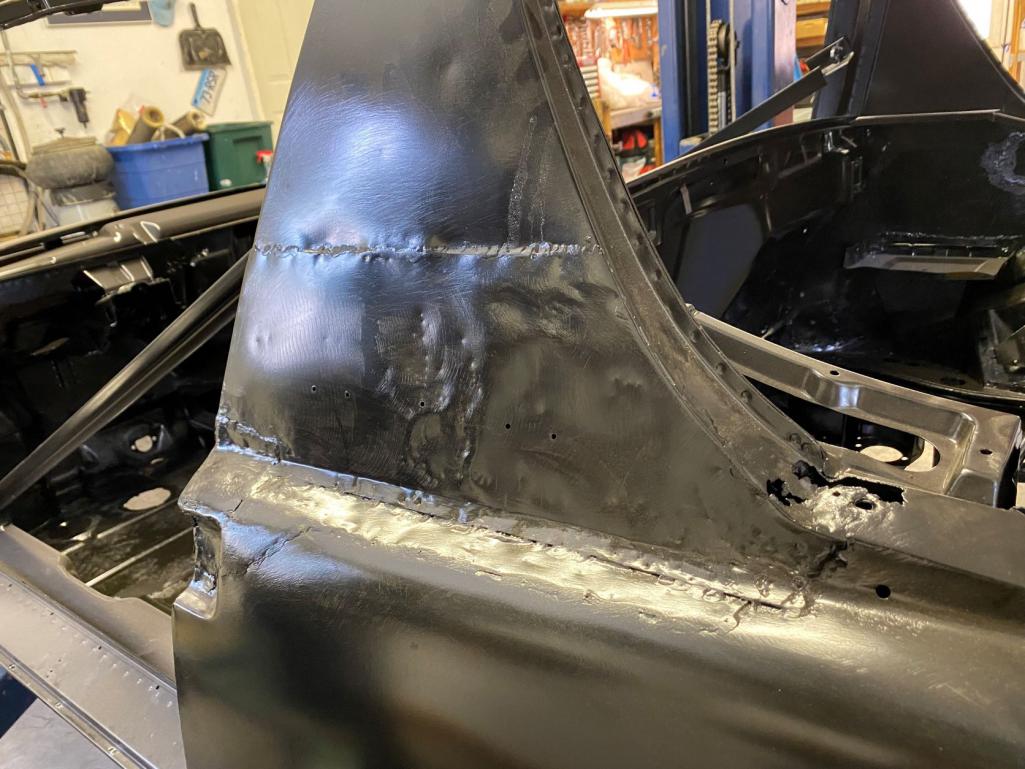

Mine is back home as well. I am pretty happy with the overall process. Car looks really clean but now all the nasty sins have been exposed.Attached Image Attached Image Attached Image Attached Image

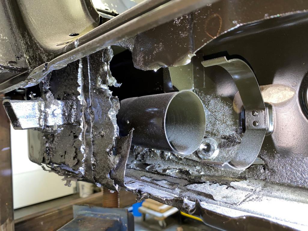

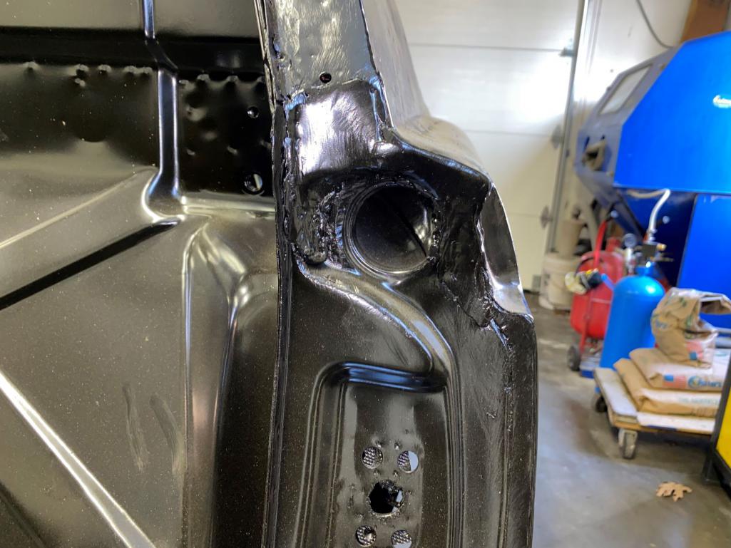

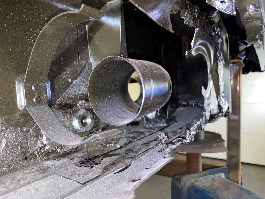

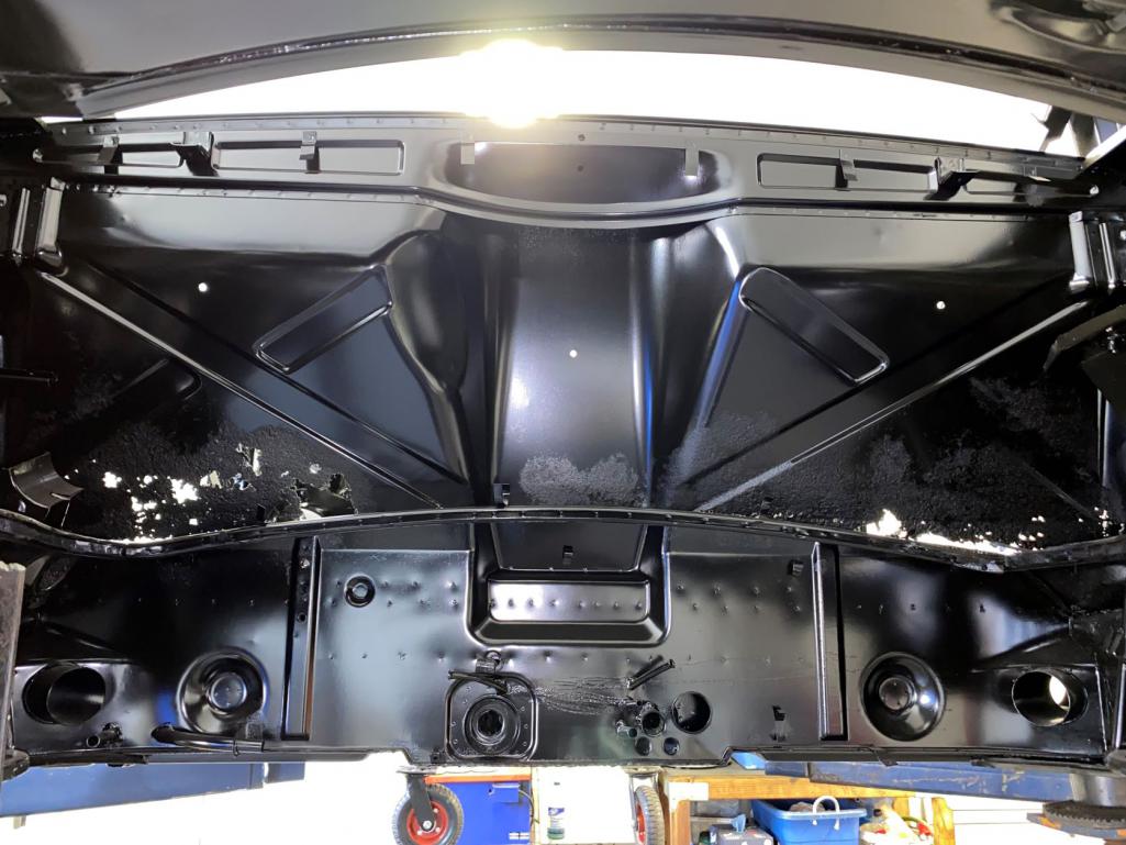

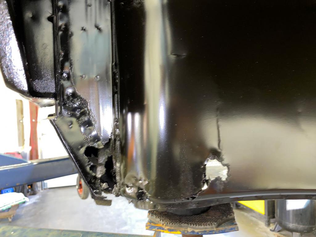

Here are some examples of the nasty hidden sins that will be corrected by Auto Associates
Attached Image Attached Image Attached Image Attached Image Attached Image Attached Image

The dip and e-coat make the good metal look really clean and the bad metal look terrible. I’m sure it will all look great when you are done. At least you didn’t not have to worry about flash rust while waiting on paint.
We replaced a lot of body panels on my car but there are still some touch ups before paint.

Update - The car was delivered to Auto Associates last week along with the chassis stiffening kits and bulkhead motor mount from Mad Dog. First up will be rust repair. This will be followed the GT chassis stiffening and GT mods with the exception of body panels and flares. The plan is for the car to come back to me for mechanical and electrical reassembly before installation of the doors and flares and final paint. Ken (co-owner and Body Shop Manager) would prefer to have wheels and tires mounted to properly install the flares. He also prefers to have the chassis weighted with gearbox and engine to set the door gaps.

The rust repair has started with removal of the rusted firewall, 4 cyl engine mounts and the improper repairs to the hell hole area. Luckily, Ken was able to source a NOS replacement firewall panel.
