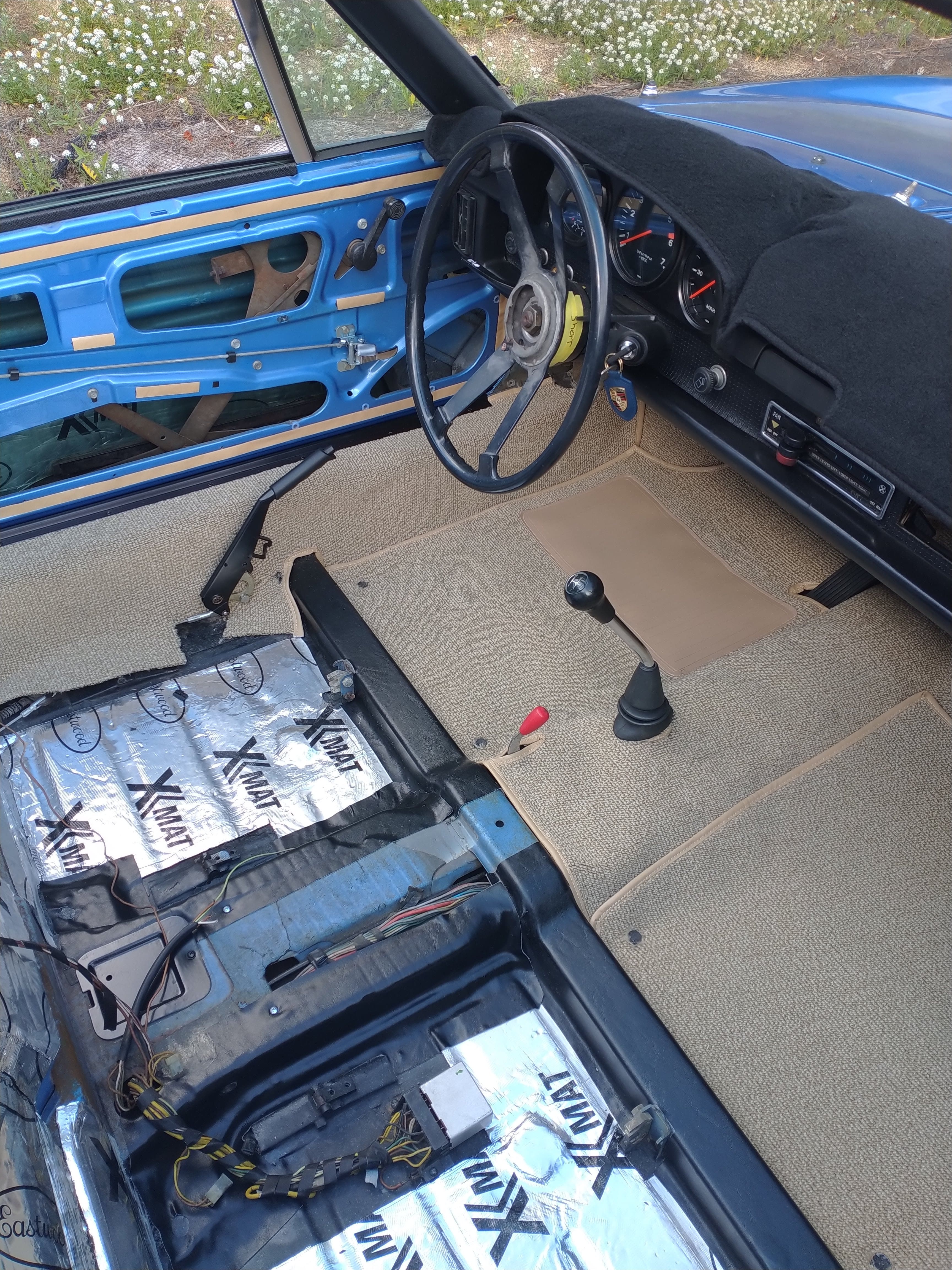

Got the carpet kit installed today. It came out pretty nice. The carpet needs to relax a bit in certain areas.
I glued the longs, the left foot rest, the piece above the foot board and the top three inches of the passenger side foot rest area.
I think it came out looking pretty nice. Just have to get the door cards, seats and the backpad in and interior will be all set. We're going to do the door cards next weekend, we have to make sure the glass is adjusted properly up and down and side to side. Always a PIA working with the doors because there's so many adjustments.
Here's the pics I promised.

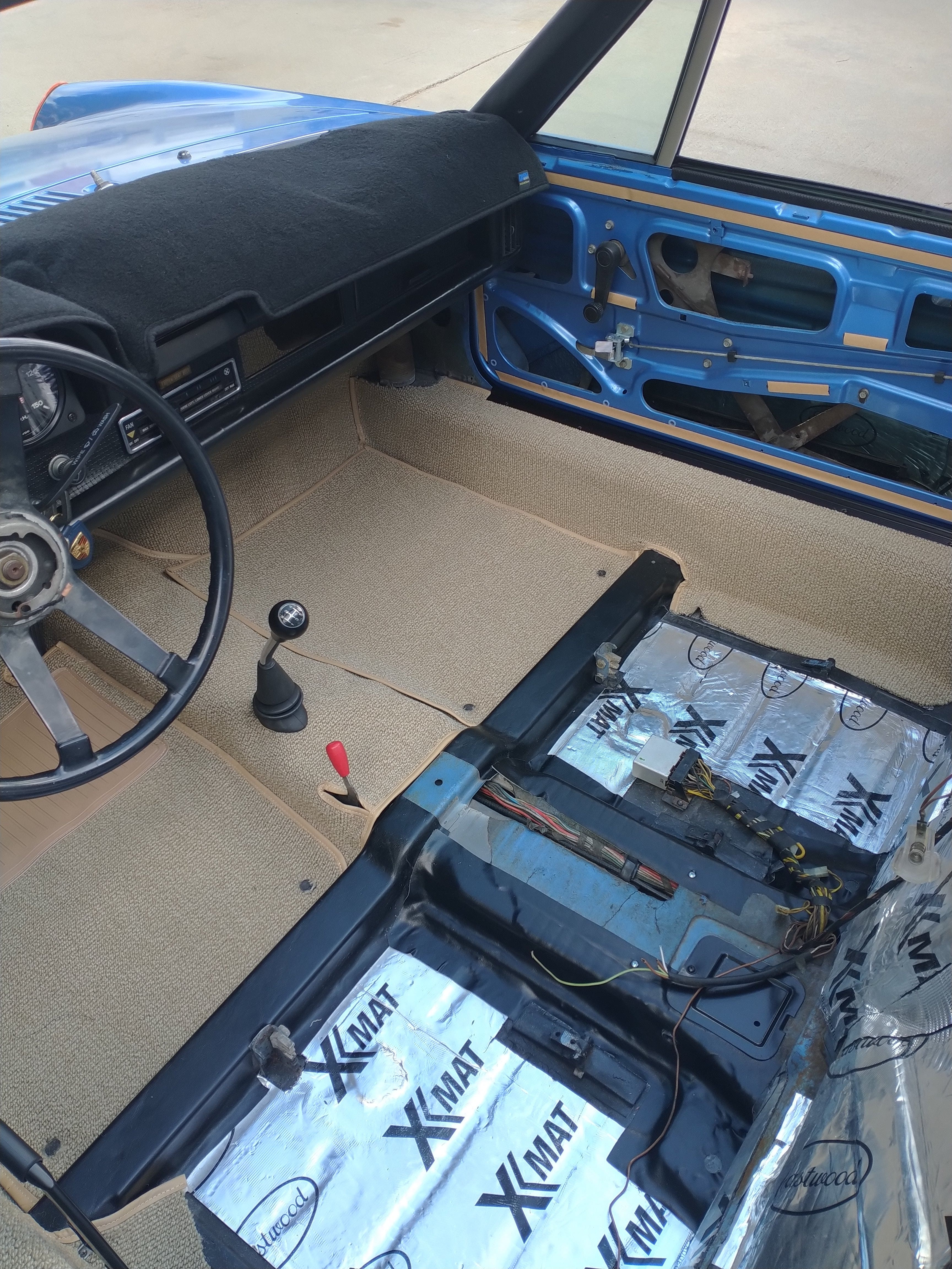

and from the other side.
