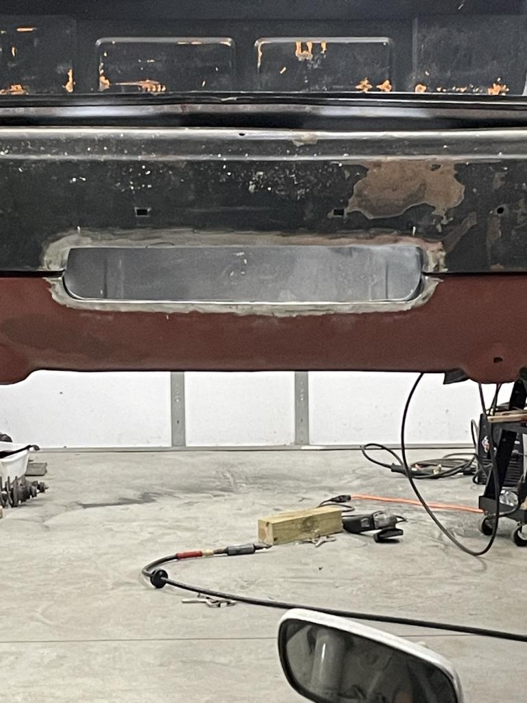

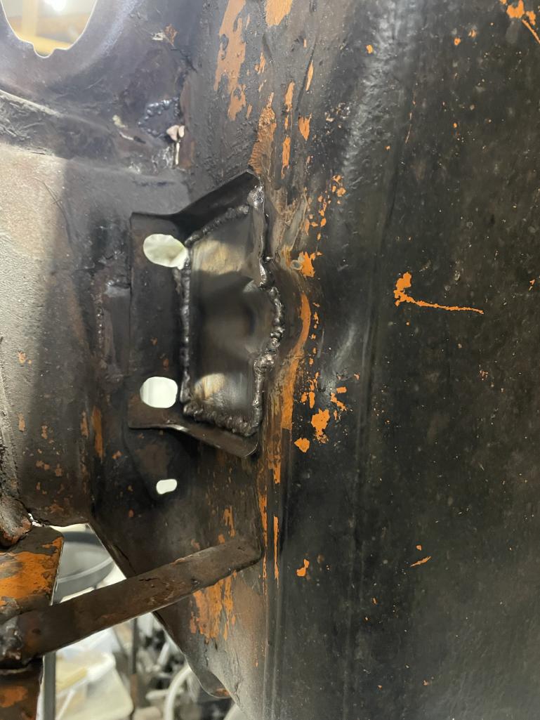

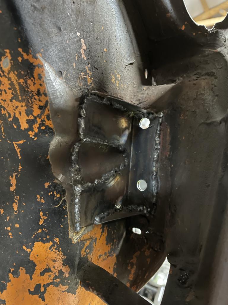

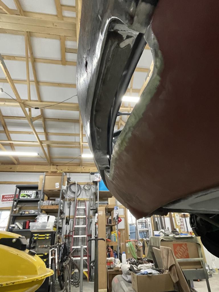

I saved the sh*ttiest task for last……had to repair some pretty bad rust at the front bumper mounting areas. There were sizable holes through to the headlight bucket area. Fabricated some patch panels and made it strong again. This area just sux because there’s no room to work it at all.

Patch welded in…..

Passenger side was worse and required 2 patch pieces….

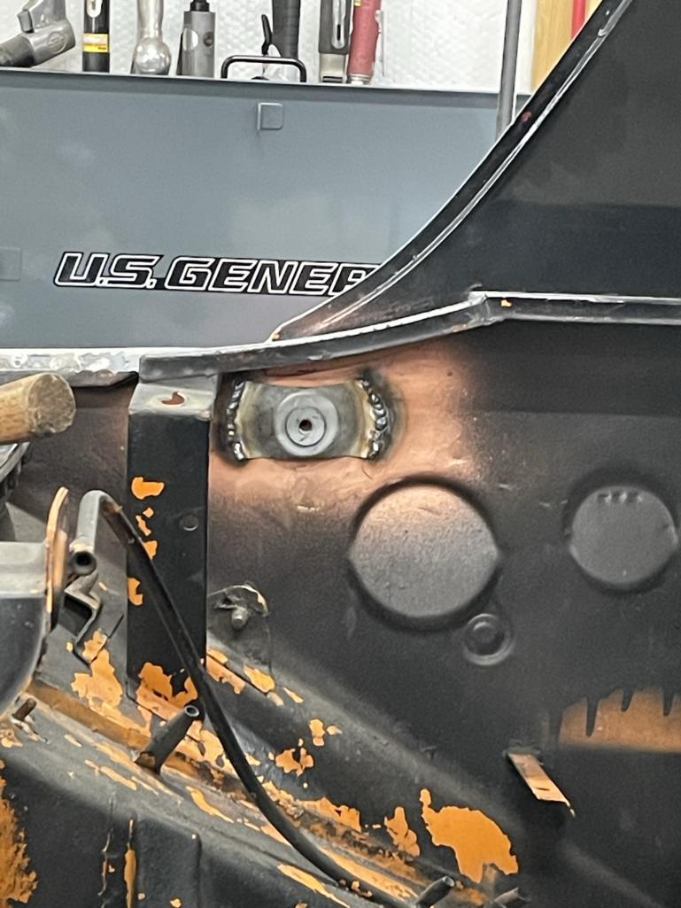

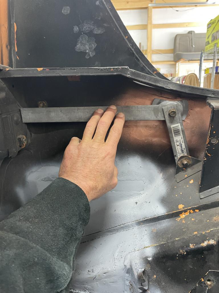

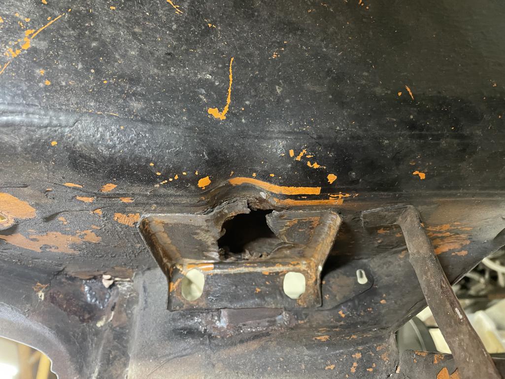

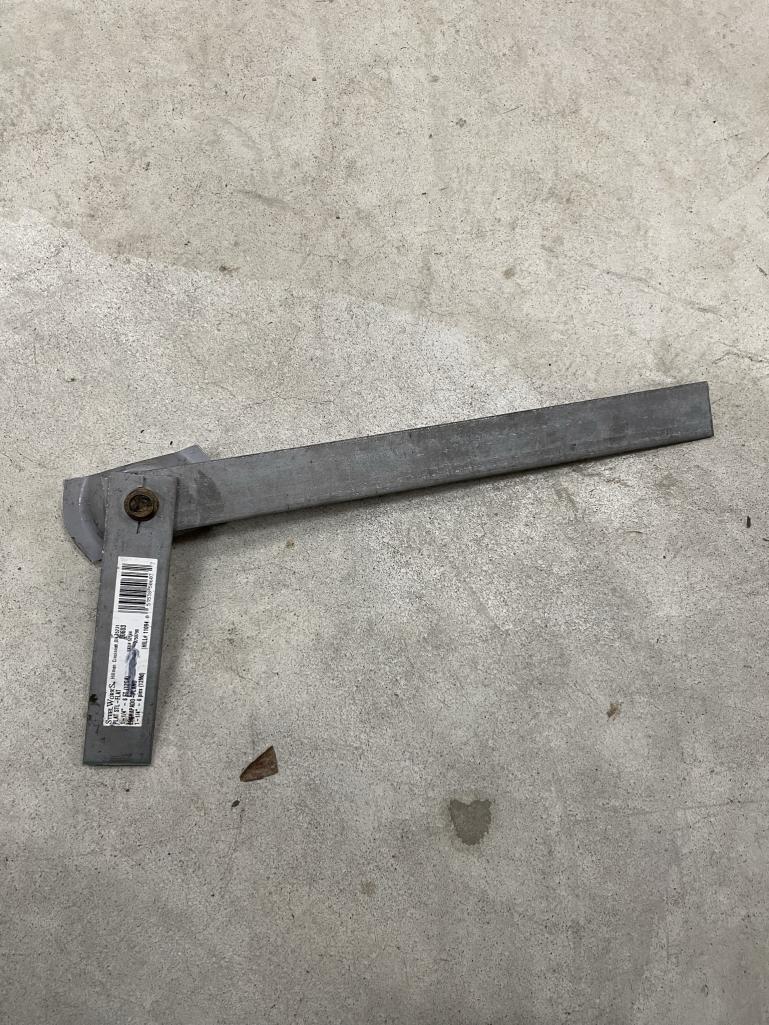

Then it was on to rear trunk hinge pivots. The drivers side was a mess of bubble gum welds holding a stock replacement pivot. I cut the off and got down to clean metal. The passenger side had an aftermarket heim joint setup (jwest?) and they had drilled multiple holes before they got it right. I welded up all the holes and got back to clean metal as a base.
I made a little jig for proper positioning the pivot, it works for either side.

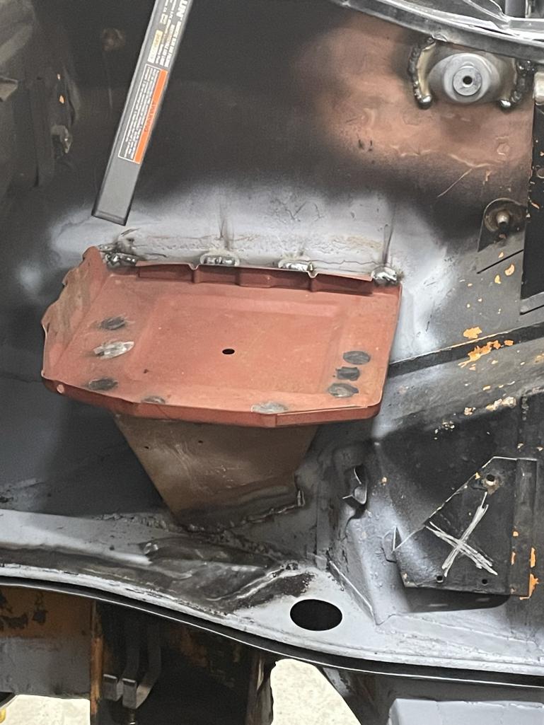

Tackled the battery tray next. Although I’m doing a Subaru conversion and most seem to relocate the battery, I couldn’t find any reason not to go with the stock location.

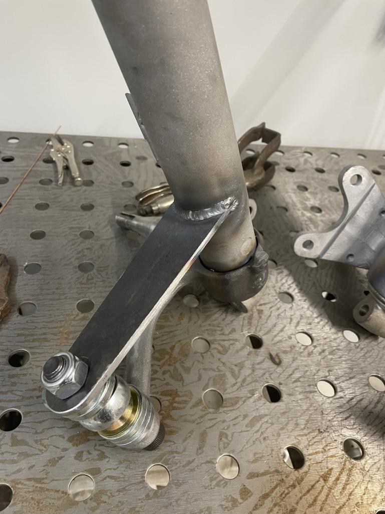

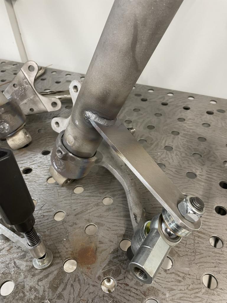

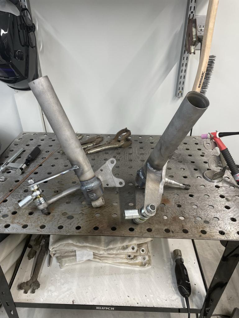

Decided a little while back to go with 911 struts. I was originally going to use my stock 4 bolt struts and convert the rotors to 5 lug and started modifying them for the Safari lift.
Fast forward…..thanks to @mepstein , I have 911 struts to mod.
I lowered the axles 1.670” and added a steering arm brace to allow for heim joints (vs ball joints). Welded them up today and now they’re ready for prime and paint.

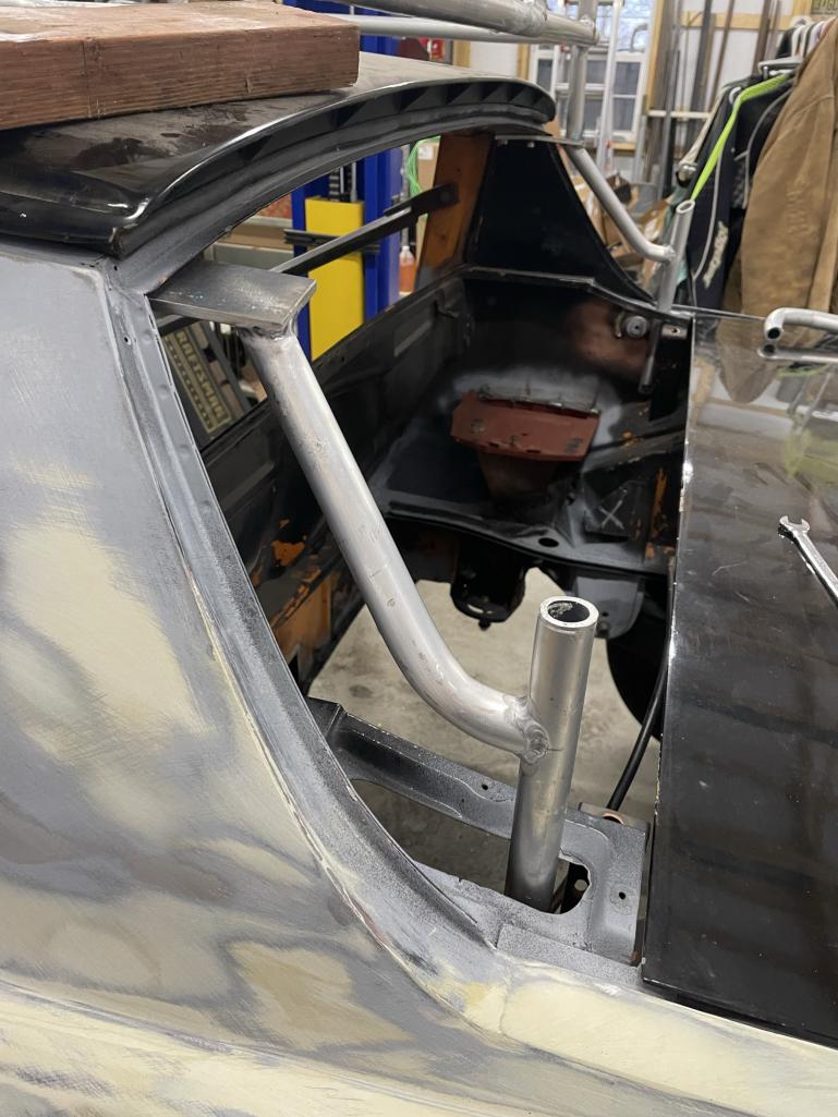

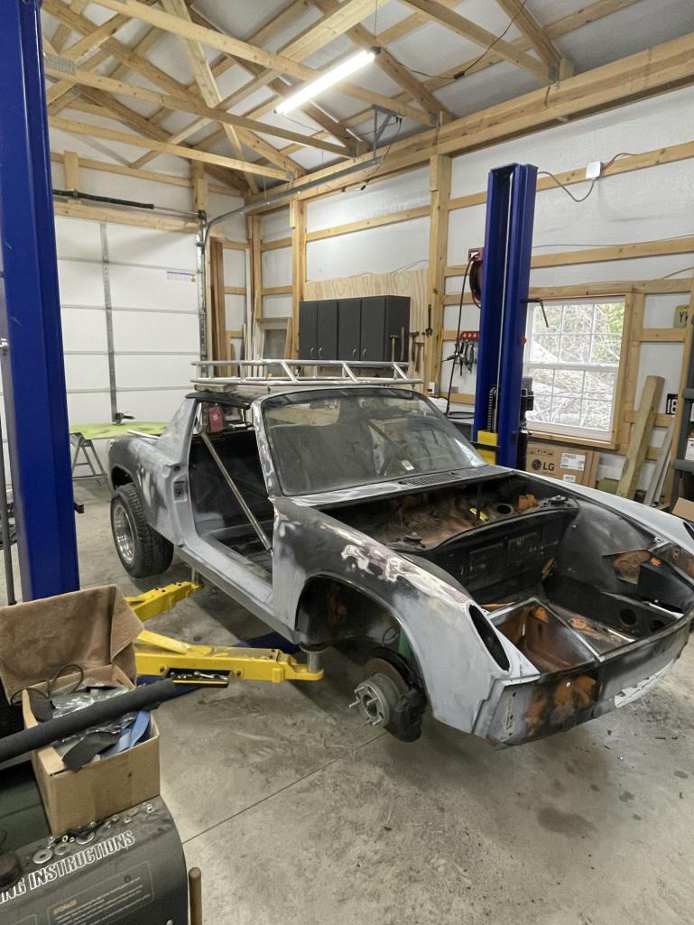

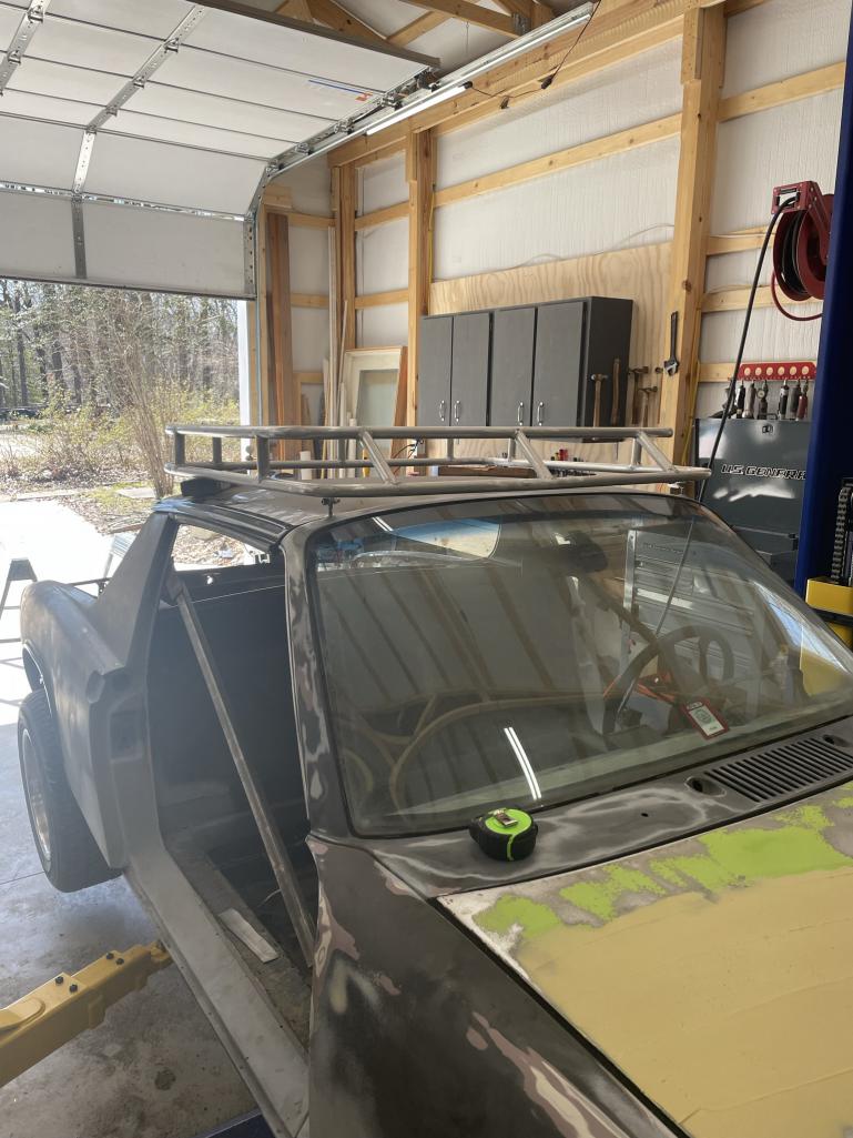

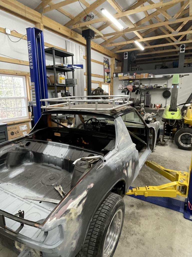

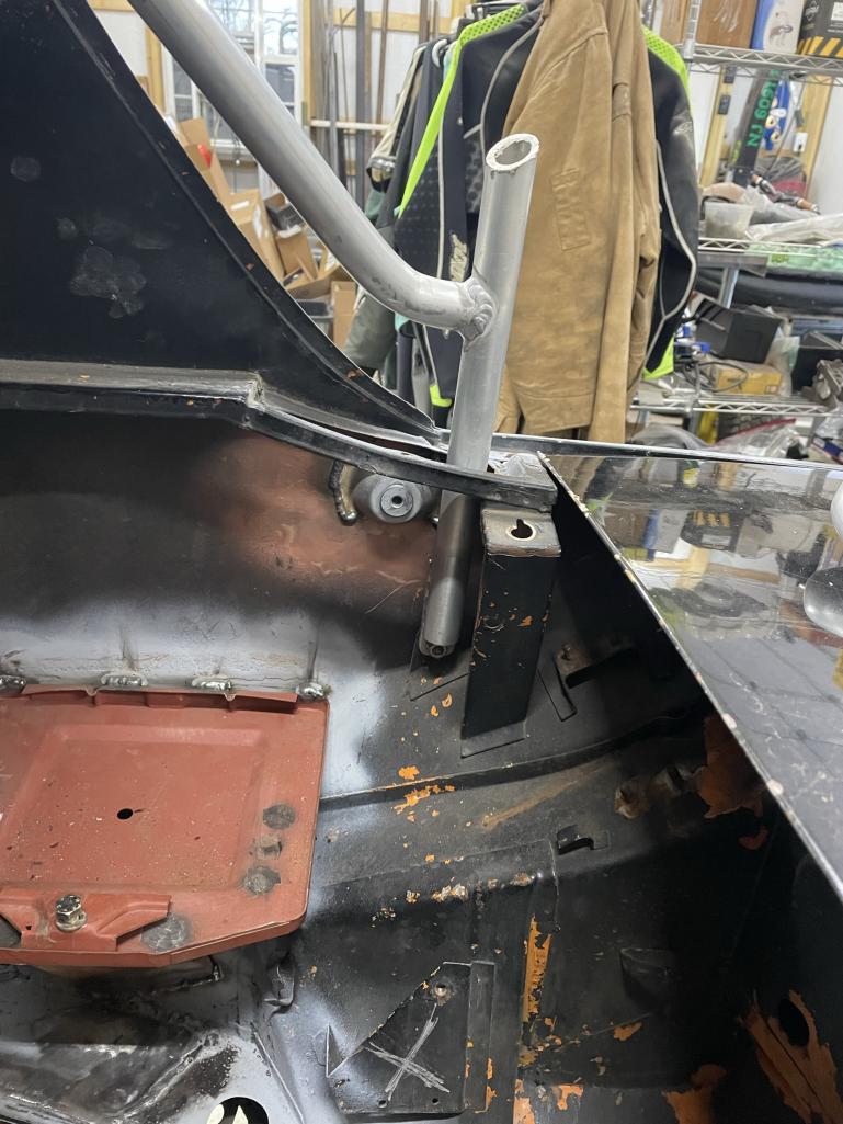

Safari stuff progress……still have to work the mounts. The front rake/angle matches the windshield.

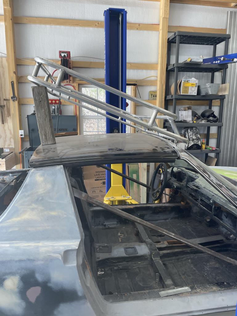

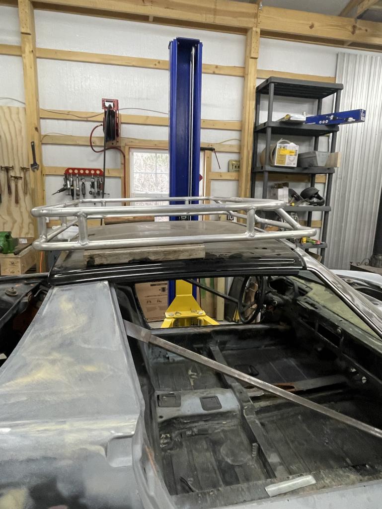

Miscellaneous tidbits…..

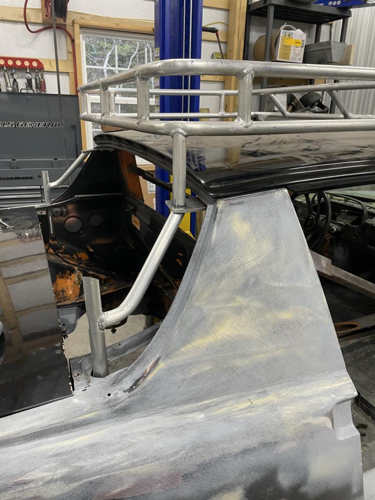

Hinged at the front so you can remove the targa roof? Nice touch...
- Tony
East coaster
post Apr 1 2023, 07:10 PM
Post #72
Posts: 1,992
Joined: 28-March 03
From: Millville, NJ
Member No.: 487
QUOTE(Retroracer @ Apr 1 2023, 08:48 AM) *
- Tony
Yup, that was an absolute requirement!

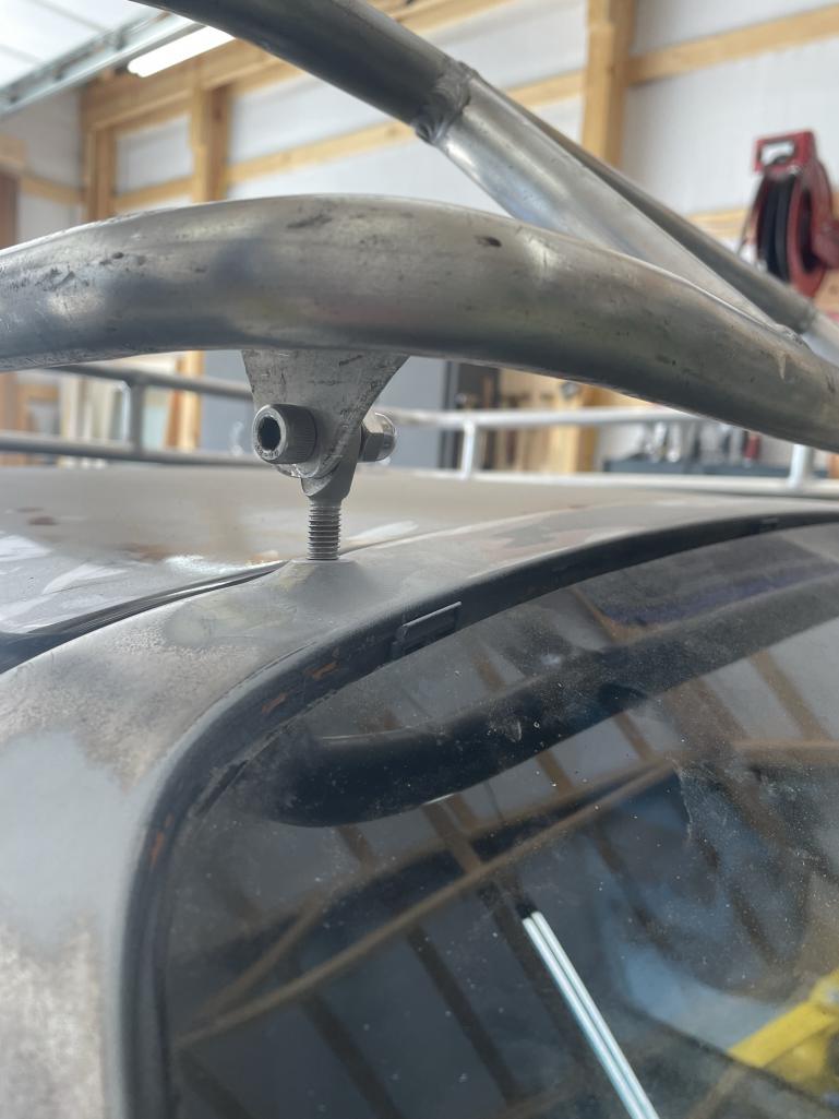

Better reinforce windshield frame..
https://pbase.com/9146gt/image/88567152
The Sunco 9146GT ..owner complained about flexing and broken windshields..
East coaster
post Apr 2 2023, 06:12 PM
Post #75
Posts: 1,992
Joined: 28-March 03
From: Millville, NJ
Member No.: 487
QUOTE(sixnotfour @ Apr 2 2023, 12:01 PM) *
Thanks! I’ve considered that but I don’t plan on carrying too much on the roof rack except the front wheel of my mountain bike. I’m thinking I won’t be stressing it much more than the factory ski racks did…….I guess I’ll find out.
The rack is mounted on heim joints at the windshield so it can flex front to rear without stressing the windshield frame. Of course the main reason for the heim joints is to tilt the rack to remove the top.

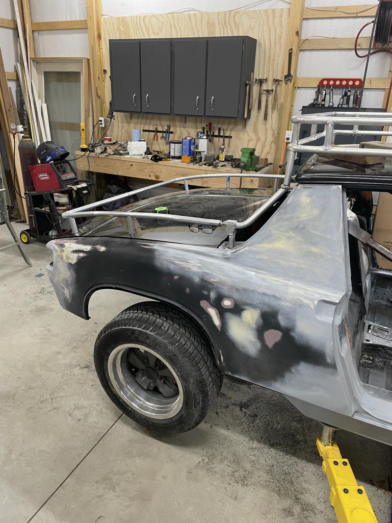

Started work on the rear rack. Hope to get it welded up tomorrow…..
