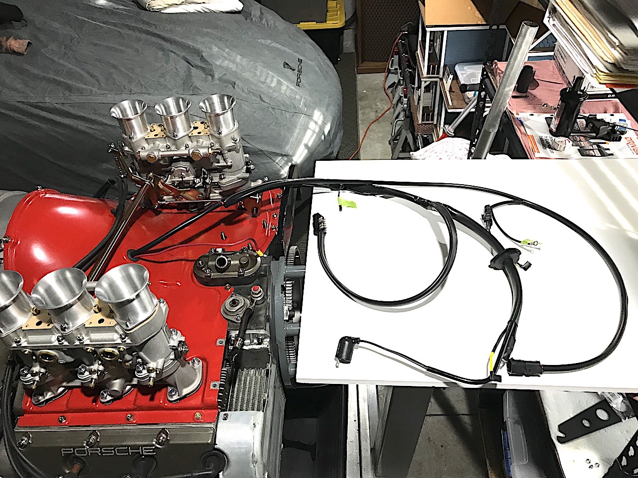

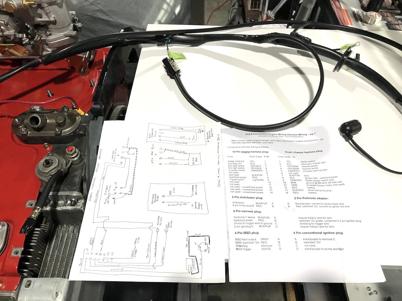

mlindner
post Dec 14 2022, 05:26 AM
Posts: 1,807
Joined: 11-November 11
From: Merrimac, WI
Member No.: 13,770
Not only does Perry build a great engine harness, he also explains it well. Plug and play.Attached Image Attached Image
