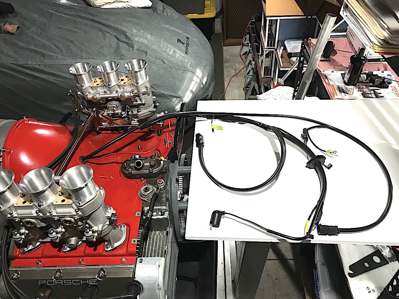

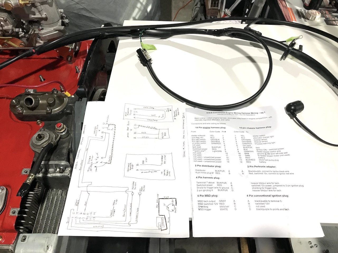

Not only does Perry build a great engine harness, he also explains it well. Plug and play.Click to view attachment Click to view attachment

I in my pamphlet 914-6 conversion guide or "what you are getting yourself into" have the wiring harness diagrams showing how to use the four board with a six engine
