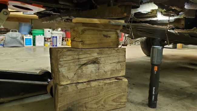

interesting method Jeff
i think i'll stick to the engine plate method tho
but to be extra safe,
i'm going to place wood blocks under the engine and tranny
while i loosen the engine and tranny bolts
just in case the floor jack would fail
then remove the blocks one by one as i lower the engine/tranny
according to this forum and the plate manufactures
the engine/tranny should be balanced on the lift plate
Drex

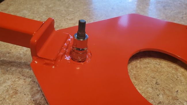

(IMG:http://www.914world.com/bbs2/uploads_offsite/www.surfacezero.com-27003-1679135550.1.jpg)
received the two important tools i'll
need to drop the engine
plan to do this today or tomorrow
it is 10 F in iowa this morning!

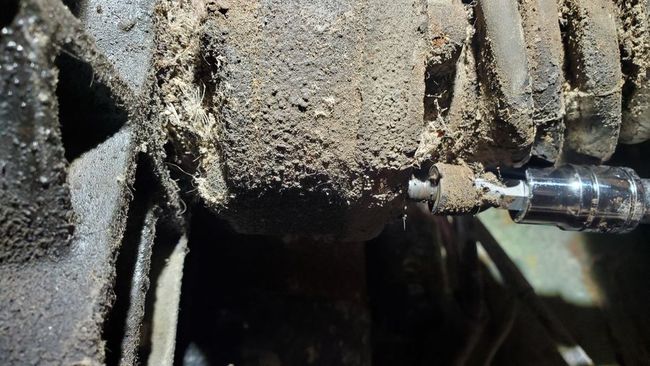

(IMG:http://www.914world.com/bbs2/uploads_offsite/www.surfacezero.com-27003-1679182212.1.jpg)
Took out these 8 bolts
What is the best way to separate
the axles from the transmission?
Thanks

QUOTE(Drex @ Mar 18 2023, 05:30 PM) *
Thanks
Drex
Give the hub a few gentle taps to seperate. There is a gasket in there, often the PO has applied some sealant in there making it "seal better". Remove the large (36mm) nut at the wheel side and remove the axle shaft.

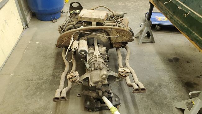

(IMG:http://www.914world.com/bbs2/uploads_offsite/www.surfacezero.com-27003-1679250639.1.jpg)
Engine is out of the parts car!!
Used a flat screwdriver with masking tape
and gently tapped around the CV/transmission joint
until it slowly split apart
Took a lot of patience
Had to use a grinding wheel on three of the four transmission mounting bolts
The top nuts were completely inaccessible
Also, the engine mounting bolts consisted of
recessed Allen bolts with a large nut on top
I was able to get a 17 mm socket on the top nut
and an Allen wrench, with a long extension, below
One came right off, the other broke the bolt off
If the Allen head would have stripped out
I'd would have had to cut the mounting bracket
Fortunately, this wasn't necessary
Drex

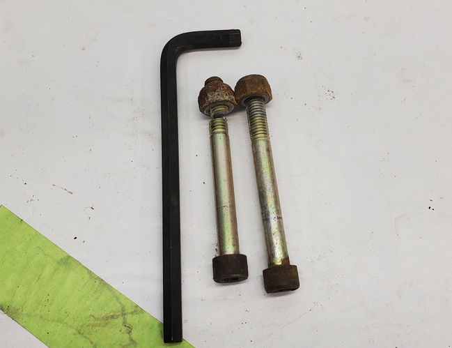

Drex(IMG:http://www.914world.com/bbs2/uploads_offsite/www.surfacezero.com-27003-1679252200.1.jpg)
Allen engine mounting bolts

So having done this - would you agree the Tangerine engine cradle is worth it? If answer is no, try putting it back in without. That might give an alternate view. (IMG:style_emoticons/default/happy11.gif)
Hopefully you don’t regret it. I love mine and I’m just ashamed I didn’t invent it.
Drex
post Mar 19 2023, 01:07 PM
Post #110
Posts: 170
Joined: 1-December 22
From: Guthrie Center, Iowa
Member No.: 27,003
(IMG:http://www.914world.com/bbs2/uploads_offsite/www.surfacezero.com-27003-1679252864.1.jpg)
Hello Superhawk!
Yes, I was glad I spent the $ for the tangerine engine lift plate
The tough part of dropping the engine were the mounting bolts
I was extremely nervous about safety
some used wood blocks under the engine
while removing the engine mounting bolts
But the plate worked like a charm and the
engine came right down
Drex

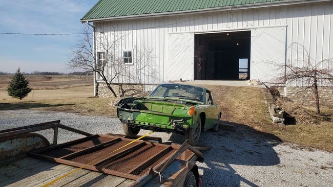

(IMG:http://www.914world.com/bbs2/uploads_offsite/www.surfacezero.com-27003-1679482268.1.jpg)
When I loaded up the 914
Was in Stockport, IA
The Clark barn was featured in
the Iowa most beautiful Barn contest
Drex

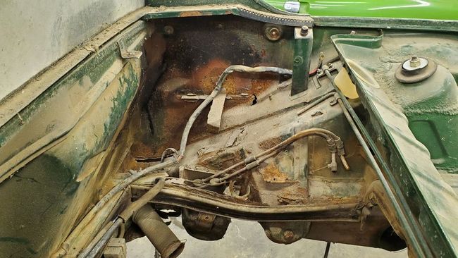

(IMG:http://www.914world.com/bbs2/uploads_offsite/www.surfacezero.com-27003-1679856701.1.jpg)
This was just left of the glove box on the panel
What was it used for?
Drex
