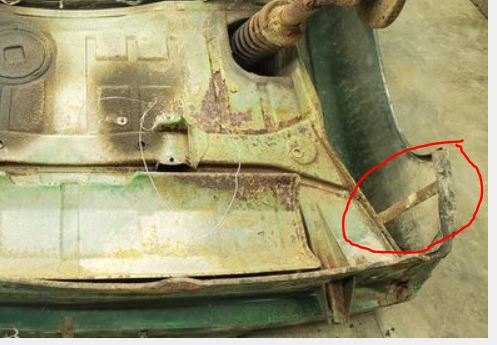

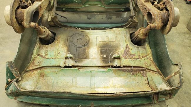

(IMG:http://www.914world.com/bbs2/uploads_offsite/www.surfacezero.com-27003-1680348084.1.jpg)
I have not saved the harness yet
Are they worth saving?
Also, here is the rear trunk floor
Look good enough to save?
The trailing arms look awful rusty
Is this just appearance and would
they sand blast and powder coat ok?

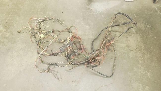

If the harness wiring is not cut or hardened it can be reused. Even if it has a few cut wires it can be repaired. If you remove, no need to cut anything especially where pulling it through the engine bay firewall, that cut destroys the harness. You will need to just remove the plastic connector housings at the relay board 14 pin connector, fuel pump connector and headlight connectors. Pretty simple, just compress the wire terminal tangs and pull the terminals out of the housings.
You have a 71 - which version of the chassis harness do you have early or late? The difference is best seen at the steering column connector - is it 12 pin or 14 pin?

Unless they're bent the rear trailing arms would probably clean up ok with blasting etc. With new bushings and bearing I'd bet they would be usable.

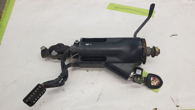

(IMG:http://www.914world.com/bbs2/uploads_offsite/www.surfacezero.com-27003-1680384485.1.jpg)
Jeff, is this the pin connector your talking about
I only count 13 pins

Thanks Drex! You have the late-1971 chassis harness, lucky you! The connector is a 14 pin connector but it correctly has only 13 pins. Willl PM you.

(IMG:http://www.914world.com/bbs2/uploads_offsite/www.surfacezero.com-27003-1680569461.1.jpg)
Removed the complete harness today
It's a little beat up in areas
but mostly intact
Pushed a lot of wires thru tiny holes!!

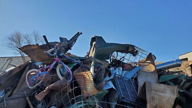

(IMG:http://www.914world.com/bbs2/uploads_offsite/www.surfacezero.com-27003-1680799321.1.jpg)
Well...
The remaining carcass of my parts 914
Went to the dump today
400 lbs
Ready to start in on the real project
