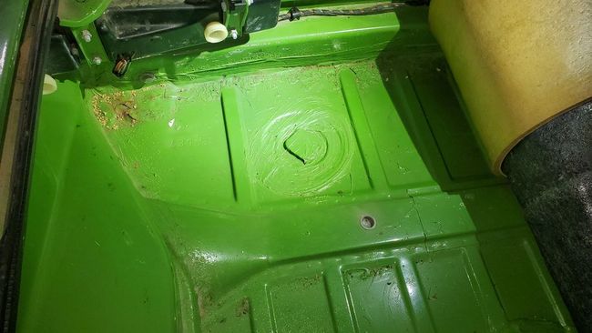

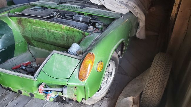

looked at this 914 again yesterday
wow...temp was 63 F (IMG:style_emoticons/default/biggrin.gif)
big change from the below zero we've had lately here in Iowa
my friend's sister was a big help
we found the original VIN plate for the L front fender area!
here is picture of the 'Hellhole'
looks like the battery tray is toast
but i think the area under it isn't too bad
also, a picture of the rear trunk floor
looks pretty good
i did push up on the under the body
it had been undercoated
but unfortunately, felt a little spongy in places
old man rust may have invaded
but...
if the judge permits
i'm still going to buy it
thanks for all your help

I know this car has some sentimental value to you and that’s OK.
That battery tray is just the tip of the iceberg. By the time they are that rusted, there is significant damage to the wheelhouse inner, and the hell hole below that you can’t even see with the ECU in place. All that acid that caused the battery tray corrosion is also down in the passenger side longitudinal eating away at metal 25/7 for the last 40 years.
Don’t let a judge con you into paying much more and a couple thousand dollars for this car. As stated previously, he will likely only see PORSCHE and think it’s worth big $$
This car is will be a time and money pit - you’ll be doing the family a favour by fixing it!
