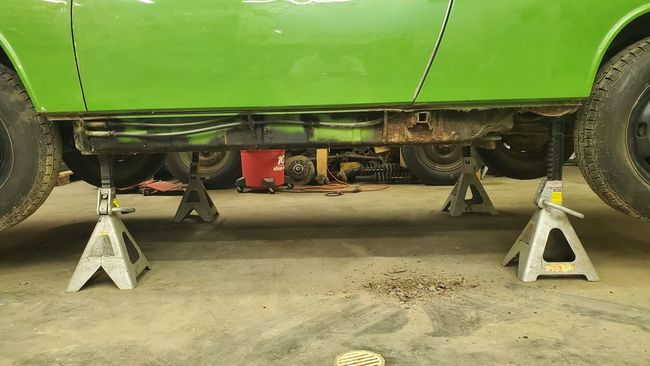

the L rocker area
once i have cleaned the old jack plate out
i may need to reinforce the rocker area behind it
just curious
is the jack support plate welded at the top?
it looks a little dicey to get at
D Rex
D Rex
It’s do-able without cutting the rear quarter
See my thread, page 26, post 510
http://www.914world.com/bbs2/index.php?sho...5209&st=500

Great pictures Superhawk!
big help
thanks

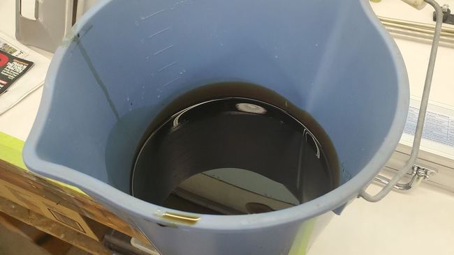

(IMG:http://www.914world.com/bbs2/uploads_offsite/www.surfacezero.com-27003-1686966229.1.jpg)
yes, probably
i remember when i was restoring my '63 (actually a '62) VW beatle in the early 2000's
i had subscribed to a couple of VW magazines then
i drained the oil today
no metal or other debris
really looks pretty clean after 40 years

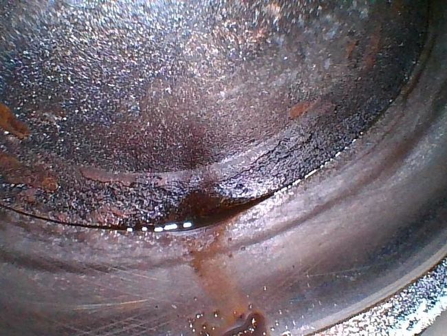

(IMG:http://www.914world.com/bbs2/uploads_offsite/www.surfacezero.com-27003-1687092140.1.jpg)
this is # 2 cylinder
i used DW-40 to spark plug overnight
as it was very tight
what do you all think?
thanks
D Rex

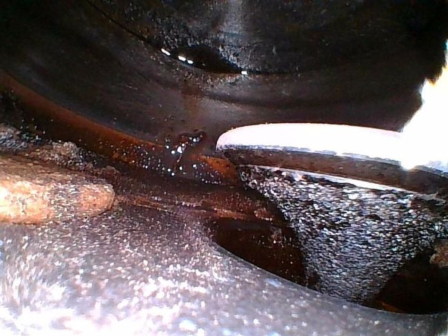

(IMG:http://www.914world.com/bbs2/uploads_offsite/www.surfacezero.com-27003-1687092353.1.jpg)
# 4 cylinder
again spark plug with WD-40 overnight
so the fluid in cylinder is the leftover WD that
dripped into the cylinder when i removed the plug
D Rex

You can start and run engine but it is unlikely to be 100%
Boxer engines don’t store well being prone to condensation and rust pitting in the bottom of the cylinders.
Set aside funds for the eventual rebuild
(IMG:style_emoticons/default/agree.gif) It's a coin toss, she may or may not run decent. But a rebuild is in order at some point. Is the rest of the hulk somewhat road worthy? You just might get some seat time this season
