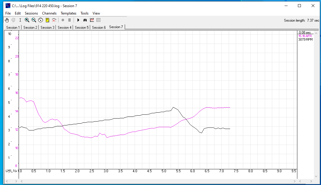

FWIW< I’m trying to get the lean spots out of there..
13.1 across the board and maybe touch 13.9 /14 on light cruise

Now that I understand the log, that is pretty cool. Good thing you got it working again. Is this Wot pull in first or 4th? Or are you shifting?
I think it might be best to keep it in a gear like 3 or 4 and go from 1k to 5k

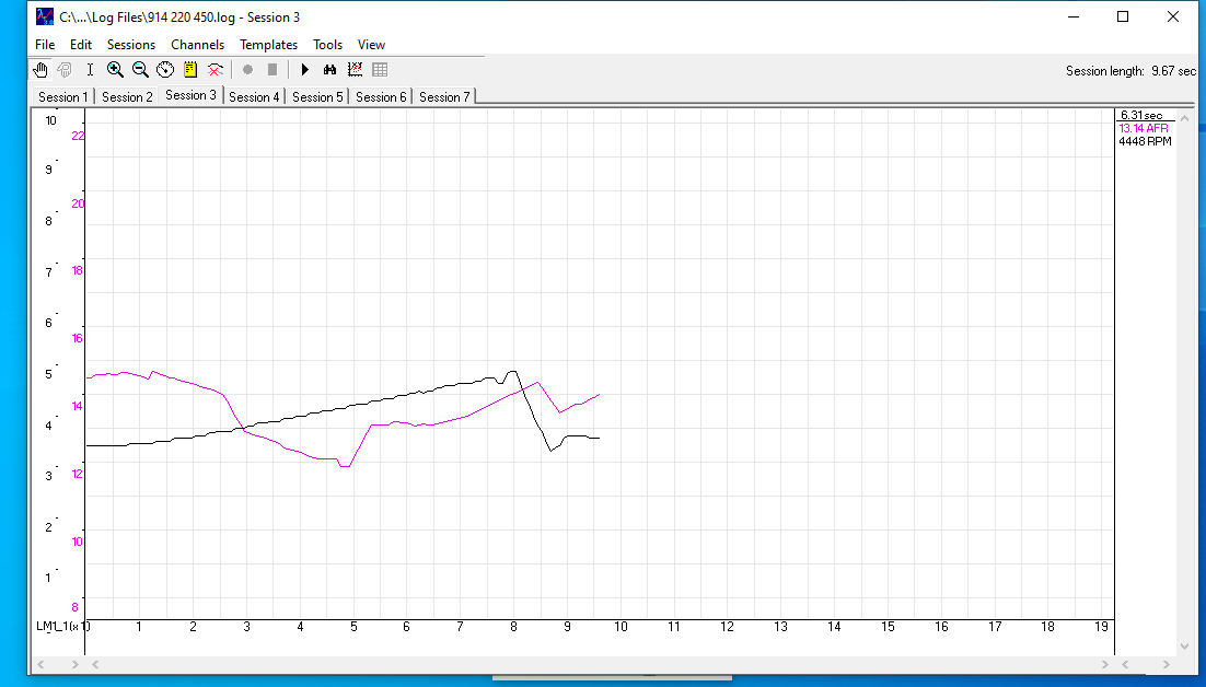

another pull in 3rdAttached Image

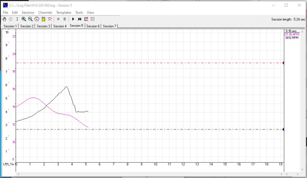

11 afr is too rich for me...

6k pull. This looks pretty good

Those look a lot better. Its better to be on the rich side then the lean side when you stomp on it.
Get a log just driving around how you usually drive the car and compare WOT to normal driving. Do a log just cruising with low load.
Zach

Yes, this looks much better and the daily driving log would be great. I would be nervous about those lean parts of 3 to 4k, that's where the fun is and often the point at which the engine is under the greatest load, I would rather be at 12-13 there. Even my water buffalo mustang keeps it around 12.5 under that kind of condition.
