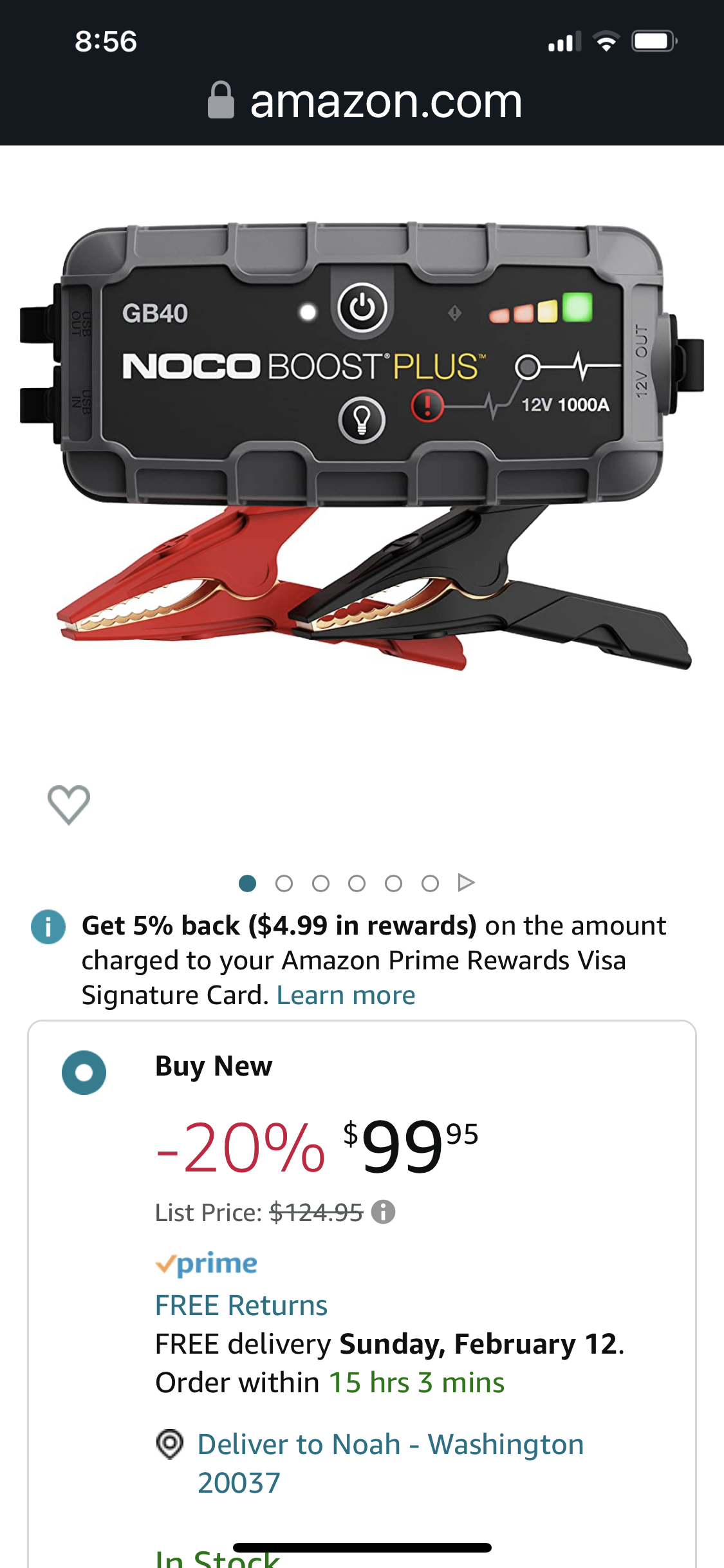

These will fit in the palm of your hand and start a large truck with a dead battery. I’ve personally used it on the truck. It’s what I purchased for my daughter. Gets high reviews.

QUOTE(mepstein @ Feb 10 2023, 07:59 AM) *
Sorry, there is no way in hell that unit will provide 1000amps unless you measure the time in milliseconds. The clamps themselves would melt after 2-3 seconds.

QUOTE(fixer34 @ Feb 10 2023, 06:03 PM) *
Agree on the 1000A rating - marketing hype.
Ratings are like cheap stereo ratings of old - optimistic and rated at peak.
However, research how lithium ion batteries perform. They can be designed for peak energy or peak power. A single 18650 cell can deliver 30A in short repetitive bursts. Pouch cells can put out even more current due to large surface area of the anode and cathode. This ability to deliver very high power out of such a small package is what makes Lithium ion batteries dangerous if used improperly and/or short circuited.
It is VERY EASY for these small jump packs to crank a completely dead vehicle (with or without vehicle battery) with a very small footprint and light weight. Used to use them a couple times a week. Way better than hauling around those old lead acid jump packs.
