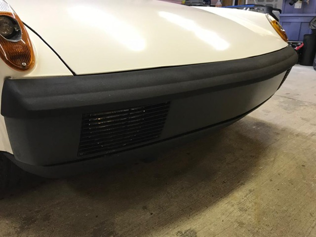

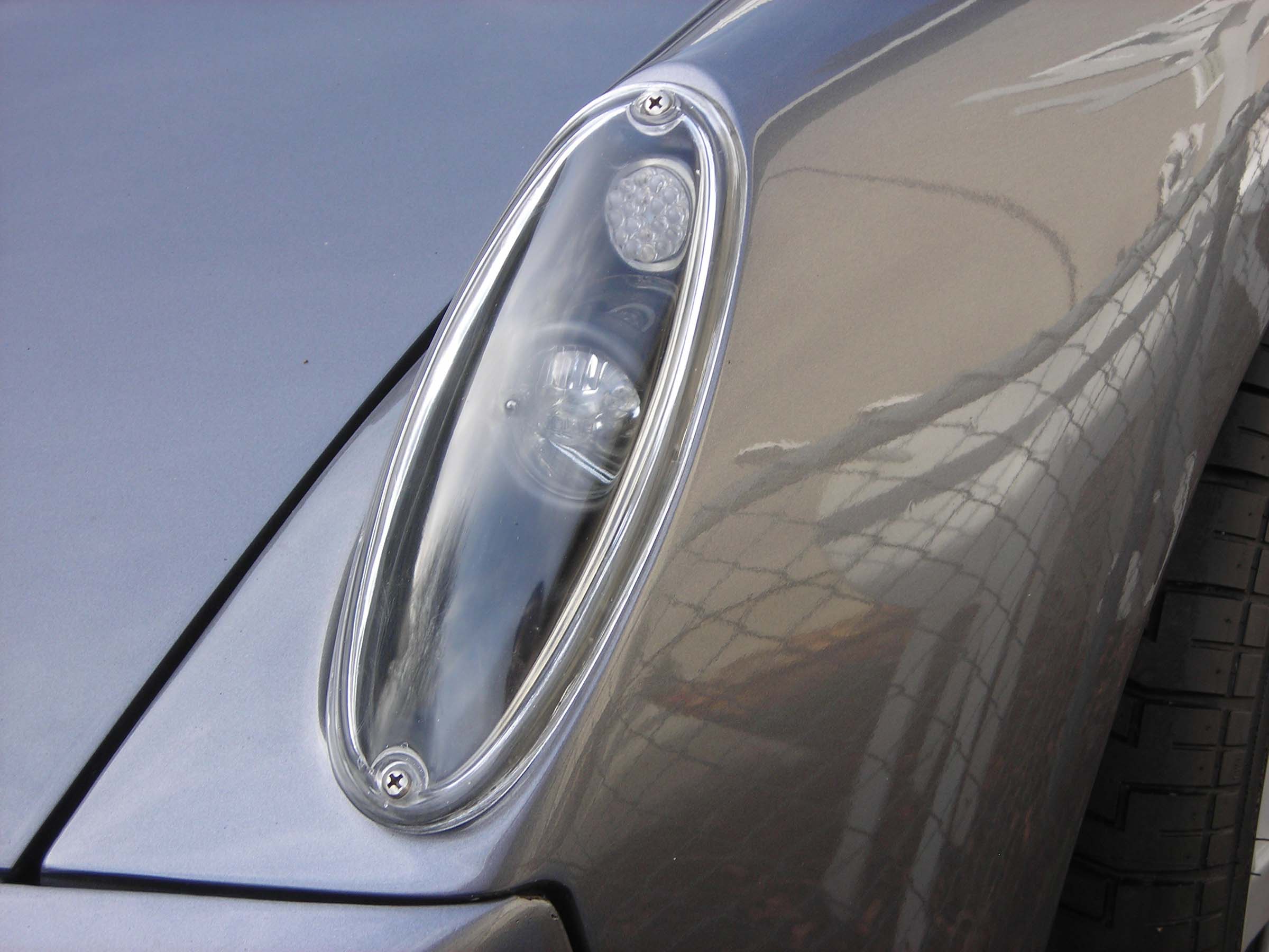

You can check out this thread:
http://www.914world.com/bbs2/index.php?showtopic=37568
And another option:
Garland

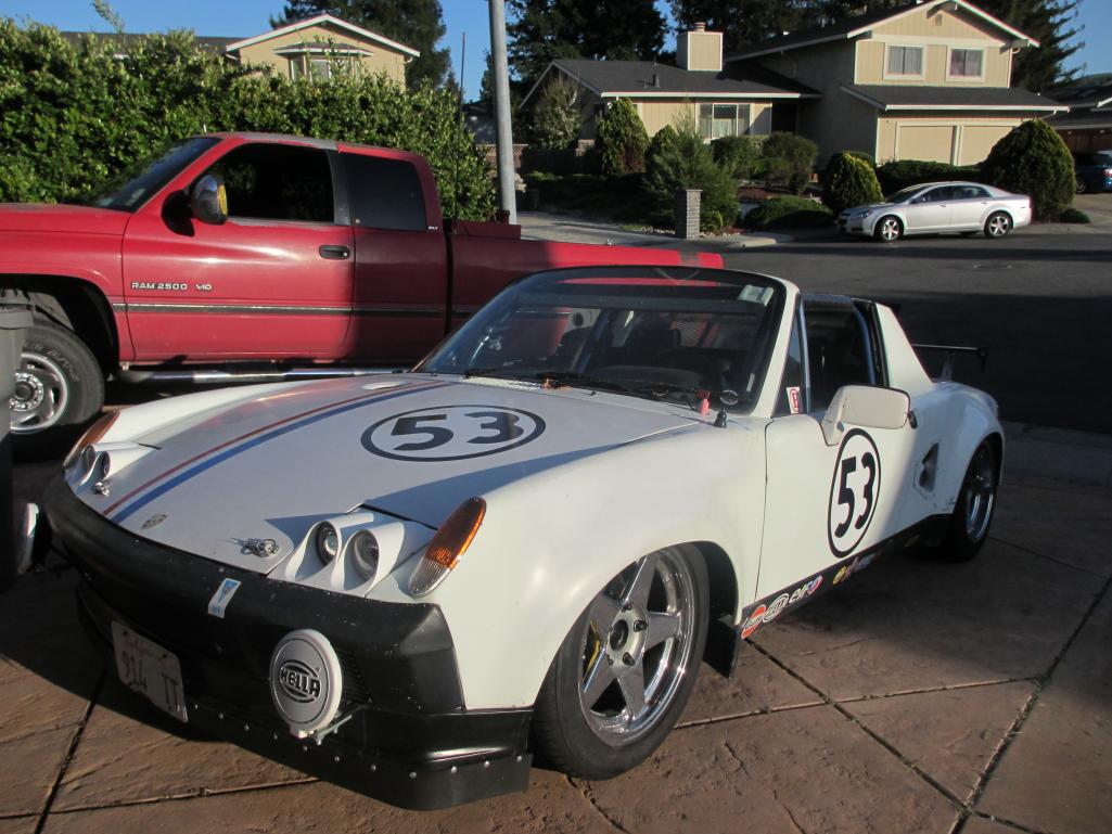

post Feb 20 2023, 11:07 AM
Restoration Fanatic
Posts: 1,413
Joined: 8-January 04
From: ......Michigan......
Member No.: 1,535
Here’s my build link, Link to Michigan Build 2016 using these LED full size, hi & low beam, in the bumper for 6 years, work great, never been bothered by the authorities. I did have to do a small modification for them to fit. The turn pods now also have LED bulbs, fog lamps.
