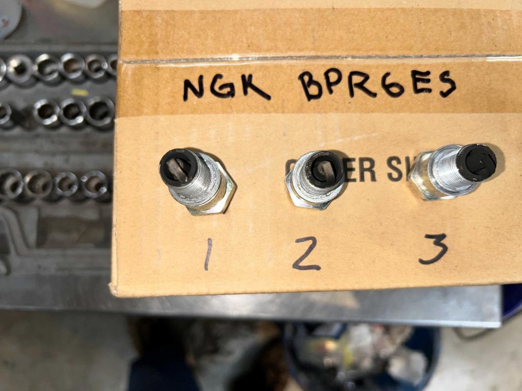

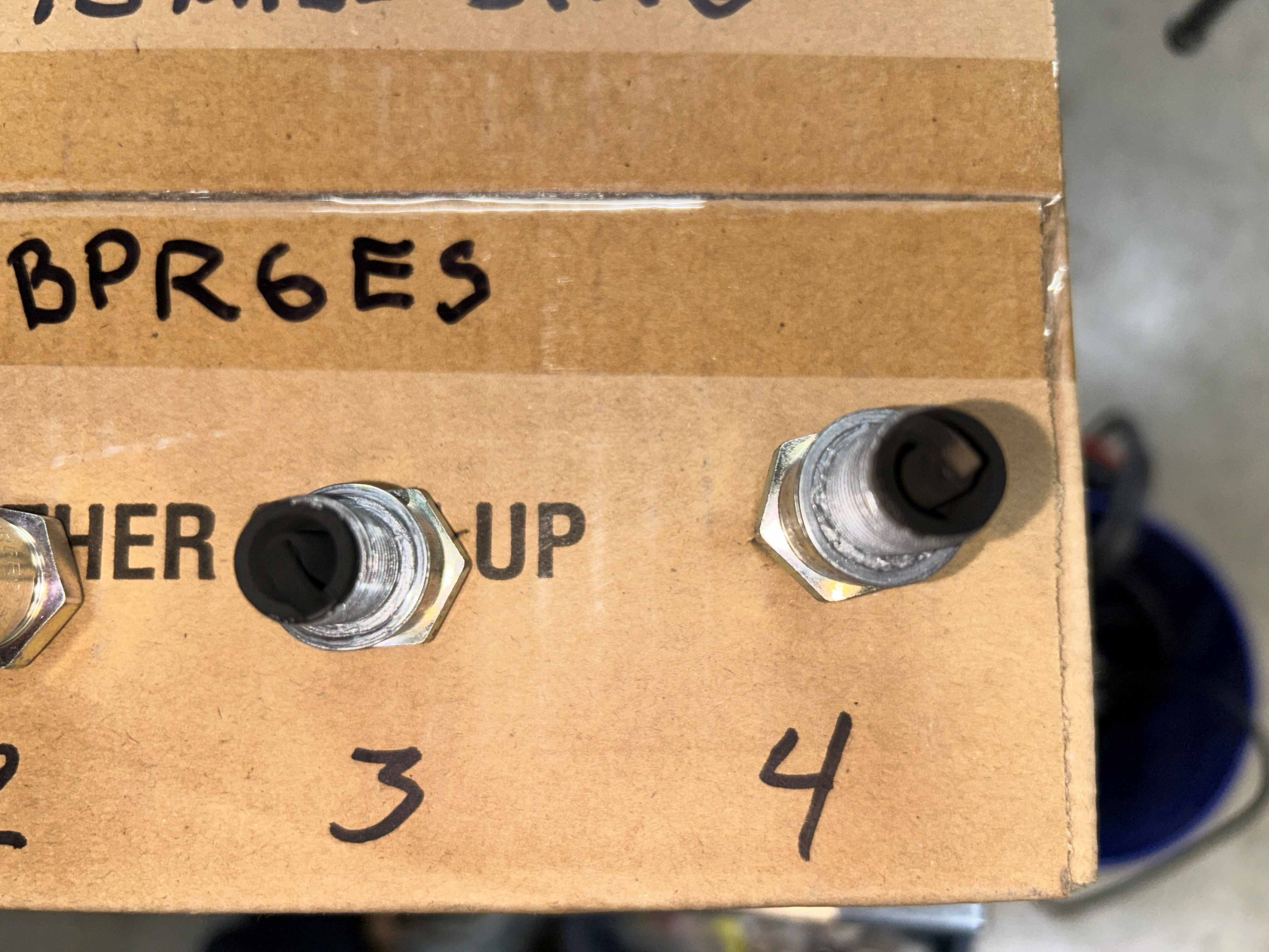

Rich as expected. 1 & 2 do look better, but still have the a bit of very black non-shiney, dusty look on the edge. Kinda strange, but maybe not since each barrel is adjustable, but they all have a bit of difference.
I think 1 is best, 3 is worst, in terms of BLACK-ness.
Again, this was about an hour idling when I was adjusting, then maybe 10 miles of driving.
Can this be cleaned off to review again when I have attempted BEST LEAN IDLE?

3-4 are running really fat.

Reading plugs happens two ways
One at idle….
Then, after you super clean them start and drive immediately, with little to no idling
Go run it up and down the gears
When you are coming into the driveway, shut it down
Try for no idle during this phase ( not easy)
I start it and rev immediately to 2500 ish
After you stop, let it cool down
Check the plugs again
You should see a different condition
Idle is typically much richer
You want perfect color under load, when driving
Rich

If I am checking plugs, I will run WOT for a short time, cut the ignition, coast to a stop and look at the plugs. Idling is a small portion of the picture, I want to know the mixture under load.

I’d start with a fresh set of plugs - once they get carbon’ed up like that they start getting misfire. Carbon conducts electricity. Almost impossible to get them cleaned properly when running that rich on 3/4

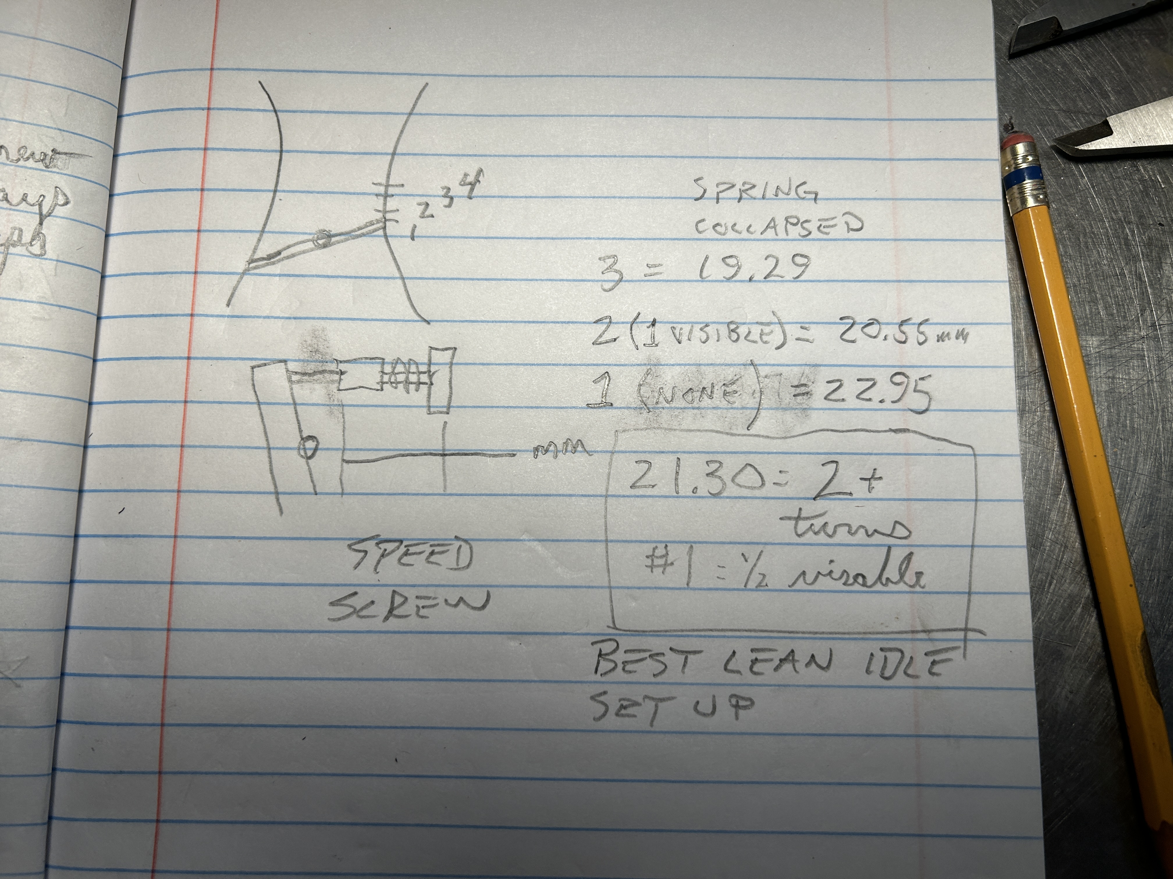

Here is a note about the plate and covering the small holes inside the barrel. I ended up taking one carb off yesterday, so I decided to check the plate situation.
There are 4 zig zag holes and I measured the speed screw all the way til it had fully mashed the spring.
so even at the Best Lean Idle preset, the btm hole is partially visible. Bad drawing, but here is an example.
