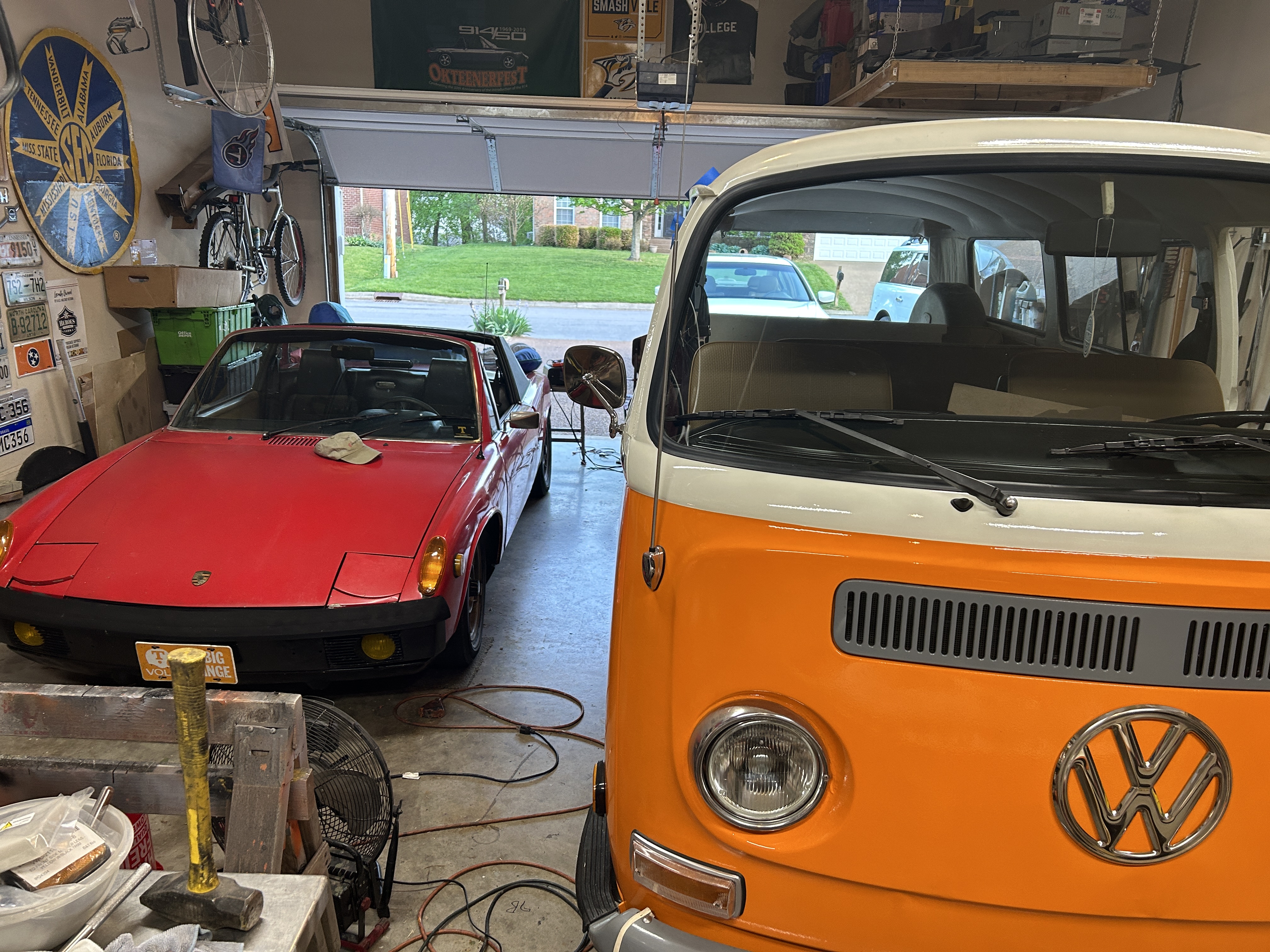

A BIG THANK YOU to ALL...... great to have the knowledge that is freely given here.
Would have been hard to do it without all the ideas and examples etc...
I will update here as I put some miles on the bus....
