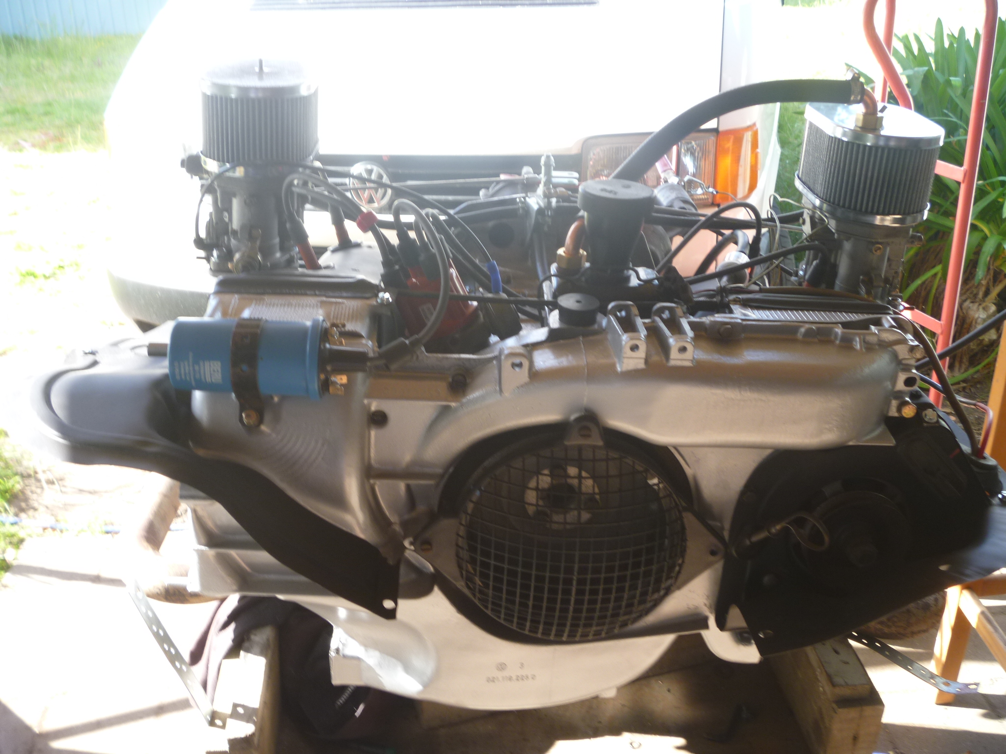

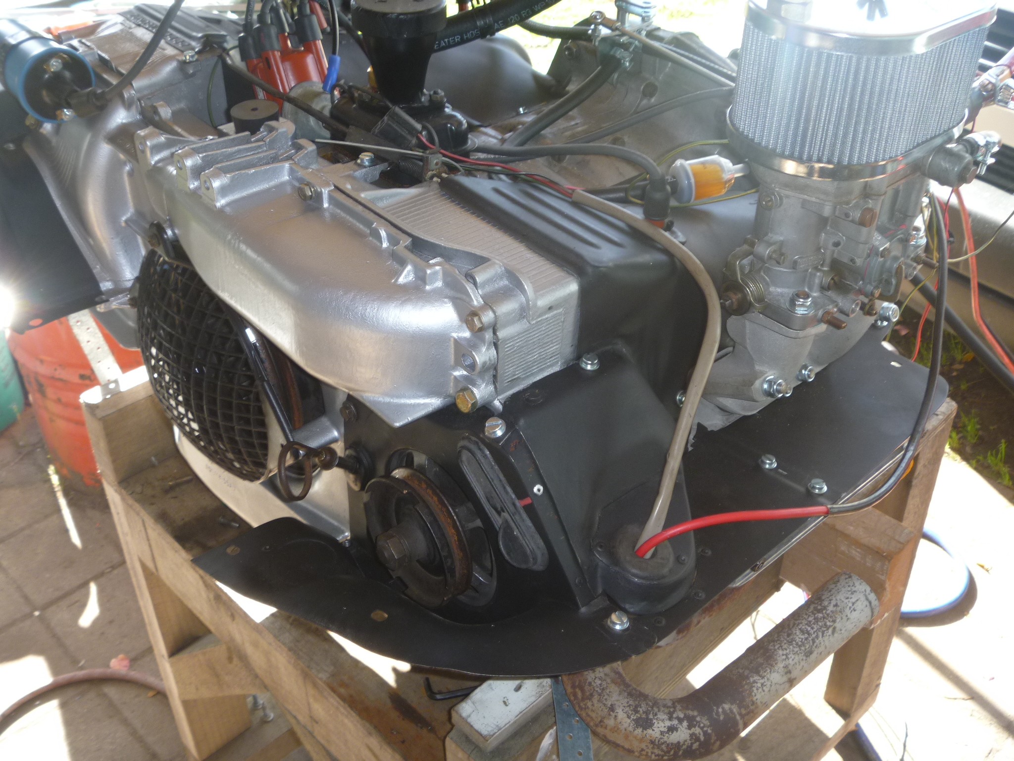

Thanks Rich ,missed that...not good for a "fresh" build ,even with low comp pistons it should be 125 psi even ish if run in properly ? the variation between cyl's 1 and 3 exceeds what is the norm even for a used motor .
Think the OP should do another compression test when engine is warm and if result is the same put a squirt of oil down the plug holes,if a retest shows an increase thats the issue,if as I suspect you will need to do a "leak down" test on your valves also.
Don't for a minute trust the manifold gaskets with the common intake manifold kits around,the EMPI ones for example are very soft and too thick causing leaks after they are fitted ,ask me how I know,most likely better check that first.
I persist asking about this but fitted 36dlra's to my last carb case from 411,NOS raised top pistons and 1.8 barrels,fully rebuilt heads,my carbs had little done to them but setup on a bench and cleaned,motor ran unreal almost out of the box as they say,so without being a dick something is wrong here reason I'am asking,cheers.
