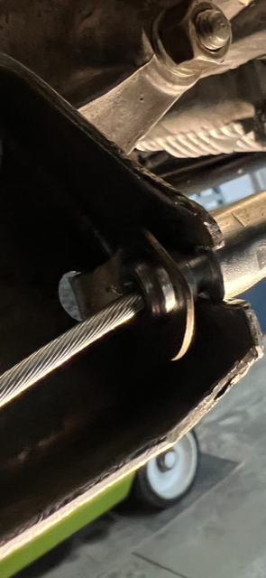

Hello,
I forgot how the clutch cable keeper is positioned. Maybe not the proper name for it. It keeps the cable from popping out of its bracket. I think... Any thoughts?

I did a deep search through the site and found a picture. I correct it and good to go.
Thanks

Krieger
post Aug 22 2023, 08:54 AM
Posts: 4,808
Joined: 24-May 04
From: Santa Rosa CA
Member No.: 2,104
That is not correct. The bendable lock tab goes on the other side of the transmission bracket. Remove cable from pulley and reinstall. Use the same groove on the clutch cable where the lock tab is now. With a small hammer and punch, fold the locking tab around the trans bracket and into the hole on the bracket.

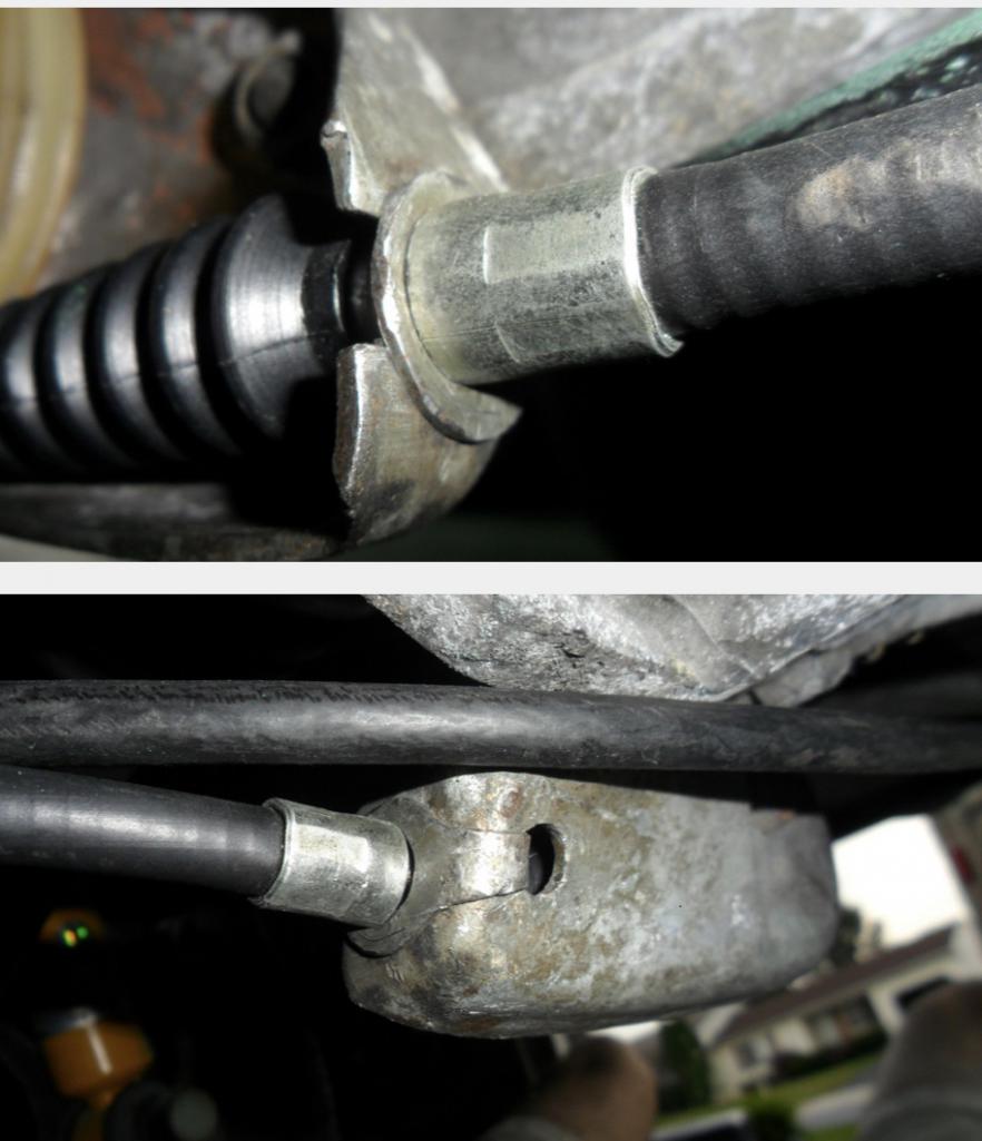

Superhawk996
post Aug 22 2023, 09:12 AM
Posts: 7,221
Joined: 25-August 18
From: Woods of N. Idaho
Member No.: 22,428
(IMG:style_emoticons/default/agree.gif) Yup
Here’s the proper setup
http://www.914world.com/bbs2/index.php?showtopic=218615
NARP74
post Aug 22 2023, 12:47 PM
Posts: 1,380
Joined: 29-July 20
From: Colorado, USA, Earth
Member No.: 24,549
I understand that pic to be the before, or what his was setup like. He found a proper pic and corrected it per his text. I could be wrong...

QUOTE(Superhawk996 @ Aug 22 2023, 08:12 AM) *
Thanks for posting the photos. I'll be doing this soon as well and they are very helpful.
Gordong
post Aug 22 2023, 03:37 PM
Posts: 30
Joined: 20-January 22
From: Carson City Nevada
Member No.: 26,268
Yes. I did a search. Found a photo and corrected it.
Thank you guys for all your help. If all goes good, I may be turning the ignition key this weekend.
Gordon
