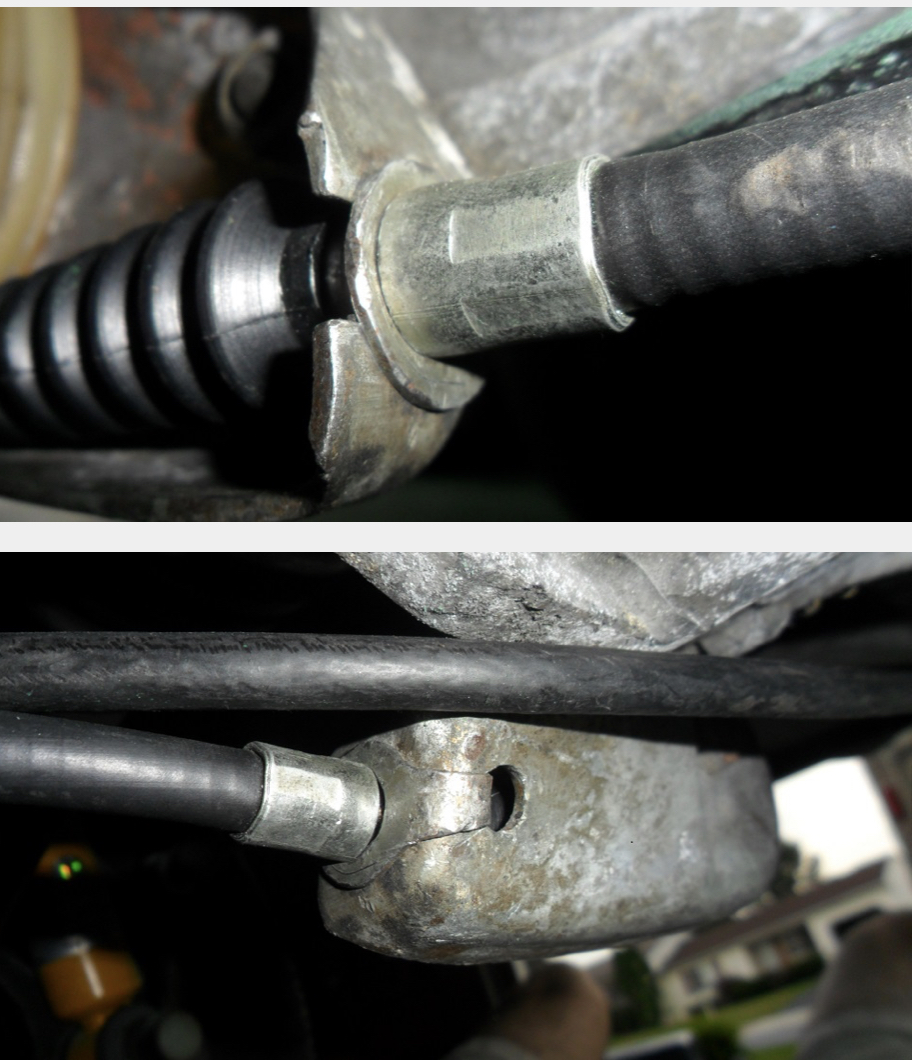

Hello, I forgot how the clutch cable keeper is positioned. Maybe not the proper name for it. It keeps the cable from popping out of its bracket. I think... Any thoughts?

I did a deep search through the site and found a picture. I correct it and good to go.

That is not correct. The bendable lock tab goes on the other side of the transmission bracket. Remove cable from pulley and reinstall. Use the same groove on the clutch cable where the lock tab is now. With a small hammer and punch, fold the locking tab around the trans bracket and into the hole on the bracket.
