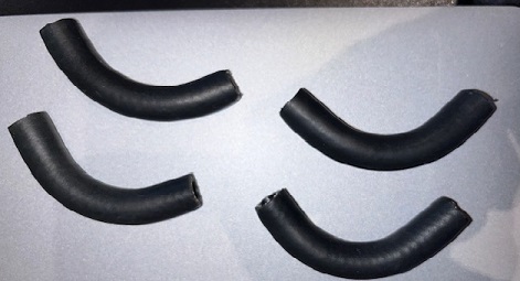

I'm replacing all of the fuel lines with Gates Barricade lines and made my own elbows for the pieces that are connected to the injectors. Pretty happy with how they turned out.

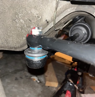

Regardless, I finally got the bars installed, followed by the tie rod ends. For the tie rods, I had to use both a jack and a c-clamp to keep the shaft from spinning when tightening, but I got them buttoned down without too much difficulty.

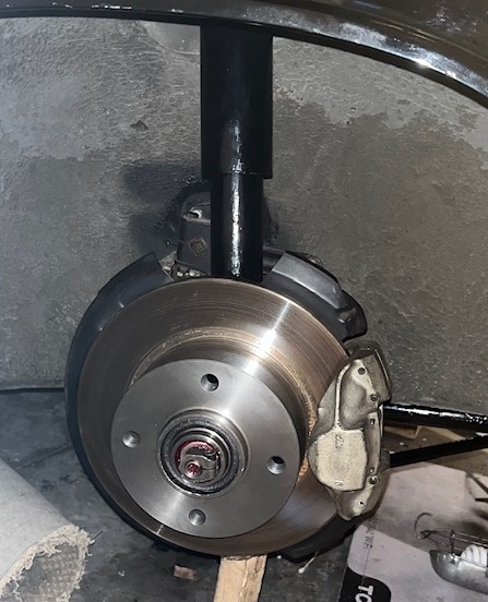

A productive weekend. After installing new wheel bearings, I got the rotors and calipers back on. Not an easy task to remove and reinstall the front calipers without disconnecting the brake lines because there's barely enough slack to get the lines mounted on the strut housing.

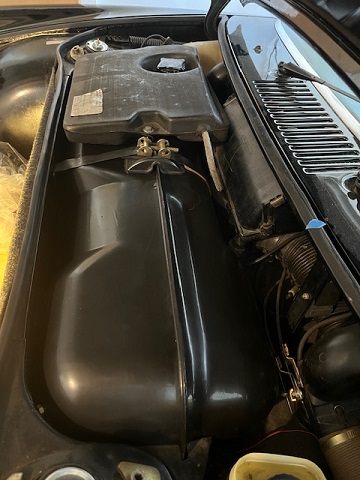

Gas tank is back in with a fresh coat of paint and all fuel lines replaced.
