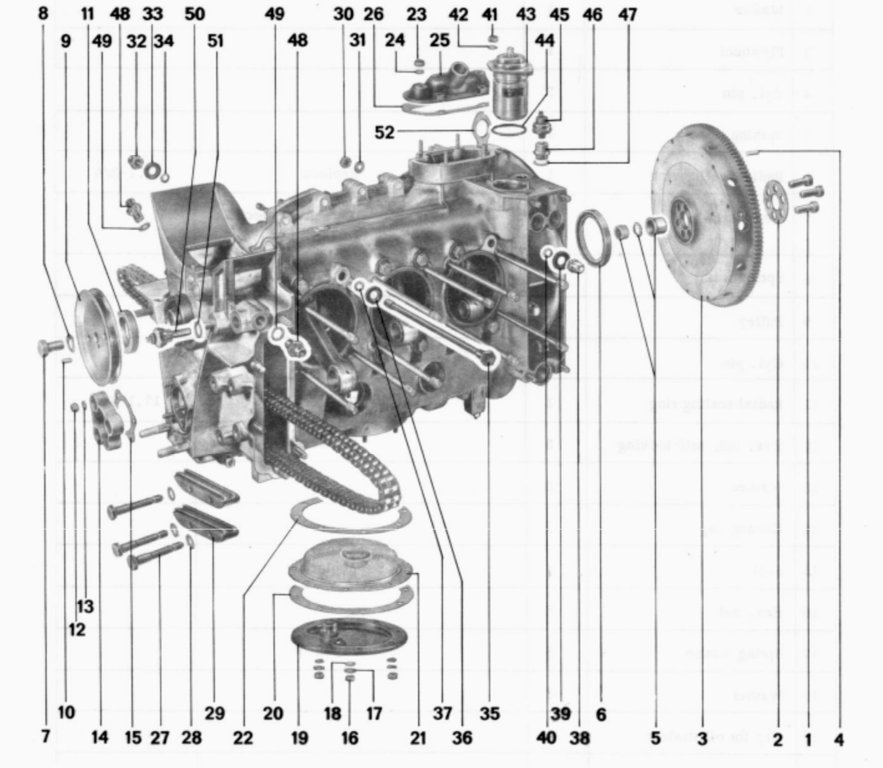

QUOTE(DennisV @ Dec 11 2023, 04:05 PM) *
Did 914-6 engines have an engine lift bracket (aka hook or ring)? I have seen a bracket listed for some 911 engines, but perhaps that was only for later model years. I'm not finding a listing in the factory parts catalog. I realize it might not help much getting the engine in / out of the car, but it sure would be handy for getting it off the engine stand.
The PET doesn’t appear to show the lift bracket, but the shop manual does.
Listed as item 52, called an ‘eye’. The engine won’t balance on it, you need something to lift from the other end. I’ve used nylon webbing, I’d consider an eyebolt through the engine mount somewhere.
