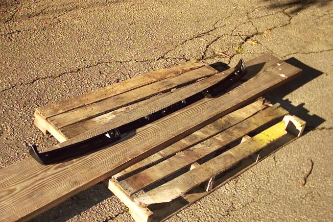

Started with a very low rust rear bumper.

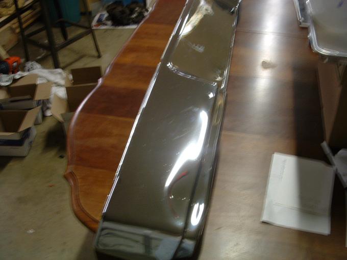

It did have several dents that needed to be removed.

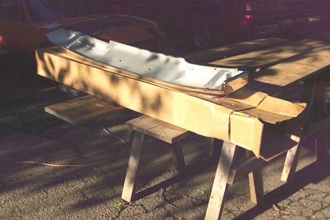

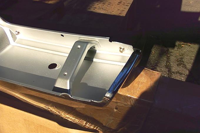

Painted the back side of the freshly re-chromed bumper. It had some discoloration in a couple of areas. I know! No one will see the back side, but it looked like it would be more succeptible to rusting (IMG:http://www.914world.com/bbs2/html/emoticons/wacko.gif) Plus it looked like the factory painted the back sides of the bumpers for some reason (IMG:http://www.914world.com/bbs2/html/emoticons/confused24.gif)

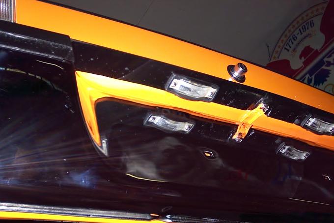

Member No.: 261
Cleaned up the license plate lights and installed with SS washers and screws.
Doug Leggins
post Aug 19 2005, 07:52 PM
Posts: 1,358
Joined: 6-February 03
From: Nashville, Indiana
Member No.: 261
I also had the tow eye hook hole plug re-plated.

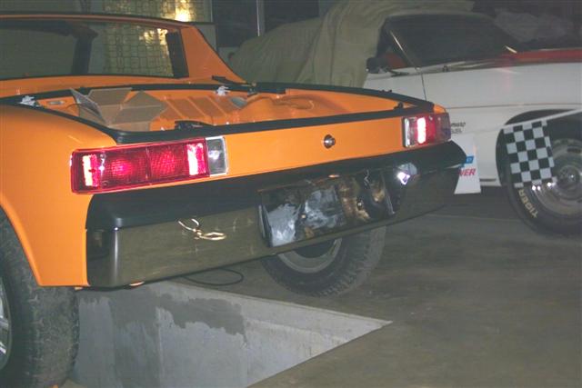

Here's the final look.

Outstanding work! Your rear lower pan is supposed to go on before the bumper- I would do the same wanting to see how my new bumper looked.
Okay, this is probably a dumb question and I'm overlooking the obvious. The chroming process is an electrolytic dipping process. When you get a part like the bumper chromed, why isn't the backside plated as well as the front? (IMG:http://www.914world.com/bbs2/html/emoticons/idea.gif)
My current plan is to not install a rear valance. I like the look without it installed.
