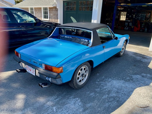

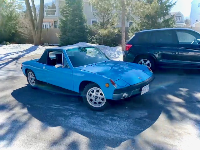

Over the past couple of weeks of winter; Sorted out the electrical gremlins, welded bungs in the exhaust, hooked up the Wide Band O2 gauge and got the Webers synched at idle.
Milestone today, went to the MA DMV and got plates for the 914. I dread going to the DMV, but we lucked out today and got the plates within 30 minutes with no nonsense.
It was cold enough today that the roads were dry, so we slapped on the plates and went down the road.
(My first time driving a 914.)
The O2 guage was showing really lean ( 16.5 AFR) and the engine had no pep, so we made it a really short ride. Ordered some bigger jets. Was running 115 main, ordered 130 based on a quick calculation of flow needed. The idle was lean too, so ordered 55s to replace the 50 idle jets.
