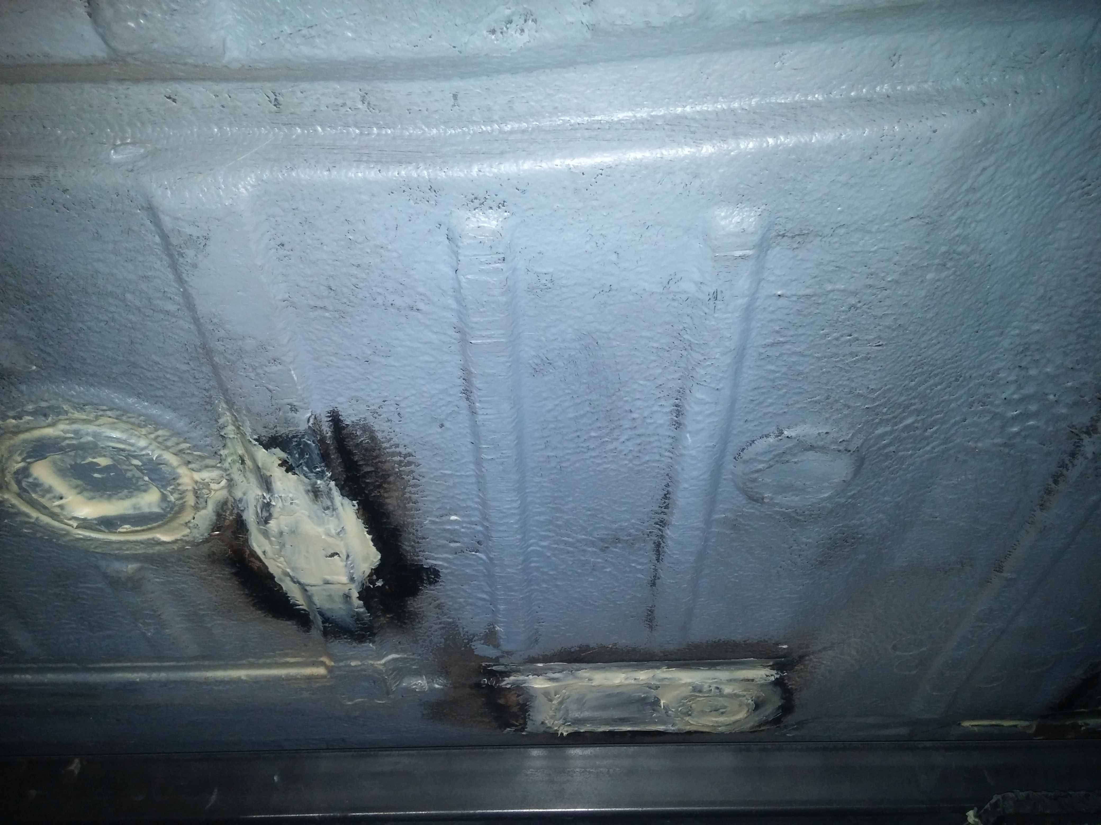

QUOTE(Rufus @ Feb 15 2024, 11:11 AM) *
@Rufus : I don't know what to tell you. Certainly not great, but I still don't know how bad that is. Is the pan soft or perforated, or is the Wurth undercoating compromised? Hopefully, the unbiased here will chime in.
Bottom line: I certainly would've had that fixed if Rillos hadn't assured me it wasn't an issue.
Below are a couple of underside pics prior to Wurth undercoating for reference:
- MR
Rufus
post Feb 15 2024, 06:08 PM
Post #125
Posts: 314
Joined: 8-April 06
Member No.: 5,840
QUOTE(mountainroads @ Feb 15 2024, 04:57 PM) *
- MR
Light from a drop light underneath

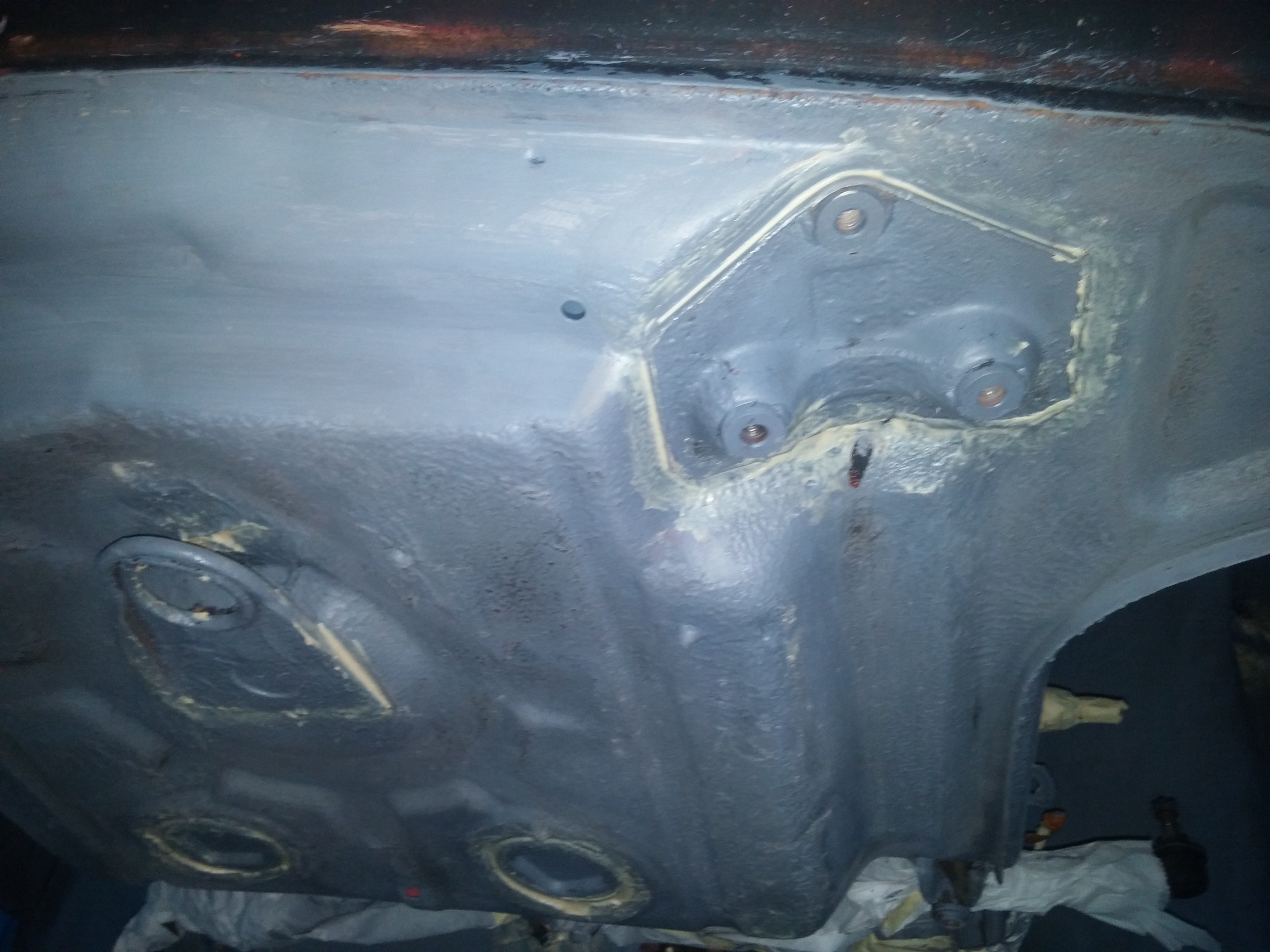

mountainroads
post Feb 15 2024, 06:14 PM
Post #126
Posts: 210
Joined: 19-February 12
From: Seattle
Member No.: 14,145
The second pic:
- MR

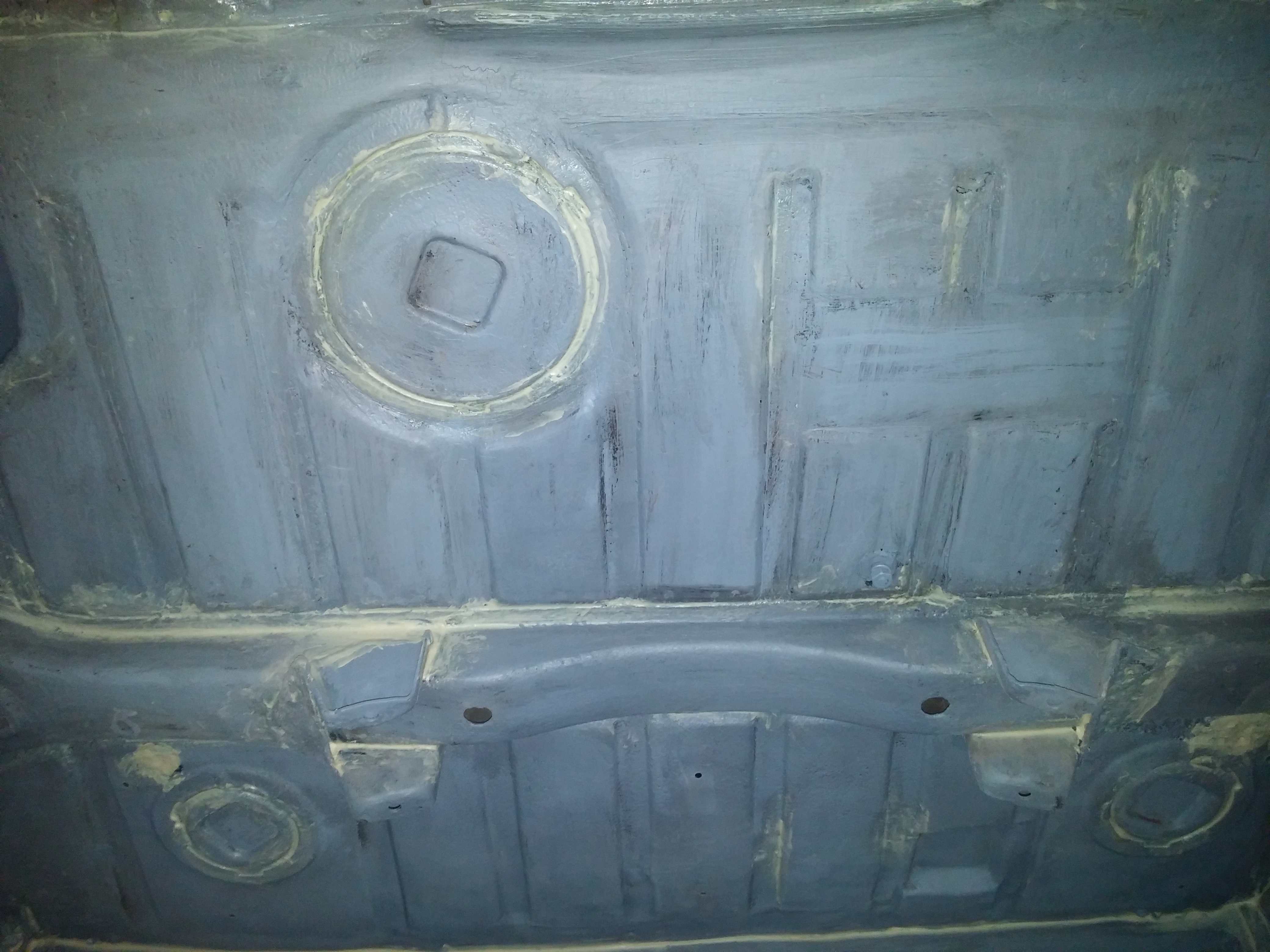

mountainroads
post Feb 15 2024, 06:23 PM
Post #127
Posts: 210
From: Seattle
Member No.: 14,145
One more. Unfortunately, I can't tell exactly where underneath the car these pics were taken. They were all sent to me by Rillos as work was in progress.
- MR

QUOTE(mountainroads @ Feb 15 2024, 06:23 PM) *
- MR
This is the driver's side floor, about in the middle, looking from the center tunnel at the top of the picture towards the outer long. Front of the car is to the right. The internal cross member sits above the rib that looks wider. The driver's seat is about the larger circular plug on the left.

I guess i’ll be the bad guy . . . Shame on Rillos for just rubbing seam sealer over that and then spraying undercoat.
$60k ? (IMG:style_emoticons/default/hissyfit.gif) (IMG:style_emoticons/default/sheeplove.gif) it has become almost impossible to find real craftsmanship in this world.
I just feel terrible for both of you.
The good news is that it is is a /6 and its a survivor and there isnt anything there that hasn’t been dealt with before.

Some basic input here after going through all of this
I think the only people to blame are the shops. I don’t think that floor pan would have been discovered in a ppi as it appears it was well hidden.
Only step forward is to properly repair it which if it were in my neck of the woods I would fix that area for around $1000 and it would be undetectable. I hope to see this thread move in a positive direction now.

I think I'm about done posting to this thread. I'm trying hard not to be defensive, but I feel like I'm on public trial. Not sure how much more of value I can add at this point, anyway.
Upon closer inspection now, it appears Rillos might've (I can't tell for sure) used body filler to "fix" the floorpan from below (Post #127). If so, I don't know why he did that instead of welding and he never said anything to me about it at the time. Had he said "This should be welded up.", I would've immediately said "Do it.".
Frankly, I didn't look at the pictures he sent too closely then and simply thought "Oh, he's just cleaning up the bottom before undercoating". I trusted him to take care of what needed fixing and to do a good job. Perhaps that's why he didn't want to do anything from the top side of the pan. IDK.
I again refer to the initial PPI (Post #128, page 4). Although numerous mechanical defects and the front panel repair were noted, they inspected the bodywork and underside and no rust issues were pointed out. I would've gladly shared all the restoration pictures I received and the PPI with any prospective buyer or inspection shop, if requested. Perhaps those items would've informed a different purchase decision.
@Rufus : I feel your frustration and disappointment. I'm still confused why you started poking around under the seats in the first place though, unless it was a quest to find everything possibly wrong with the car? Did your subsequent scraping and wire brushing remove the "repair" that Rillos did, and that exposed the holes?

Is the picture in #123 the bottom of the center tunnel? #129 the light color smear had the cancer behind it? The really dark spots might be a rust conversion product. Get an ice pick and probe around. Move forward.
