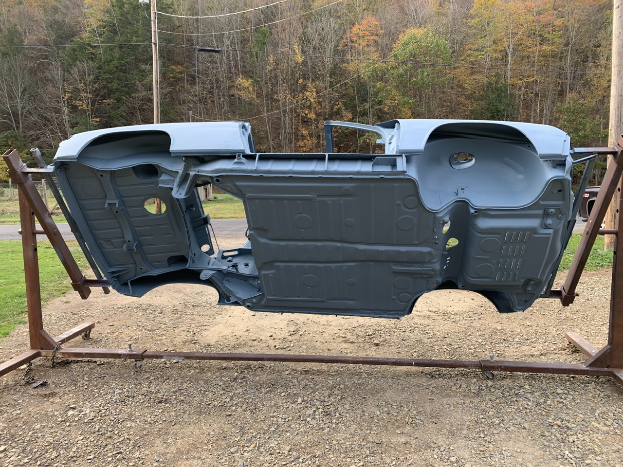

Like this 914-6 I am finishing?

This could be your 914, if your pockets and time frame are in line.
For me, I would inspect for structural deficiencies and assuming none enjoy this beauty.
If structural work is required, go after it with a solid plan and a solid repair facility.
