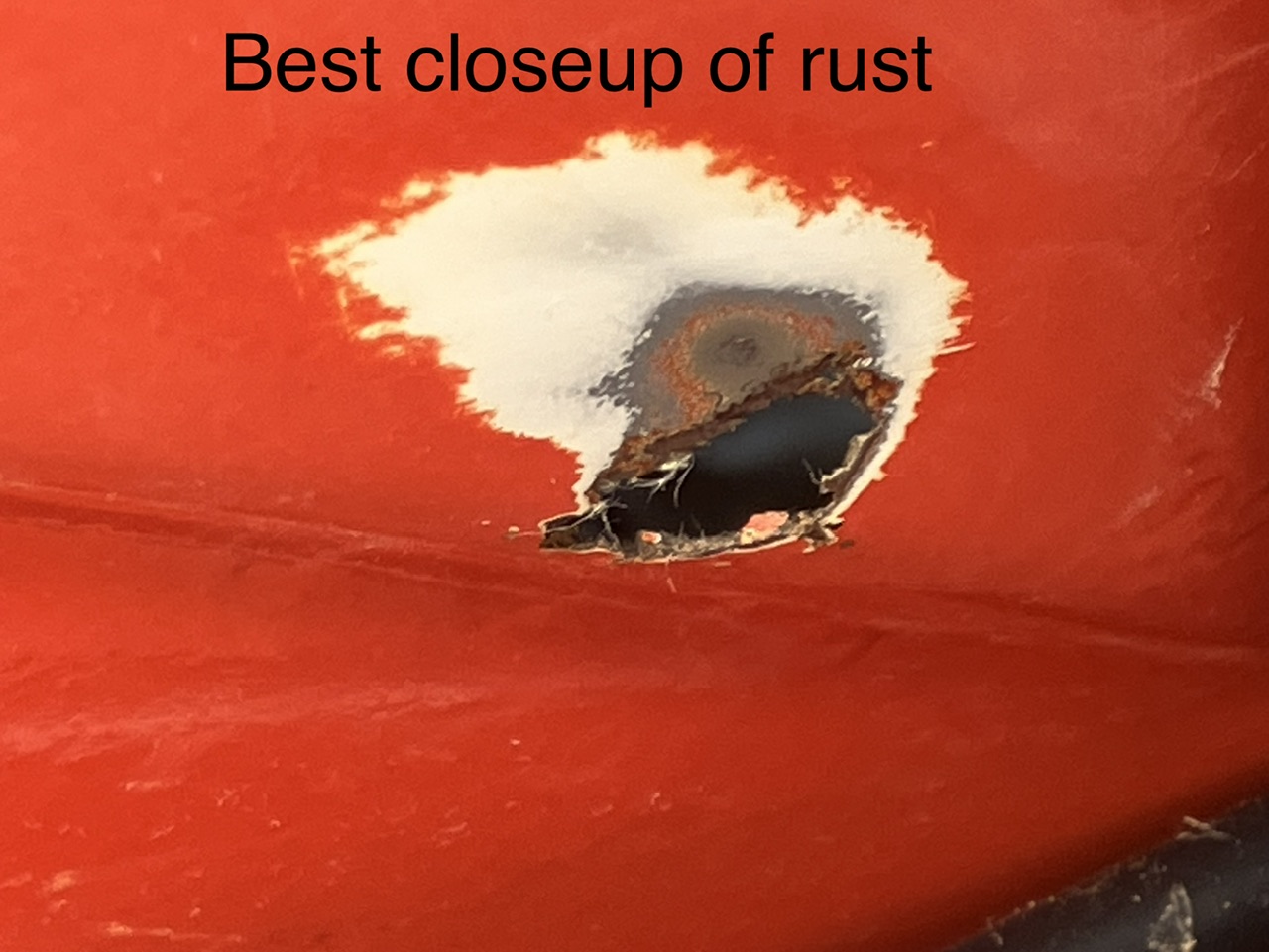

A little sanding with 400 grit, followed by rubbing with acetone soaked Q-tips & paper napkins
Bottom pic after Evaporust gel applied

Interesting.
So I don’t see a second coat of paint under that one. So are the paint runs from Rillos?
I don’t mean to be insensitive by disregarding the rust.
It’s just that I’m amazed by the bill for bodywork, only to get runs like that.

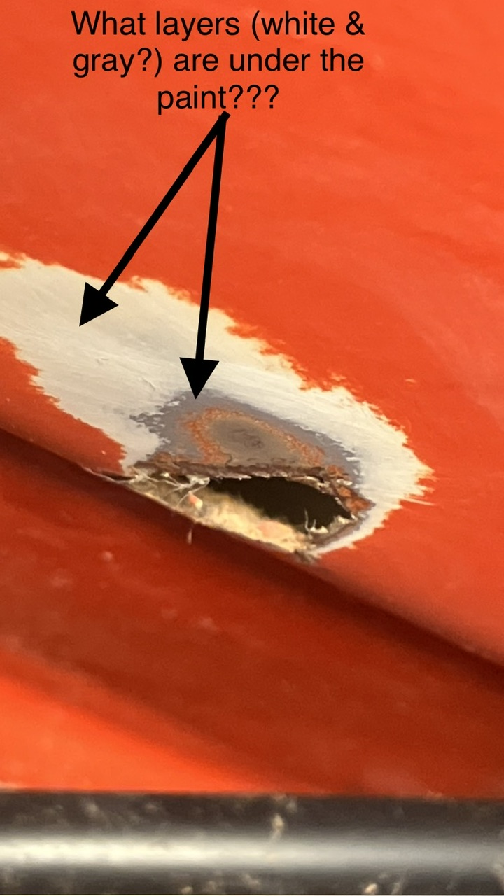

QUOTE(mountainroads @ Feb 16 2024, 02:03 PM) *
@Rufus : I feel your frustration and disappointment. I'm still confused why you started poking around under the seats in the first place though, unless it was a quest to find everything possibly wrong with the car? Did your subsequent scraping and wire brushing remove the "repair" that Rillos did, and that exposed the holes?
- MR
Probing after cleanup from a couple of days soaking with Evaporust gel. Numerous (5) probe (awl) pushes in different spots; two perforations

QUOTE(Superhawk996 @ Feb 23 2024, 12:28 PM) *
Interesting.
Since receiving the car in Nov 2020, nobody has touched the car but me. As described in this thread, I’ve done a number of things, but no paint or painting. I have no reason to think Rothsport did anything re paint.
MR will have to address what happened up to July 2020 when Gamroth picked it up for me
