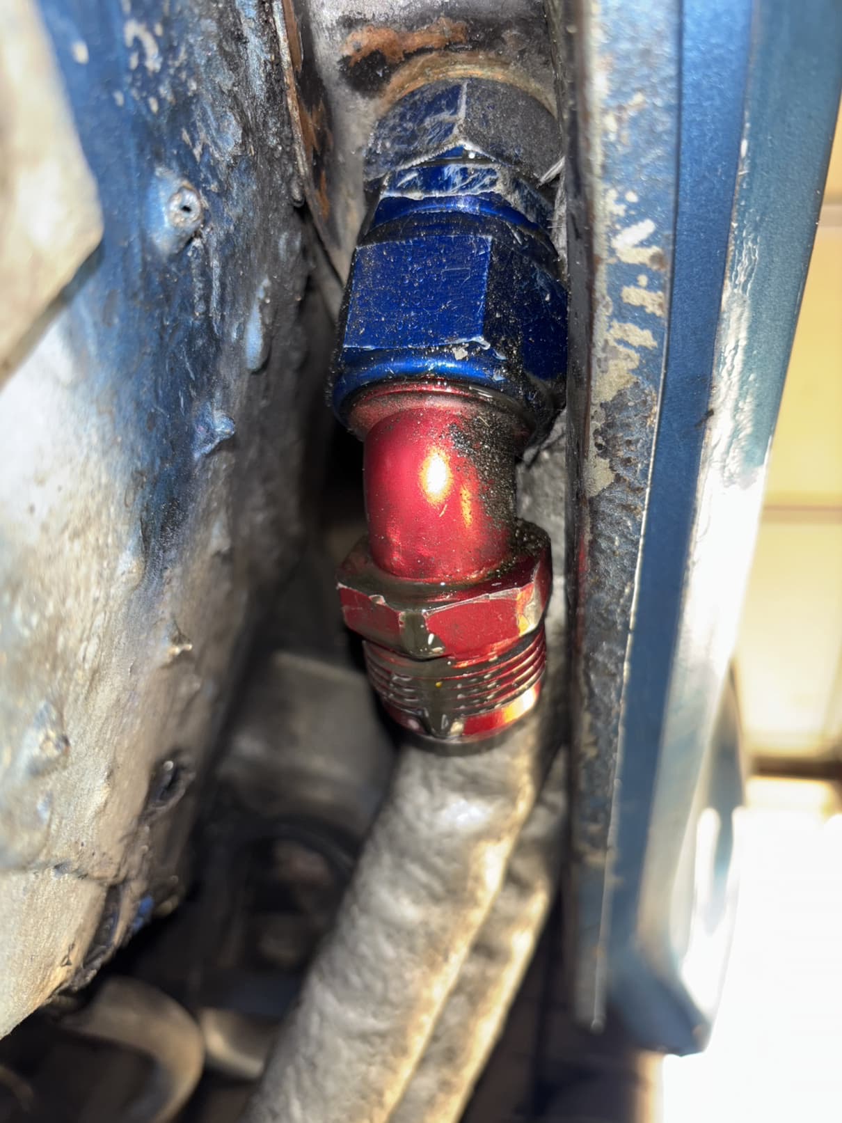

I couldn’t stop the constant drip from this 30mm to AN16 tank adapter, so I spent a day to remove it. PIA.. I’m going to replace it with a stock oil line, so I can tighten it. I could not get a crows foot or other tools over the AN16 fitting.
According to the 993 owners manual, break in is 600 miles. I finally have 600 miles on the top end overhaul, so the perfect time to fix the oil line, install larger oil cooler and change the oil and filters.

I replaced the kludgy M30 to AN16 oil tank adapter with stock 914-6 oil line. What a difference. Should have done this years ago. This fixed the oil leak issue and now it’s easy to tighten it under the tank.
