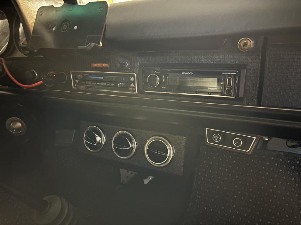

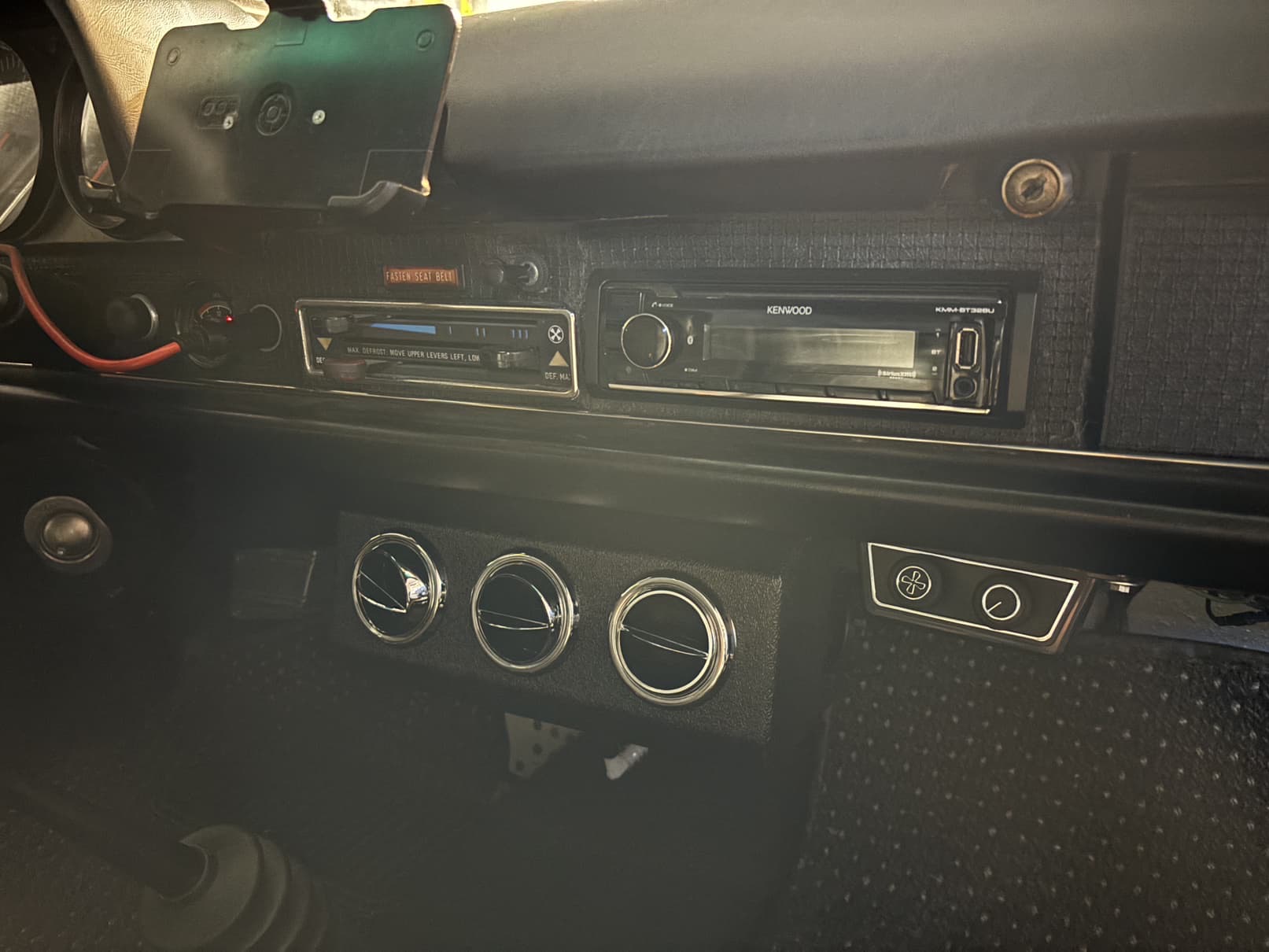

Next steps get the electric AC working.
Mounted the Southern Air mini under dash evaporator. Not too intrusive. I need to make longer hoses and use different ends. Need to find better spot for the controls. Waiting for parts. Slow progress as usual.

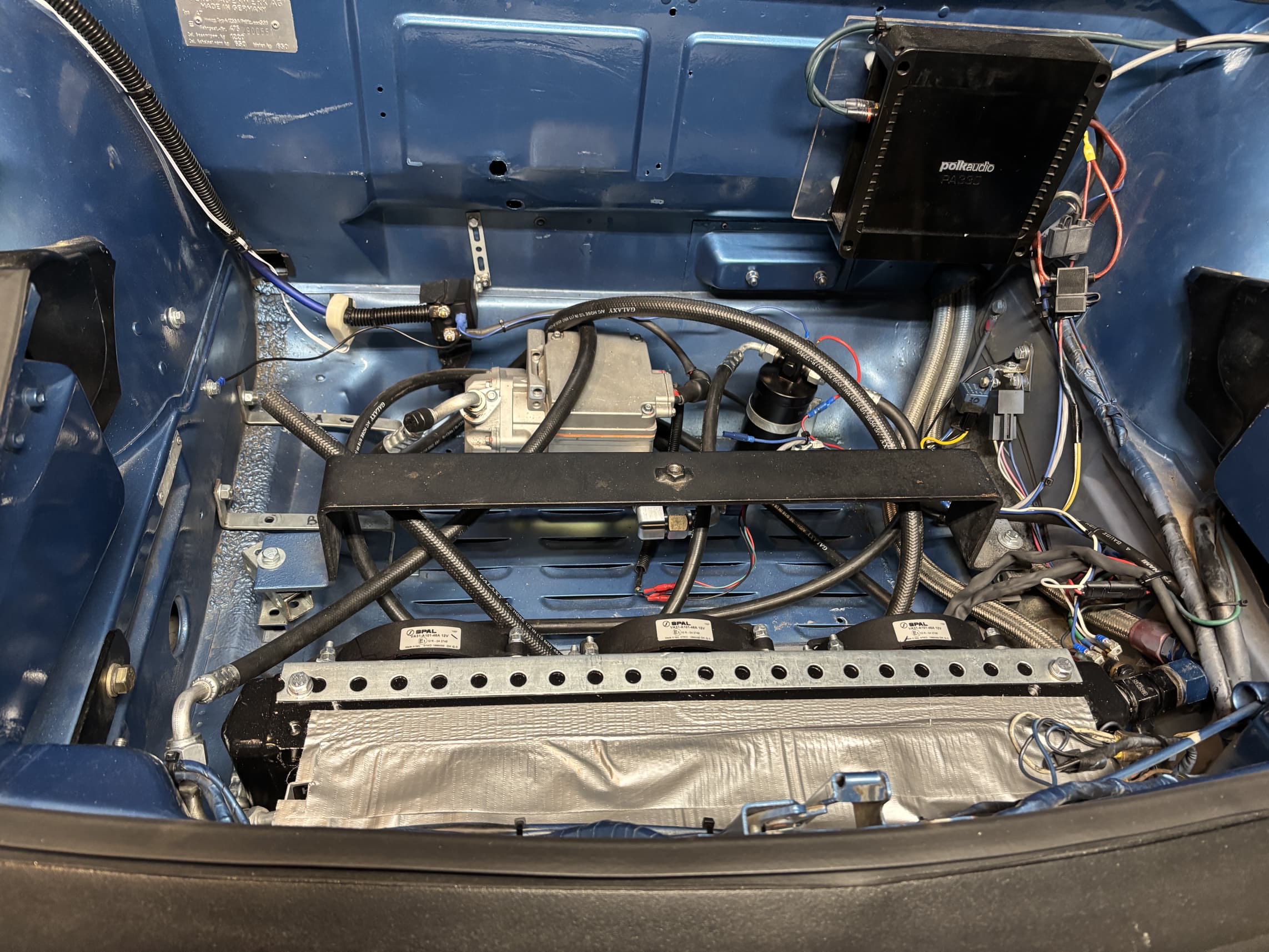

Replaced GT3 muffler with my M&K 2 in and 2 out muffler. The Dansk GT3 muffler was too quiet and boring. Also very heavy compared to the M&K. I also replaced the crappy hot wire to the compressor with 2 AWG copper wire and replaced the 17” fixse rims with 16” Fuchs. I took this picture at Cars & Coffee in San Clemente last Saturday and used Meta AI to change the background to a virtual Porsche Dealer.

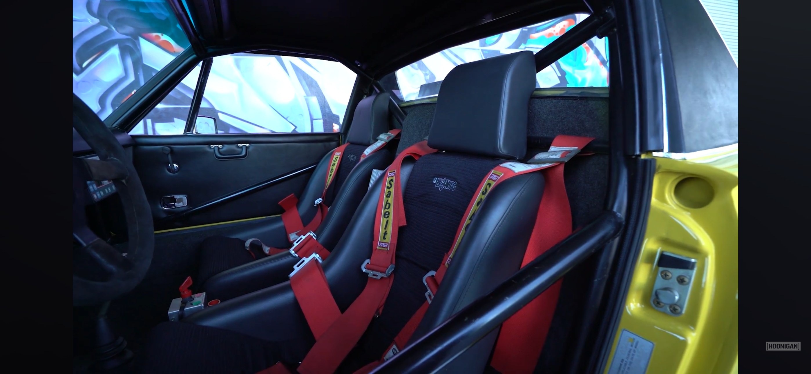

I bought a set of used Konig seats from someone that bought them from Jeff Zwart. Here’s a picture of them in his car. I will post a picture of them in my car when I get a chance. Very nice seats, but harder to get in and out of. The drivers side was a straight bolt in. The passenger side was more of a pain. I had to enlarge the rail holes and realign the rails on the seat to get them to slide right.

Thanks!! (IMG:style_emoticons/default/beerchug.gif) Another 914 guy said try to be happy with 95%, because you will never achieve 100%. The seats are nice and comfortable but a pain to get in an out. I added a lumbar pad to the seat bottom, which lowers the bolsters and makes it easier to get in and out of. Like the Lemans GTS seats, it has a springed bottom, which makes it more comfortable than stock. The higher seat bolsters are also nice if I ever autocross it again.
