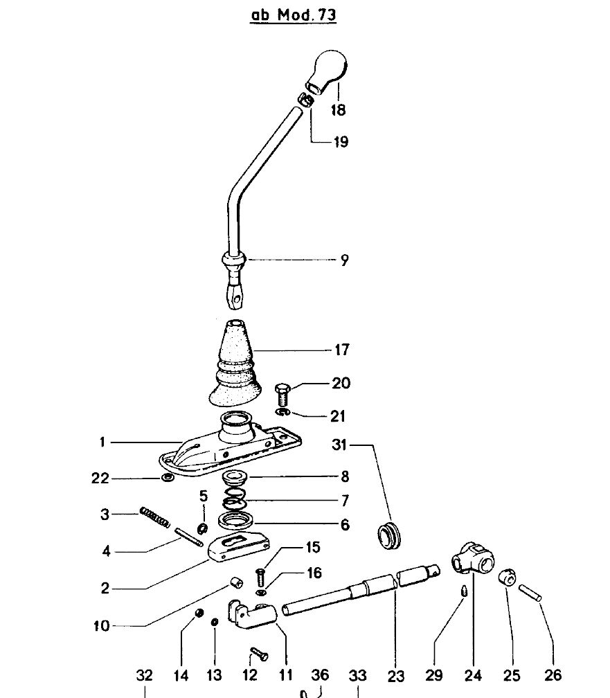

Have you tried adjusting the shifter? If it is currently set where you do not need to push what is called the "stop plate" (mentioned by the others, #2 in diagram) by a lot to get in first gear, then it may be too easy to get into reverse too? (IMG:style_emoticons/default/idea.gif)
#2, 901.424.017.00 could be worn out. This spring loaded part can wear out over time, especially if there is no lubrication. There could also be something malfunctioning with the springs too. Sometimes if the stop plate is worn out, the shifter lever is also worn out where it contacts the plate.
You may want to investigate in there and assess the condition, especially if you have taken care of all the other bushings, time to complete the job. (IMG:style_emoticons/default/smile.gif)

Item #2 must be inspected for wear at the shift lever connection point along with the lever itself. The linkage should jump out of the 1st/R plane. If not done, presume EVERY bushing in the linkage needs replacement. Repeated grinding will more than likely result in an expensive repair and excessive down time. Shifter removal and inspection is a simple task.

There are 2 springs and 2 small rods, #s 3 and 4 that support the detent plate. If the plate is worn replacements are available. There are 4 number 5s (circlips) that keep the small rods in place. The springs also get gunked up limiting compression. Getting the rods and springs back in place can be a small problem.

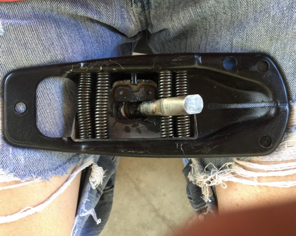

I can show you what I did for that reason and also coming quickly from higher gears to second.
@burlybryan

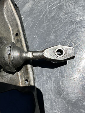

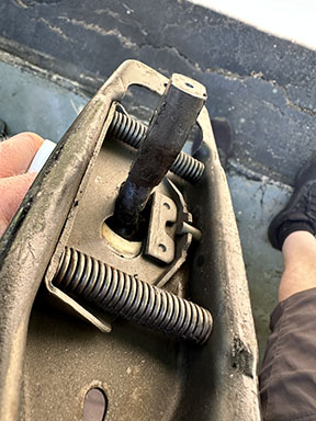

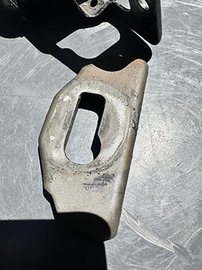

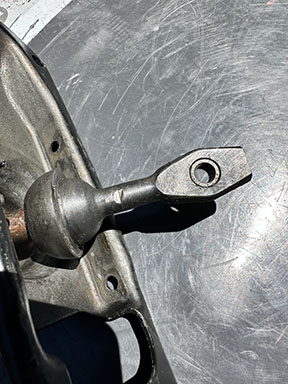

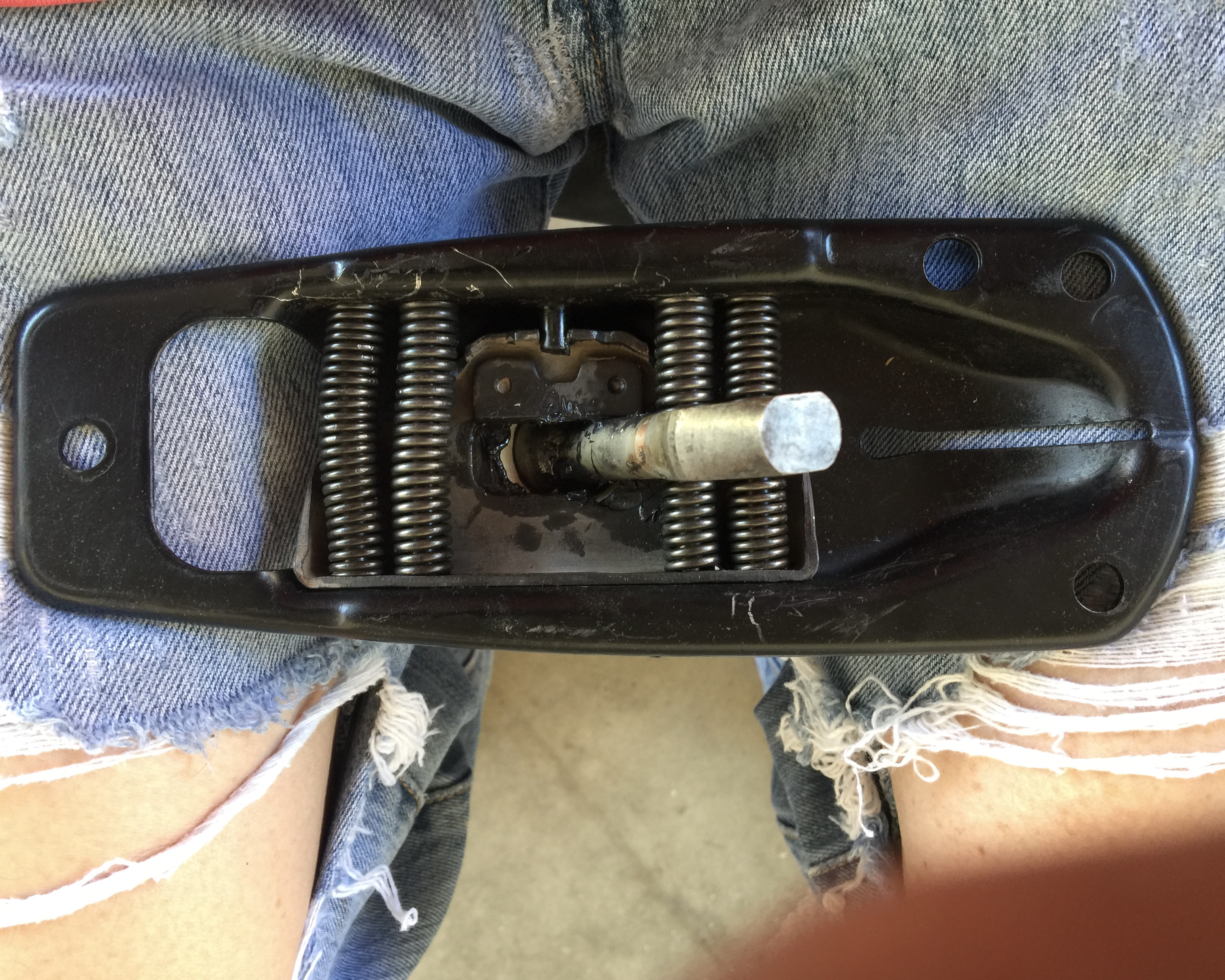

Finally got around to pulling the shifter. Springs intact and someone has replaced the lock out plate in the past, but I think I found my problem. Can I weld fill this wear on the shifter shaft or should I look for a good used or new one?
914werke
post Jun 30 2024, 01:25 PM
Posts: 11,796
Joined: 22-March 03
From: USofA
Member No.: 453
Weld it.

burlybryan
post Jul 3 2024, 03:39 PM
Posts: 180
Joined: 25-May 20
From: Saint Paul
Member No.: 24,311
Welded and reinstalled. Having a blast trying to re-find the gears.
Found these threads from dr evil and Chris.
http://www.914world.com/bbs2/index.php?sho...91028&st=20
http://www.914world.com/bbs2/index.php?showtopic=188120
Got the gears back by twisting on the rod in the tunnel (Chris's method), but need to fine tune. Not going directly into reverse anymore, but still nicking it when going to second sometimes.
Seems from the threads that this requires some very particular fine tuning.
