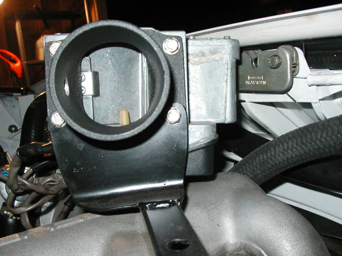

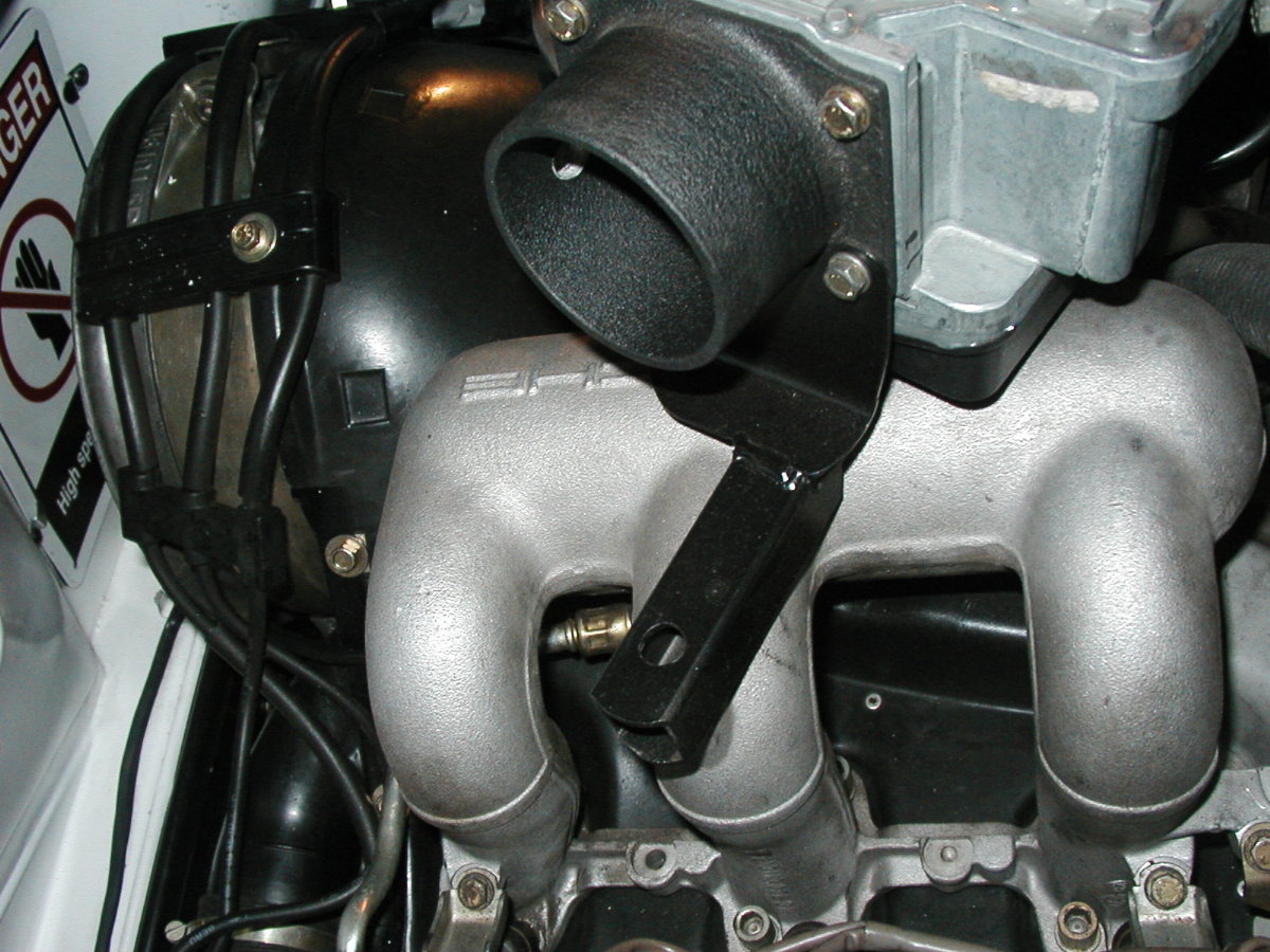

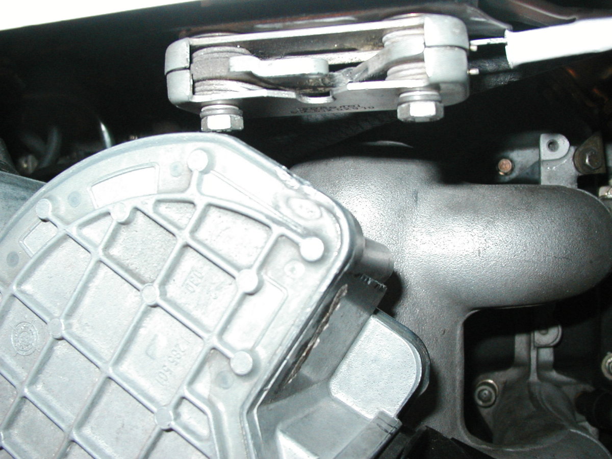

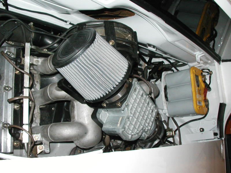

slightly turned to clear latch...

one more... I have more at home or can take more pics of the mount with the air filter removed if you like.

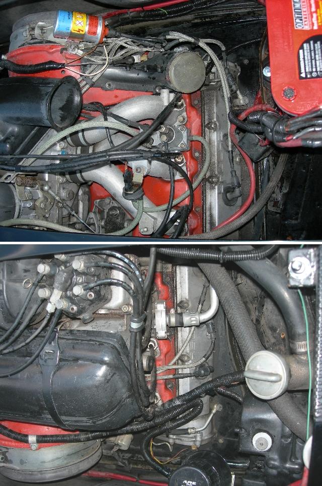

That's fine. Thanks Mike.

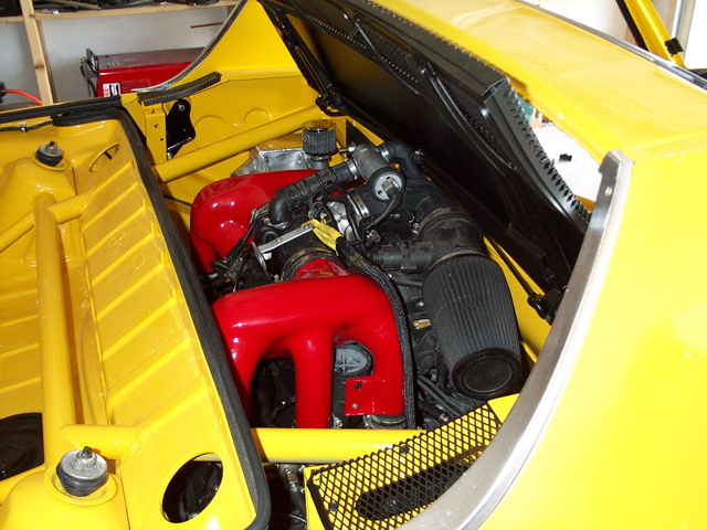

You're engine bay actually looked a little dirty in that second picture. I knew I should have cleaned the RS before voting at the RRC.... (IMG:http://www.914world.com/bbs2/html/emoticons/cool.gif)

QUOTE (914RS @ Oct 25 2005, 07:36 AM)
LOL, i'm still finding red dust in places (IMG:http://www.914world.com/bbs2/html/emoticons/dry.gif)
and the air filter in those pics does not clear the lid. I had to go smaller on the diameter.
Ferg.

Smaller diameter air filter:

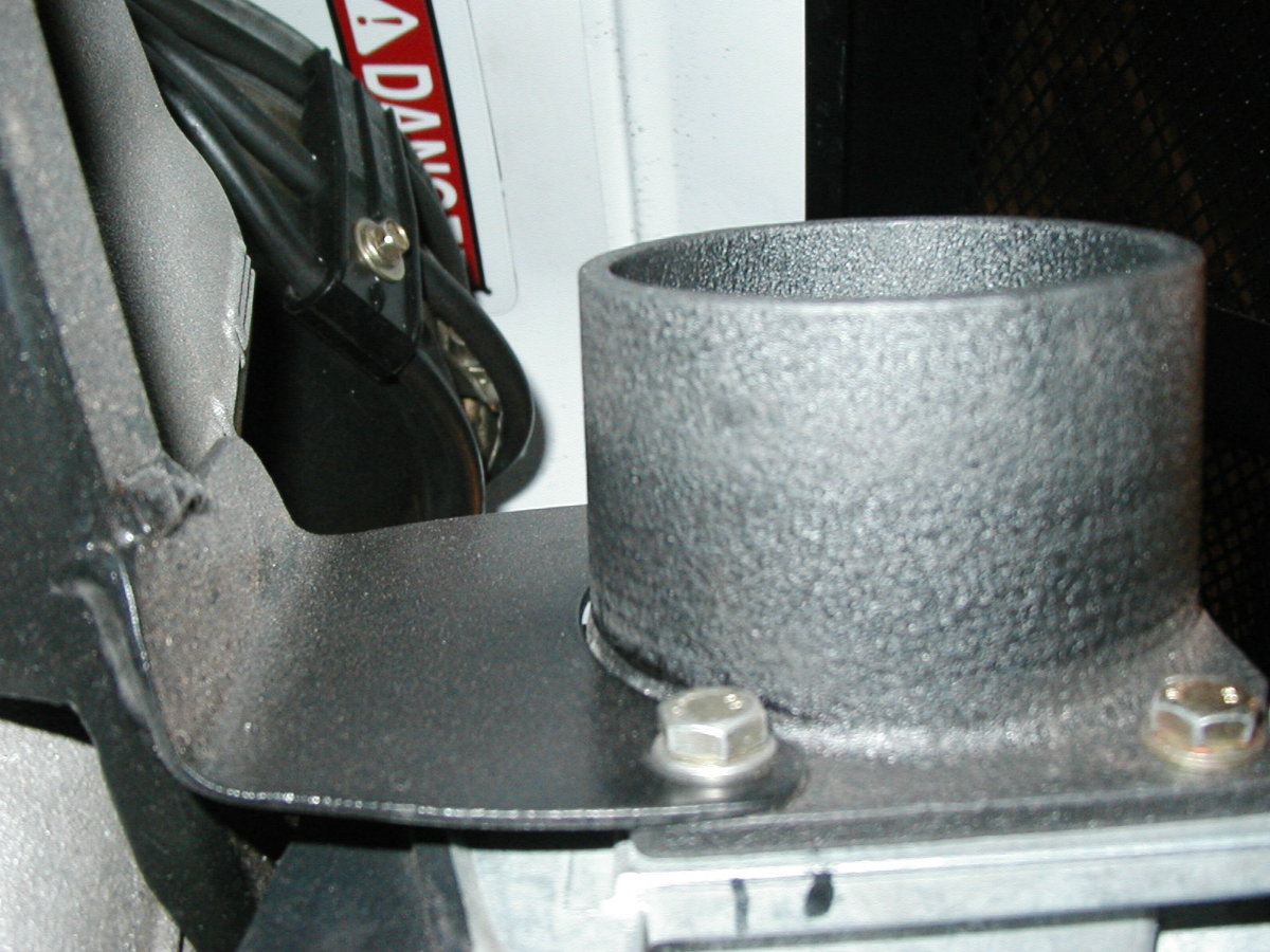

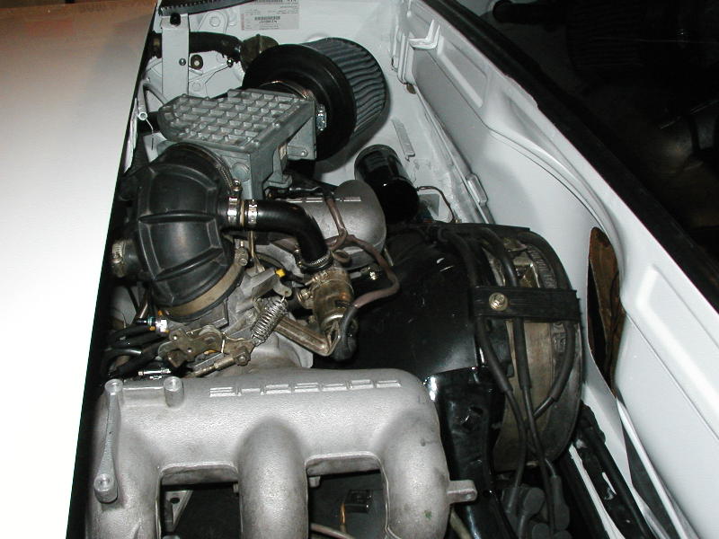

More Pics were promised so here you go.

nuther, the mounting point on the aluminum intake runners is slotted for adjustment

very tight but works, the pic angle makes it look tighter than it actually is.

last one

Mike,
That's almost exactly what I'm attempting with my recent 3.2 project. On the race car, we simply cut the rear trunk and kept everything stock. Since then we have replaced the stock airbox with one of those cone air cleaners.
On my street car 3.2 I am already planning on getting one and turning the air flow meter as you show. I'm glad to see that it all fits in there.
I was considering turning the intake manifold around, but may not have to.

On my 3.0, we lowered the firewall mount about an inch and removed the latch. secured it with pins. no clearance problems.
