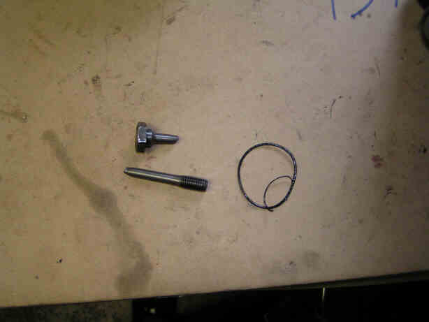

A couple of casualities. A broken drive flange expansion bolt. I used the wrong torque spec. And a pinched O-ring

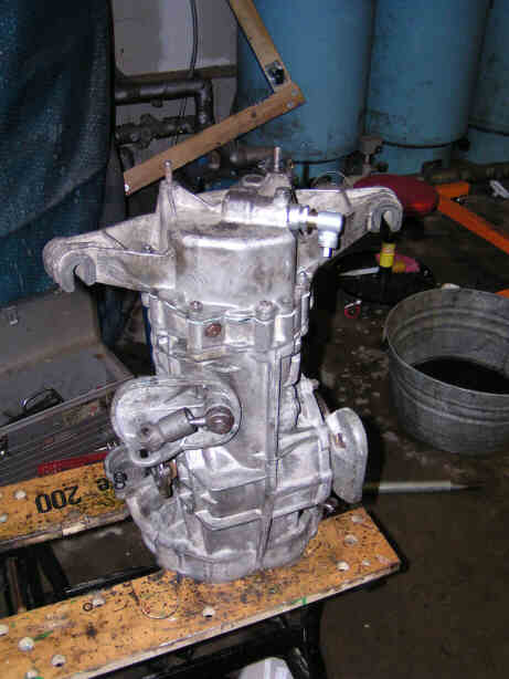

Done!! (IMG:http://www.914world.com/bbs2/html/emoticons/smilie_pokal.gif) I just need to add Swepco. I sure hope it works

Thanks for putting so much time into documenting the rebuild. It's the best I've seen in terms of photos. Good Luck!
