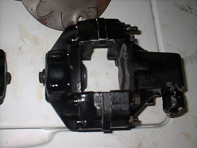

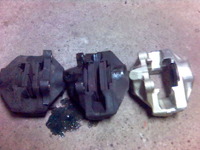

Installing the Carrera calipers on today I noticed that they are damn close to the 320i BMW ones without the spacer. In fact really effin close!
I wouldn't bother using "M" calipers as they fall in between the Carrera/320i and the stocker in size. Attached image(s)

M-calipers allow you to use a vented rotor, so they are infinately better than a BMW caliper. It's all about the cooling. |

Yeah, thats why I went to the Carrera calipers and the vented rotors but the 320i calipers look the exact same as the Porsche ones. Someone just has to source spacers as the BMW ones were WAY cheaper than the Carrera ones. But piston wise the BMW one and the Carrera are the same size, equals same force.
The "M" calipers are weenie compared to the BMW/Carrera calipers. Piston size equals more force to stop, even if you are using solid rotors. (IMG:http://www.914world.com/bbs2/html/emoticons/popcorn[1].gif) |
