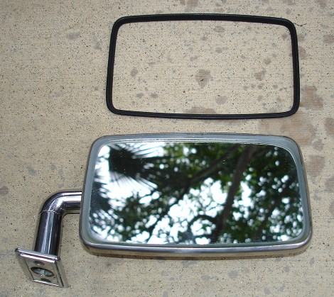

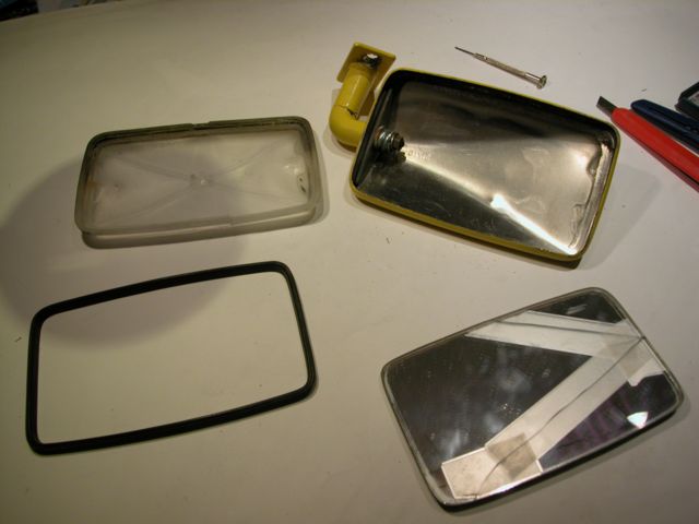

Thank you for the tips. I just have done the job today. I had a broken mirror.
I decided to replace it and in the meantime wanted to bring my painted side mirrors back to polished finish.
Here are a few pictures showing what has been described in the previous messages.
Here you can see the first ajusting nut.
johannes

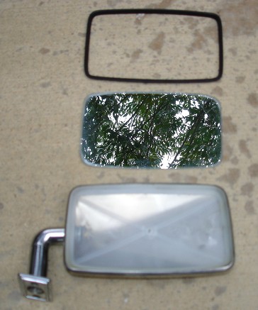

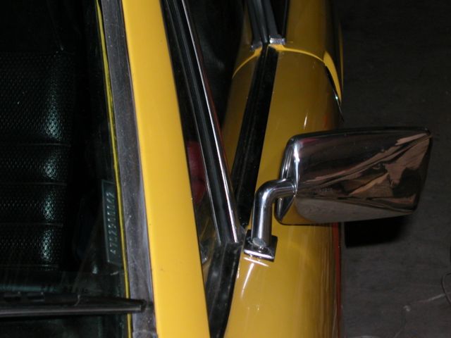

Here you can see the transparent spacer and the plastic sealing.
You can see the second ajusting nut that is behind the (broken) mirror and the transparent spacer.
johannes

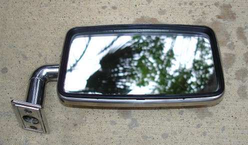

A friend of mine kindly polished all the parts ... Not so bad looking for a 30 years old side mirror (IMG:http://www.914world.com/bbs2/html/emoticons/wink.gif)

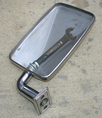

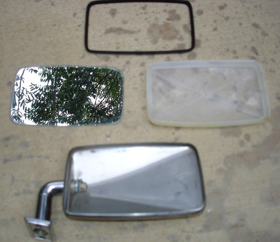

Gwen, I did send the pictures to you. . . here they are again, without narrative, which has been so eloquently described above . . . .
type47fan
post Jan 29 2006, 12:32 AM
Post #29
It Looks Better In Person. . .
Posts: 860
Joined: 17-September 03
From: Carlsbad, CA
Member No.: 1,170

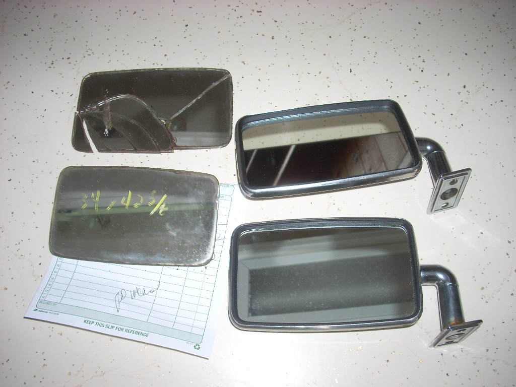

#2

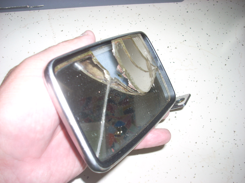

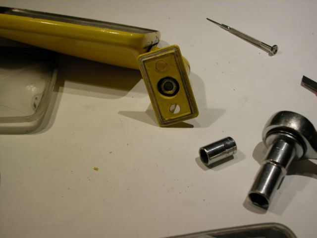

AAARRRHHHH , Just began to restore my second mirror ... and found out that the transparent plastic is broken in 3 pieces ... so is unusable ...
Does someone have this part available for me ? ... I can pay of course
The piece I need is the one shown on the picture bellow
HELP !!!! (IMG:http://www.914world.com/bbs2/html/emoticons/smiley_notworthy.gif)

I've never done it, but I expect you could get away with some foam tape, maybe 1/4" thick. Just put it around the outer edge of the steel piece. (IMG:http://www.914world.com/bbs2/html/emoticons/idea.gif)

QUOTE(johannes @ Feb 1 2006, 10:24 AM)
I've repaired these pieces using a 3M Scotch-Weld product: DP-190, gray. It's a two part epoxy adhesive that remains flexible after curing. Just run a thin bead on the part and put the pieces together. I use regular masking tape to hold the assembly while curing.
Good luck,
HELP !!!! (IMG:style_emoticons/default/smiley_notworthy.gif)
My USD.02, see above

Thank you, I'll try that ...
