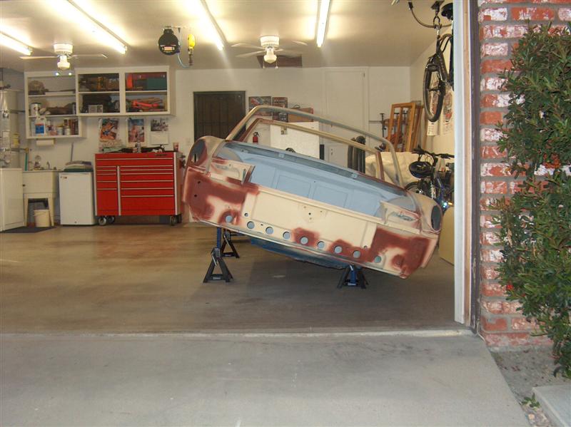

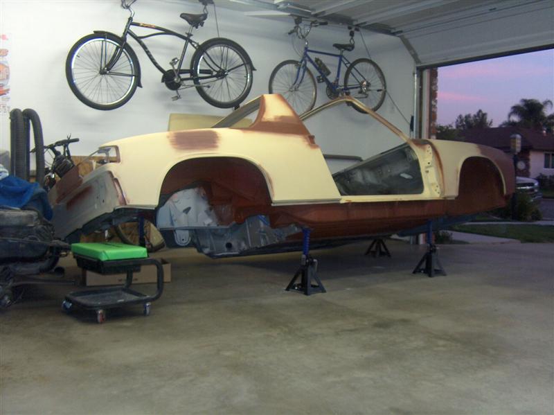

I've been watching Joe O'Brien's progress on the Turtlegirl car, he painted the underside first, before he painted the rest of the body.
The more I thought about doing it that way, the more it made sense, this way I can put the suspension back under it which allow me to roll the car around when I paint the exterior, and it will allow me to make any adjustments to the rear fenders for tire clearance before I put the finish paint on the car.
Here's the car back up in the air, I sure wish I had a rotiserie;

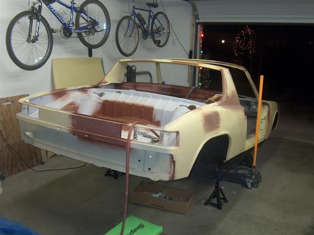

The Rear;

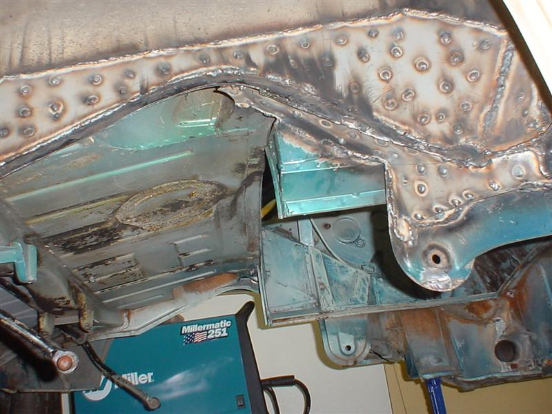

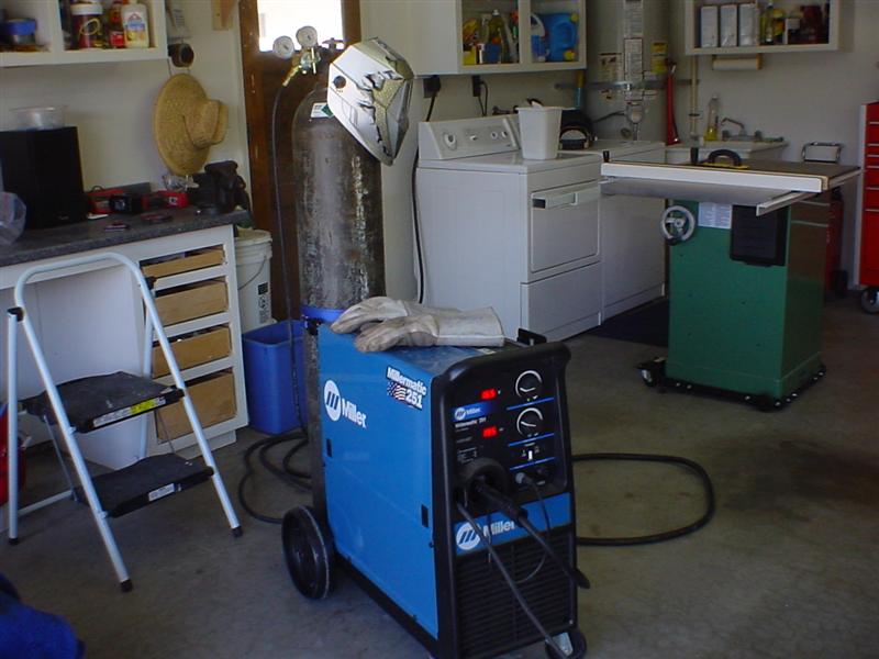

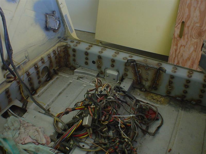

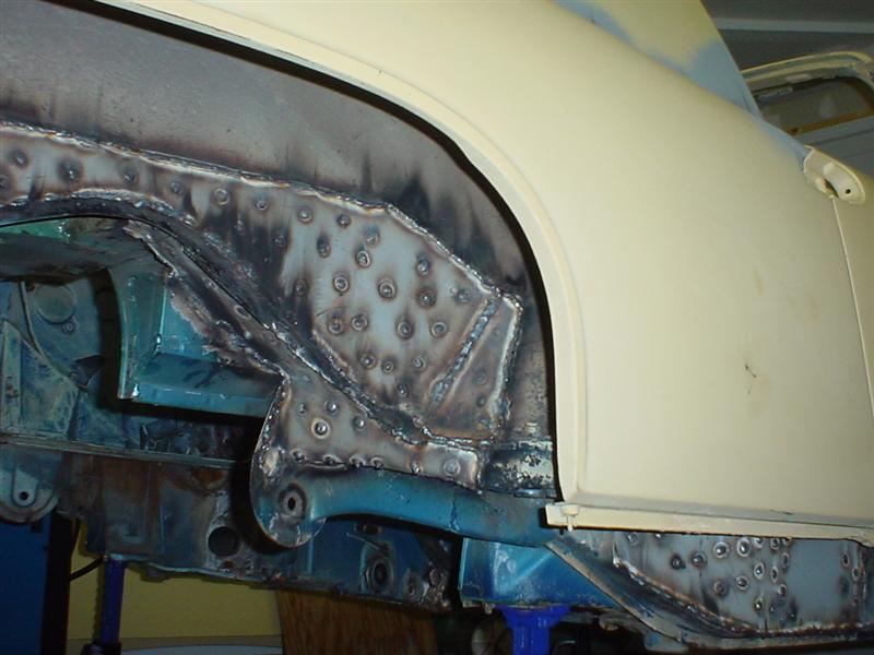

Getting ready to start some welding, we ended up with about 12 hours of welding, which included the Engman kit, GT kit, trunk and hell hole repairs.

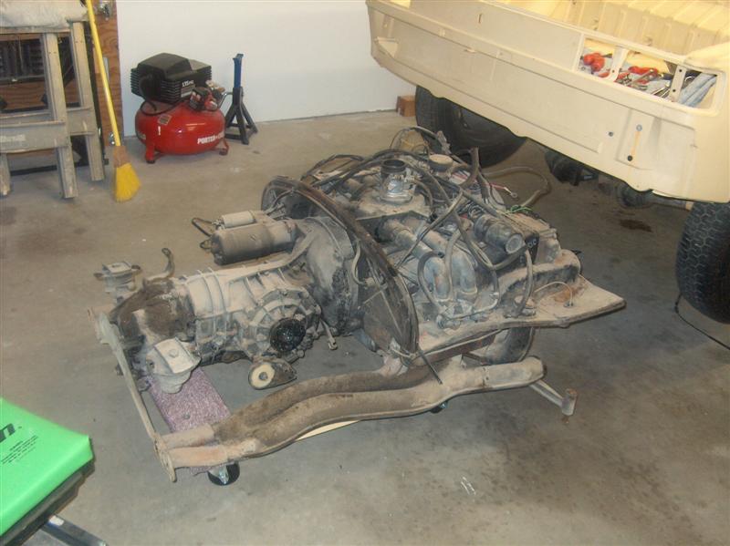

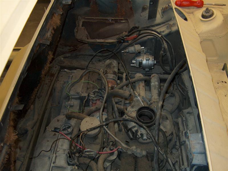

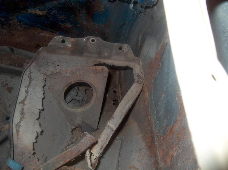

Original engine removed;

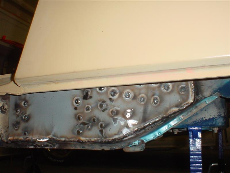

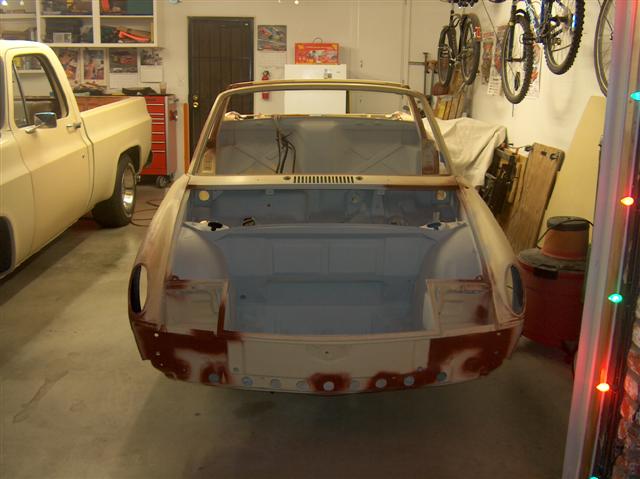

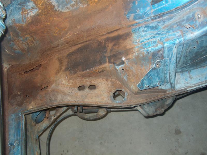

Here is the pasenger side long, I've got the whole underside of the pasenger side done, still stripping the drivers side.

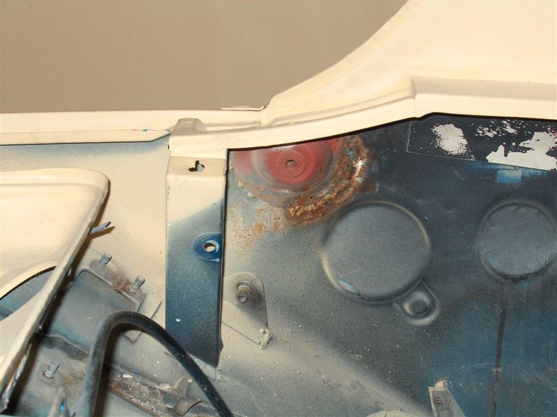

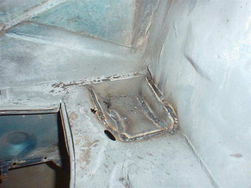

Hell hole and battery tray repair;

Here is the installation of the Engman Chassis Kit;

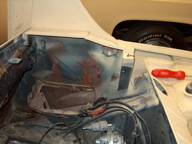

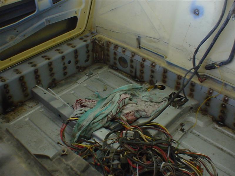

Rear trunk replacement and hell hole repair:

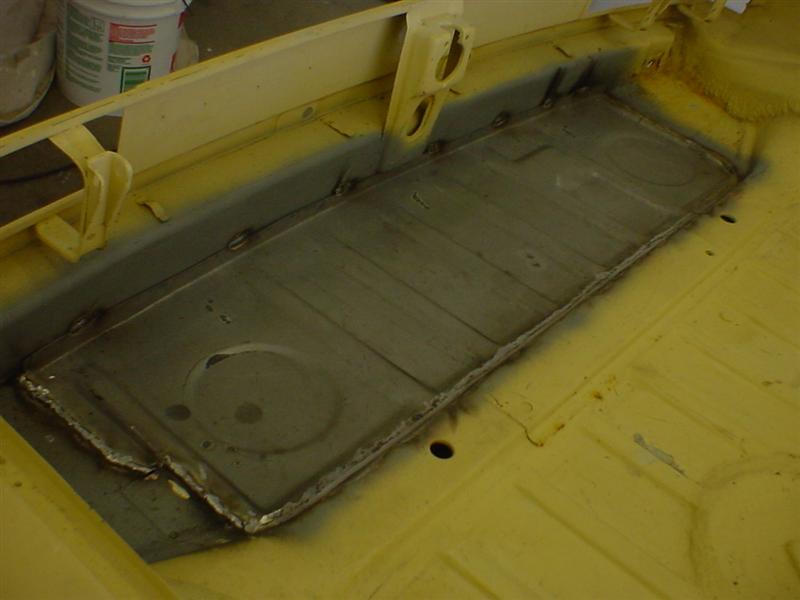

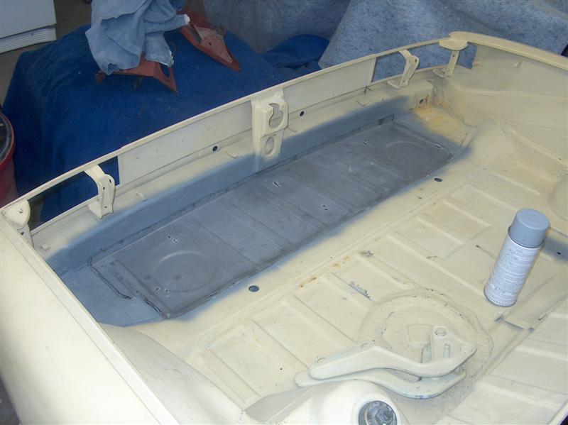

Rear trunk panel replaced;

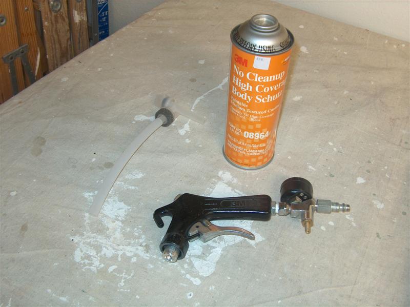

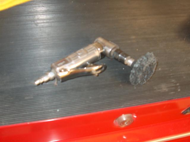

I sprayed Castrol Super Clean (Purple Container) first to remove all the oil and grease, I did this two or three times. Then I used Aircraft Paint remover, you brush it on in one direction only. I then scraped and wiped it clean. I have a die grinder with a cleaning wheel attachment, I think its made by 3m, it does a great job of stripping the old paint off and ruffing the surface up enough to paint.
Then I shot the underside with 3m Body Schutz:
